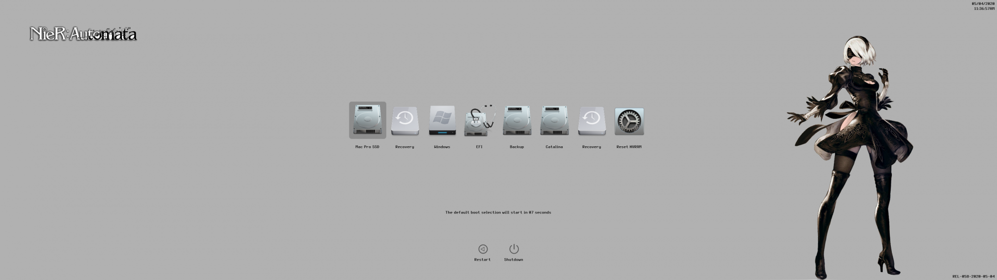

Wow, what a nice background picture. Would you share it?
So, I have to rename the drivers, right? I didn't get that before.

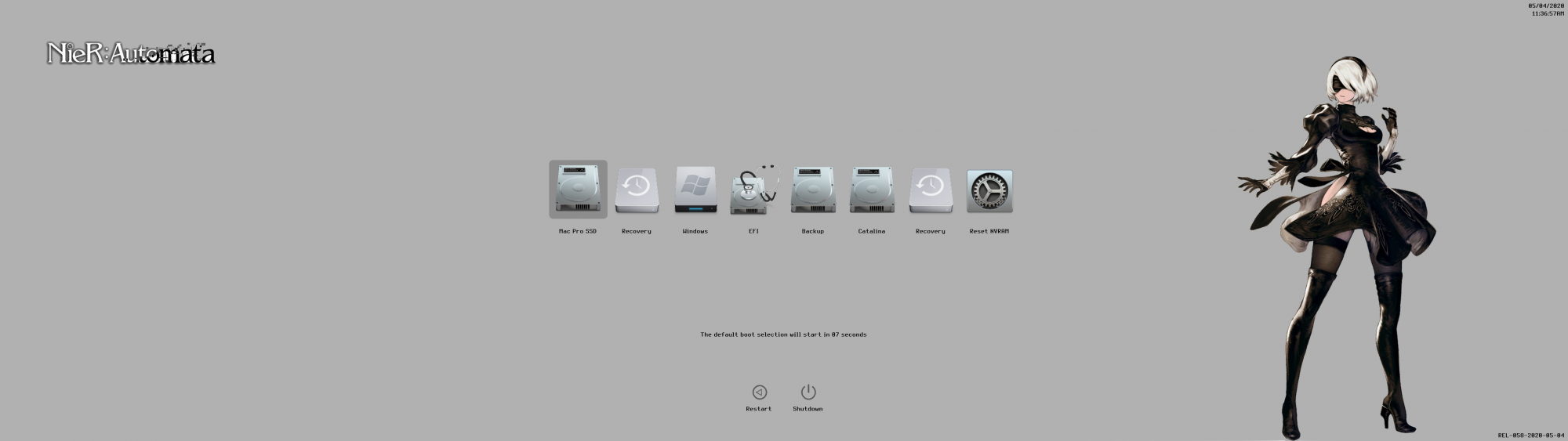

Attached is the background picture I am using for NDK BootPicker, it is 1920x1200 pixels, you may have to re-size it for your monitor resolution. I used Apple's Preview for resizing. I also included an improved graphic for the pointer. This version is black with a white outline and shadowing. This gives the pointer improved visibility when over any background.
  • NDK BootPicker assets.zip
Reactions: leoaf79

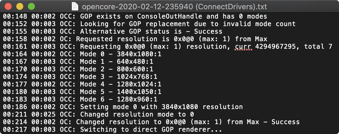

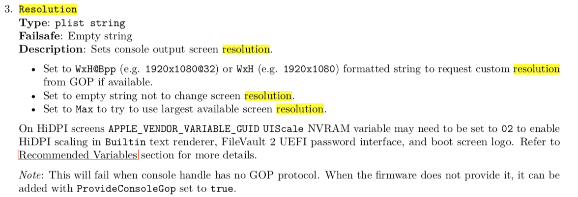

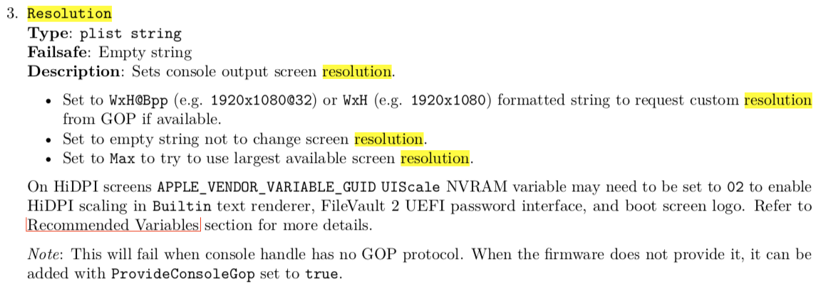

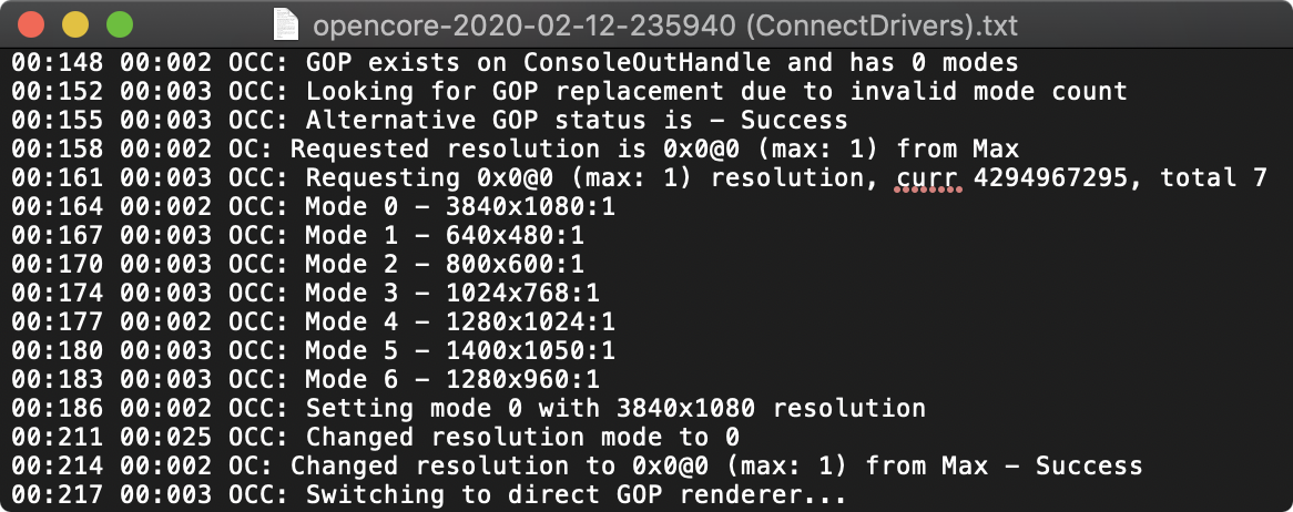

You may try force the resolution to 3840x1080
But if your WX9100's GOP can't do that, then nothing we can do.
For your info, debug mode can log all the available resolutions.
You better use a USB drive to test this resolution settings. In case that cause black screen or system hang, you can simply remove the USB drive and use your current setup.
That NVMe patching is to make it shows up as internal drive.

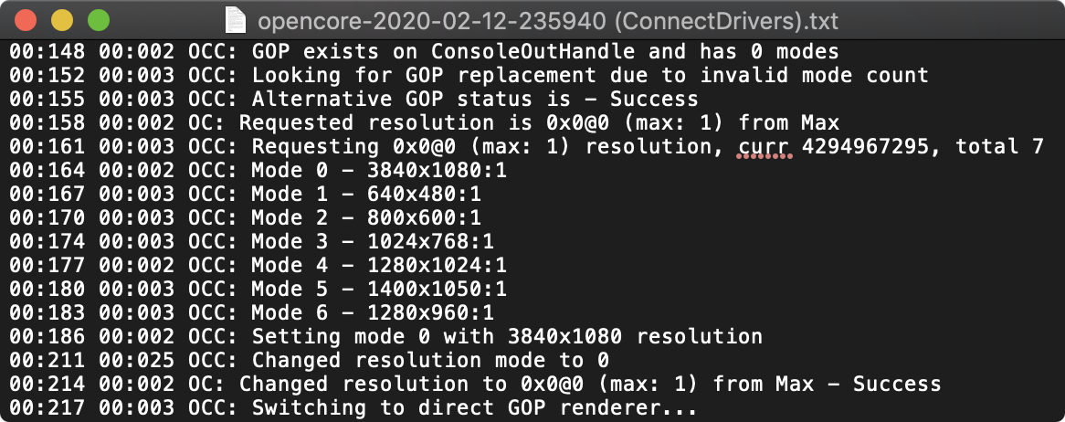

Thank you very much for your answer.
I have already tried to force to the resolution 3840x1080 but unfortunately this did not help.
My log writes the following:
01:300 00:032 OCC: GOP exists on ConsoleOutHandle and has 0 modes
01:311 00:010 OCC: Looking for GOP replacement due to invalid mode count
01:322 00:011 OCC: Alternative GOP status is - Success
01:332 00:010 OC: Requested resolution is 0x0@0 (max: 1) from Max
01:344 00:011 OCC: Requesting 0x0@0 (max: 1) resolution, curr 4294967295, total 5
01:354 00:010 OCC: Mode 0 - 1280x1024:1
01:364 00:010 OCC: Mode 1 - 640x480:1
01:375 00:010 OCC: Mode 2 - 800x600:1
01:386 00:011 OCC: Mode 3 - 1024x768:1
01:400 00:013 OCC: Mode 4 - 1280x960:1
01:410 00:010 OCC: Setting mode 0 with 1280x1024 resolution
01:448 00:038 OCC: Changed resolution mode to 0
01:459 00:010 OC: Changed resolution to 0x0@0 (max: 1) from Max - Success
It seems that the Radeon Pro WX9100 doesn't work with this resolution... It's a pity, but it's only an esthetic point and the actual (the boot screen) works very well. So I am very satisfied for this.
Thank you for your help.

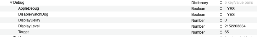

Interesting... 0.5.8 release version provides some debug logging when logging is enabled. No need to replace with full debug version for troubleshooting.

AFAIK, the icon assignment base on the drive's name.
If it contain the word Mojave (or may be part of it), then will use Mojave icon, otherwise, macOS icon.
You may test if this is correct.
ok, I didn't know that and that makes a lot of sense
@h9826790,
Thanks for the response. What I meant was the actual set of icons from where those two specific ones came from originally.
The TimeMachine and Windows icons look different from the others in your image and I presume they came from a specific set.
