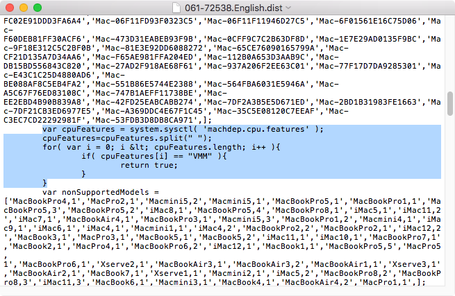

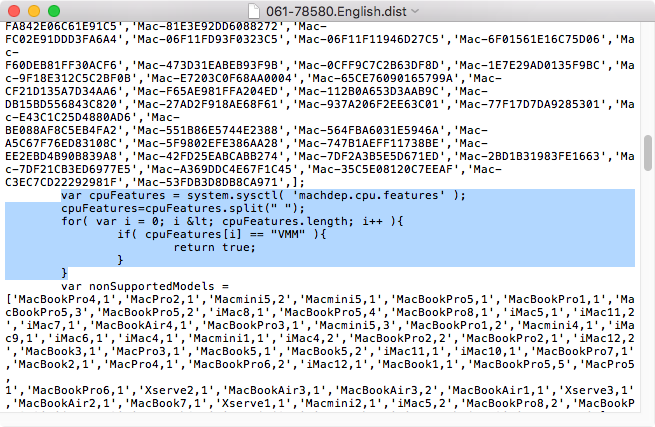

Has anyone tried applying the 10.15.5 update natively? I've setup 2 config.plist files, both identical, except one has the VMM flag enabled, the other not. Booted with the VMM flag on, and got the prompt for the update. After selecting to download and reboot, it initially goes to the applying the update Apple logo with progress bar screen, it advances something like 5-10% and then reboots, which gets back to the OC picker, and choosing Catalina (vs. Mojave or Win10) back to the desktop and Software Update noting 10.15.5 is available. This just continues to repeat the same cycle. Changing back to my normal config (VMM off) and the update prompt is there, but when selected it just immediately reboots without the Apple logo/progress bar screen. Did they build some logic in this update to bork OC/cMP implementations of Catalina?
Wouldn't it be easier to have a community based 4,1/5,1 cMP Open Core EFI folder on github?
Sure, but what I'm proposing is to simplify/facilitate for newbies, not for the advanced users.
Newbies don't even know how to download from GitHub.
Distribution file has the exact same VMM test as before, nothing changed:
10.15.5 Combo (061-78580):
10.15.4 Combo (061-72538):
