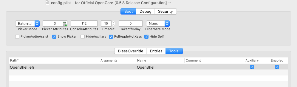

Graphical depiction of OpenCanopy settings for OpenCore 0.5.8 and 0.5.9 on MacPro 5,1 these correspond to settings in the Boot section of config.plist.
You can also see that in the Tools section of config.plist I have enabled OpenShell.efi to appear on the BootPicker screen as an option by unchecking HideAuxiliary (making it false) and adding OpenShell.efi to the Tools section of config.plist and checking (making true) Auxiliary and Enabled in config.plist. OpenShell is a nice tool for exploring the pre-boot environment. It is part of the UEFI standard.
For a manual of commands available with OpenShell go to the UEFI website.

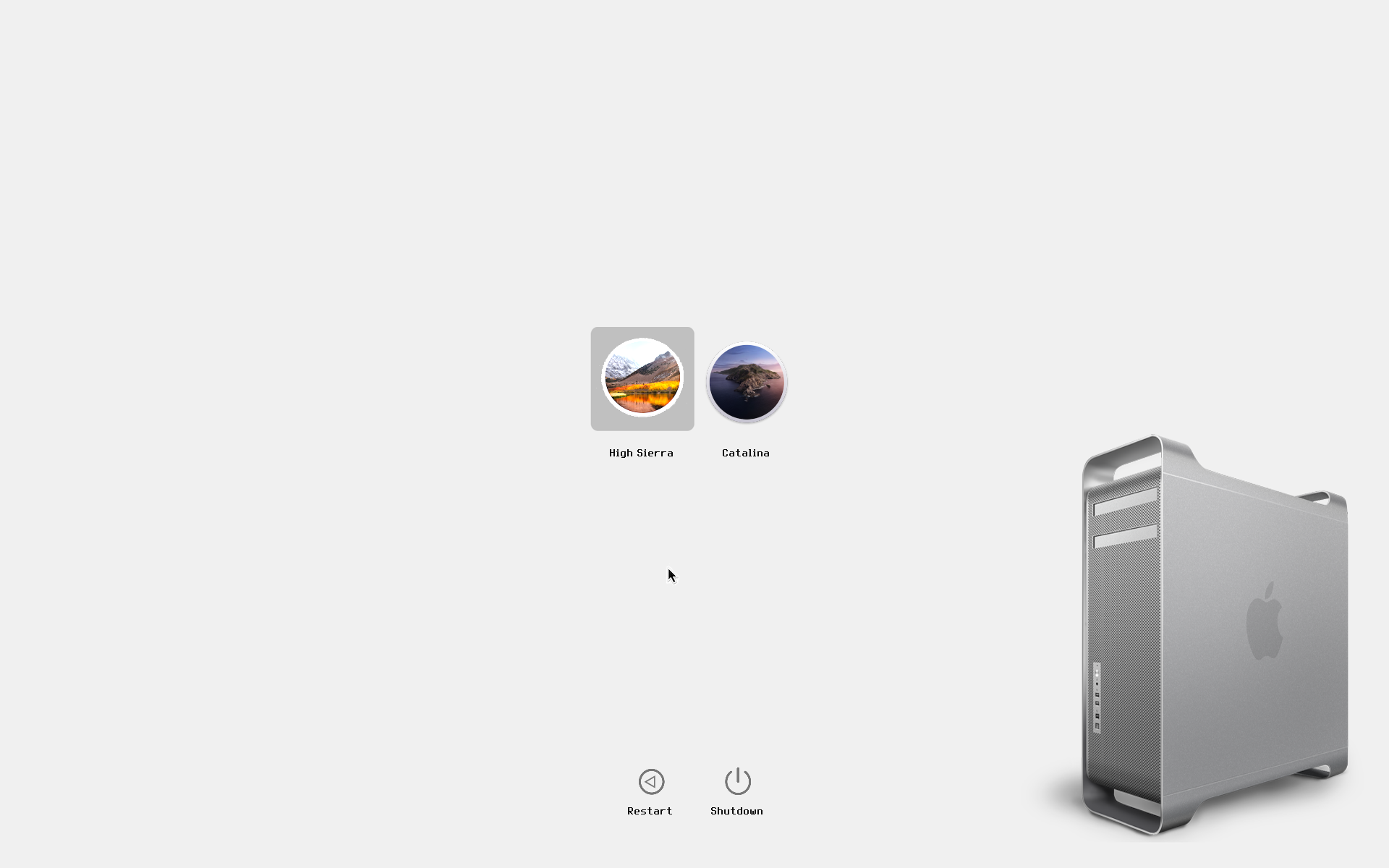

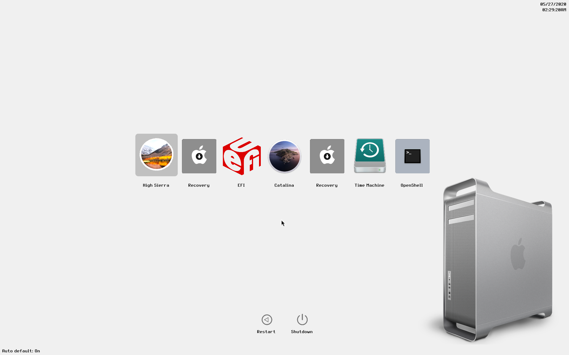

Attached are screenshots showing OpenCore 0.5.8 with NDK BootPicker v1.8
At this time I have found there is greater flexibility in NDK vs OpenCanopy for displaying different icons for operating systems and auxiliary tools.
Note the first screenshot is the default BootPicker screen.
Screenshot 2 is seen after pressing the spacebar which reveals the additional selections.
Screenshot 3 shows the auxiliary tool I have included in the UEFI drivers section OpenShell.efi, its appearance is controlled by HideAuxiliary in MISC | Boot | HideAuxilary (false). The NDK BootPicker icons were customized.
