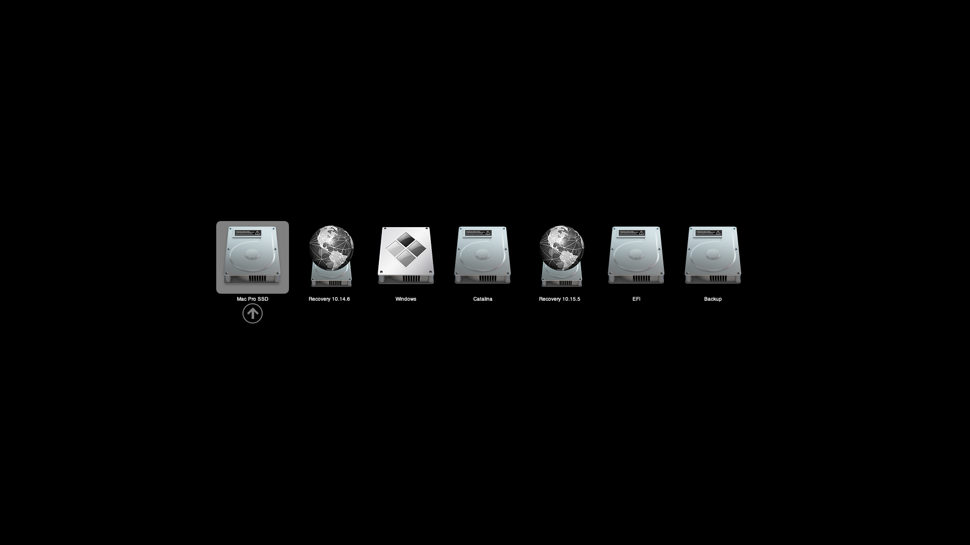

hi guys!
Update to 0.5.9 went flawlessly, OpenCanopy is visible, fantastic work!
Right now I'm searching teh internet and this thread to find how to add to OpenCanopy Recovery and Reset Nvram to be visible in the Bootpicker menu. I read the manual. Could someone point me in the right direction please?
Also, my usb mouse is very choppy and inaccurate in OpenCanopy, can I fix this somehow?

Hi, I managed to make Recovery partition visible in OpenCanopy but sadly my apple usb keyboard isn't working.
I activated KeySupport but still no response from keyboard in OpenCanopy.
Somehow keyboard started working, dunno why... ?

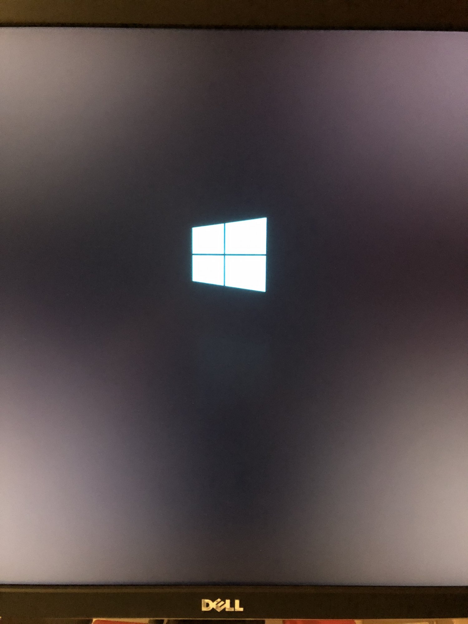

Edit: After rebooting 3 times into Windows, the freeze issues made surface again.
Exactly. I could not confirm the fix proposed by @vit9696. The problem is something else. It is also not related to the partitioning. If you install Windows by following the guide, you will not not get those extra partitions. However, the issue still exists. In fact, the issue has existed since day 1:
There's something flakey in either OC, my configuration of OC, or Windows itself which will eventually result in your Windows installation failing to boot.
So the issue exists with three installation methods: dism (as in the guide), VirtualBox and direct installation.

I've something interesting to report.
The keyboard in BootPicker doesn't work when my Windows Legacy Sata HDD is inserted.
Keys works just fine when I unplug the Windows Hdd.
Everything is working fine otherwise, I hope the keyboard will start working when I'll convert Windows Legacy to UEFI.
Solved: It is the usb 3.0 hub to blame, I connected the keyboard directly and it works every time.

Well, the issue also happens on the first reboots after installing, before the drivers are installed. Interestingly, the issue eventually becomes very infrequent. OpenCanopy, however, has apparently made the issue more frequent...

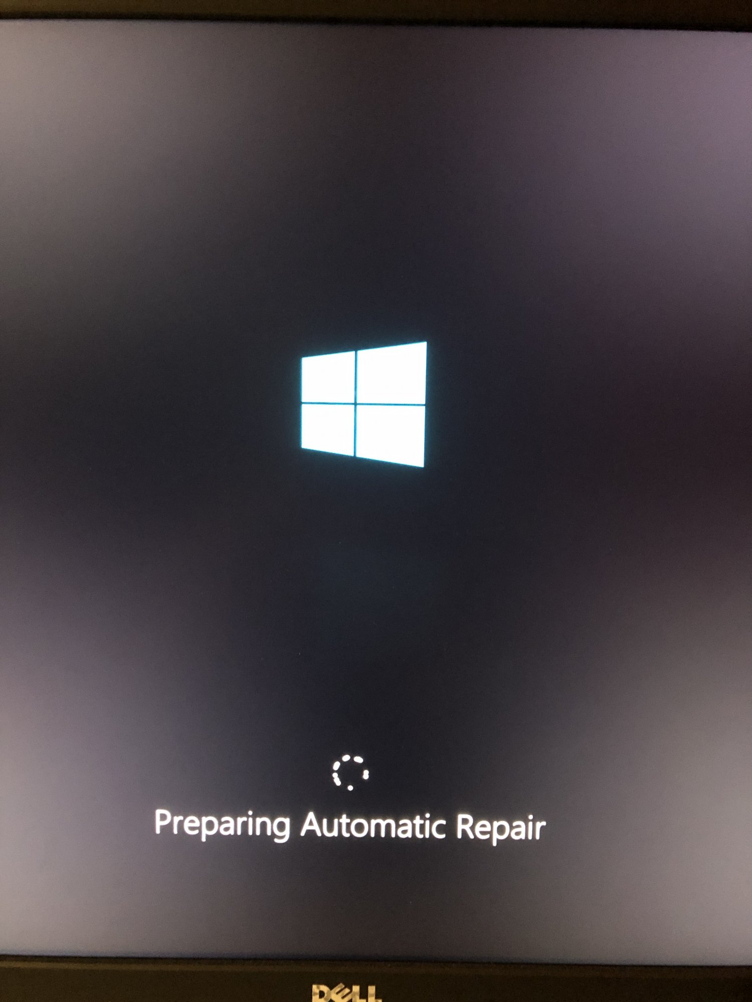

How should we proceed investigating? Even if we are in DEBUG mode, this issue happens after OC, while in Windows.

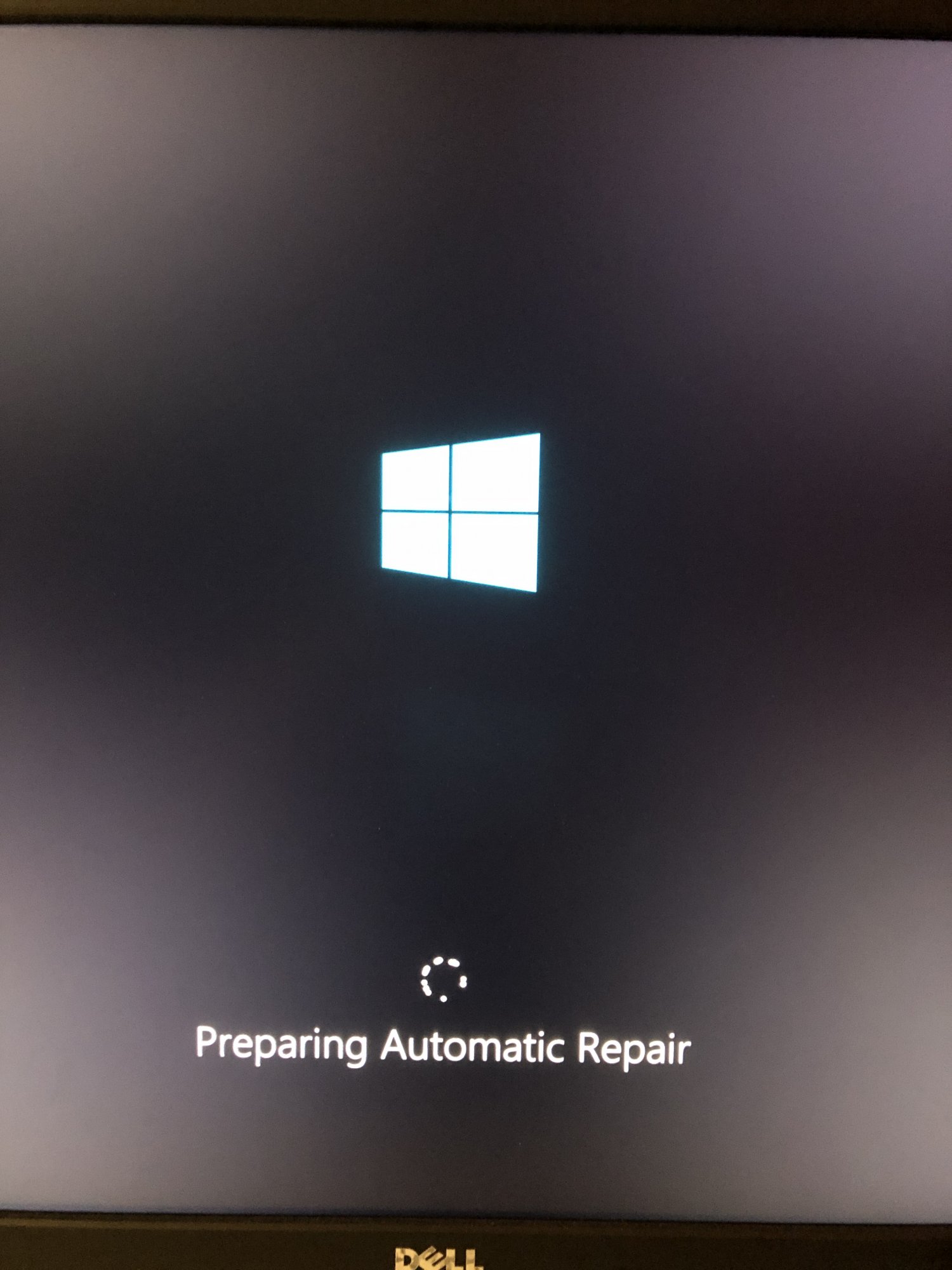

@startergo, when I boot with OpenCanopy, I get an automatic repair and then when I select Continue, Windows freezes. I left it there for 15min, is dead alright. The only fix I have is to disable OpenCanopy and re-install Windows.
Unfortunately, nothing in the logs indicates the issue. Neither FirmwareFeatures (for UEFI Windows boot support) nor ExitBootServicesDelay has helped. Because there are no boot failures at all with macOS or Linux, I believe the issue is Windows...
I've reinstalled a few times. Although infrequent (in my case), the issue is always there.
You need to get in safe mode with networking and update the video drivers.
