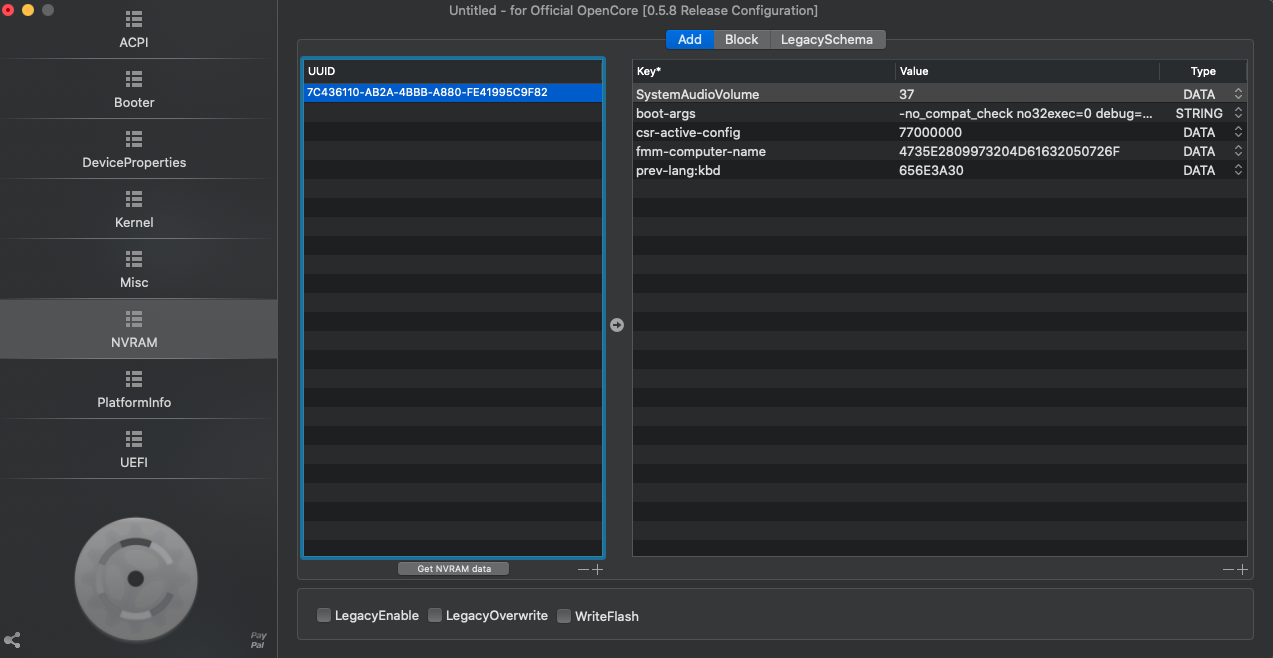

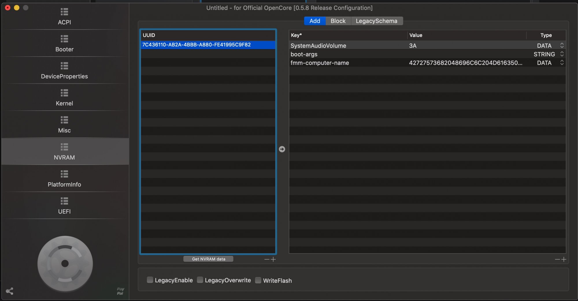

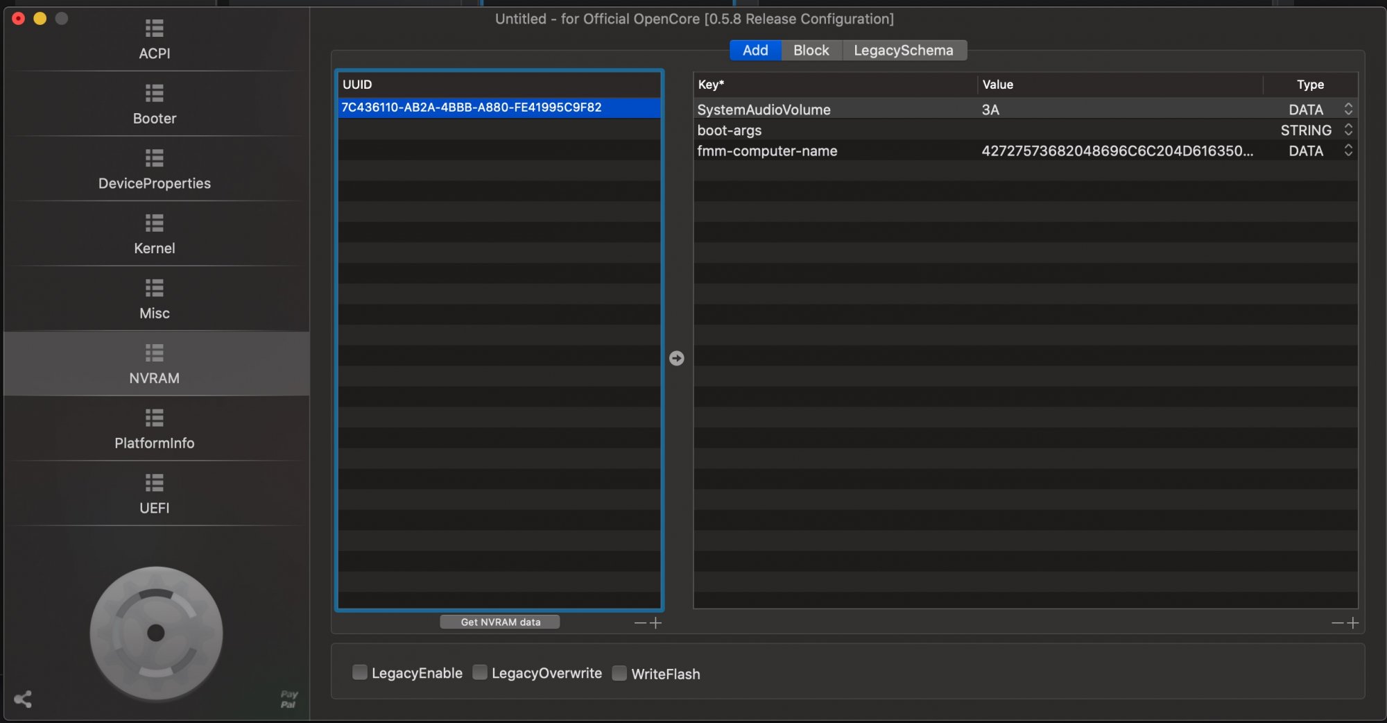

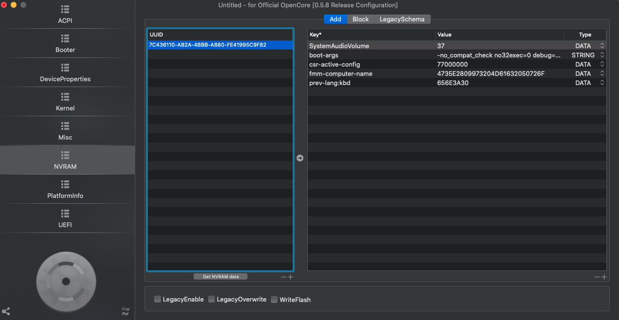

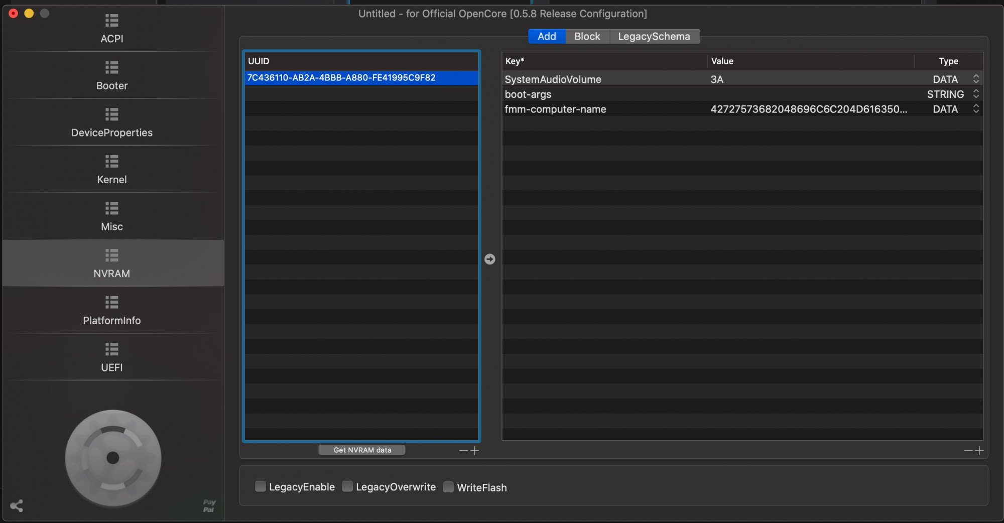

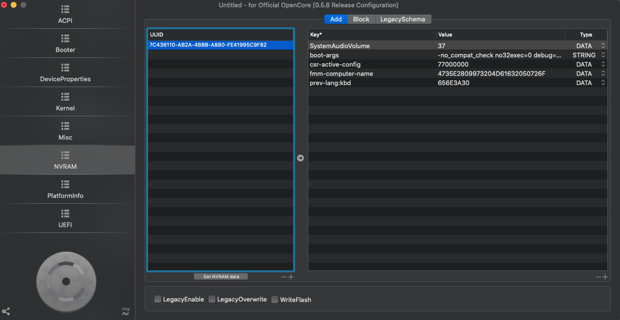

In OC configurator you can query the current nvram data and system volume :
Get NVRAM data drop down menu at the bottom left.
Reactions: octoviaa
mangombia
macrumors member
Jun 12, 2019
84
16
Nashville, Tennessee
This is what I get when invoking that command:
[automerge]1591145125[/automerge]

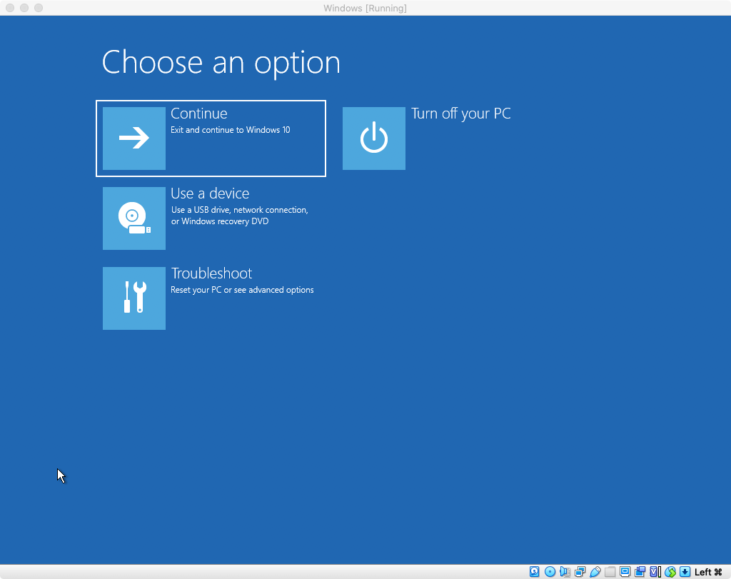

And when I try and bring up OC config.plist with OC Configurator I get a popup warning that the "Bootloader looks like it is not installed or the NVRAM is not native."

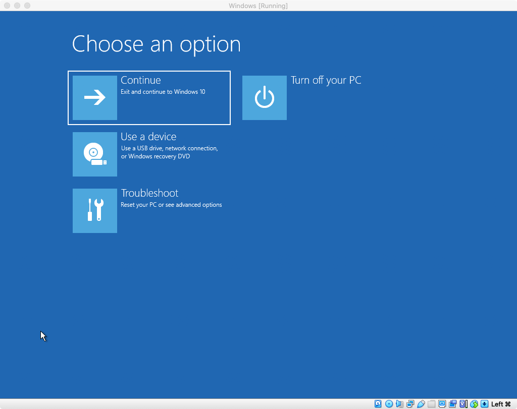

TECK
macrumors 65816
Nov 18, 2011
1,129
478

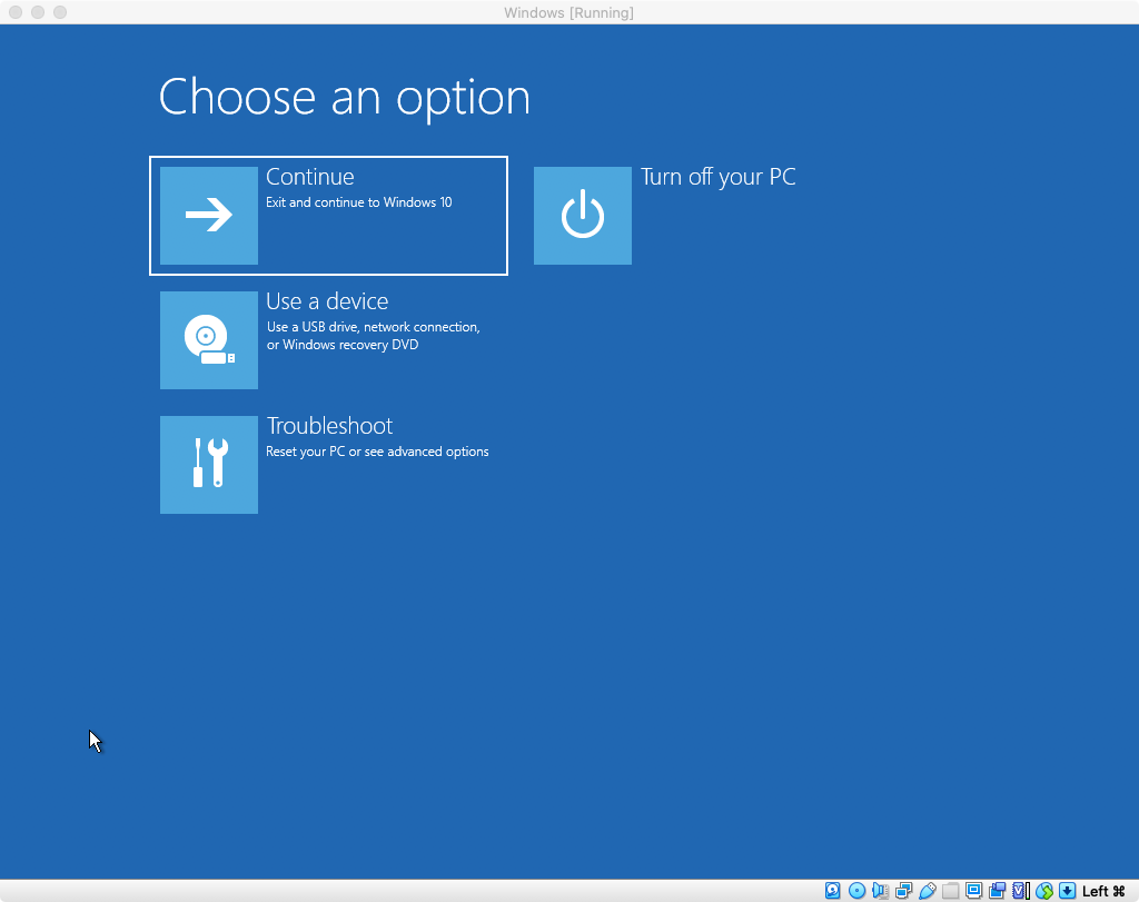

You need to get in safe mode with networking and update the video drivers.
The video drivers are latest from Windows Update so I can use my 4K screen, I was using the text bootpicker before which does not have any issues. Right now everything is fuxored so I need to either re-install Windows again clean or to a system wipe, which will leave the drivers in place but get rid of personal information. Is unfortunate I cannot use OpenCanopy but I'm using Windows every day so I will get back to text bootpicker.
Is the safe mode freezing in OpenCanopy as well? Loading in VirtualBox?

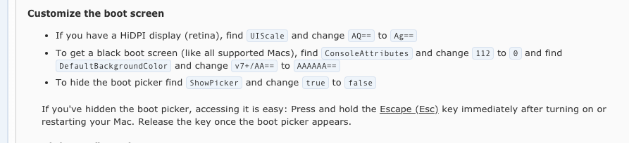

Also when setting the config for HiDPI displays, what exactly does this do? I can still set retina scaling for my 4k display in system preferences, is it just a cosmetic boot screen option?
Correct, that's for the loading screen (and boot picker etc).
Once you boot to the OS, you can set whatever resolution you want in system preferences.

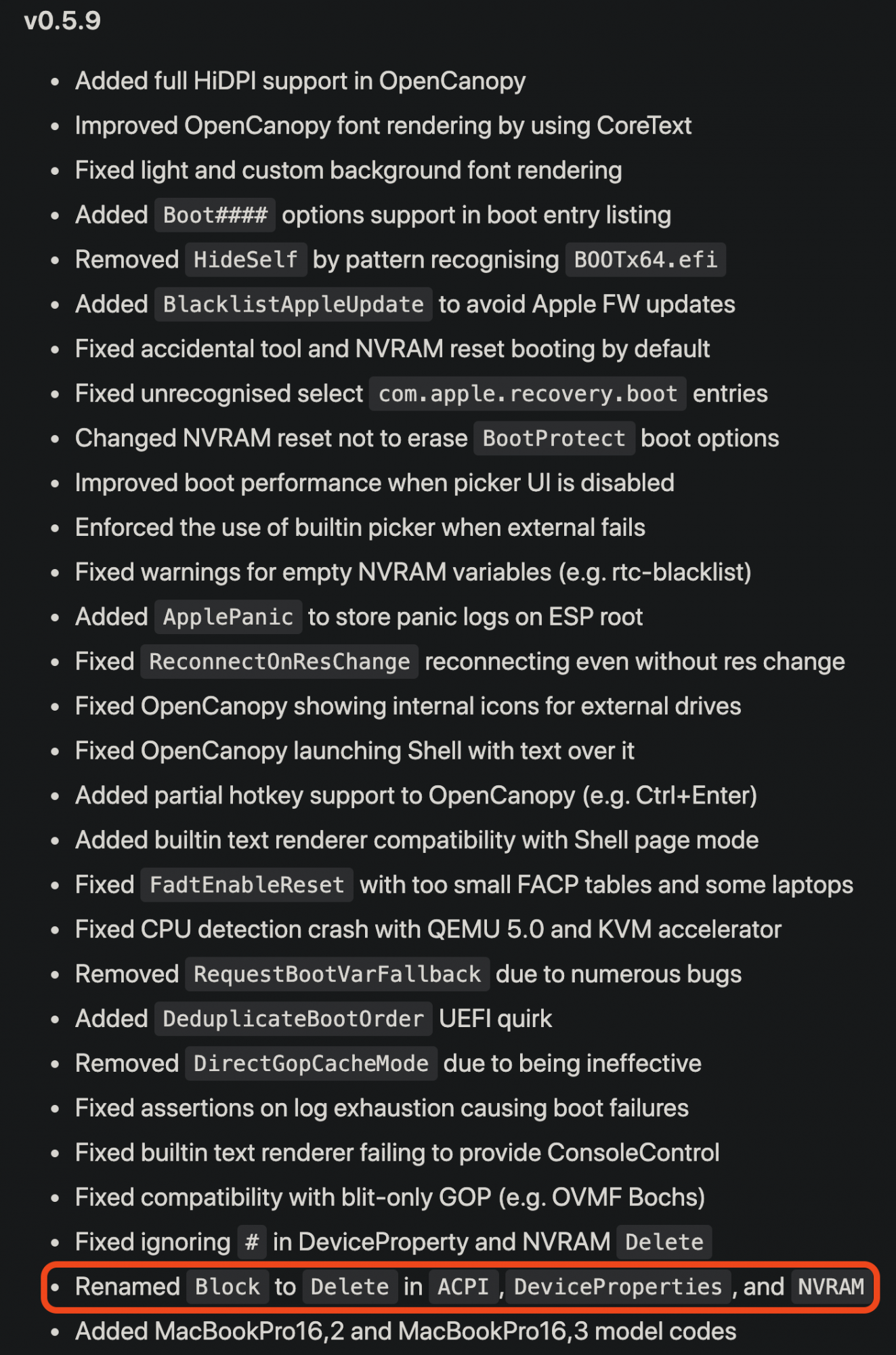

Hi again!!
I'm updating from OC 0.5.8 to 0.5.9 my own Mac Pro 5.1 (the other that tonight don't boot fine and solved is of my wife) and I have a doubt:
In the config.plist of 0.5.8 I have this:

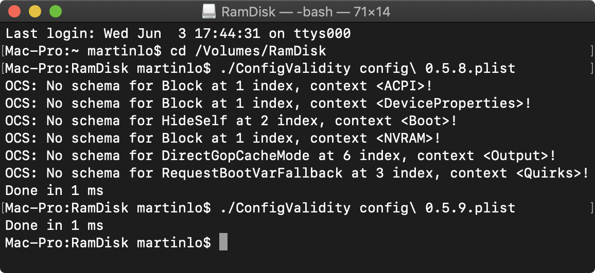

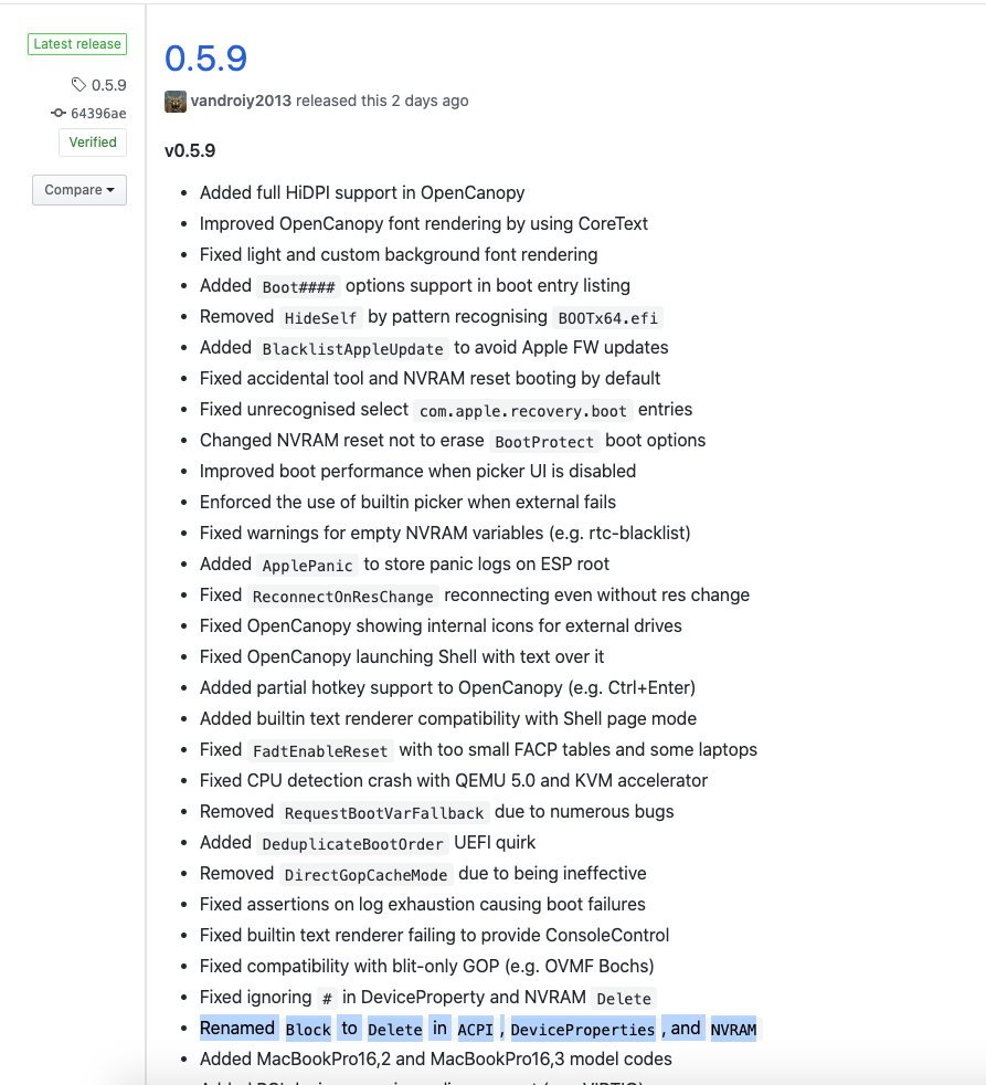

But, in the config.plist of 0.5.9, the key Block is changed for Delete... this is correct??
May I write this on the 0.5.9 config.plist?

It is a change from previous version
I had a same problem as you
Try the vanilla config.plist for 0.5.9 first

I don't know how to start in safe mode with OpenCanopy. In VirtualBox it loads the repair.
It is in troubleshoot.

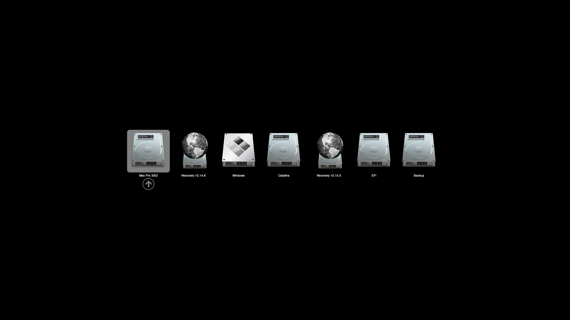

I cannot boot from Windows into macOS anymore using bootcamp "restart your mac in macos"
Can you try pointing to the actual Mac drive rather then using "restart your mac in macos"
[automerge]1591177415[/automerge]
Yes
Norbert Mikołajczyk
macrumors 6502
May 26, 2016
346
171
Yes, there is one macOS drive visible (there should be visible 2 maOS drives?)
No matter what I select and how I restart it still boots back to windows.
Maybe I should reinstall the newest Bootcamp 6.1?

Code:
<key>NVRAM</key>
    <dict>
        <key>Add</key>
        <dict>
            <key>4D1EDE05-38C7-4A6A-9CC6-4BCCA8B38C14</key>
            <dict>
                <key>UIScale</key>
                <data>AQ==</data>
                <key>DefaultBackgroundColor</key>
                <data>AAAAAA==</data>
            </dict>
            <key>7C436110-AB2A-4BBB-A880-FE41995C9F82</key>
            <dict>
                <key>boot-args</key>
                <string>agdpmod=pikera shikigva=80 mbasd=1 -wegtree -no_compat_check no32exec=0</string>
                <key>bluetoothHostControllerSwitchBehavior</key>
                <string>always</string>
            </dict>
        </dict>
        <key>Delete</key>
        <dict>
            <array>
                <string>UIScale</string>
                <string>DefaultBackgroundColor</string>
            </array>
            <array>
                <string>boot-args</string>
                <string>bluetoothHostControllerSwitchBehavior</string>
            </array>
        </dict>
        <key>LegacyEnable</key>
        <false/>
        <key>LegacyOverwrite</key>
        <false/>
        <key>LegacySchema</key>
        <dict/>
        <key>WriteFlash</key>
        <false/>
    </dict>
That's one of the changes
And your code looks correct to me.
Anyway, there is a new useful tool in 0.5.9 which is the ConfigValidity utility.
If your config is wrong, it will warn you.
e.g. If I let it check the 0.5.8 config (despite that's 100% correct for 0.5.8, some entries are no longer valid in 0.5.9), it will warn me that Block is invalid in the NVRAM section (and something else).
But if I let it check a correct 0.5.9 config.plist will shows nothing, but just finish the check in 1ms.
