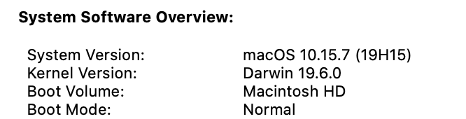

To my surprise this seems to fix it. It's been only 4 months and maybe Apple managed to fix it's Macos :)
Ive done 5 times ... boot ... connect to Caldigit dock ... monitor, usb devices working ... put to sleep ... wait ... disconnect ... wait ... connect, wake up and all seems not to crash.
Need to do this for little longer but in the past it used to crash it almost prompty.
Without apple mentioning it, they might've fixed it :)

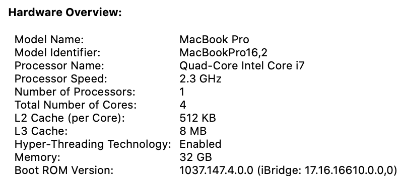

Keep in mind (those beta testers of Big Sur) about month ago i reset T2 so i have Bridge OS firmware as I think it should be for all/majority of users. So 19H15 seems to be fixing it for me.
As suspected. NO change. I did NOT manage to crash it within the 30 minutes but all USB devices do disappear and it is likely to crash (or not work with e.g. my audio interface and/or usb drive).

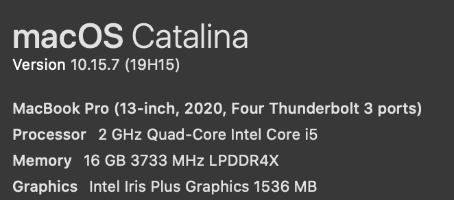

So far I did 3 tests:
  • Unplugged dock, slept the mac and went to sleep myself. In the morning (6-7 hours later) I woke up the mac and plugged the dock - everything worked fine
  • Unplugged dock and slept the mac and went for a shower, so maybe 10-15 mins of sleep. Re-plugging worked fine
  • Unplugged dock and slept the mac, then went out for 20-25 mins, came back and woke the mac - re-plugging worked fine
I would expect the USB devices to not work after 6-7 hours of sleep, and then a crash when unplugging. This didn't happen in any of the cases.
Don't want to get any false hopes up, yet the results are looking good for for my machine at the moment, which is this one:
There is no way to say if the fix is solid yet. Maybe I just got lucky, or maybe they improved it but did not fix it correctly. Otherwise, I cannot explain why other people claim they got instant crashes on this patch and saw no difference.
UPDATE: After another night of extended sleep (~8-9 hours) USB devices were not functional.
I can confirm there are no fixes in this update. :mad:

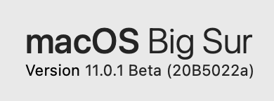

The problem is not with the dock (hubs), it is with the Thunderbolt 3 ports in the MacBook Pro, where you connect the Hubs. Big Sur Release Candidate is available for the public consumption as of last week, you can register at:
Very likely the official release of Big Sur will be this week. I can confirm that the problem is gone after I started using it. I hope this information helps.
I installed the Big Sur beta two days ago and the problem is solved! I'm so happy. The version I have is 11.0.1 Beta (20B5022a). Thanks to those of you who let us know that's is fixed.
