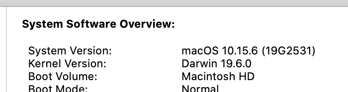

I have installed latest update - which specifically mentions it addresses some WiFi issues and some iCloud drive issues. As i am not home for another 10 days, I can't test if Apple has through fantastic grace and client's focus or through asking few developers to use Thunderbolt docks/monitors addressed the issue.
Version is: 10.15.6 (19G2531)
Hopefully one of you tries it and let us know if after only a month or two Apple fixed the issue :)
thank you !!!
I updated to 19G2531 this evening and have had the same issues we’re all seeing. Kernel panics are still happening when unplugging the dock. Doesn’t appear like theres any fixes in this build which is really disappointing.
