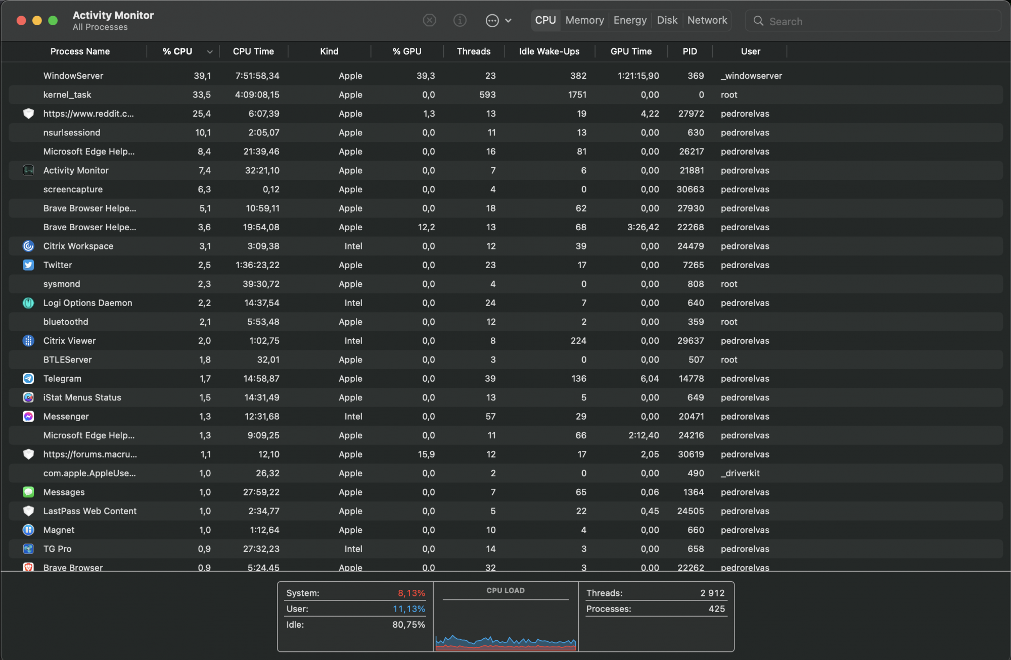

Anything in the background eating CPU? I experienced WindowServer issues (due to playing some videos w/Firefox to be more precise) where a core gets permanently stuck at 100% and leading to 50-55ÂşC constant w/o even doing anything, only solution was to reboot. Check your processes when you hook-up the monitor and/or watching youtube and see if anything abnormal is happening, if not, I'll contact Apple and explain them the issue.

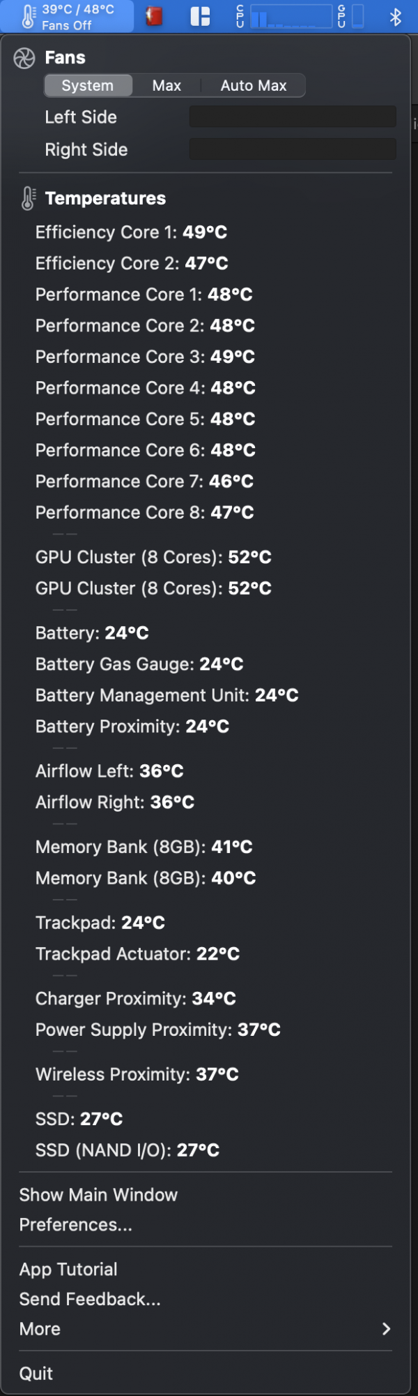

I performed a quick test connecting the MBP to my Samsung 4K TV as promised, and I can see no diff temps from the others shown the other day while doing the same tests playing Youtube videos. I played a Linus Tech Tips video for 15 mins, quality was set at 4K, display was being duplicated so equal footage on both screens at the same time at full screen, here are the temps right after I closed Safari.
Checked also during the video, and temps were similar. Ambient is 20ÂşC. I think you should check Activity Monitor to see what processes are in use or boot in safe mode as @0089294 said and compare if temps are that high even there, those are concerning IMHO (unless your ambient is 45-50ÂşC of course which I doubt)

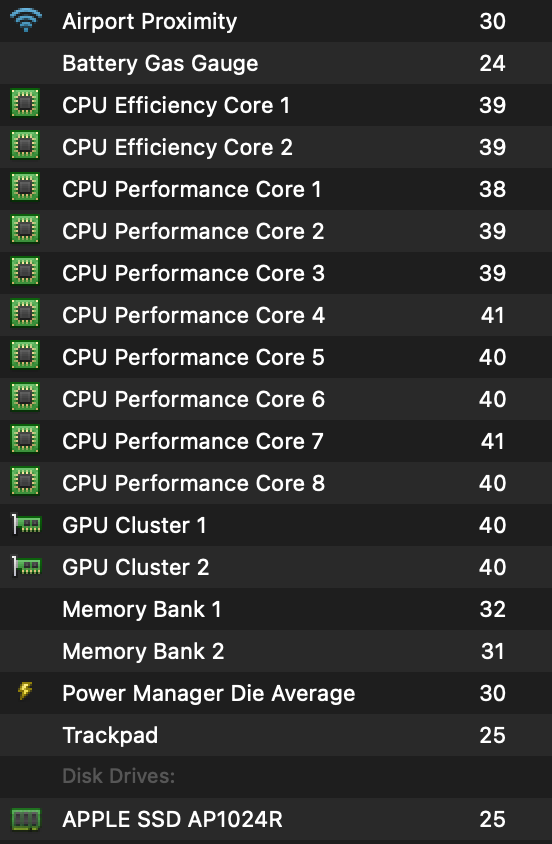

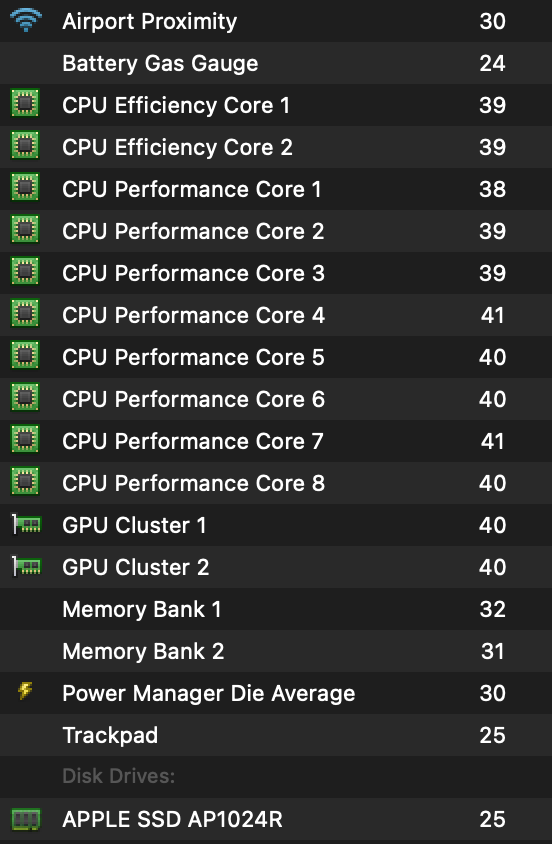

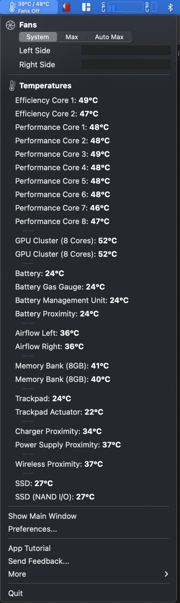

Here's some print screens connected to dual displays Huawei Mateview 4.2k@60hz
Room temperature 24c
Reactions: SirKeldon
View attachment 1931835View attachment 1931836
Interesting results, mine was definitely not with the same workload as yours, and a 4ÂşC ambient difference is a huge impact as well, so I think yours is holding great on temperatures given the fact you're on 2 external monitors (I can see WindowServer cookie monster lol) ... a lot of programs open, a substantial CPU usage and also maybe, the RAM/SSD activity seems to be intense.
Good beast and good thermals IMHO!

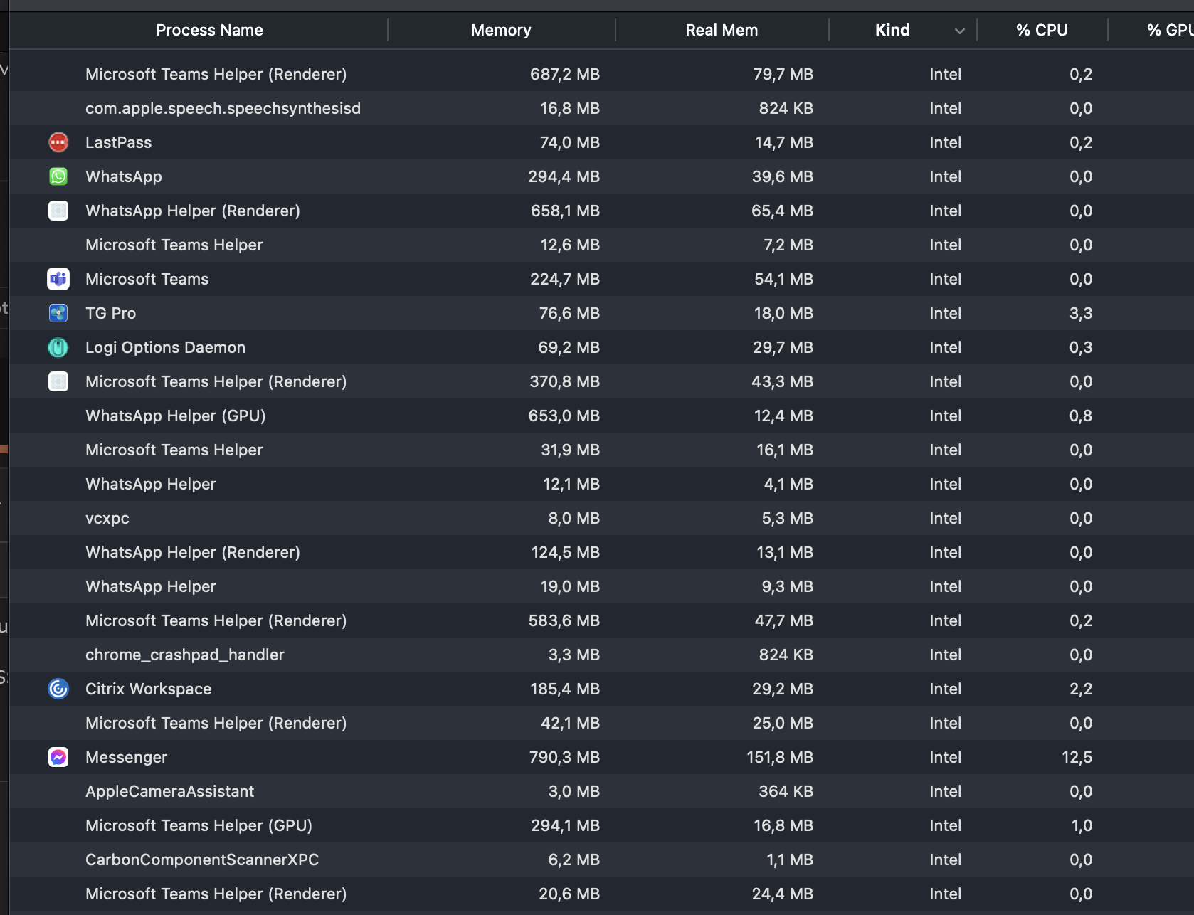

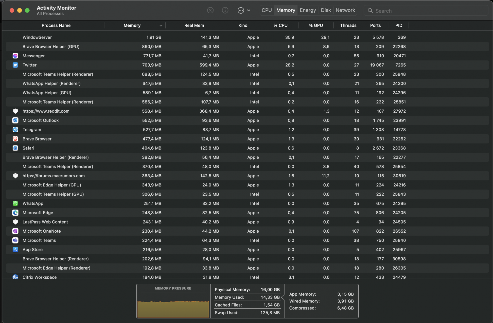

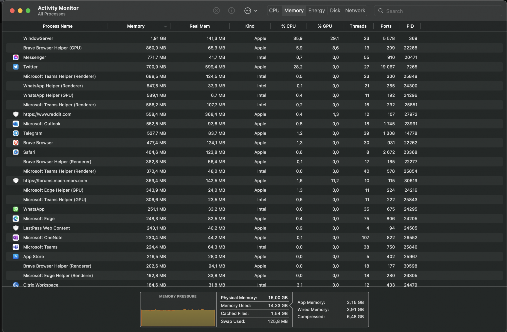

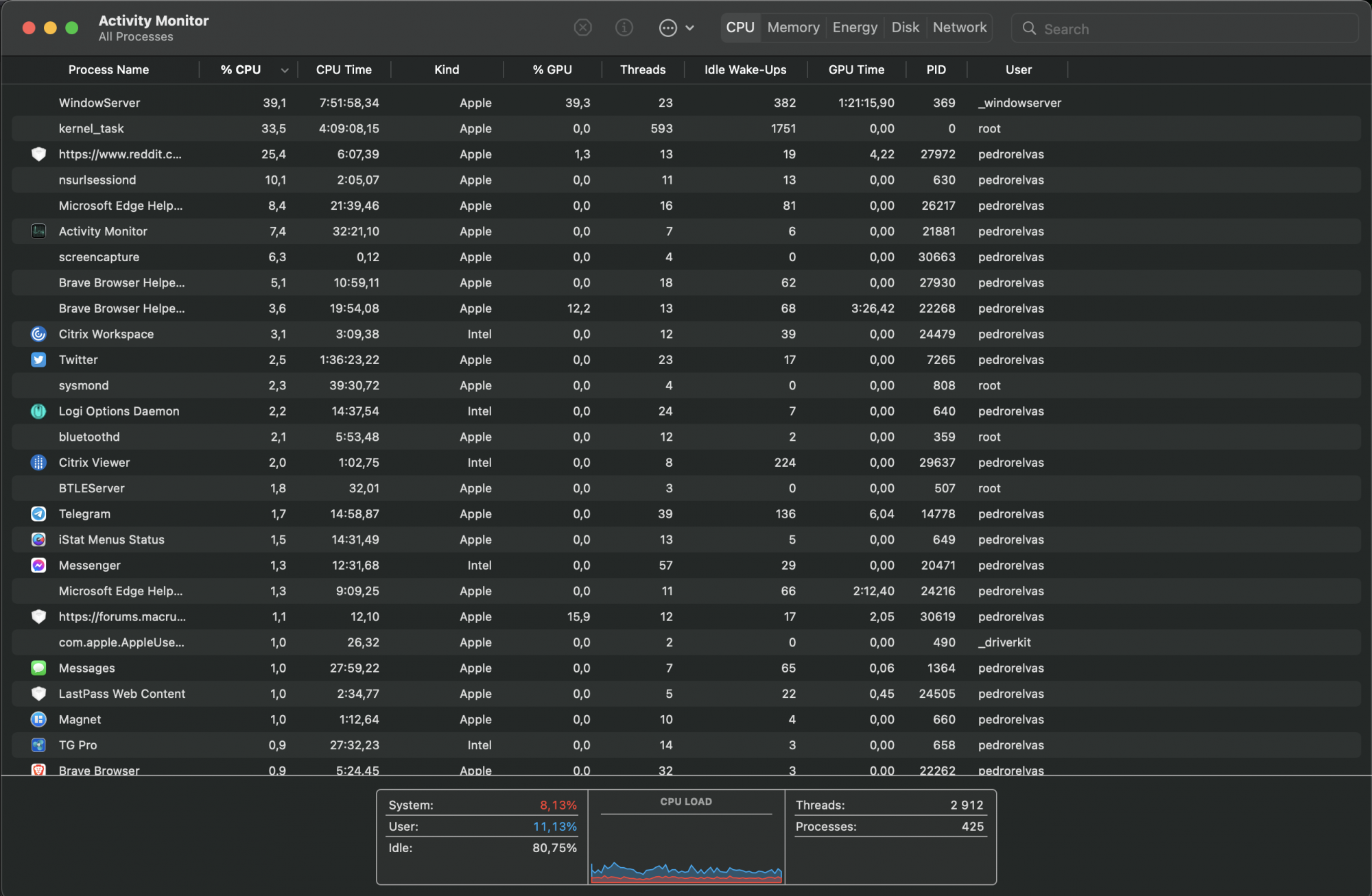

Yeah the problem is that most of my apps aren't still Apple Silicon optimised...
- FB Messenger
- What's App
- Microsoft Teams
These 3 are the main culripts of eating my RAM, just look at this...
