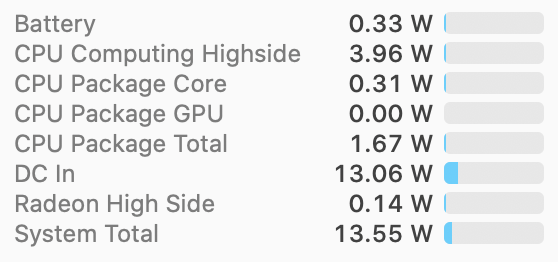

Actually iStat Menus works great for this... one of the bits of information it provides is "system total" power, which indicates how much power the computer is consuming (regardless of source). If I have a Handbrake encode running, it will be 90-100W. Normal use (for me at least) is typically in the 15-50W range.
How much of that is from the battery vs charger? Does iStat break it done? An inline meter would give you the demand on the charger.

Yes, it does break out battery vs. charger. Here are two screen shots, one at idle, and the other with heavy usage. My particular dock is (best-case) limited to 85W, so as you can see it pulls some power from the battery when under heavy load.
