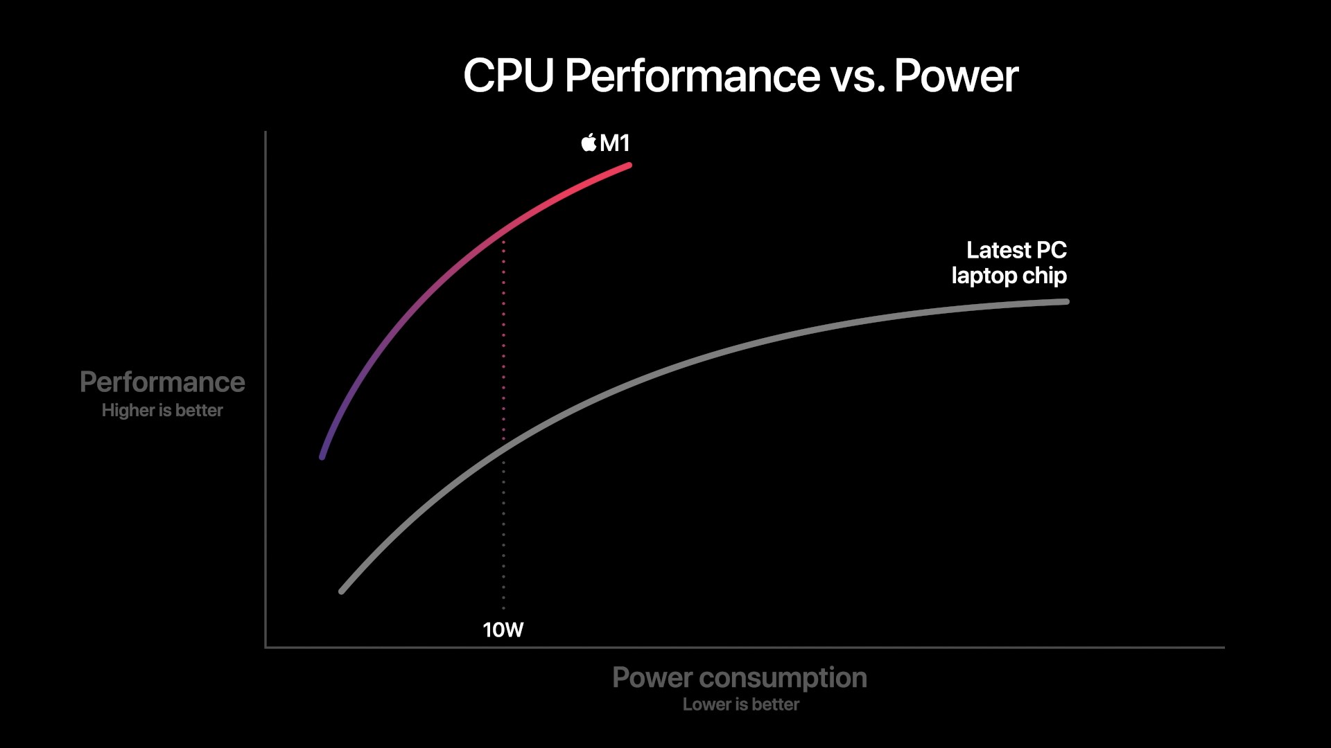

You should know regex is a core feature of Perl. You classify it as "bad" because it doesn't conform to Apple's claims (see Apple's diagram). I showed an independent regex engine, that of Python, also doesn't show that the M1 is superior.

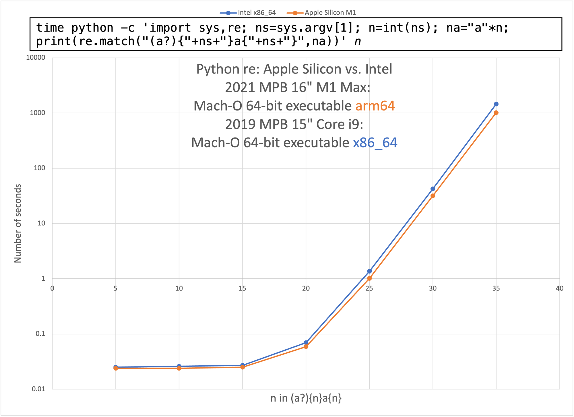

Well, it's not just Perl. Let's look at the same regex matching using Python. Again, I give a one-liner that anyone can run from the Terminal. There is a small gap, but again the M1 Max isn't much different from a 4 year-old 2018 Intel Core i9 (i9-8950HK).

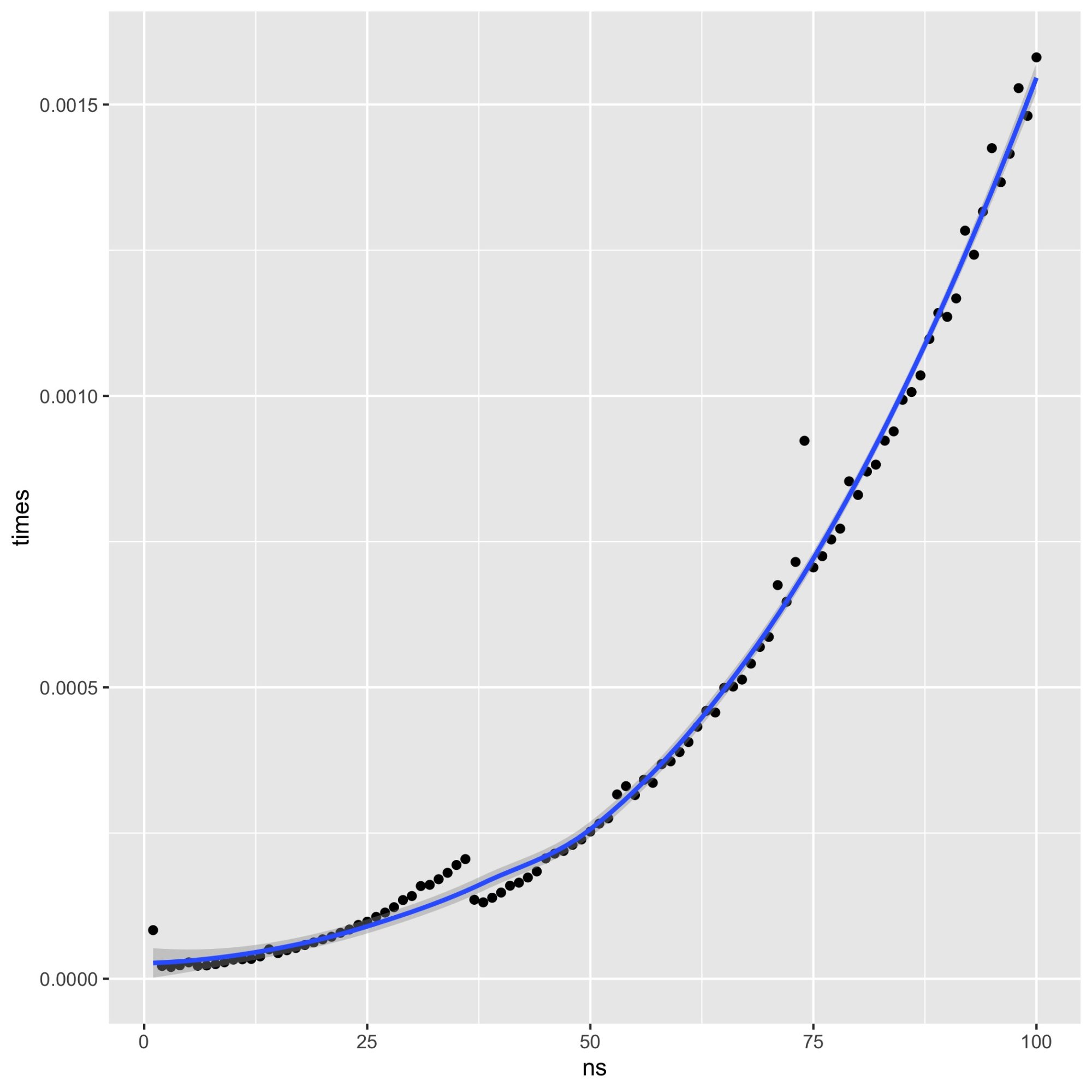

And here is the same regex performance using R's built in regex engine. Didn't run it on the i9. This is just to make clear that you are measuring pathological performance.
The R code was
C-like:
dumb_regex_bench <- function(n) {
  s <- paste0(rep("a", n), collapse = "")
  r <- sprintf("(a?){%s}a{%s}", n, n)
  grepl(r, s)
