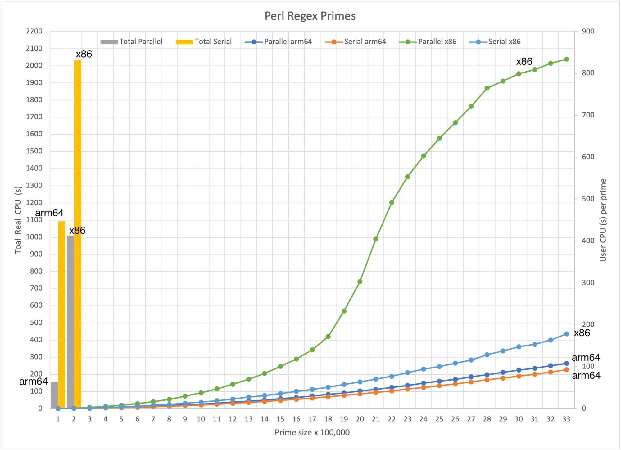

FWIW, running this test on a Ryzen 5800X (which is in general a bit faster than any Intel less than 12th gen) gives me 0.1 seconds at 20, 3 seconds at 25, and 105 seconds at 30. That's on linux with perl 5.36.
The fact that you got identical times with an i9 and an m1 is almost certainly just a bizarre coincidence.
The m1 is in general a better balance of performance and power than any Intel chip. If your argument is "Apple told us the m1 is faster than anything and it's not", then all I can say is maybe you shouldn't take marketing claims at literal face value.
By the way, I dunno if anyone else noticed, but the graph in the original post is a classic example of how to lie with data. @chars1ub0w used a log scale on the vertical axis to compress the two curves much closer together than they would appear in a linear scale graph. Even his own data probably supports M1 being substantially faster than his i9, it just looks much closer than it is thanks to the log scale compression making the data points look closer together than they really are.
Note: If anyone goes back to take a look at that graph, please ignore the first three data points for N=5, 10, and 15. At these low values of N, the regex execution time is so short that it's lost in the random noise of Perl interpreter startup time (which seems to vary quite a bit from run to run) and the UNIX 'time' command's measurement accuracy.
Also: If you step through some sequences of N that are a bit closer together, it quickly becomes evident that execution time roughly doubles each time you increment N by 1, meaning this very weird regex is running in O(2^N) time on many of these regex engines. (Not all - the data @leman collected for R's regex engine still looks like some kind of fast growing curve, but clearly it's not 2^N unless I'm misunderstanding the axes.) This is why this is a bad test of real world performance; nobody actually uses weird regex patterns crafted only to demonstrate that regex engines have edge cases with exponential execution time growth.
Thank you! I was getting desperate here. By the way, I did some tests using real-world regexes with Perl and M1 is 60-70% faster than Intel mobile i9 Coffee Lake (post #55 has more details).
P.S. I can’t believe that I didn’t immediately jump at the fact that the scale is logarithmic… must be getting overworked…

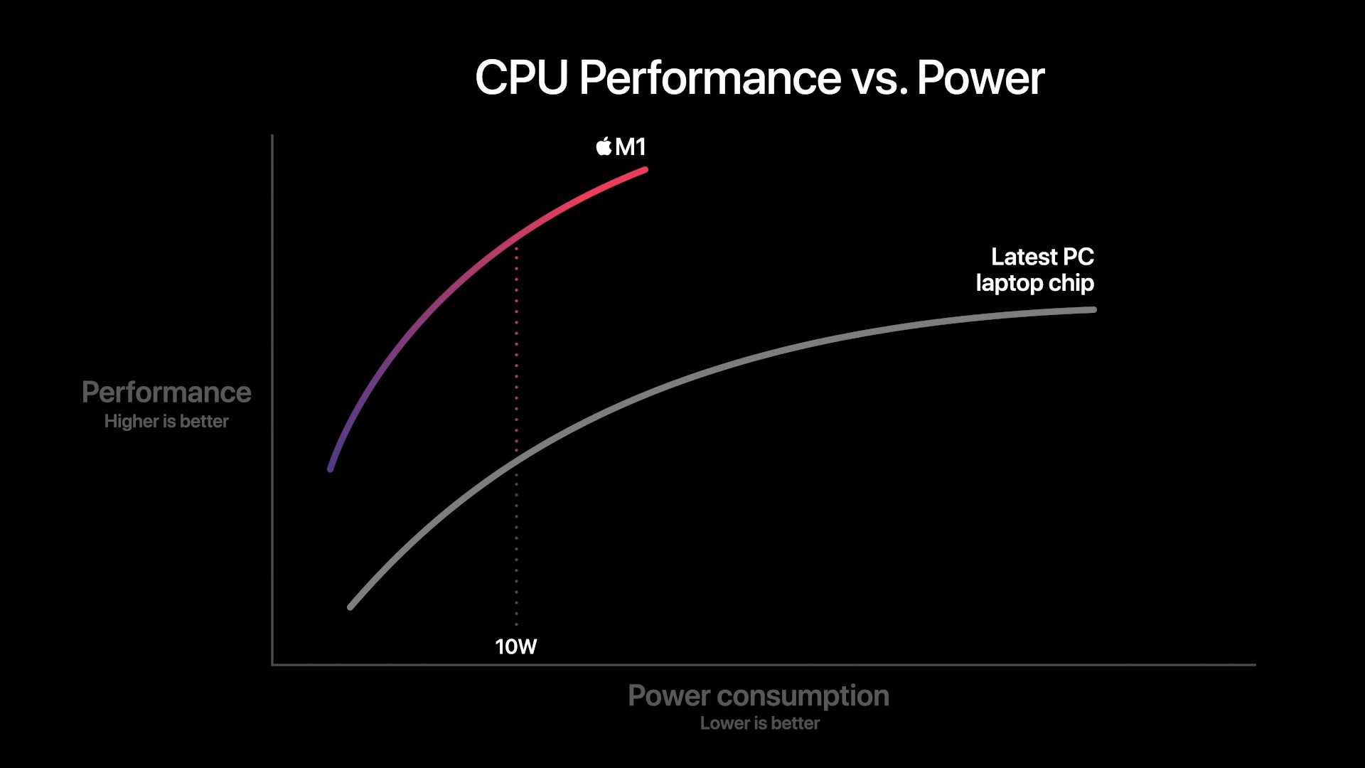

And you would be wrong on both counts. M1 has more cache, almost double the integer processing units and superior branch prediction.
And? Those things are to help efficiency at lower power.
It wasn’t designed for ultimate high end performance as it runs in under 100 watts total system power. Including a GPU that’s actually not crap.
It’s clocked much lower than an i9 and uses far less power.
If Apple was shooting for the ultimate performance with it they’d be clocking it higher and giving it a much larger power budget.
We shall hopefully see this when they put out a pro machine they aren’t containing to 100 watts.
Well, the definition of ultimate performance really depends on what Apple's design goal is I suppose. I really don't think Apple cares too much about being top dog here. They probably have design goal targets and I suppose the current crop of AS Macs met most of their goals with a balance of performance to power/energy used.
Again, I like to point back to the benchmark posted here that shows the M1 Ultra scaling almost linearly compared to Xeons. The latest crop of 13th gen Intel (RL) or Zen 4 AMD CPUs likely cannot compare here. The unfortunate situation that we are seeing now is that the software are not optimised to take advantage of the M1 SoC architecture, which I think is balanced between I/O and processing capabilities. Changing software is hard and costly, so I think this situation will continue for quite a while.
Intel and AMD's approach smells a lot like desperation IMHO, energy usage be damed.
I know you're talking about desktops here but, interestingly, one can view Apple's efficiency goals as tantamount to a desire to be top dog in any device that's thermally constrained, which means mobile devices, including laptops, tablets and phones (which comprise most of what they sell). And that they've achieved (except for laptop GPU performance). For instance, the SC performance of the M2 is higher than that of any mobile CPU.

What do you mean “and”? And the result of it that M1 is 70% faster than i9 on perl regex code. Doesn’t this fact speak for itself?
Of course it’s not designed for “ultimate performance” (whatever that means). It’s still a damn fast CPU that can match or exceed the performance of much larger machines on common code patterns.

OP here. I am glad for the discussion but I am rather disappointed at some of the reactions. First, don't diss Perl regex. It is a fine and very powerful engine that has a lot of history. Nothing's perfect but Perl's strength in regex should be obvious to all - it's well copied, so we have PCRE and other languages have modules that emulate it. That's because regexs are used a lot. Second, the Perl regex test I used is a well-studied problem. I used it here because others can reproduce or dispute my results without installing any software. A one-liner illustrates a data point that I've seen time and time again. The M1 Max is not *significantly faster* in some cases. Third, I am a trained computer scientist. The log graph is commonly used when things get exponential so we can see differences at different levels. Fourth, I said in my original post - "Sometimes I'm not so impressed" with the M1 Max. Sometimes I am not so impressed with the Core i9. I will give an example in a fresh thread (as it will get lost here). Yes, I will use Perl regex again so it's easy for other to reproduce. And you can see a surprising difference (bad for the Core i9).
I am the OP in the recent MBP M1 Max vs. Core i9 thread in which I started off saying "Sometimes I'm not so impressed with my M1 Max MBP 16" (64GB RAM). Sometimes, it seems barely faster than the Core i9 15" (2018) MBP (32 GB RAM) that I also have."
Sometimes I am not so impressed with the Core i9. When I first got my Core i9, I bought two. One Dell and one MBP. Both with 32GB RAM, both with the same Core i9 laptop class processor. Here, we stick to M1 Max vs. Apple Core i9. (I have also just ordered a ThreadRipper PRO 5995WX system and will be testing that.) Rather than this getting buried in the other thread, I'll create a new one here. (Since I want the results to be easily reproducible or challenged, I will stick to Perl regex here, offering another easy-to-run example.)
The regex is a well-known short one /^(11+?)\1+$/, which can be used to determine whether a number (in unary notation) is prime.
Generally, the M1 Max is twice as fast in this case, except in the all-parallel case, the M1 Max is way faster because the x86 blows up (green line). The Core i9 has 6 cores plus Hyperthreading, which is generally worth delta (small improvement, I have lots of testing over the years on research code). The M1 Max has 8 performance cores + 2 efficiency cores. Not so different in my opinion. (The 5995WX has 64 cores and Hyperthreading. And the upcoming Mac Pro should have maybe 40+ cores, but we can't order that yet.)
Here is the serial code (to do the parallel version, just change $p to $p &):
#!/bin/bash
primes=(100003 200003 300007 400009 500009 600011 700001 800011 900001 1000003 1100009 1200007 1300021 1400017 1500007 1600033 1700021 1800017 1900009 2000003 2100001 2200013 2300003 2400001 2500009 2600011 2700023 2800001 2900017 3000017 3100007 3200003 3300001)
TIMEFORMAT='%3U'
for p in ${primes[@]}; do
time perl -le '$n = shift; $_ = "1" x $n; print "$n prime" if !/^(11+?)\1+$/' $p
done
wait
Reactions: Hippocrates
Nobody is dissing Perl. I have also demonstrated that M1 runs real-work Perl reges significantly faster than i9.
It’s might well-studied problem in the theory of non-deterministic automata and because it triggers a corner case in the reges engine as implemented by Perl. It’s probably not a good regex to use for benchmarking because no real world practically used regex is of that type.
Actually, your graph does show that M1 is significantly faster. You just need to account for the fact that it’s a log graph. The i9 runtimes are substantially longer. Your graph focuses on the fact that algorithm scales like crap but precisely because you use a log scale it obfuscates the constant factor. If you are a trained computer scientist then you should understand that a faster CPU cannot magically change the complexity of the algorithm. For example, for n=30 M1 takes 100s and i9 takes what looks like 150 seconds or more - that’s difference of at least 50% more work done per unit of time! If that’s not significantly faster then I don’t know what is. And below n=15 your benchmark is dominated by Perl launch time, so it’s random OS-related noise.
Just a hint: plot the ratio between the runtimes and account for the startup time (check my post for a Perl script that inky benchmarks a relevant code section). Then you will see that M1 is actually faster even for your pathological regex.
This doesn’t change the fact that your post is misleading. When someone browsing the forums opens your thread they see a statement “m1 is not faster than i9” and a graph that seems to support it. But in reality your graph shows exactly the opposite to be true from what you are claiming.
