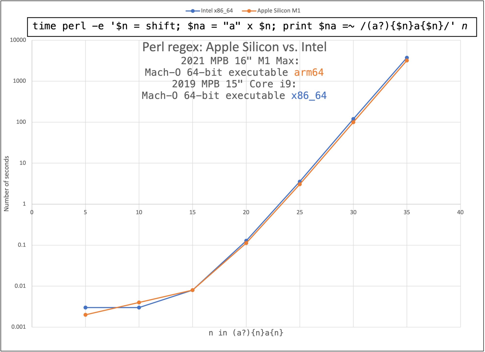

Sometimes I'm not so impressed with my M1 Max MBP 16" (64GB RAM). Sometimes, it seems barely faster than the Core i9 15" (2018) MBP (32 GB RAM) that I also have. I leave one at work and keep one at home, so I rarely compare them side by side. Sure, somethings are perceptively faster, e.g. some Photoshop tasks, but for general tasks, I'm not so sure. So I ran some code that I use for teaching non-determinism. And I'm surprised. The M1 Max and the MBP ran neck and neck on this Perl one-liner. I checked. The Perl executable for the Max is arm64. Perl for the i9 is x86. You can run the same code easily.View attachment 2101246
You’re running perl interpreter code that has had 20 plus years of optimisation for x86.
The magic of M1 is in power efficiency (i.e., doing the same work with less power and getting better battery life and less fan noise) and drastically improving performance in tasks that can make use of the accelerators for GPU and ML.
Your perl one liner is basically worst case for M1.
Also bear in mind that the only difference between your M1 Max and an M1 Pro is the GPU which has zero bearing on this test.
Additionally this task will very likely not be multi-threaded, so the fact that the M1 Max is keeping up at much lower clock speed (Intel CPUs boost hard when only a single core is active (like 4Ghz plus vs. the M1 sitting around 3.2) is pretty impressive. You’d probably get almost exactly the same performance on this test on a base model M1 Air.
Try the same test running 8-10 or more copies of your script in different processes concurrently.

I mean, come on guys. Let’s keep our feet on the ground. The methodology of this “test“ is completely flawed and the results are utterly meaningless (not to mention that we have a poster whose results contradict what OP published). But let’s deal with facts and computer science instead of inventing random justifications.
Please, not you too. It’s exactly this kind of posts that various internet trolls use to talk about “Apple apologists”.
No, Perl is not specifically optimized for x86, it’s regex engine it’s just plain C that should work well enough on anything that dares call itself a “CPU”. And no, M1 is not just about power efficiency, it’s also a really fast, capable general purpose CPU. And how is that one liner worst case for M1? It’s not Cinebench.
I updated my post.
But i stand by the fact that the biggest win for M1 is efficiency, not outright performance. Additionally plain string processing is not what it was design for, as that runs fast enough on a potato in 2022.

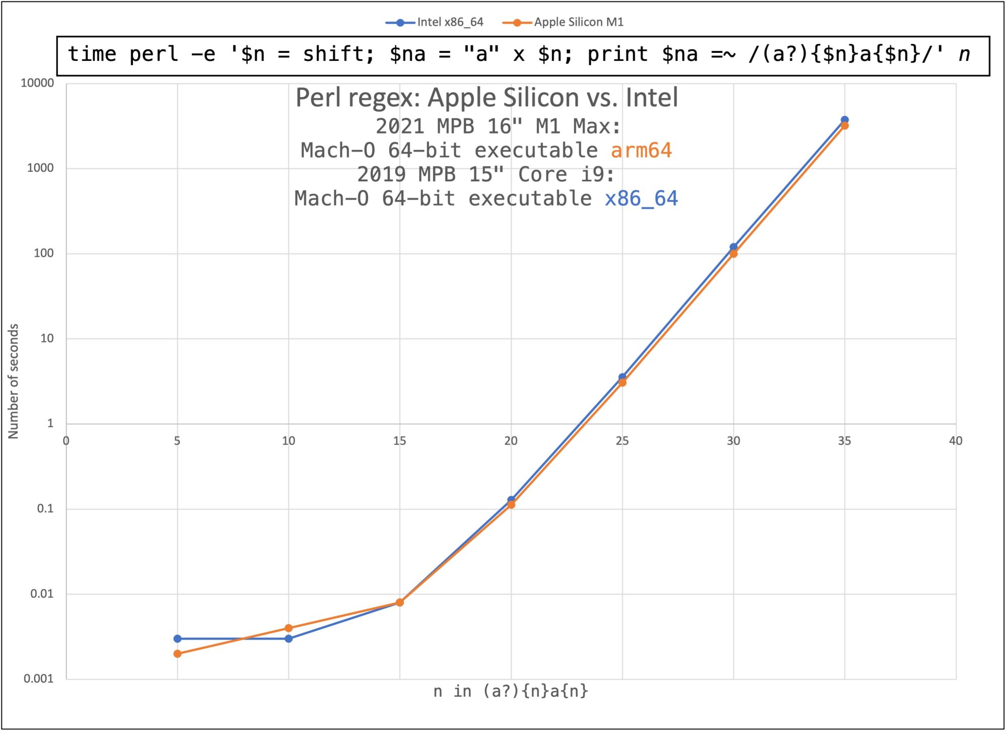

For what is worth, I have now run a simple perl benchmark on both my M1 Max and the 2019 i9 machine. This is matching 100k emails agains a RFC822 regex (taken from here https://www.ex-parrot.com/pdw/Mail-RFC822-Address.html). I preload the data into RAM and only time the regex matching section to equalise the SSD performance (hint: it doesn't matter, the launch + data load overhead is around 40-50ms on both machines). Obviously this is single-threaded benchmark. Code is attached. Pardon my crappy perl, it's the first time ever I tried to use this language.
Results:
M1 - 100ms
Intel i9 - 175ms
Hence, M1 can process 70% more real-world regex matches within the same time unit.
I hope this will put all the silly speculations to rest. Can't believe I had to waste half an hour for this nonsense.
And you would be wrong on both counts. M1 has more cache, almost double the integer processing units and superior branch prediction. It excels in generic integer code like basic regex engines. The only chance for x86 to catch up is to use SIMD-optimized string processing where it has a chance of winning due to longer vectors and higher clocks.
Results:
M1 - 100ms
Intel i9 - 175ms

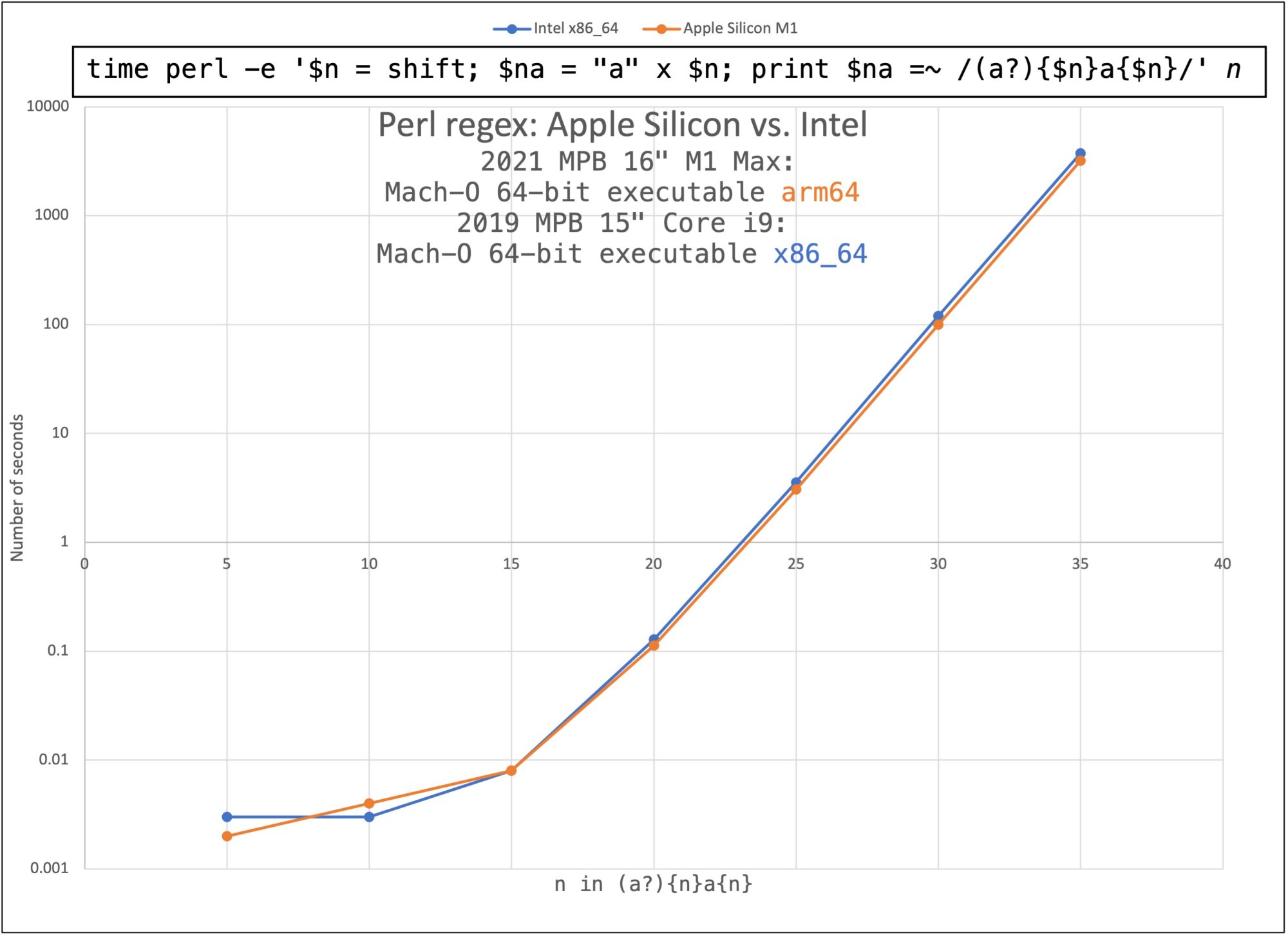

If you run a task that is too simple, the megahertz might matter more. M1 Max runs at ~3ghz. Intel CPUs often boost 4 Ghz+.
IE. If you do a simple string log of "hello world" 1,000,000 times, the Intel is probably going to beat any Apple Silicon because it runs at a higher frequence.
To measure real performance, consider testing something that actually does more than just a one liner.
This is not how this works. Apple Silicon has lower clock frequency, but it has more execution units. Every M1 CPU core for example contains seven integer execution units versus Intels five. Which means that Apple can do 20-30% more integer operations per cycle. And there are many more nuances.
