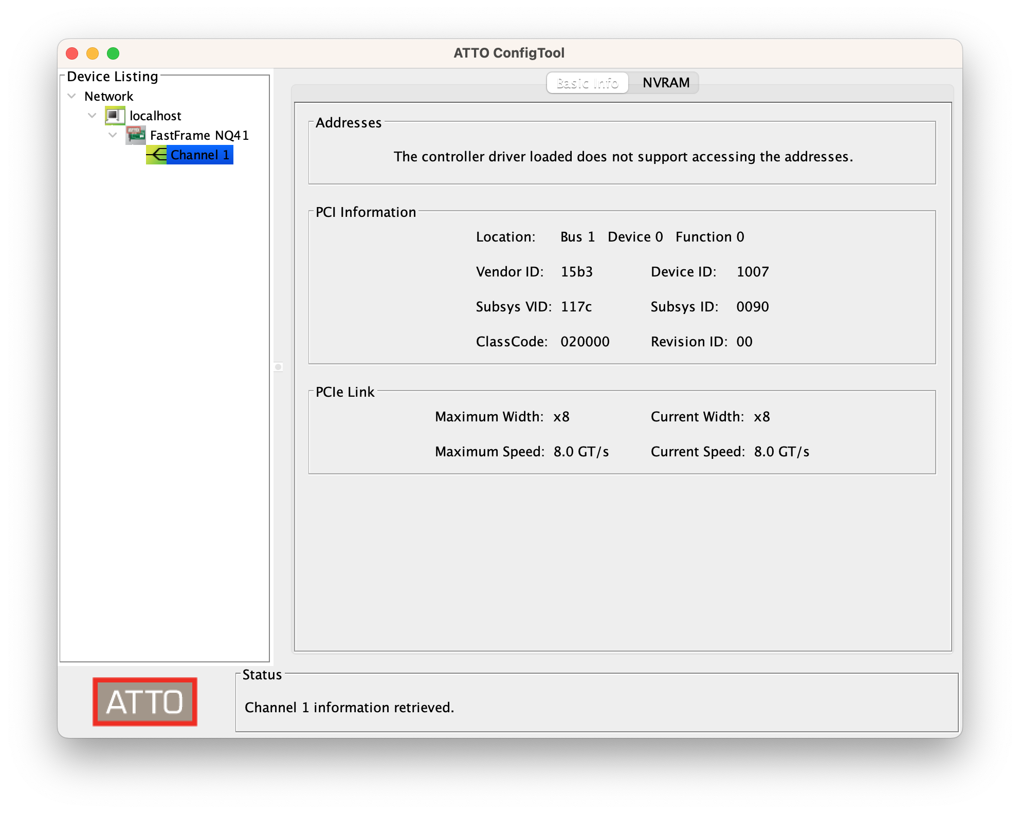

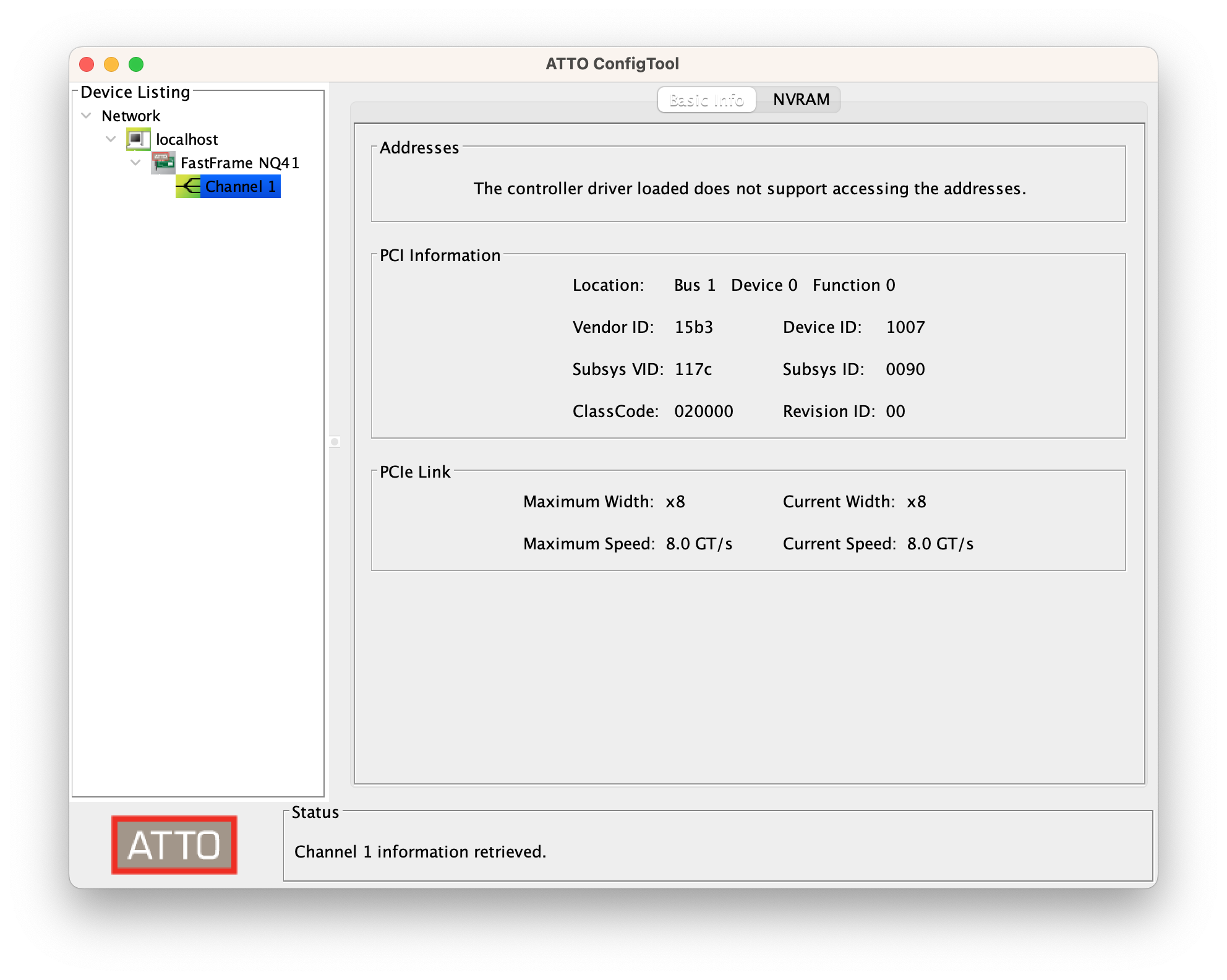

That means you have to desolder the SPI chip, flash it with the ATTO fw, solder it back and the ATTO driver will work. More than one clone means to modify the MAC with a hex editor before burning the SPI chip. The first 2kb of the fw a important !
I never used the lifefish/FNP method, always used a SPI programmer.

I flash ATTO firmware in my Mellanox MCX313 in lifefish mode (closed FNP) and try it in my hackintosh (OS: ventura). It does not work after installing the ATTO Driver.

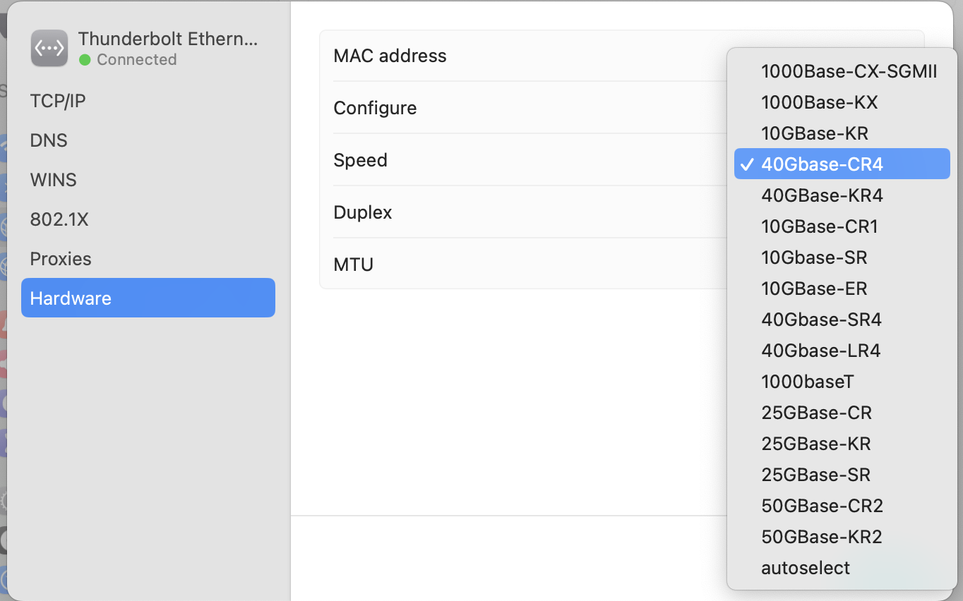

just upgrade to last Ventura, Apple has released 40gb ETH dirverkit, the dext mlx5, according to the VID it supports all the MLX connectX 4 + from 40GB to 200GB (I guess). MTU cannot be set through GUI, but I think `networksetup -setMTU en4 9000` will work. I have no conditions to test if ROCE2 works.

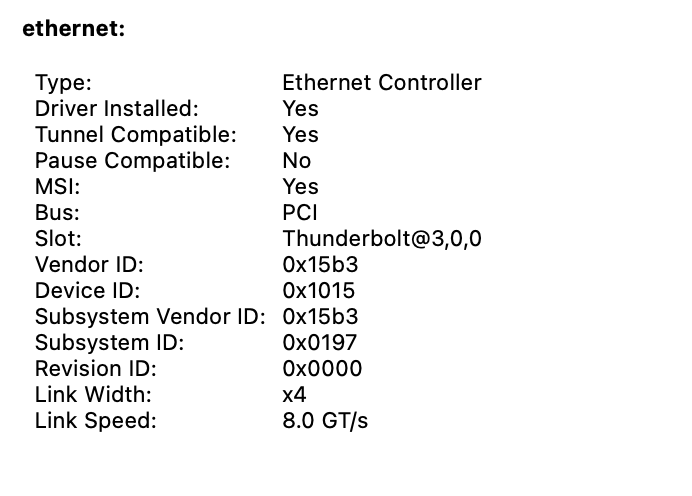

I tried the 25G nic cx4411a acan on Ventura and it worked natively too. However, the MTU was limited to maximum 2034 in settings. Tried the command you provided and it didn’t work. Were you able to set it by any means? Thanks
Did you change ‘en4’ to your actual card name?
Yes, in my case, it’s en7. Did it work for you?
Nope, I have an ATTO card setting MTU from their mgt app. This command is used in general for macos Ethernet. Since the mlx driver is a driverkit(dext), it may differ from others. I have a quick view of this dext, it only have a on/off flag, so we cannot set MTU by adding flag. hope apple could add this function soon
