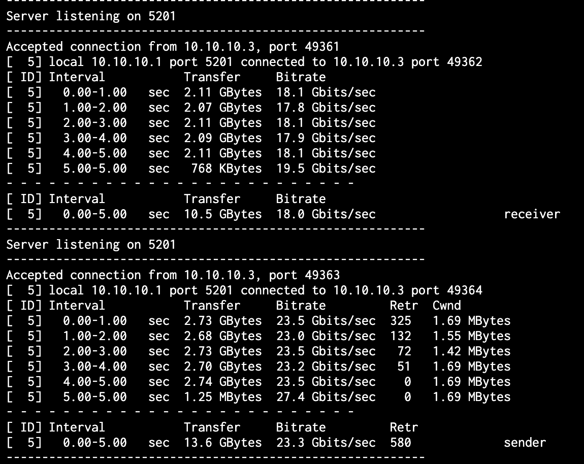

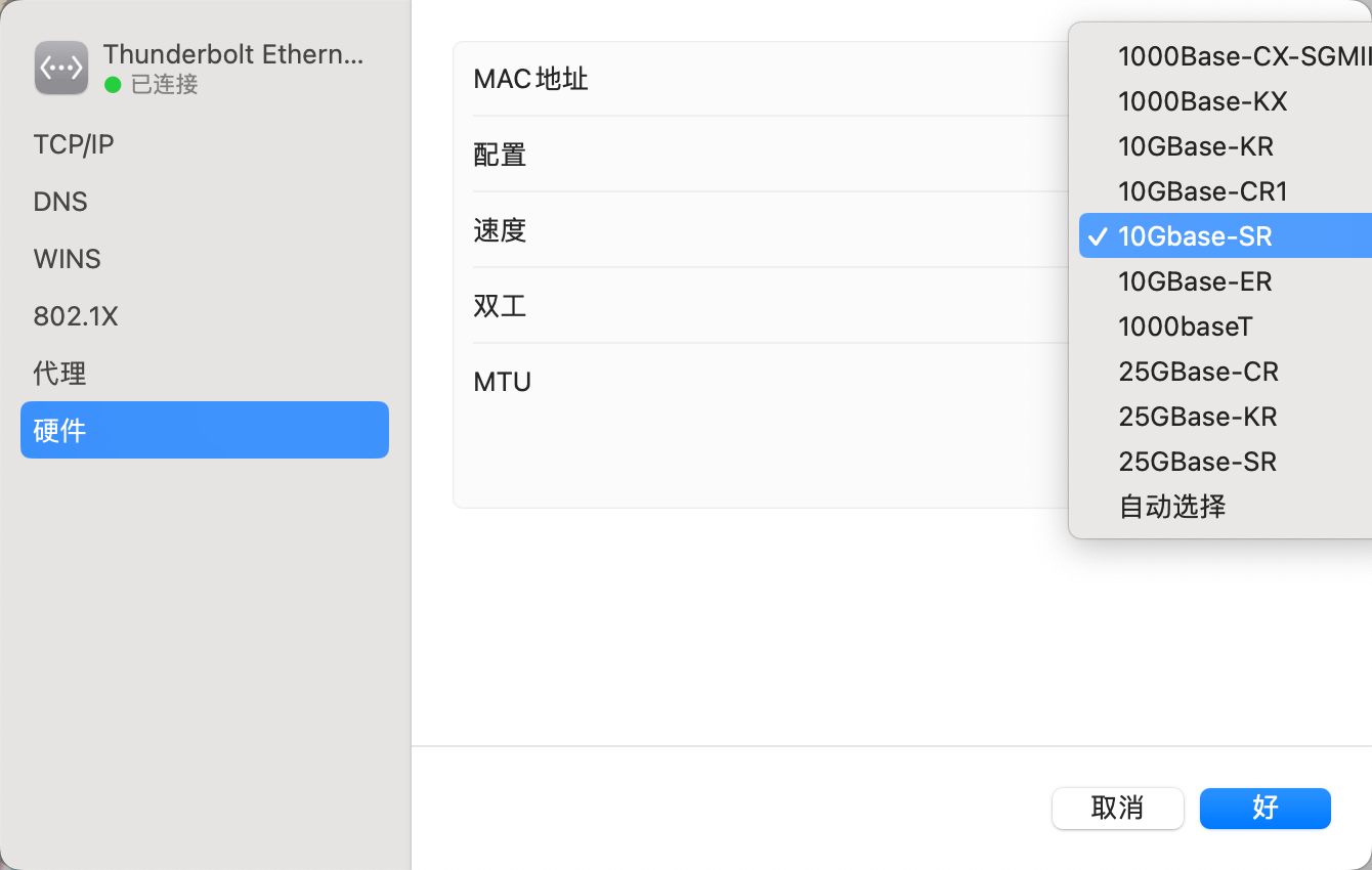

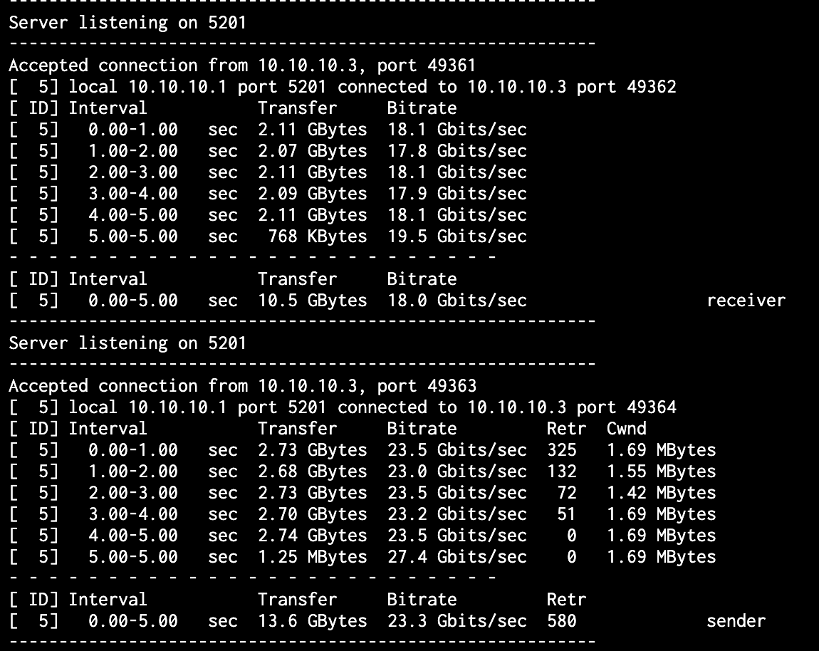

Here is a quick test of cx4411a on hackintosh connecting to the cx4411a on truenas. Both MTU 1500.

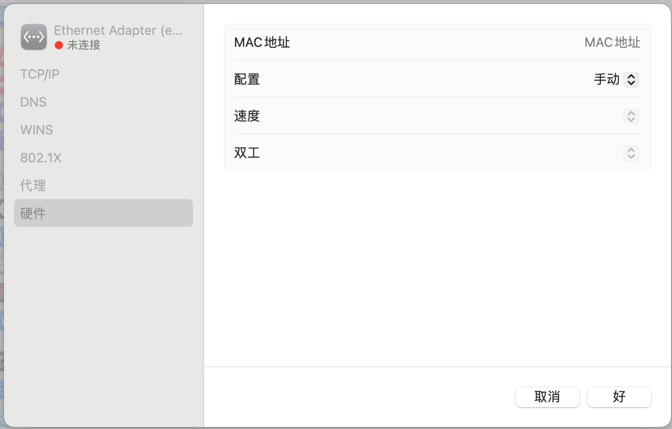

The driver loads and attaches to it fine, no errors in the kernel logs, but no network interface gets created.

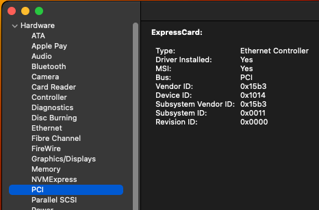

Hi. Is there a way to see all the card supported ?
In a KEXT, there is a list with all the couple vendor ID/product ID in the plist, but i don't know where the list is with the DEXT.

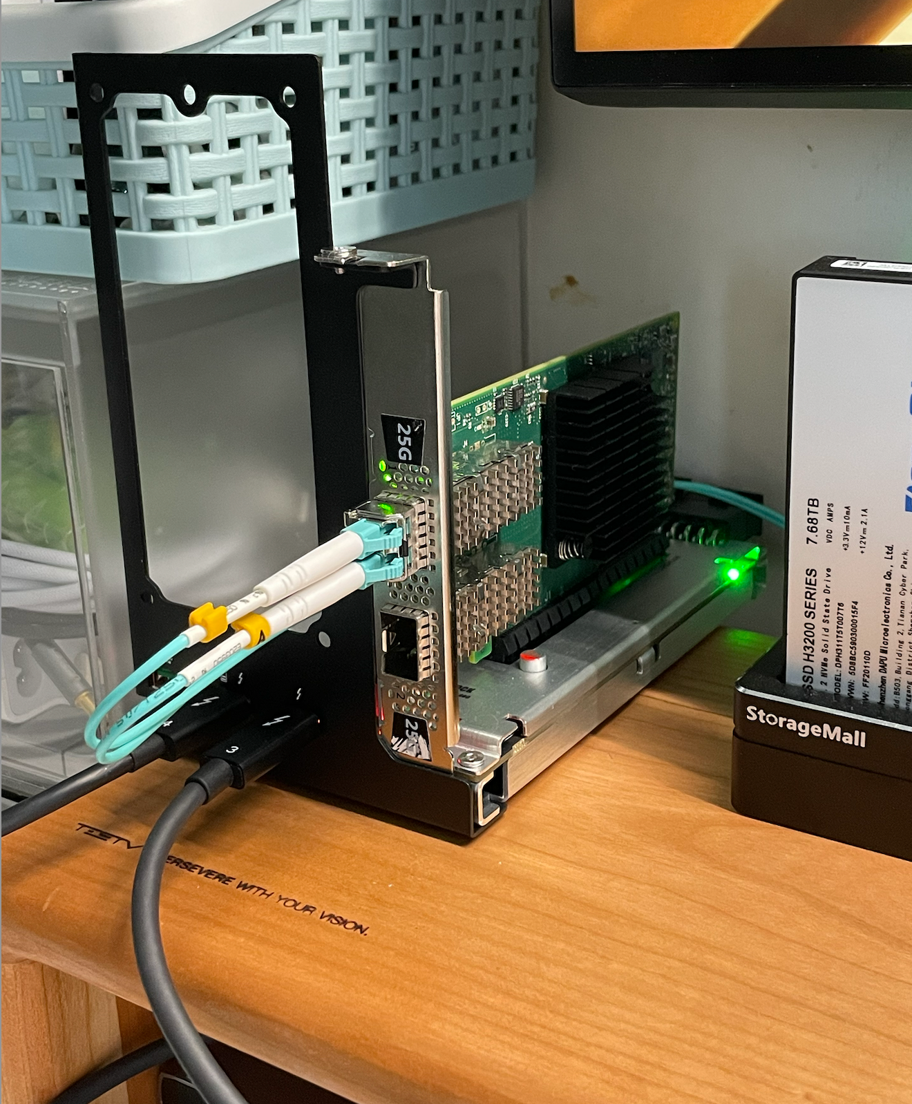

My T580 arrived today, I bought it on eBay. My issue is I do not have the full-height bracket, does anyone know where I can get it?
metacollin, thanks for your driver! it works in my Z690 Hackintosh.
I use one port in and the other port out. Here are my results (way more than 40Gbit/sec):

[ 5] 6.00-7.00 sec 7.13 GBytes 61.3 Gbits/sec
[ 5] 7.00-8.00 sec 7.05 GBytes 60.6 Gbits/sec
[ 5] 8.00-9.00 sec 7.15 GBytes 61.4 Gbits/sec
[ 5] 9.00-10.00 sec 6.76 GBytes 58.1 Gbits/sec
[ ID] Interval Transfer Bitrate
[ 5] 0.00-10.00 sec 70.9 GBytes 60.9 Gbits/sec sender
[ 5] 0.00-10.00 sec 70.9 GBytes 60.9 Gbits/sec receiver

Here's what 'System Information' shows me:
I'm wondering if perhaps the driver isn't loading because it doesn't know how to init VFs... or if it has something to do with the fact that it's being detected as 'ExpressCard'.
I saw mention of the class code but don't see where I can see that.
Any assistance would be greatly appreciated. Thanks!

Finally I got the mcx4131a bcat and it worked for one time on a HACKINTOSH. Ad than I rebooted the computer and it showed disconnected. I can't find the issues for I had done nothing to it. It looks like that it has not load the drivers. Does anyone know what the issue is and how to solve it?
Finally I got the mcx4131a bcat and it worked for one time on a HACKINTOSH. Ad than I rebooted the computer and it showed disconnected. I can't find the issues for I had done nothing to it. It looks like that it has not load the drivers. Does anyone know what the issue is and how to solve it?View attachment 2205109
SOLVED. It is the problem of pcie slot. Now I put it into the first Pice slot which connect to cpu directly and works great.

Monterey 13.3.1 M1Max macbookPro
thunderbolt 3 dock + mellanox CX4212A-ACAT 25G nic Work very well
The only problem is that only 2034 largest mtu

I want to buy Sonnet Echo Express SEL Thunderbolt 3 to PCIe 3.0 x8 expansion enclosure and then attach a Mellanox ConnectX-4 Lx MCX4121A-ACAT (dual port) or MCX4111A-ACAT (single port) NIC.
Recently Sonnet announced and started to sell a new product called Sonnet Twin25G thunderbolt 3 adapter:
https://www.sonnettech.com/product/twin25g/overview.html
and it looks like it uses the Mellanox 25gbe network adapters from the same family ConnectX-4 Lx. They prodive some drivers here:
http://www.sonnettech.com/support/kb/kb.php?cat=635&expand=_a3&action=b1219#b1219
But they require macOS 13.2+ Ventura. Does anyone know if their driver can work with any Mellanox ConnectX-4 Lx MCX4121A-ACAT or they can somehow vendor lock their driver to work only with their version of this card?
Reactions: mkush
