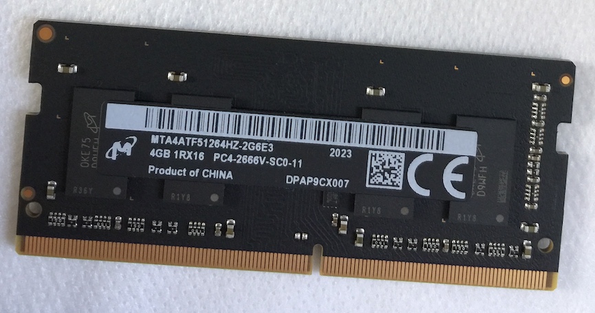

Adding one more point of data. 32 gigs of RAM from OWC in the open slots. 40 gigs total of RAM but running at 2133mhz. I'll pull the 8 gigs out to get 2667 going.
Anyone who stayed with the standard 8 gigs want another 8 gigs? I'll let them go for cheap. PM me. (I'll edit this out if not allowed)
It would be funny if two sets Apple RAM from two iMac 2020, running at 2133MHz on an iMac 2020.

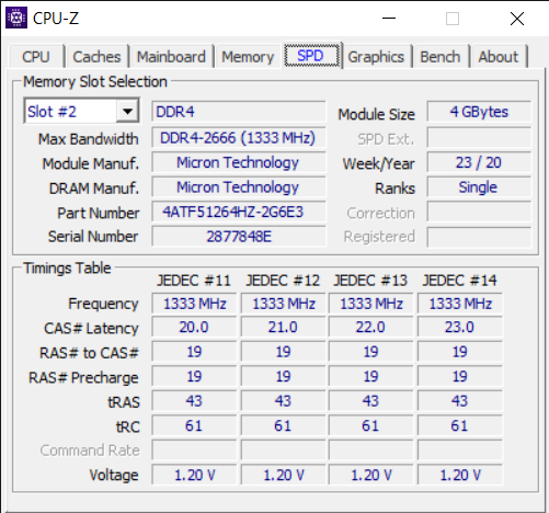

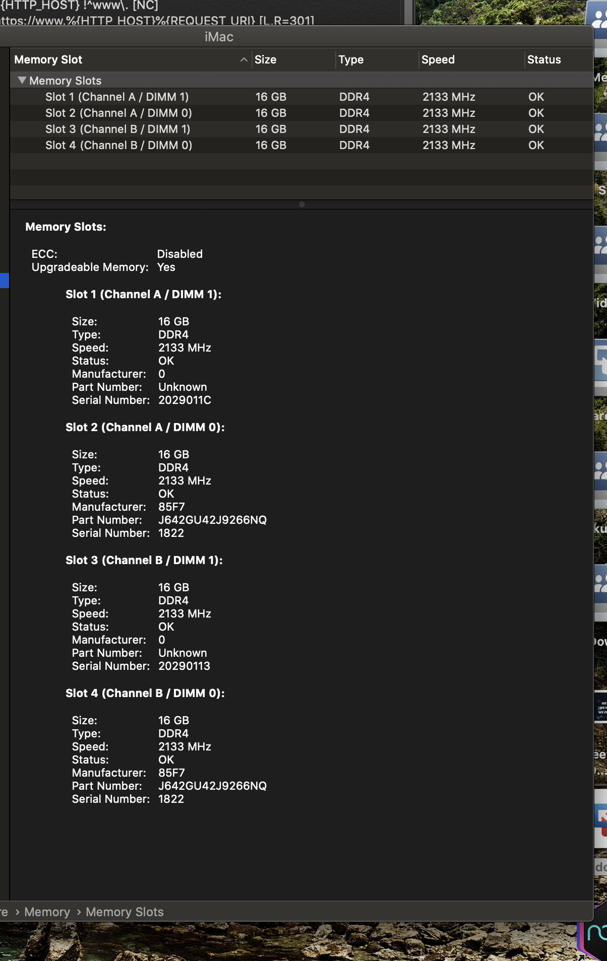

Could you screenshot the ram details in system info app, to check any difference in part number of the four sticks
You could just place the same set in the same channel to check whether it returns to 2667MHZ

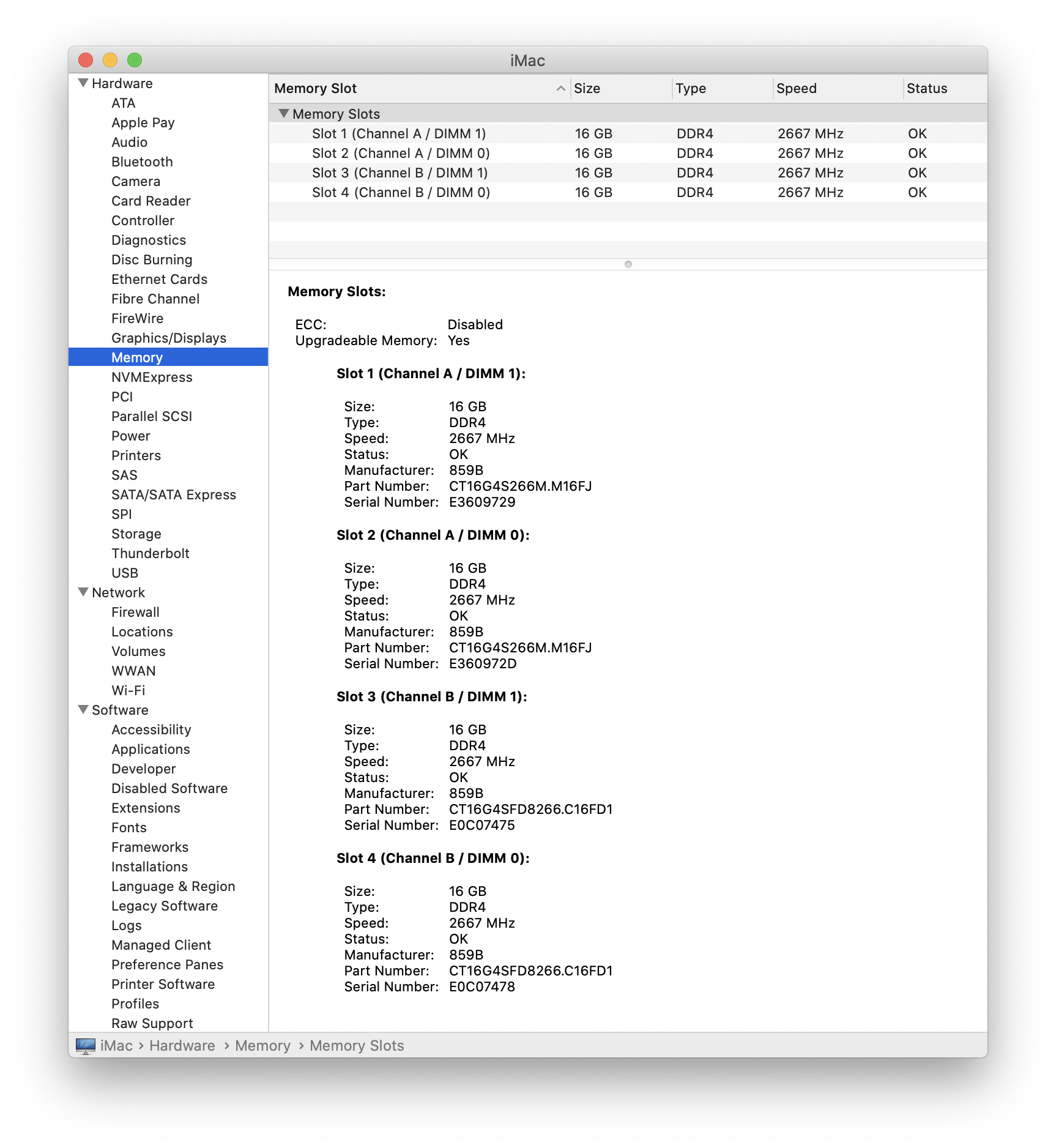

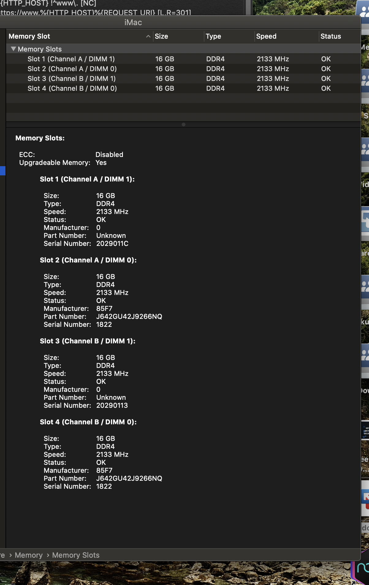

Heres a picture. The original 2x16GB worked at 2667MHZ no problem. I put the new ones into the remaining two slots and bam. I double checked the package same kit. Bought the same ones on amazon from the same supplier.

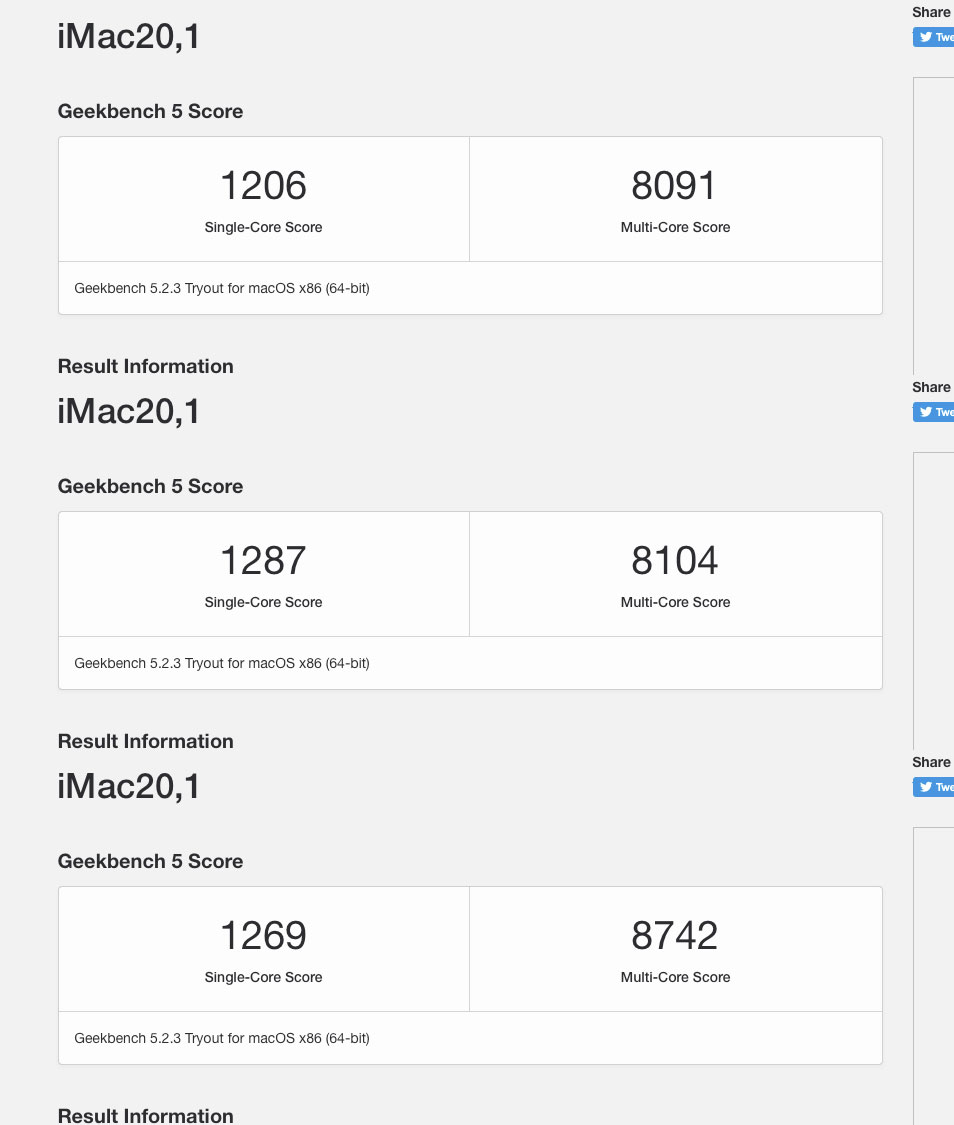

I'll post my story -
I started with the 3rd Tier and 8GB Ram (2 Apple 4 GB Sticks).... I purchased 2 16GB Sticks from OWC and had the same issues as everyone here - 9to5 way, 2667 but low Geekbench scores; "Normal" way and got the 2133 and higher scores.....
BUT - I purchased 2 additional identical 16 GB sticks from OWC and I have 4 slots filled with the same RAM size from the same manufacturer ...My results show that it WORKS.... (the second time I ran it I got 9000 for MS)

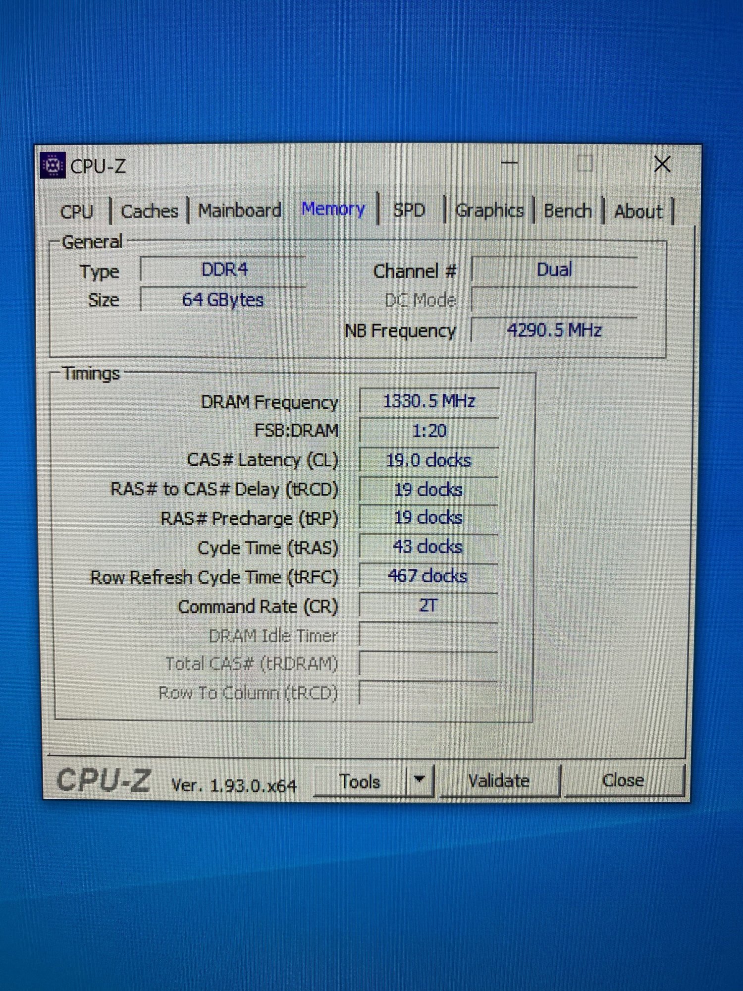

Like everyone here, I also was only getting 2133MHz when mixing with Apple RAM. I put in the Apple RAM into a Windows laptop and read the SPD data. My iMac came with Micron RAM. Looks pretty standard, it's odd that there's so much incompatibility. Hope this information helps someone find matching RAM.

If you put the first pair in slots 1 and 2, and the second pair in slots 3 and 4, then for some unknown reason you should then get 2667 MHz and dual channel support. It defies expectations but that's what's happened with mine.

You don’t get dual channel. Geekbench scores reflect that. People who have done that to get 2667 MHz have seen multi score results between 5000-7000 with the 10910. When you configure it with dual channel but the speed is 2133 MHz the results are more appropriate at around 10,000.

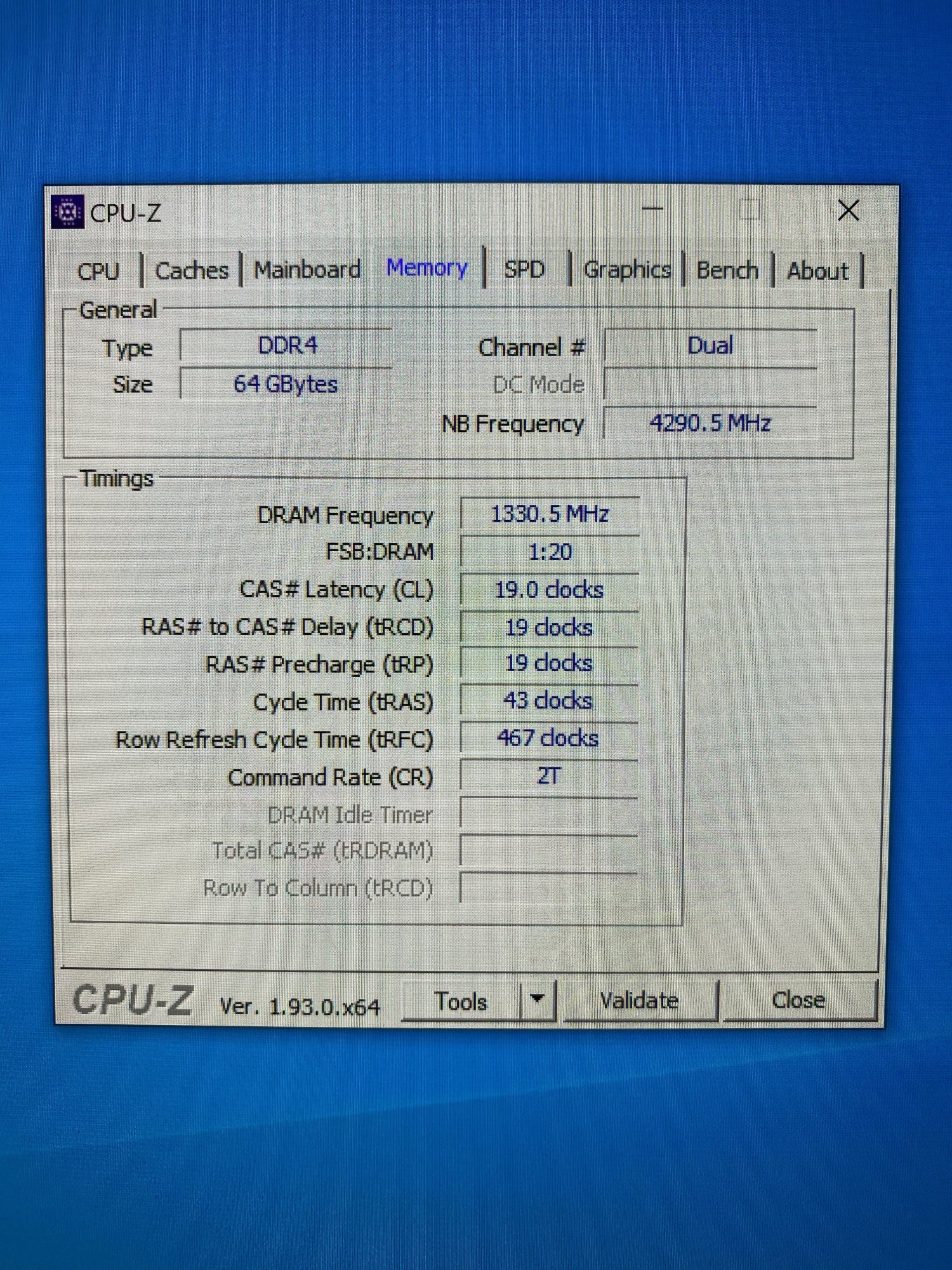

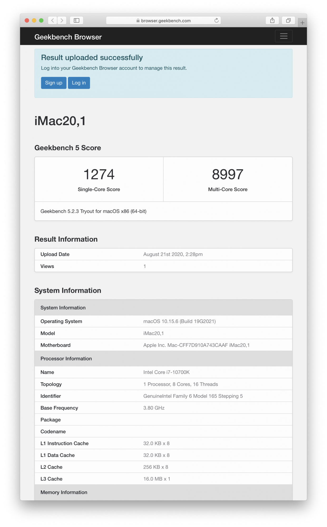

I'm doing it, it's showing dual channel in CPU-Z in Windows, and I'm scoring 9000 in Geekbench in macOS on an i7.

I'm doing what @gtosnipey was doing: not using Apple RAM, but mixing two types of third party RAM, which is why I told him to re-order them to maximise results.
Sorry to get your hopes up if you thought I was mixing Apple and third party.
It still shows that each stick does not have to be identical.
Evidence attached.
Evidence attached.

Ah, you have the same size RAM. So that is why you have dual channel still.
The issue becomes is when you mix different size RAM. If you do 4 x 4 x16 x16 for instance, you will lose dual channel. To get dual channel back, you need to do 4 x16 x 4 x 16, but then you get the speed drop.
So your config will work with different brands/types of RAM if they are same size. Issue still remains if you mix RAM sizes. I was able to mix RAM sizes in my 2019 with no issues. So it’s curious what is the issue here.

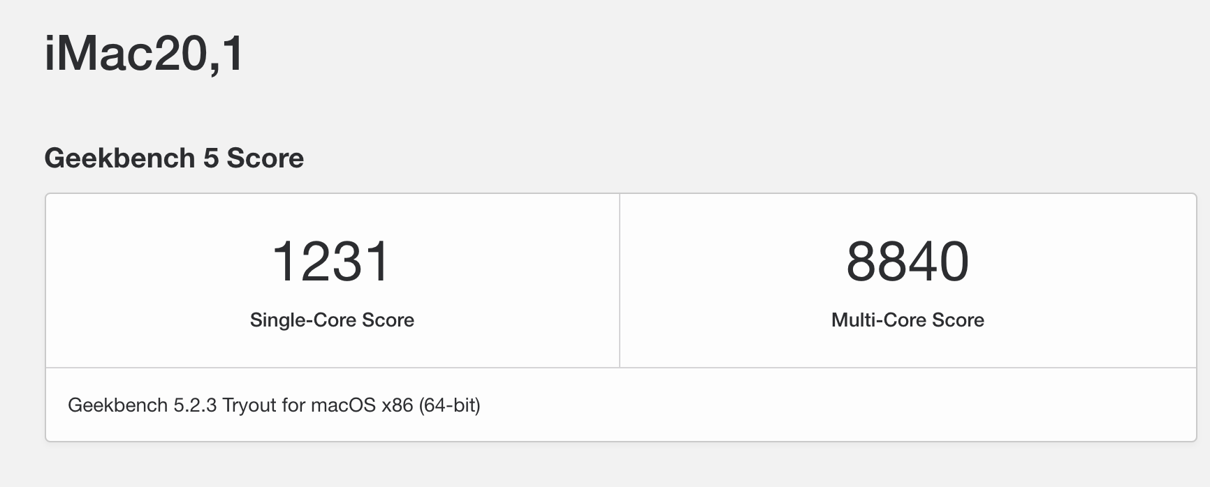

It is strange that I got multi score at 6320 for my 10500 when in single channel, but just 5922 when in dual channel at 2133MHz.
But the background app is a bit different.

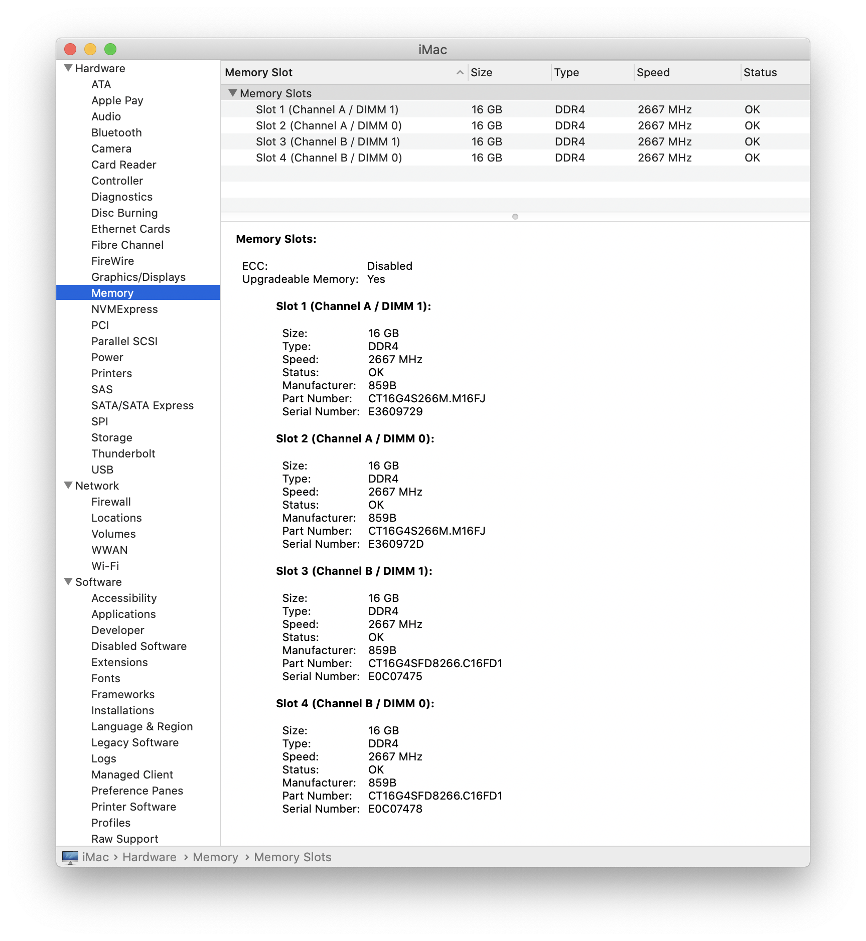

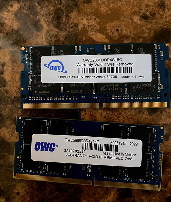

I’m not mixing two types of third party ram though. I bought the same 2x16GB kit from OWC twice on Amazon. Didn’t mix should all be the same?
Reactions: limes666 and DQ11
You may just have been extremely unlikely. I did the same with my two pairs of Crucial, but fortunately they all worked together. My understanding is that each pair is tested as a pair to ensure compatibility. When you buy a package of four sticks, all four modules are tested together for compatibility. Compatibility cannot be ensured between two different packages of pairs, I think. Which seems kinda silly.
Reactions: gtosnipey
Put the sticks from the first kit in slots 1 and 2 and the sticks in the second kit in 3 and 4 and see what happens. This is very interesting to see how picky the 2020 iMac is.

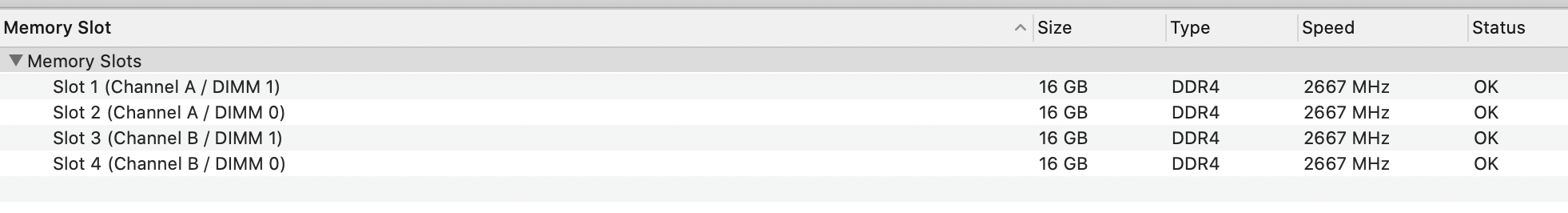

And you are the winner! So I just put the first pair in 1 and 2, and the second pair in 3 and 4, and they are now listed as 2667! Also, I am posting an image, the first two tests are in the original.
Also if you look at the ram, then are physically two completely different types of modules. I didnt compare them before I put them in I just assumed they were the same. They are not even though both from OWC.
placement rated at 2166, and the third screenshot (higher) is the new placement and is listed at 2667MHZ!
