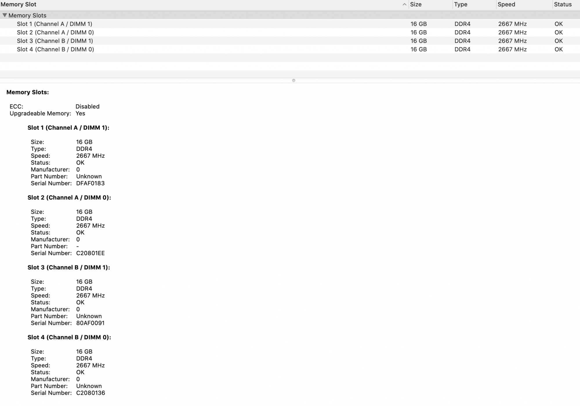

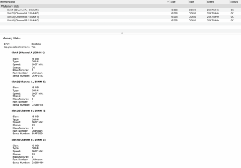

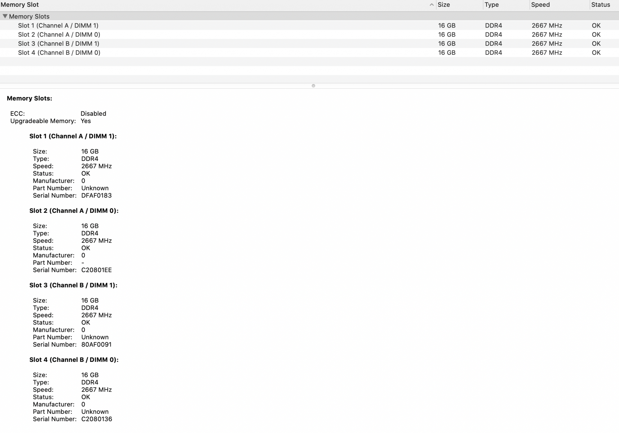

New 2020 iMac. Four 16 GB OWC modules and I assume it is working. Getting the correct speed, but I have no idea how to check if I'm getting Dual channel. Any thoughts?
I did the same config as you ... I ran Geekbench scores that indicate I’m getting the correct speeds... but not sure how to officially check if it’s dual channel
