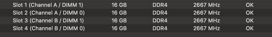

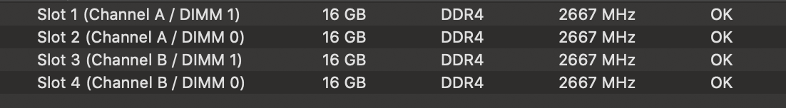

OKay so now I have apple in 3&4, and crucial in 1&2. So my speed is back up, but how do I check for dual channel?View attachment 947833

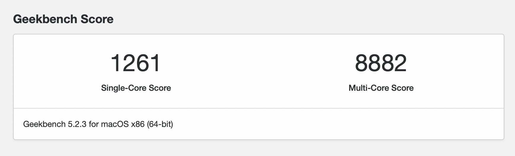

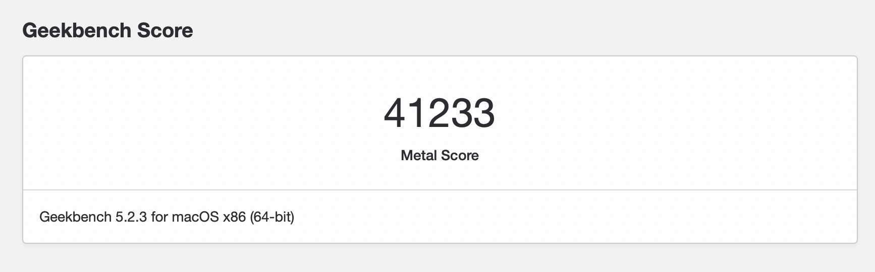

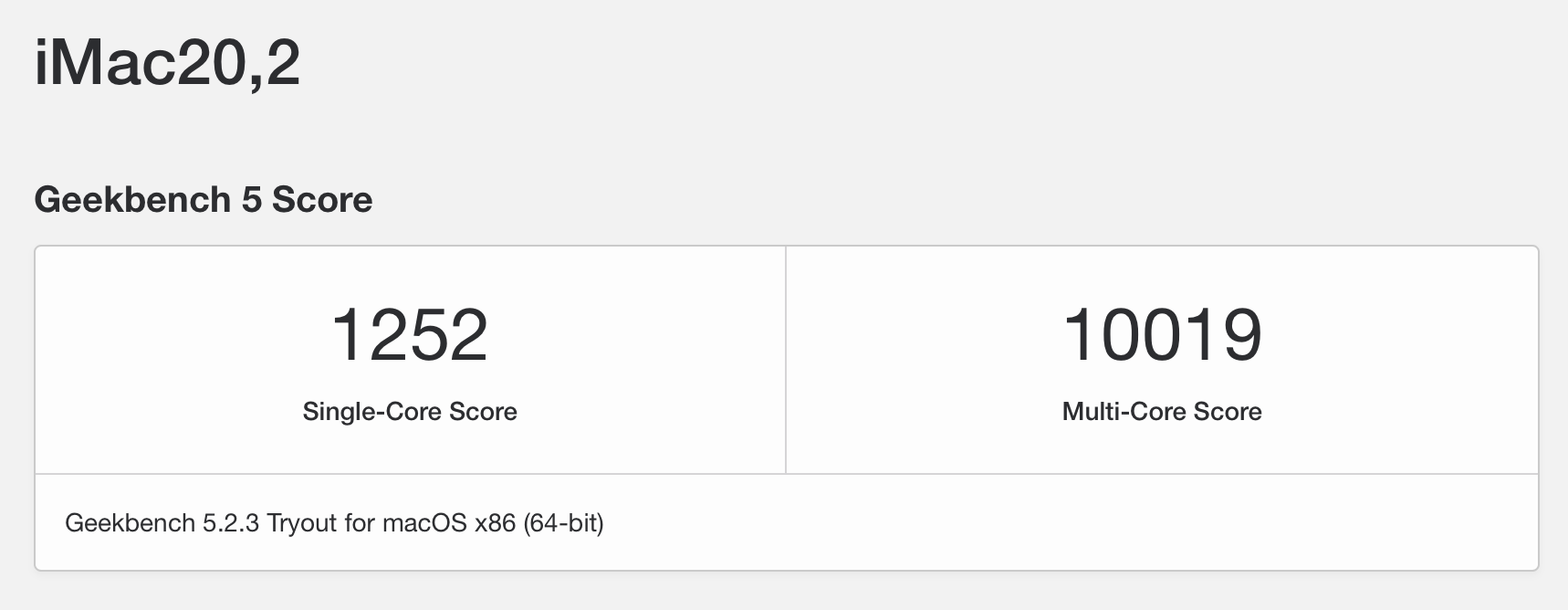

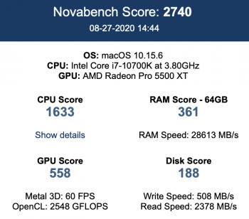

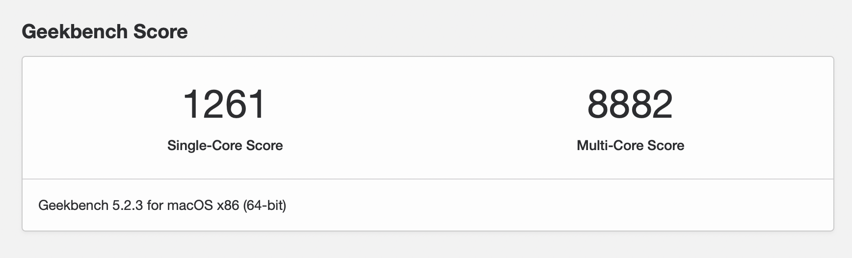

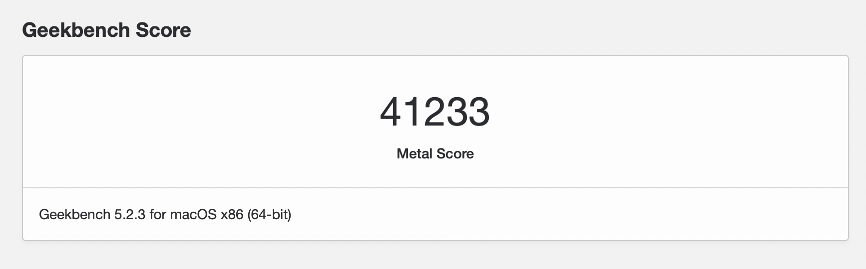

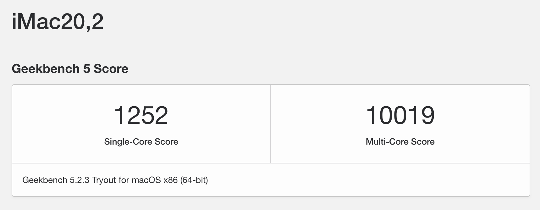

I ordered 2x16GB sticks from OWC. When I saw that Apple ram and 3rd party wasn't working together, I ordered another 2x16GB from OWC. The ram arrived and looks different; apparently two different manufactures. One made in Mexico and the other Taiwan. Since they came all the way from the US to Australia, I decided to try them together. Slots 1,3 Mexico and 2,4 Taiwan dropped speed to 2133MHz. I put them in slots 1,2 and 3,4 and speed is up to 2666MHz.
Attached are a few screenshots. Does this look OK, or should I return some or all of the RAM for something else or try with 32GB?
Thanks for testing this out! So the general consensus is that dual channel is working here? I had suspected that running a pair of sticks in each channel would work provided all are the same size - if so that's good news for me, all I need to do is buy another set of 16GB sticks next time I need to upgrade.

I'm sure you are right on this, and had I known I would have purchased different RAM, but if you look at the screenshots I posted above, does it look like my numbers are where they should be for an i7 with the 5500xt? Am I better off to run 32GB? I am in Australia so exchanging it will be somewhat costly and time consuming.
Your numbers seems inline with what I have seen before for this configuration.

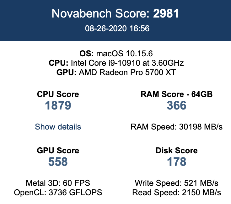

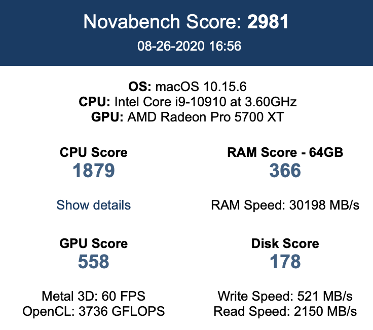

Another data point:
I have the 10 core 5700xt system.
I ordered 128GB from OWC and received two packs of 2 x 32GB DIMMs.
Each pair is matched, but the two packages contain different memory (they look physically different). Putting Package 1 DIMMs in 0 2 and Package 2 DIMMs in 1 and 3 as recommended resulted in 2133MHz. Putting Package 1 in 0 1 and Package 2 in 2 3, resulted in the expected 2667mhz.
Novabench says RAM Speed: 29935 MB/s
That sounds like expected speeds, right? Thanks!
