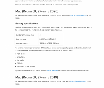

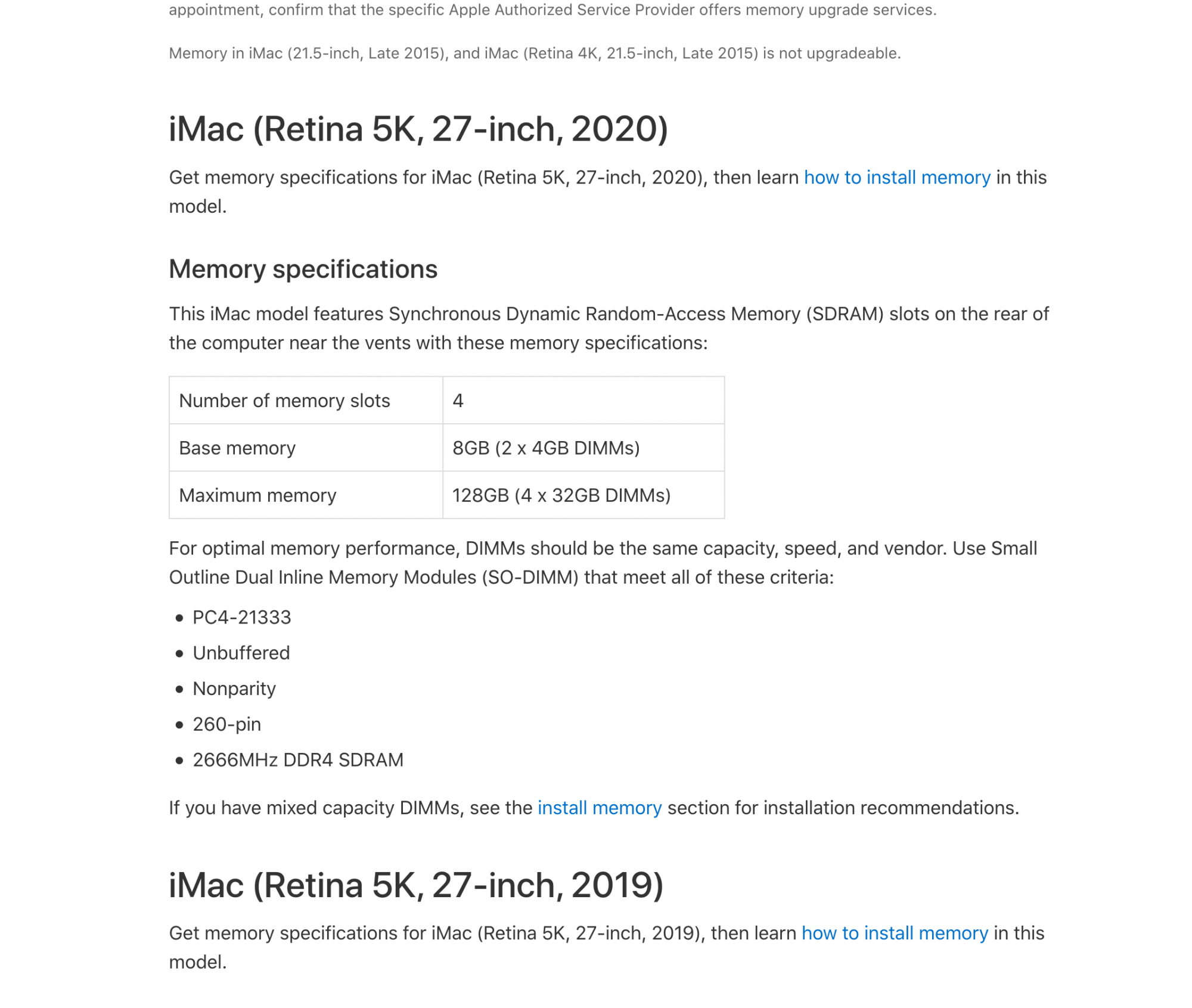

Good catch! I don't recall that text being on the site earlier. If you look at the bottom of the page it says published on "September 02, 2020". It also appears that the text "For optimal memory performance, DIMMs should be the same capacity, speed, and vendor" is unique to only the 2020 iMacs. Hmm...
There is also this paragraph specific to the 2020 iMac:
iMac (Retina 5K, 27-inch, 2020) DIMMs have a notch on the bottom, slightly left of the middle. If your DIMMs are mixed in capacity, minimize the capacity difference between Channel A (slots 1 and 2) and Channel B (slots 3 and 4) when possible.

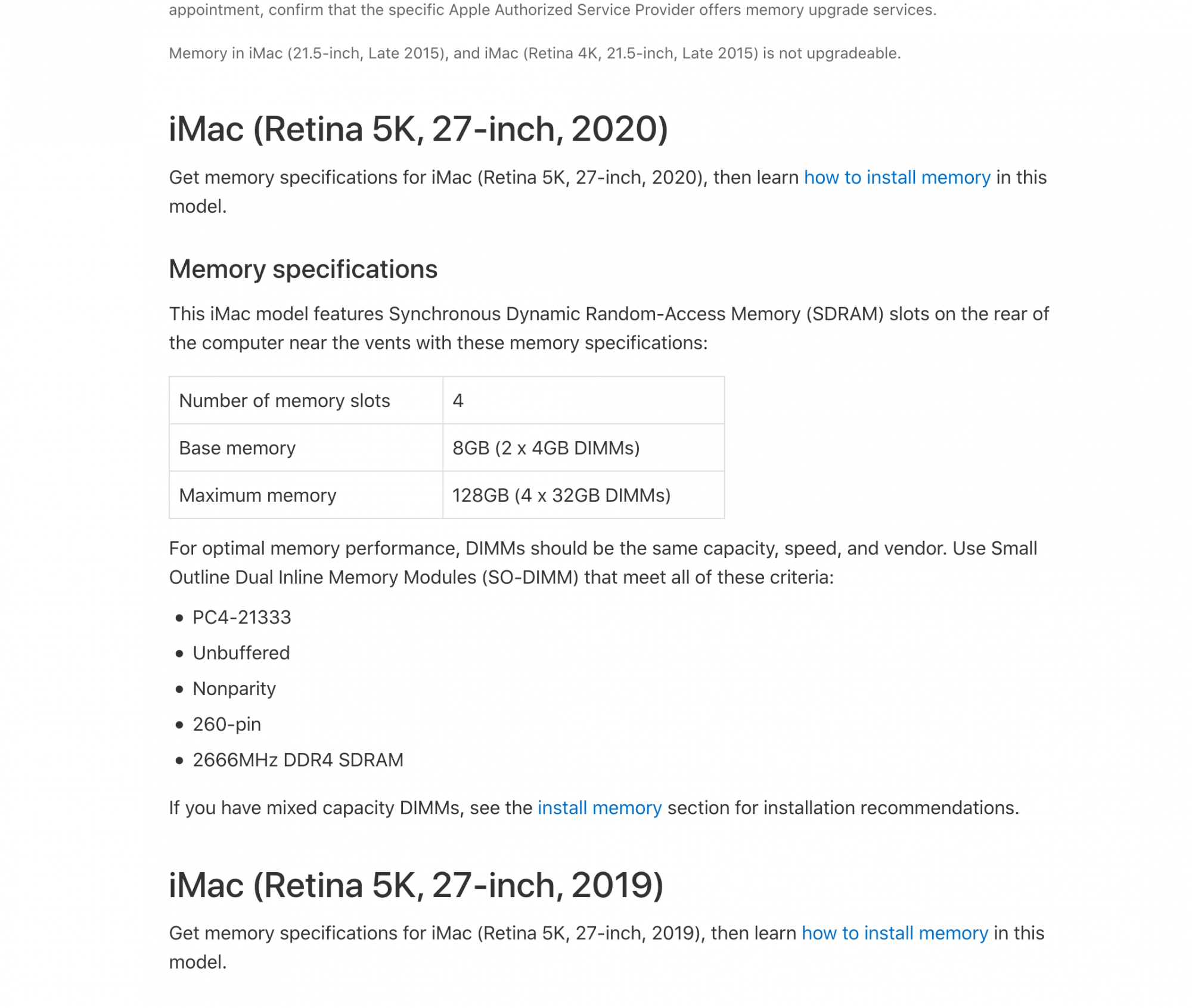

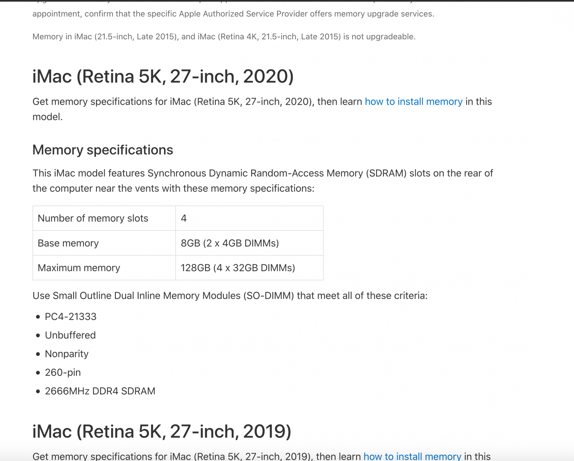

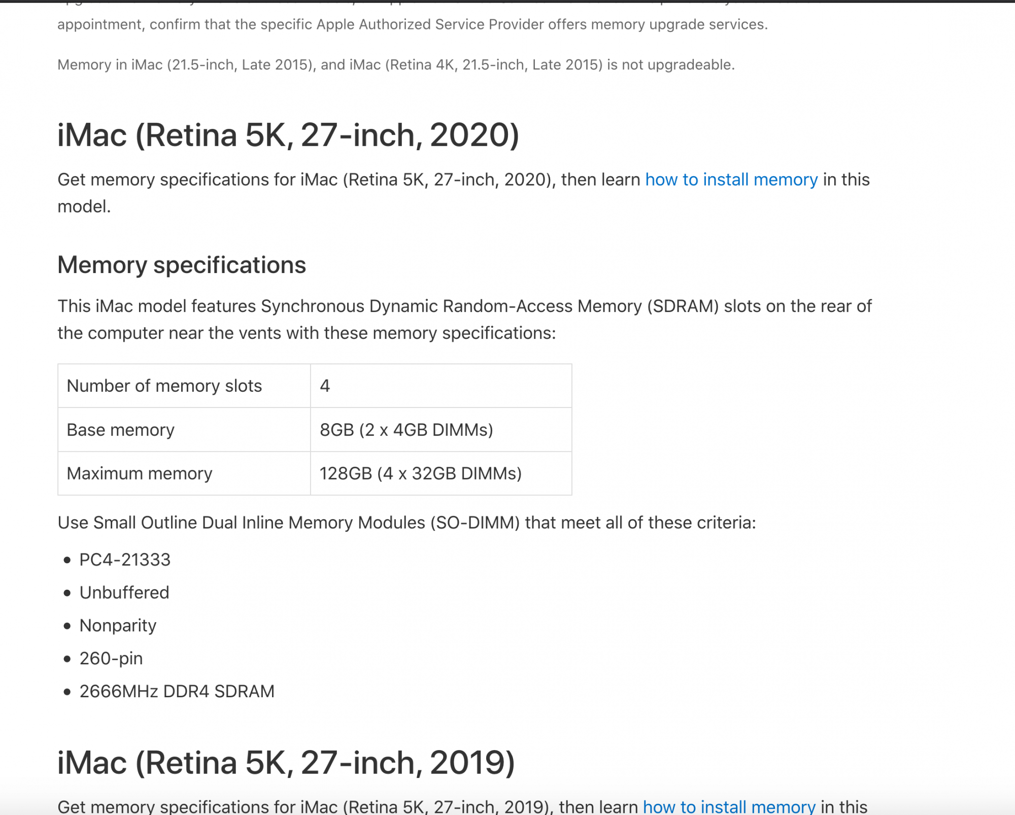

By now it seems the horse is far beyond dead, but should there be a need for an additional beat:
Here are the screen captures from the Apple Support page. One has a date of August 5, 2020. The other has a date of September 2, 2020.
I wonder if knowing this before purchase would have made any difference to those who bought one.
Anyone who read this thread knew this was coming. In fact, I predicted that Apple would post such a support update a couple of weeks ago.
It certainly makes no difference to me as to whether or not I would have bought my wife's 2020 or when or would have changed my RAM purchase for her machine.
In the real world, this won't matter to most users as they will not notice any difference in performance. None of my testing has revealed any. Since Geekbench doesn't measure real world performance, I don't use it.
I doubt it. The only thing it really changes is whether you’re expecting to use that 8GB or if you should adjust your budget to get a larger RAM kit. Even then, the cost of a bigger RAM kit is still way less expensive than what Apple charges to go to more RAM. Apple wants another $200 to go to 16GB. A 16GB kit from Crucial is $75 so even if you have to write off the included RAM, it’s still over 50% cheaper.
I’m just glad Apple clarified what we’ve all found in testing.

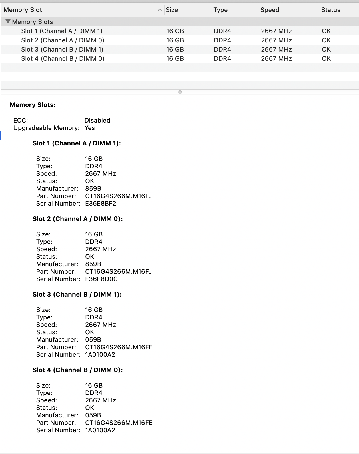

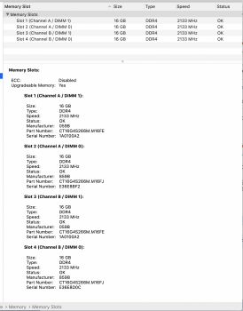

I have two of what should be identical Crucial 2x16 pairs that behave differently depending how they are installed. I'm wondering what's going on.
I ordered the CT2K16G4S266M from Amazon at the same time I ordered the iMac. When it arrived, I replaced the 2 4G sticks in slots 2 and 4 with the Crucial kit and everything looked great. Reported speed of 2667 MHz.
Then I saw a good price on the same Crucial kit from Newegg and decided to just go ahead and populate the other two slots. I ordered the same 32G kit but actually received two individual sticks with the part number CT16G4S266M. From what I could tell on the Crucial site, these are the same DIMMS as in the 2x16 kit so I tried them in slots 1 and 3.
The speeds dropped down to 2133. I swapped them around so the original pair is in slots 1/2 and the new pair in slots 3/4. Now reporting 2667 for all four.
All four sticks report the same major part number, CT2K16G4S266M, but report different manufacturers and minor part numbers. Would that be sufficient to cause the drop to 2133 when they are interleaved across channels despite both pairs being Crucial with identical specs and speed? This is baffling. Am I truly getting dual-channel here when all four are reporting 2667?
