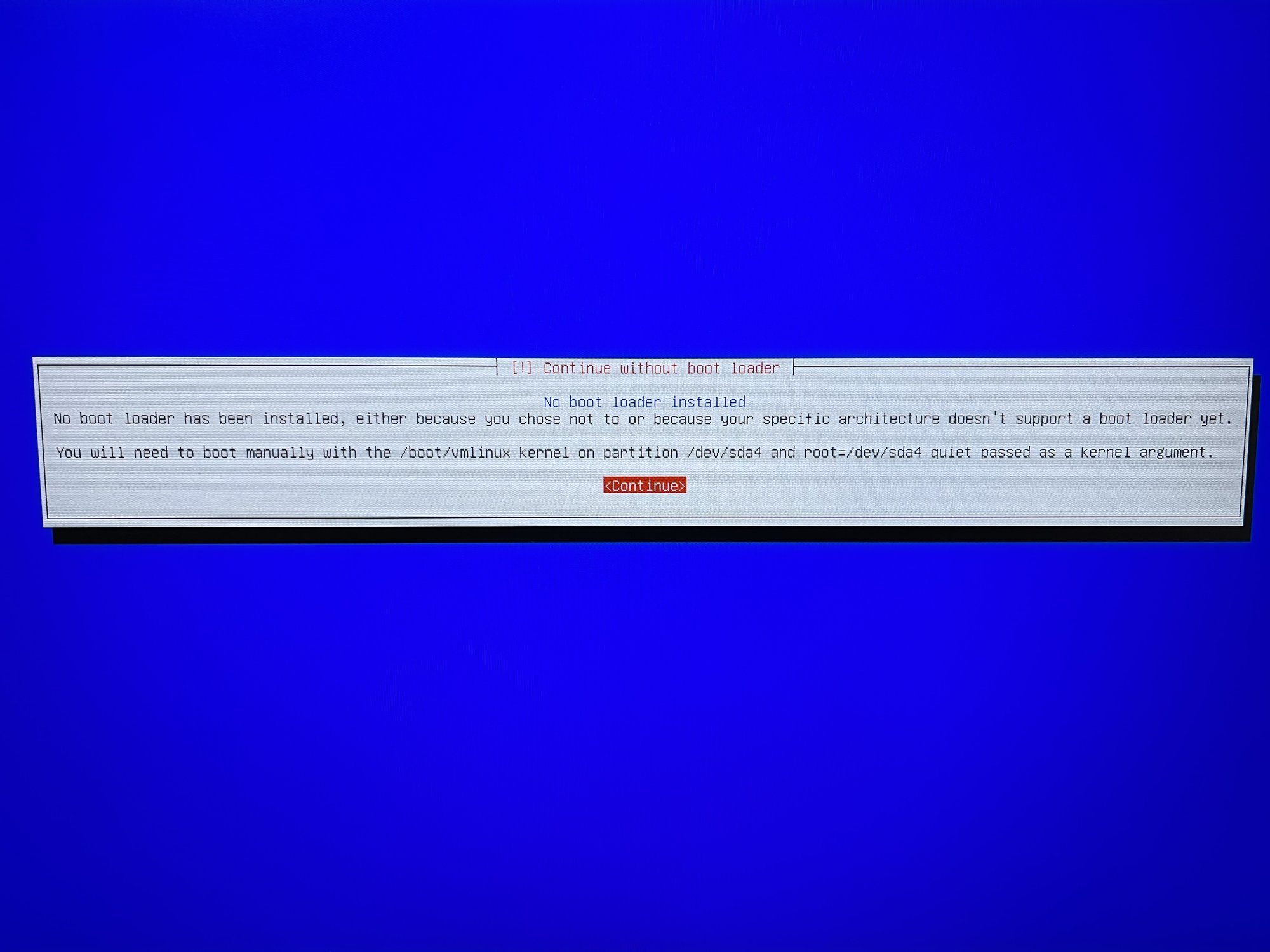

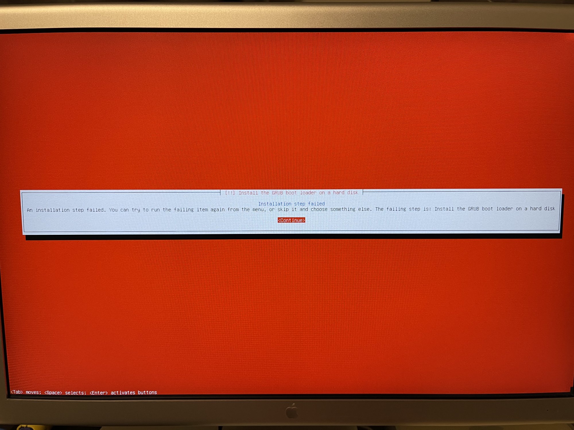

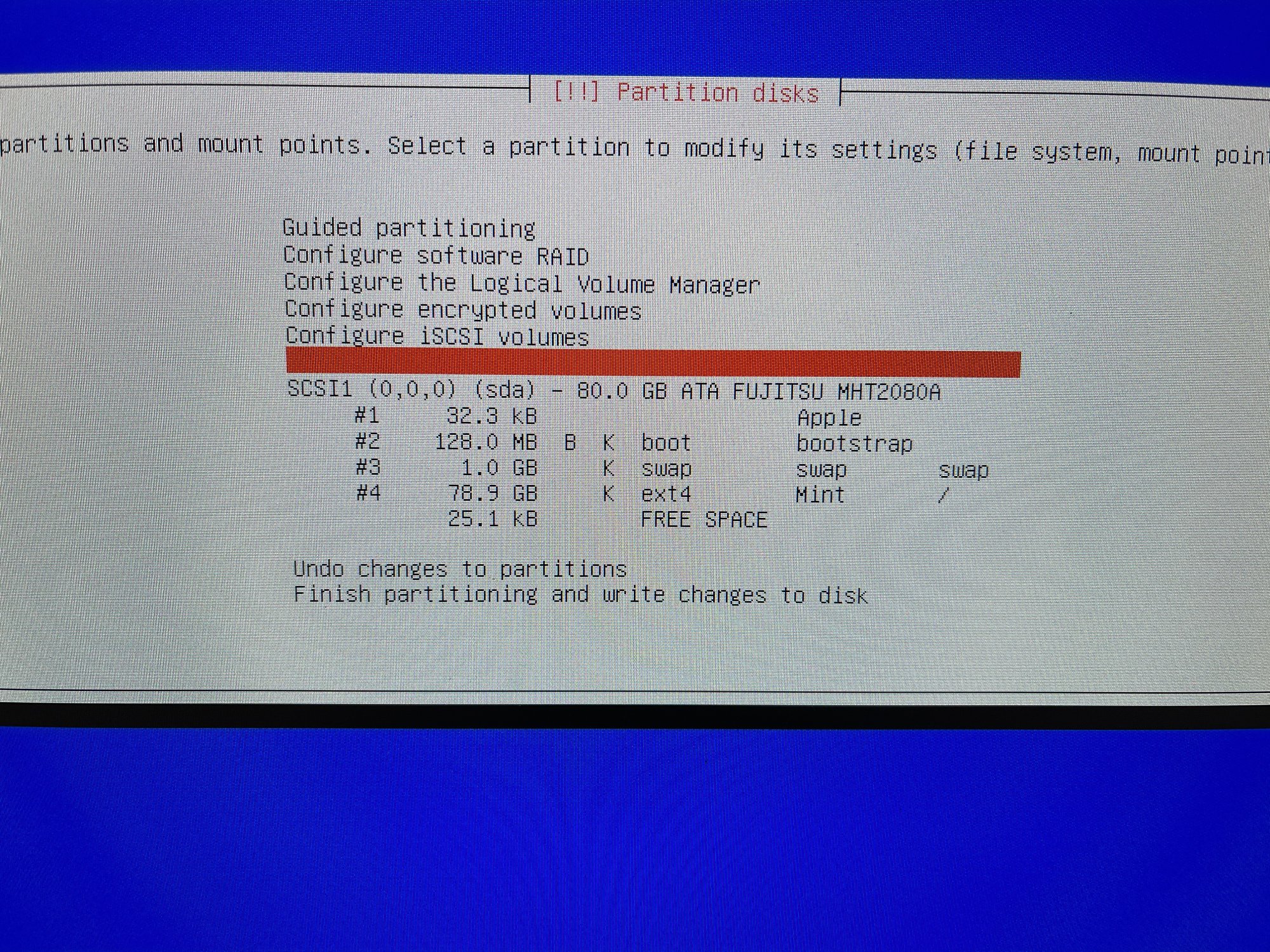

Hello, I tried to install this today on my G4 Mini and it made it through the entire installation but failed to install grub at the very end:
I believe my partitions were correct so I'm not sure what went wrong. Is there a way to boot directly from open firmware or is it necessary to install grub?
What image did you use exactly? I remember that happened to me maybe 2 years ago, when Debian switched to GRUB but this one was buggy on PPC.
With a recent debian image, I installed it on a G5 model but it failed on Mac Mini with error "Invalid memory access" booting the installer kernel.
The 32 bit one from the installation instruction page on the mintppc.nl website.
