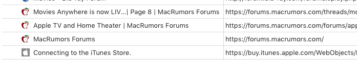

It should be in your internet browser history, it will have opened at the time you originally linked your accounts.
https://buy.itunes.apple.com/WebObjects/
That's just part of the link, it will be a lot longer for you and contain codes. I can't provide the full link because the code mine uses will obviously be different to yours. If you've already linked with iTunes it should be in your internet history
I can confirm that if you can find this link, it will get things flowing again. I had my iTunes successfully connected from yesterday, but today the Disconnect was missing and new movies weren't flowing in/out of iTunes. Simply clicking that initial link again, and doing the connect again in iTunes corrected everything. Movies are flowing and the Disconnect is back in iTunes. Thanks for the tip!!
