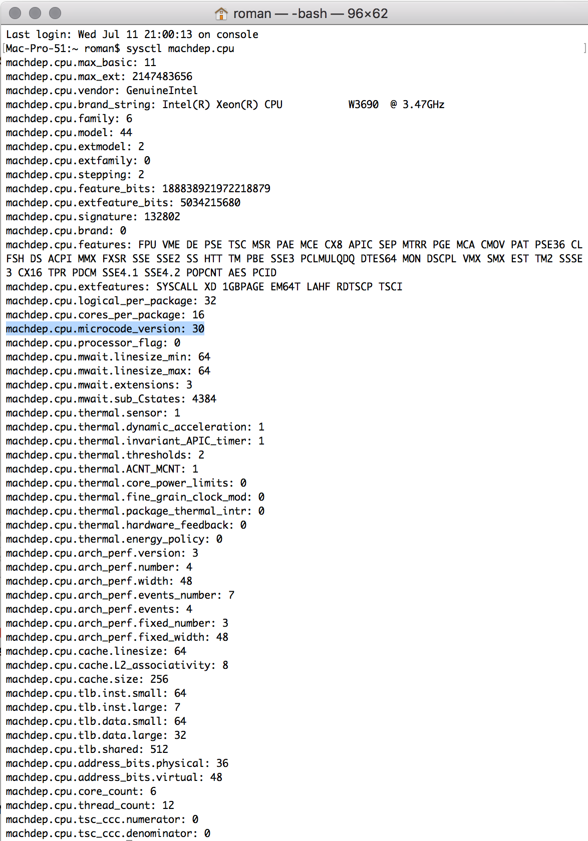

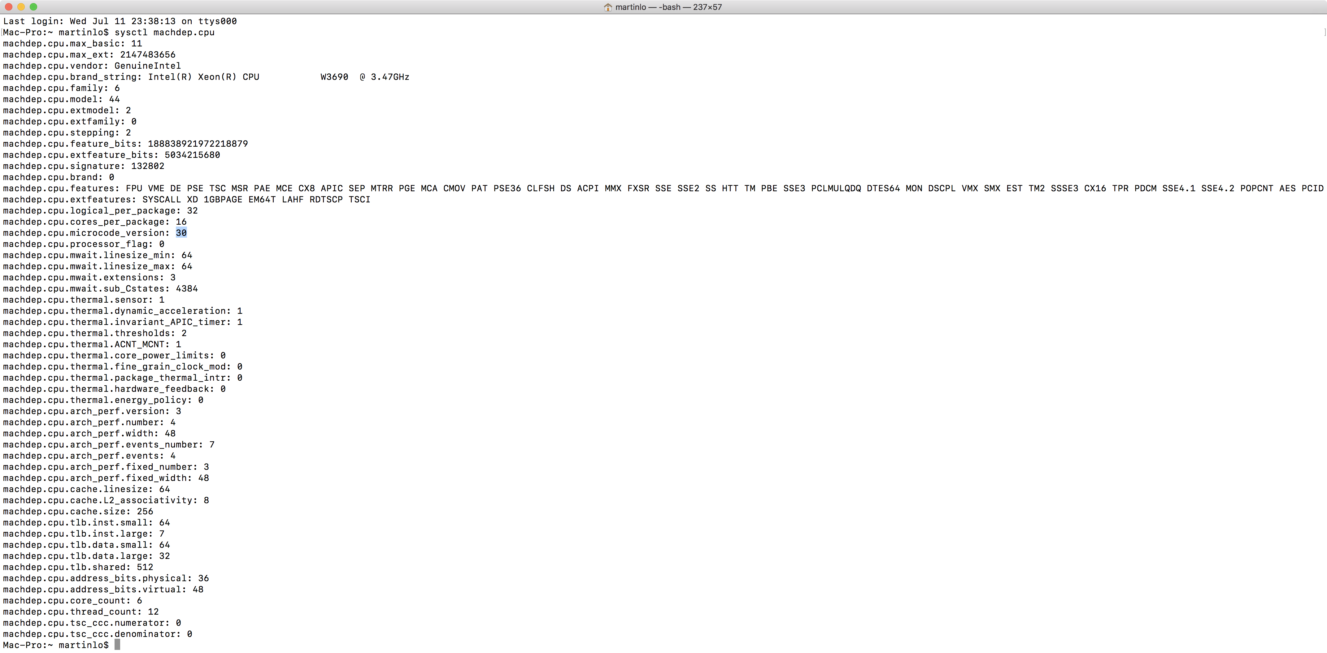

Would the installer try to mess with a W3690 which isn't going to get updated?
Worried it would just assume I've got a W3680 which shipped with the Mac Pro and screw it up, or fail to update and refuse to install macOS.

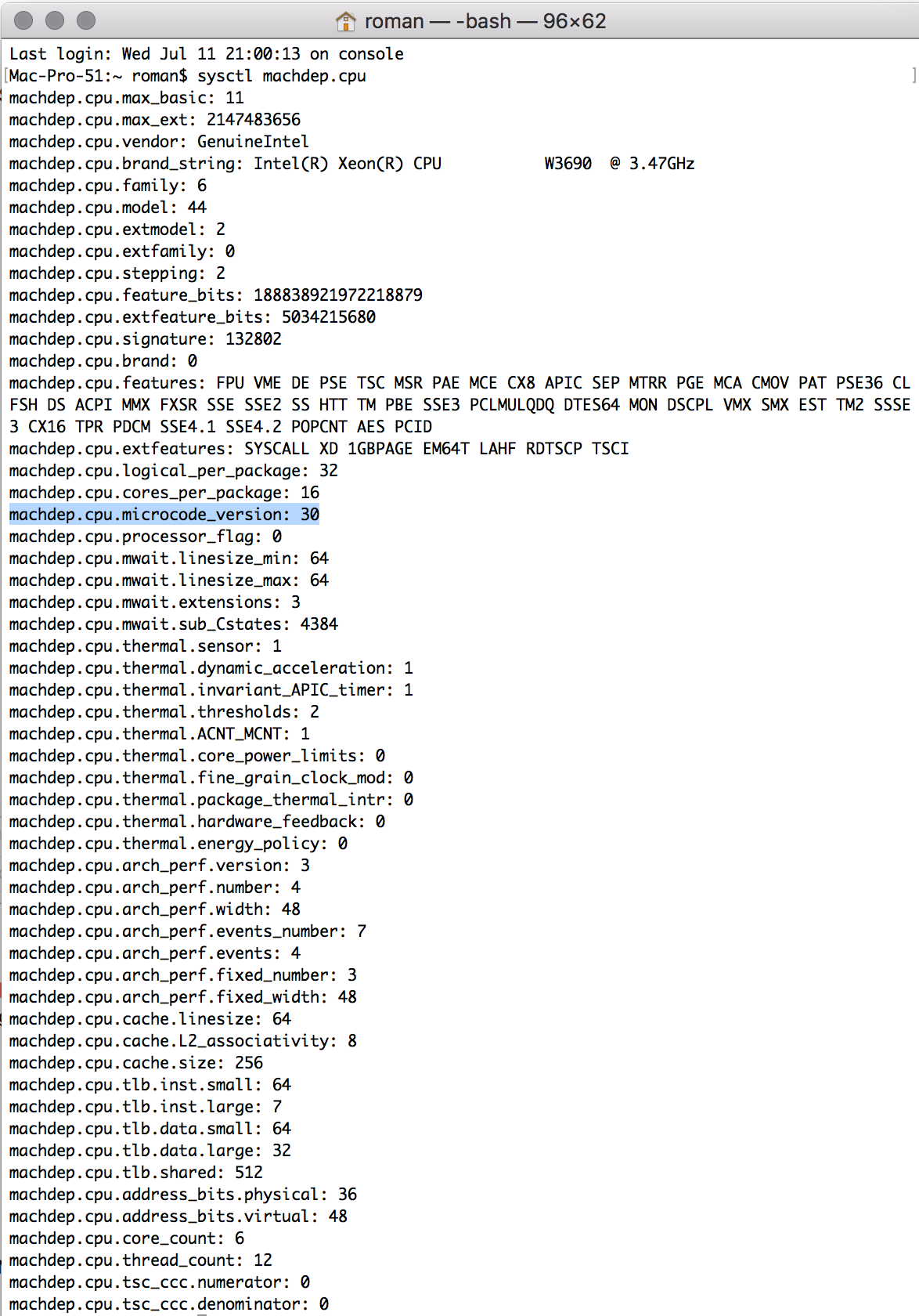

Don't worry, 0089.B00 is fine for W3690. Microcode update to version 30.

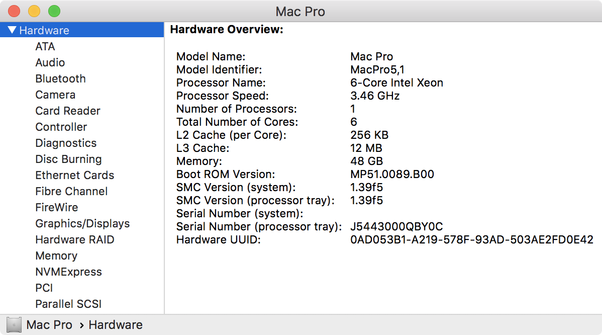

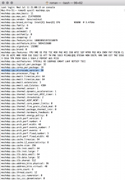

I managed to grab the 10.13.6 full installer finally and got my Mac Pro updated :)
can confirm the new microcodes :) I was also able to Boot windows (an EFI installation of windows 10) with no issues with this update so I wonder why windows breaks when we manually insert the microcode. Apple must of tweaked more then Just the microcode...
the InSpectre app was also reporting that I was fully patched as above. @h9826790 it would be interesting to see what your W3690 Mac Pro does with this Firmware update and if windows boot and if the inSpectre app reports your machine as fully protected or not? :)
http://valid.x86.fr/3h452f here is a CPU-Z validation of the newest 0089.B00 BootROM notice the updated Microcode :)
and just for reference heres a validation done while on 0087.B00 http://valid.x86.fr/s4hsqq
Update completed without issue. Microcode version 30 for W3690.
But I also hit the "no bootable device" bug when try to use BootChamp to boot EFI Windows 10.
I am sure I can make a clean Windows installation, may try to fix that by the Windows installation disc later.

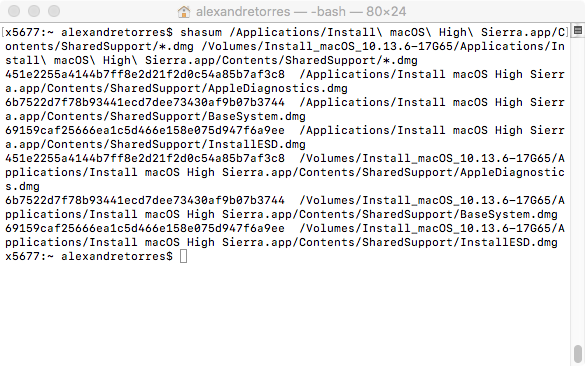

The Mac App store indicates '10.13.5' full installer, but the downloaded file is indeed the 10.13.6 installer.
I compared it with the installer in this thread.

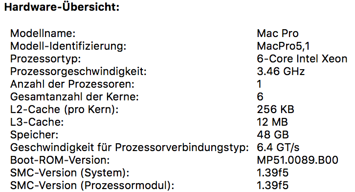

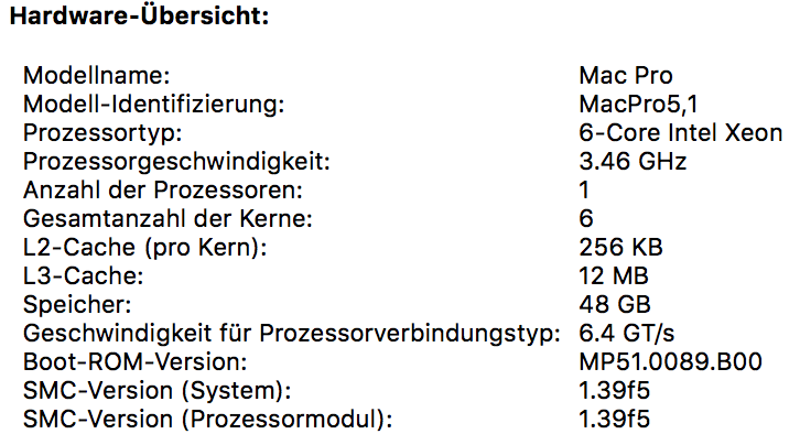

Yes, it's definitely the full 10.13.6 installer. Just upgraded the firmware.

Is there a Mac app that can do a byte/byte comparison of files/container files?
I also downloaded the full installer from MAS which the product page indicates as 10.13.5, but looking at the contents, it does indeed have the newest firmware.
I also downloaded the full installer from MAS which the product page indicates as 10.13.5, but looking at the contents, it does indeed of the newest firmware.
It's the same.
Edit: rechecked again, this time all DMGs on both SharedSupport folders.

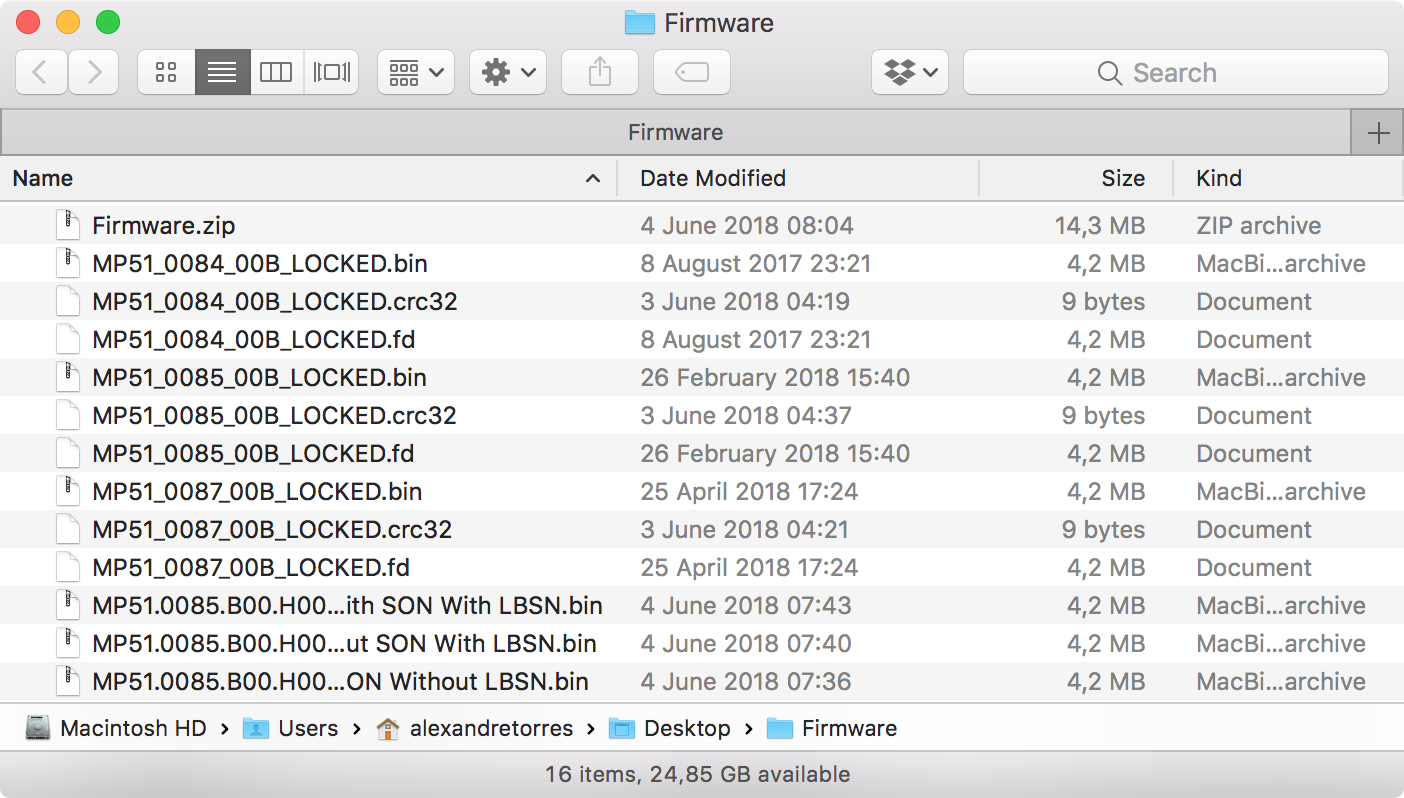

Has anyone tried to downgrade from 89 back to 85 (to re-enable the NVMe booting hack, etc) yet? I was going to flash up to 89, but want to make sure I can get back to 85 if problems are discovered in 89 or it's determined 89 can't be modded. Just being overly cautious!
Yes, I've downgraded to take the screenshots of the sysctl and check the microcode on 0085 to do the first post. It's safe.

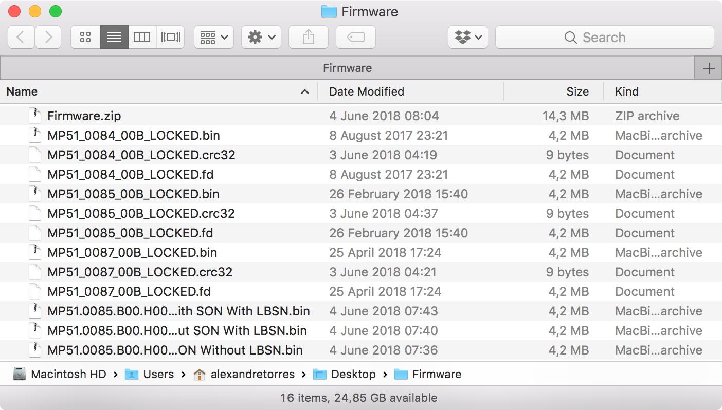

Open Mojave betas Firmware folder, rename 0085 to 0090, copy 0090 renamed file and MP51.crc32 to the 10.13.6 Firmware folder. Now you can run the 10.13.6 Installer.app and "upgrade to a lesser version".
Stupid Mac Pro firmware flasher.
Btw, my stash:
