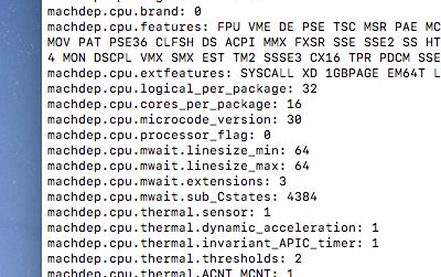

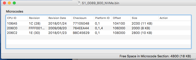

Hi there!
I have updated to MP51_0089_B00.bin and when I check my microcode it says 30, not 31 as your did?
But when I check the files as You showed they are the same?
Probably nothing important, but strange anyway.
Best regards
/Per

Hi there!

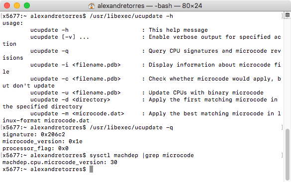

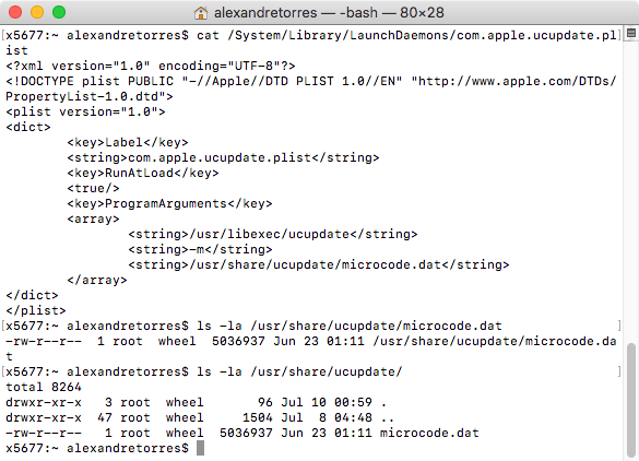

Recent macOS has a microcode updater daemon (ucupdate) and it will automatically update the microcode on the running macOS, that's how 31 showed on my sysctl.
On my work Mac Pro, the update has not been done yet, so it's like yours:
