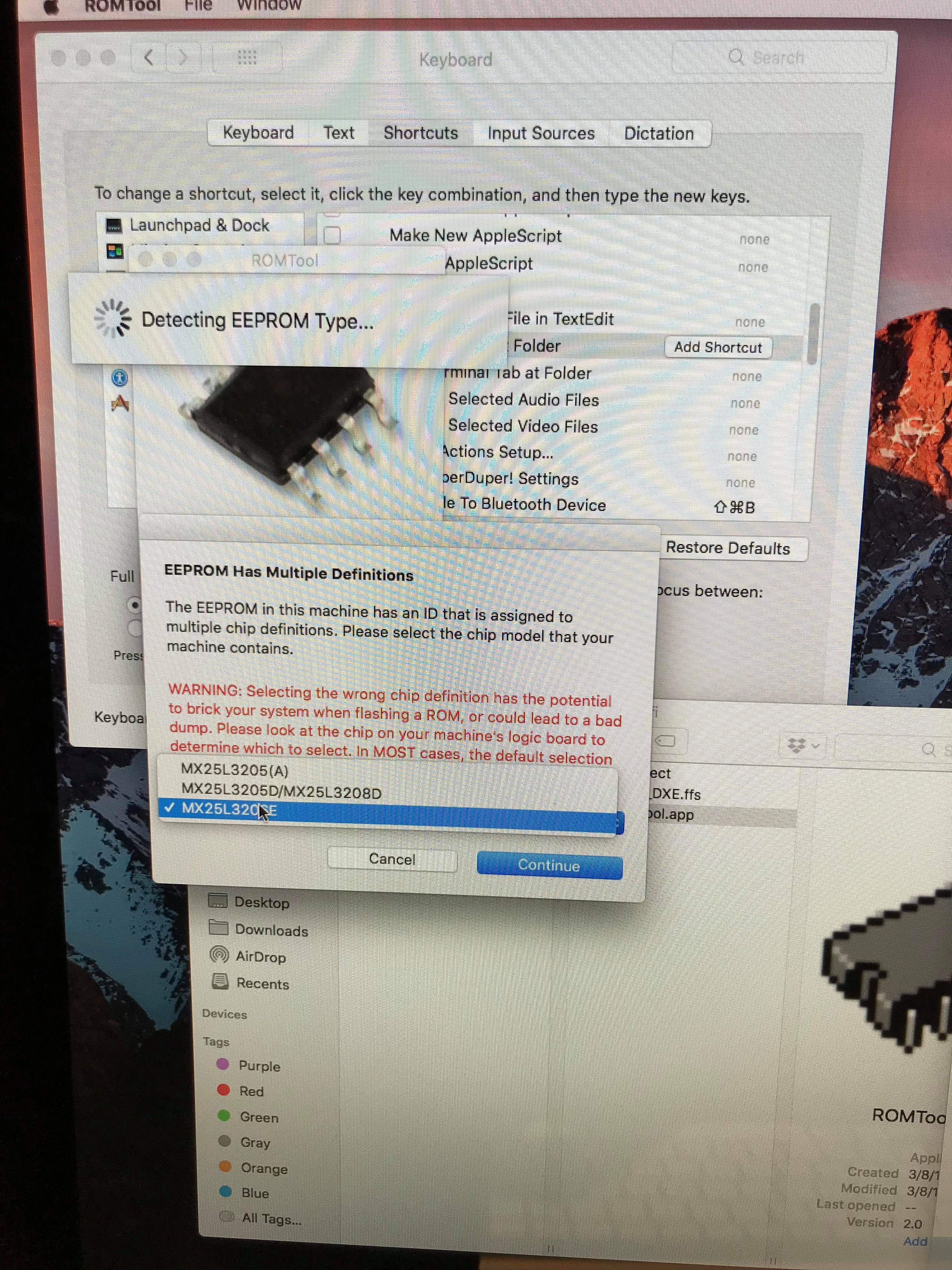

[doublepost=1544696965][/doublepost]Sorry another question:

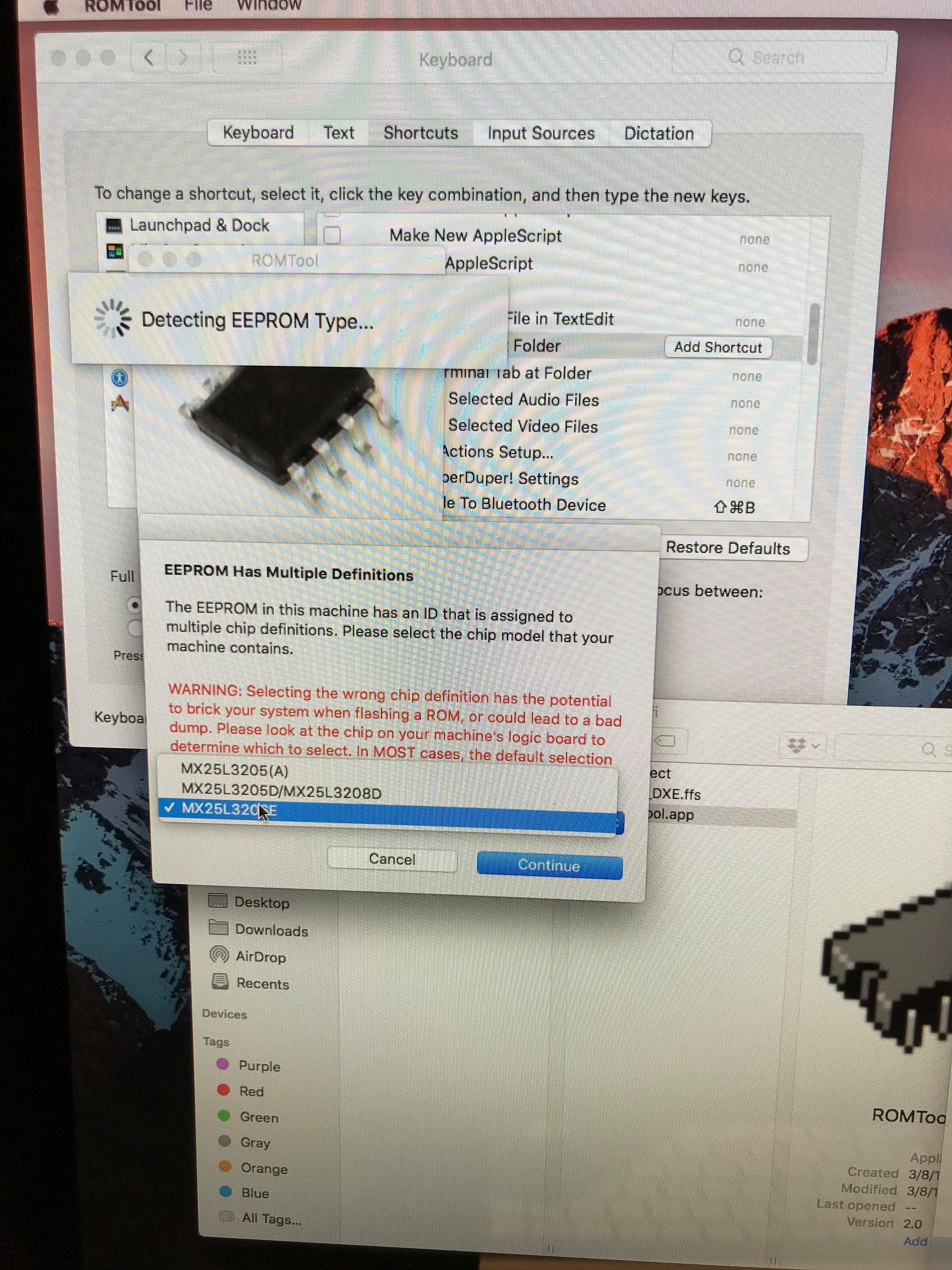

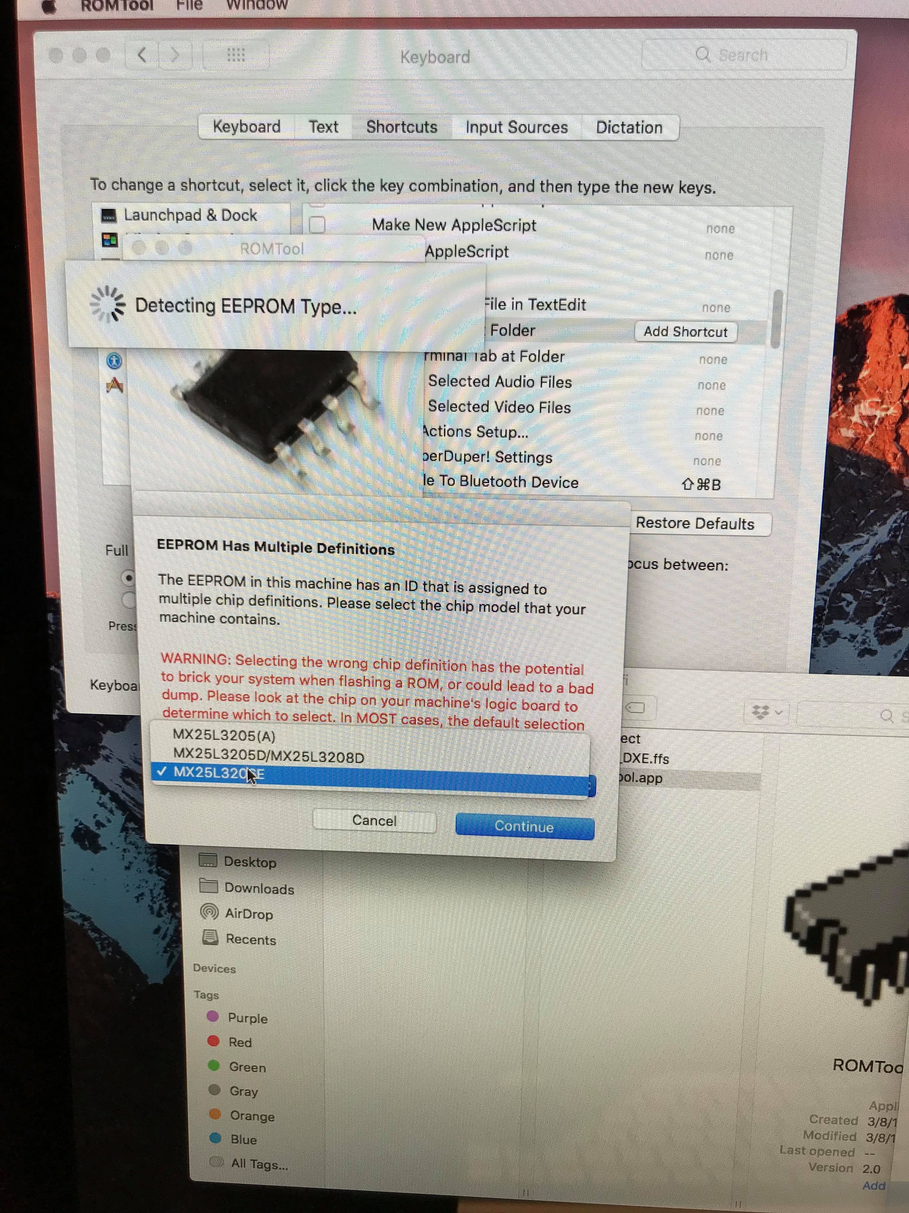

How do I go about finding the correct EEPROM ID for my Mac Pro?
I am met with this message on ROMTool and just want to ensure I don't brick anything...
EDIT: After reading previous posts, I managed to locate the EFI chip and lucky that I did, the default one was unfortunately incorrect via ROMTool.

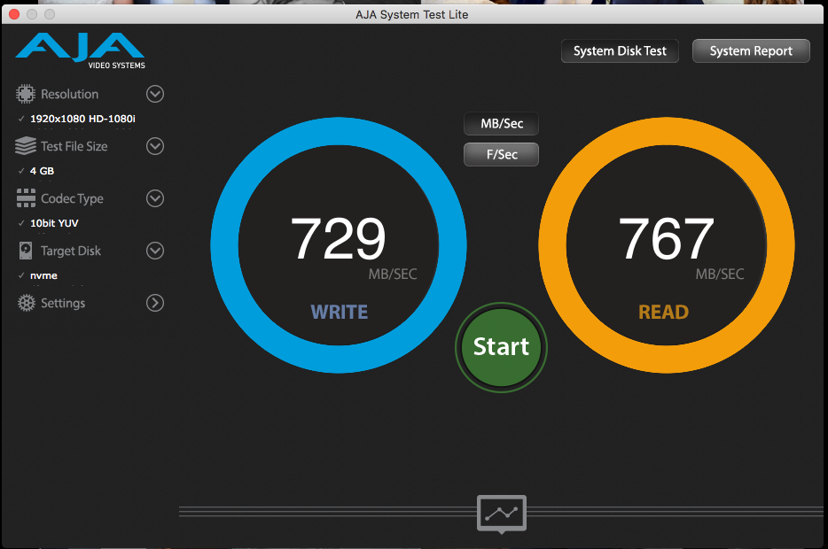

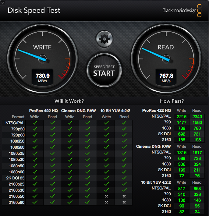

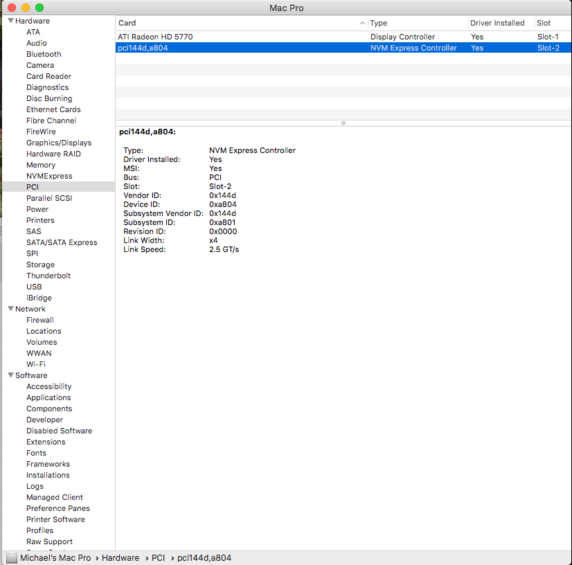

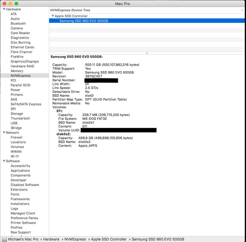

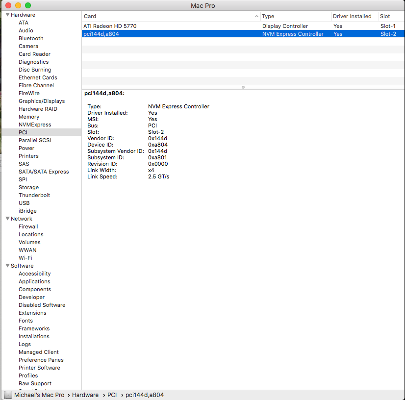

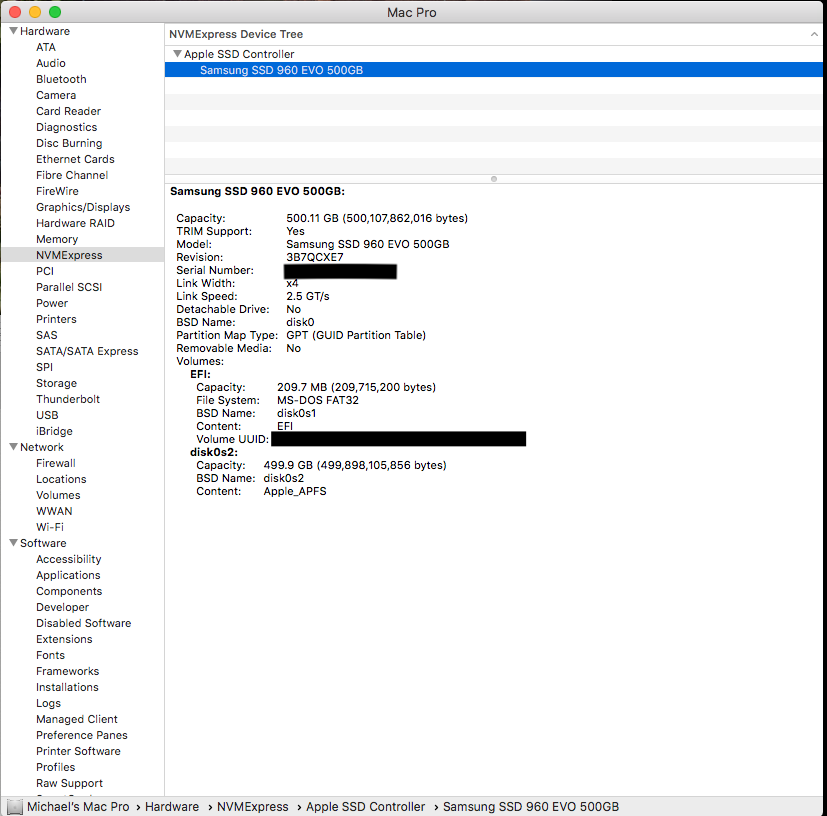

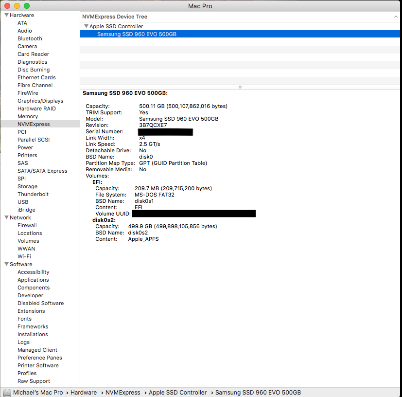

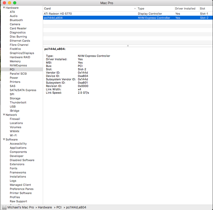

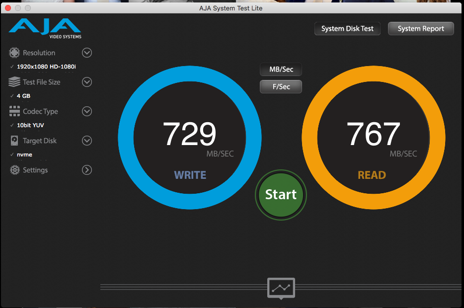

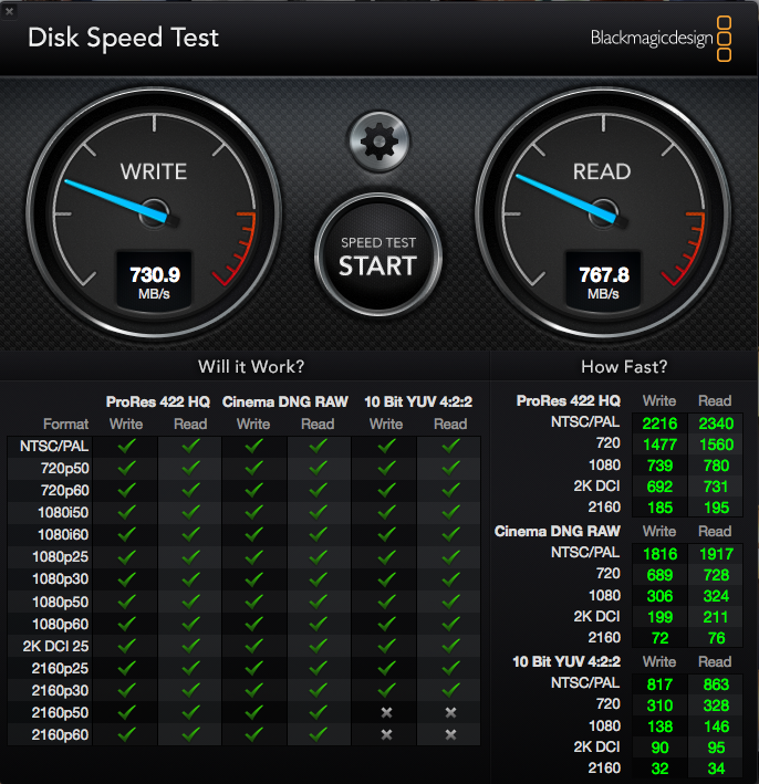

Edit: After looking at screen shots others have posted, I just realized my link speeds are only reporting as 2.5 GT/s.. Which would perfectly explain why my speeds are half of what I was expecting. I have the blade installed in slot 2. The adapter card is just a cheap one I got from Fry's for $15. It says on the box it's a x4 card. Could it be the adapter card? Or do I have a bigger problem? Maybe something in the BIOS is configured incorrectly. I have a true 5,1 machine. Mid 2010, came with the dual 2.93 Xenons. Am I in the right slot? I thought 1 and 2 were x16 slots, and the others were x4..

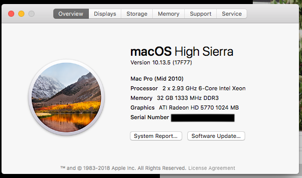

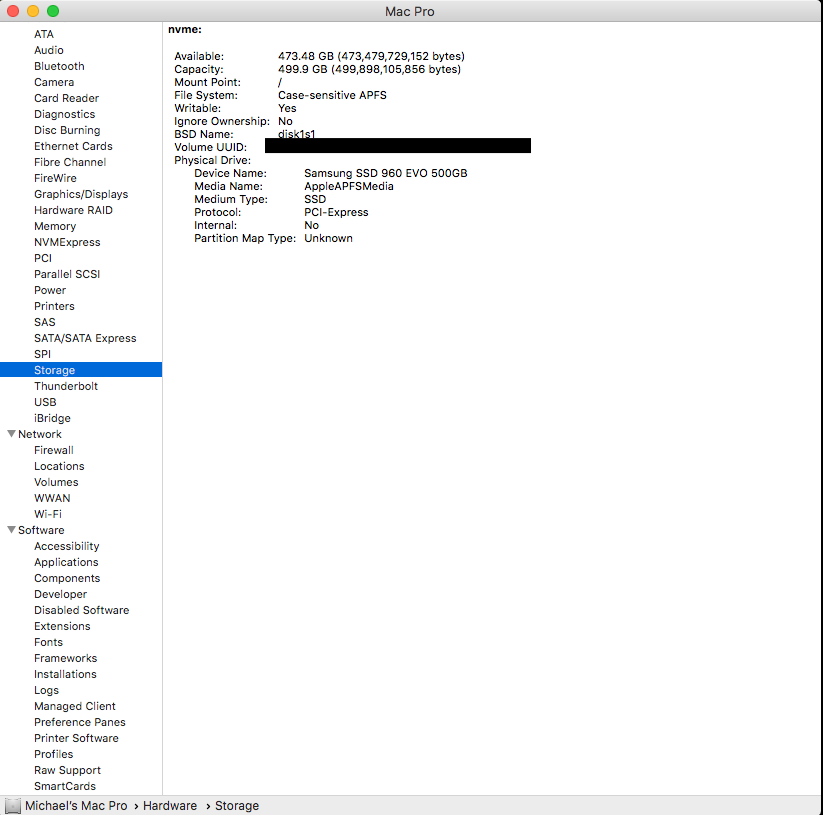

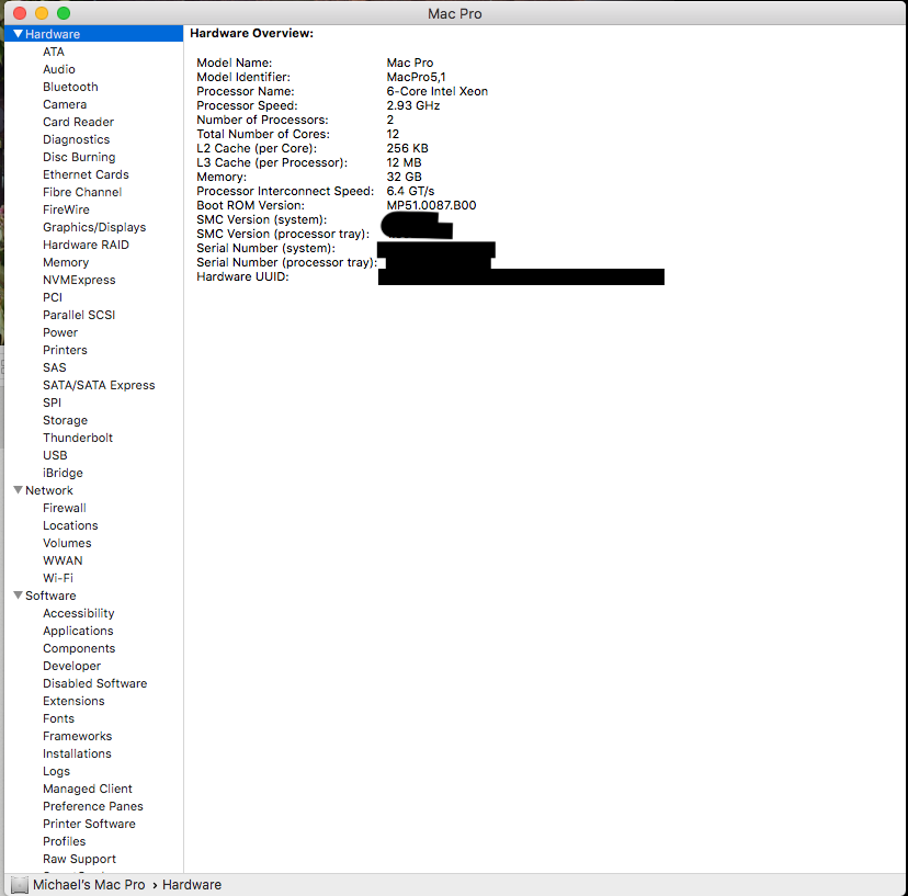

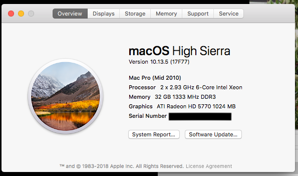

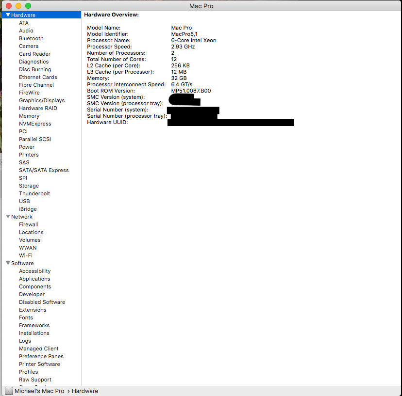

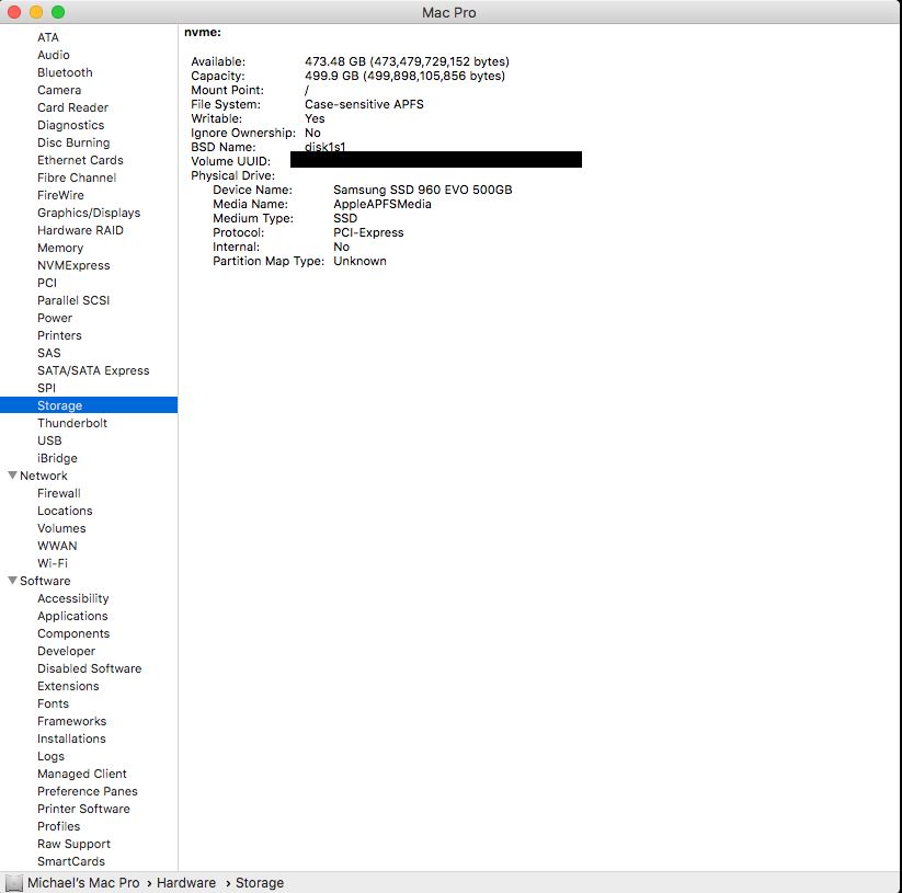

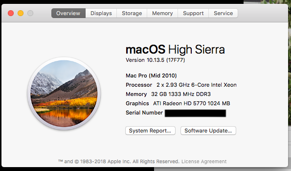

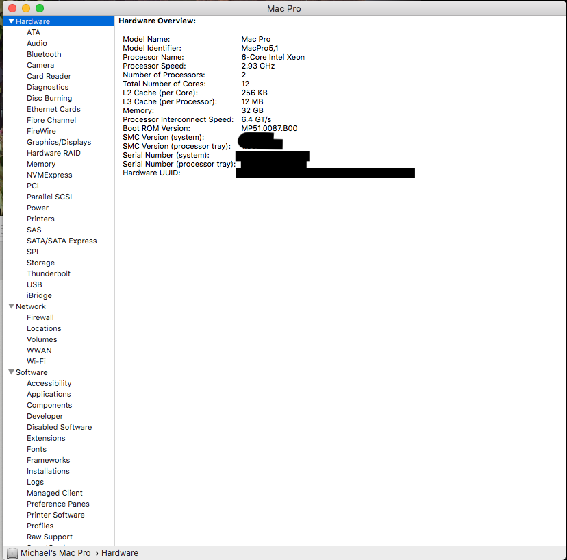

Wow, well that was an exhausting 20 hours! Thanks for all the great information, tutorials, and resources! You guys are awesome. So, I currently have my Mac Pro 5,1 (mid-2010) booting and running on a Samsung 960 Evo NVME SSD. I am on High Sierra Version 10.13.5 (17F77), and Boot ROM Version MP51.0087.B00.

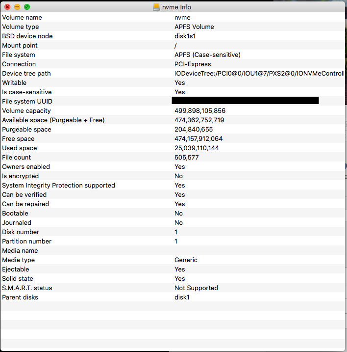

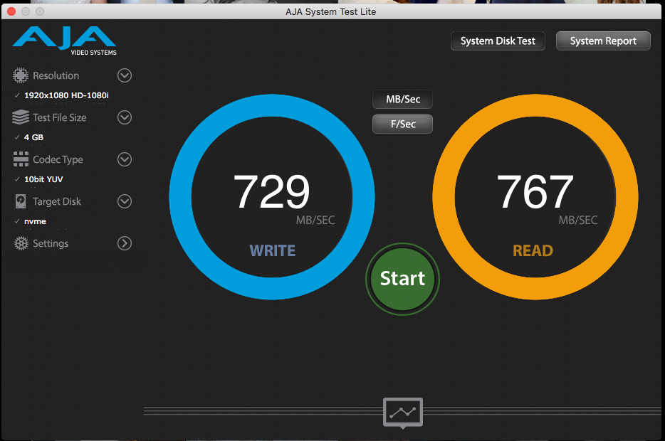

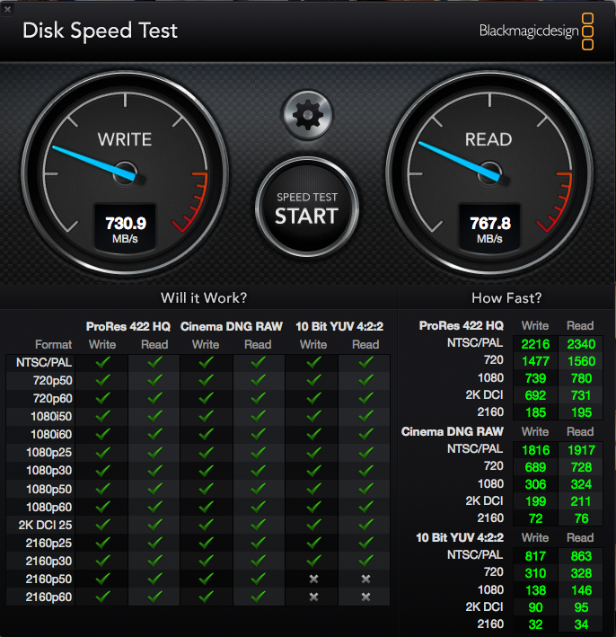

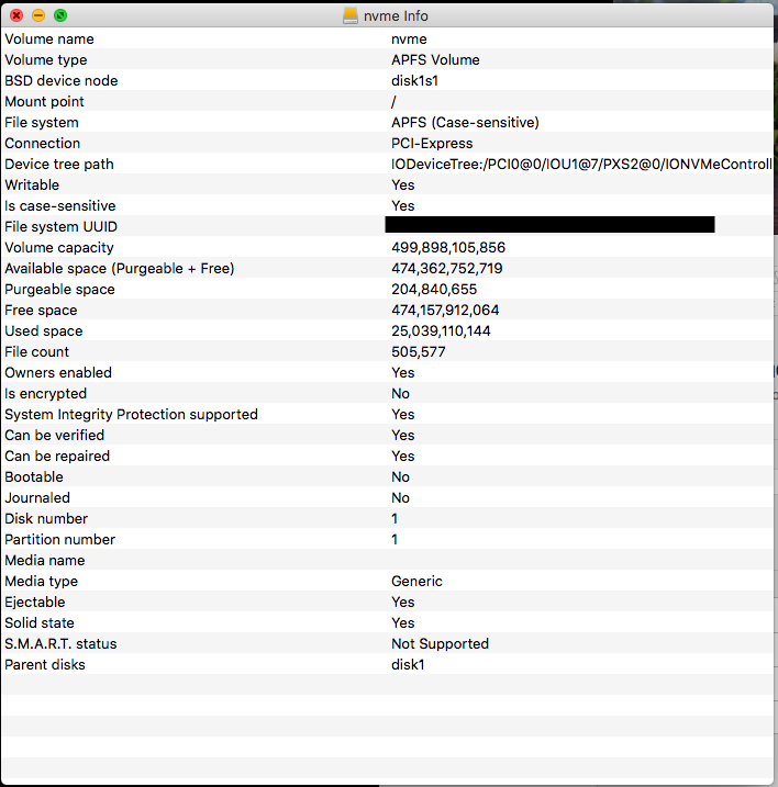

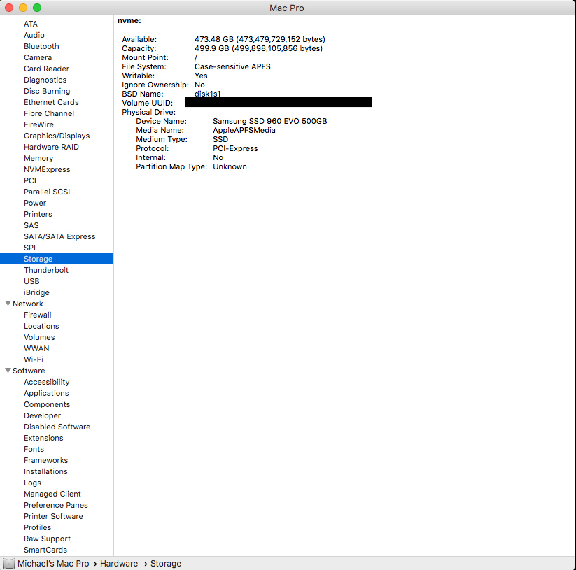

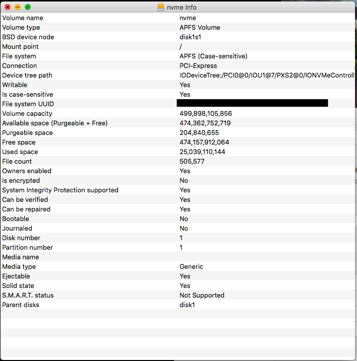

I followed the instructions on the Google Doc sheet and they seem to be working perfectly, although there were a few hiccups along the way due to me being a noob. Yesterday, I was on Boot Rom Version 84. I flashed my ROM with the updated EFI Firmware, and it worked great! I was booting and running on the NVME drive. But, my speeds were slow! Like 600-700 MB/s... I thought they were supposed to be much faster, at least it seems like others are getting much faster speeds. So, I started looking around and noticed my Disk was formatted as Mac OS Extended, and not APFS. I couldn't figure out how to reformat without doing a clean install, every time I tried recovery it would keep the same file system. I couldn't think of anything else that it could be, so I went ahead and did it. Anyways, it make the rom hack obsolete, and I was back to square 1. I only have 1 Sata SSD that was in my PC. Long story short I cloned that drive to an old spinner laying around, then wiped it, put it in the mac and did a fresh high sierra install on the SSD. I couldn't for the life of me get a spinner drive to format in APFS. Once I got that set up I was able to once again flash the rom following the steps in the drive doc. I was a little weary because it seems like people have been having mixed results on boot rom version 87, but what the hell.. I then put in the NVME drive and restored to that drive from the Sata SSD that I had just installed. It worked! I powered off, took out the sata drive, and am now able to boot and run great with only the PCIe NVME 960 Evo in a x4 adapter.
So, once again, THANK YOU! Now, one question for you brilliant people. My speeds STILL seem to be slow.. Do I have a defective blade? Is this not slow, and I'm just ignorant? I'm still getting around 700 MB/s on all the tests I run. The drive is in APFS format.. I can't figure it out. Any help would be appreciated. See attached photos. View attachment 767232 View attachment 767233 View attachment 767234 View attachment 767235 View attachment 767236 View attachment 767237 View attachment 767238 View attachment 767239 View attachment 767232 View attachment 767233 View attachment 767234 View attachment 767235 View attachment 767236 View attachment 767237 View attachment 767238 View attachment 767239
