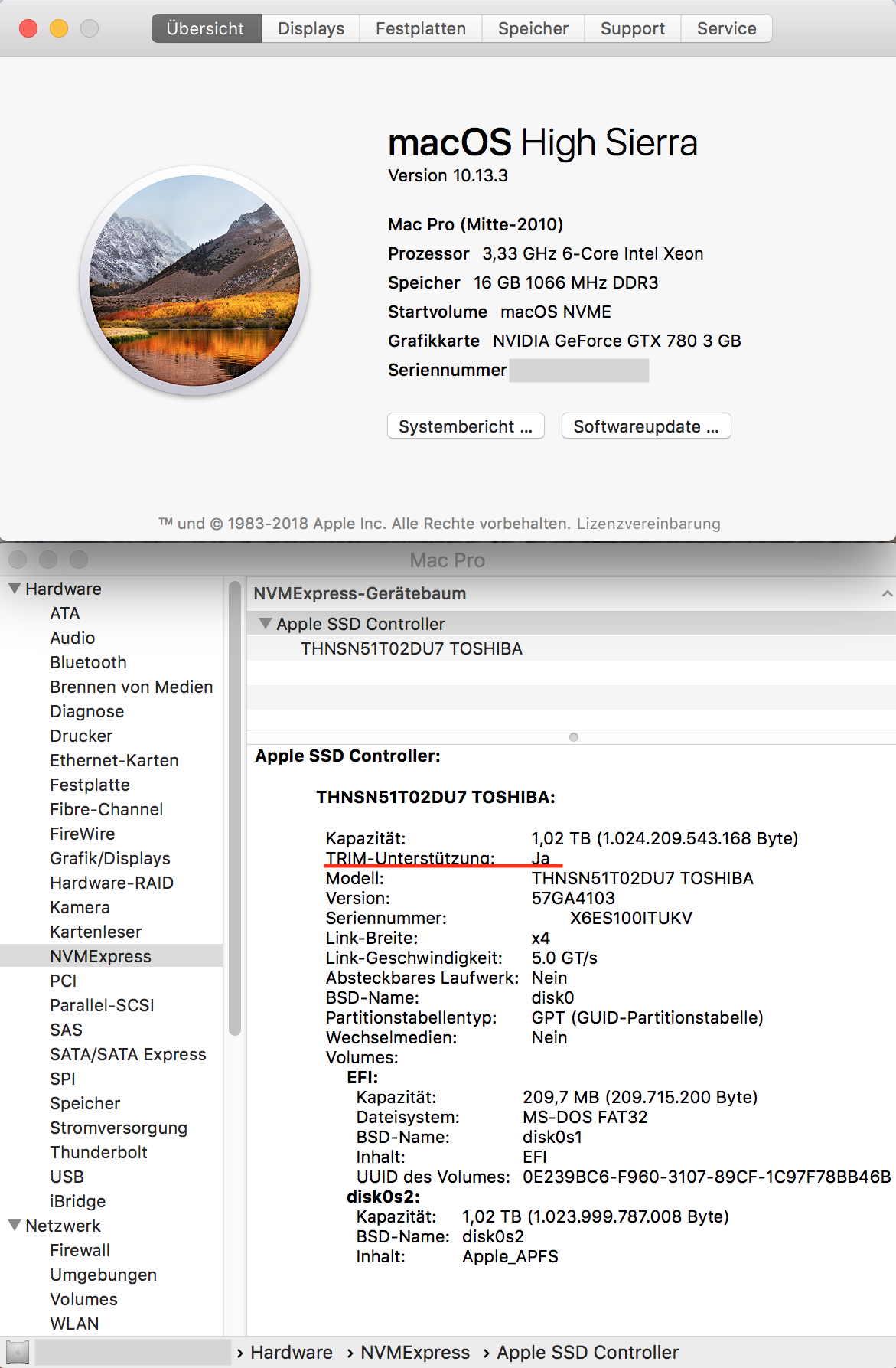

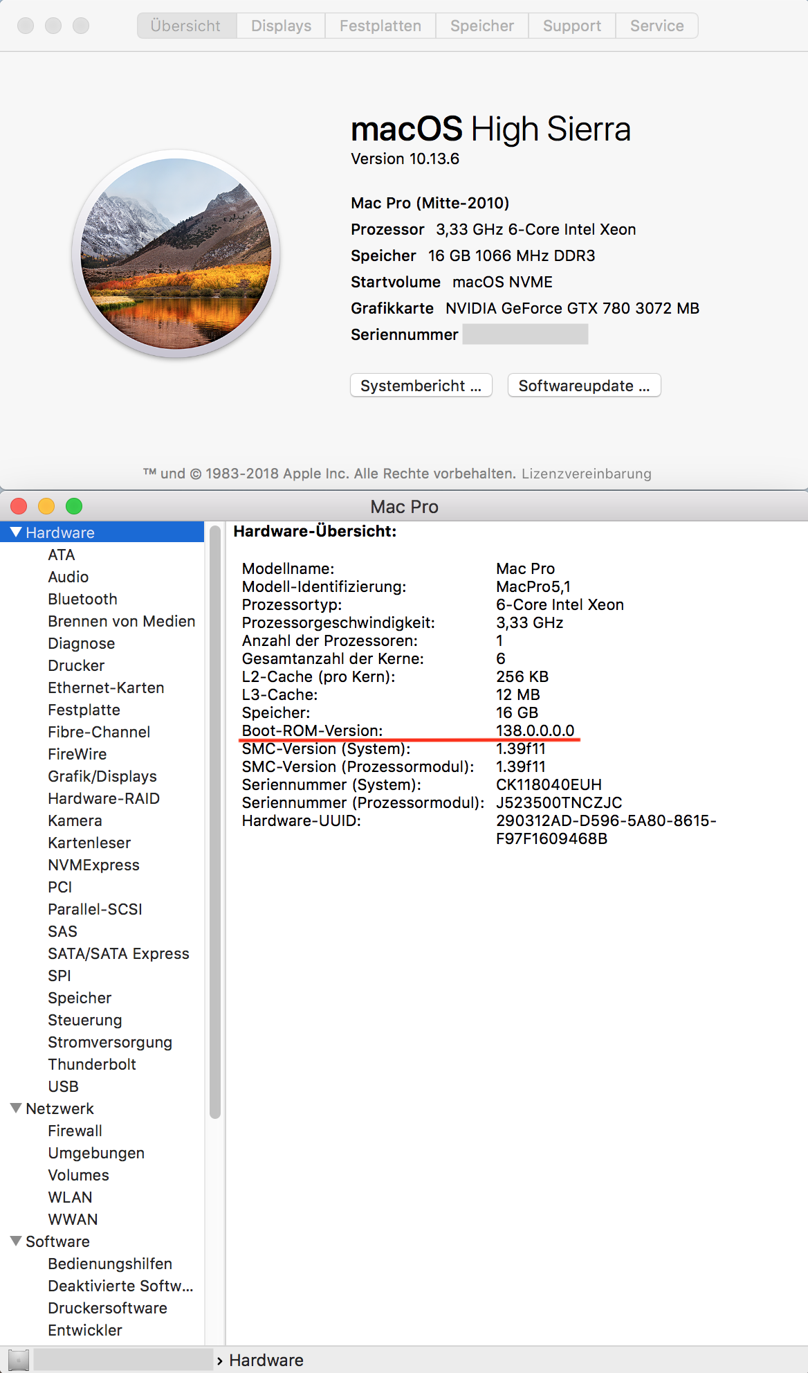

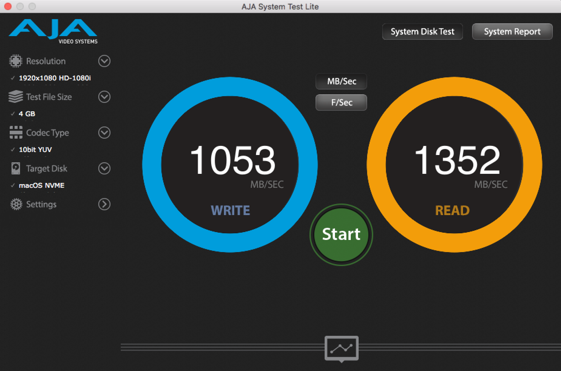

Thank you for the quick reply. I already followed the steps and successfully booted nvme. My Preview app is crashing while editing my screenshots I'm attaching here (while cutting screeny-->beachball-->then crash)...My results seem normal compared to the bugs in preview. That's why I'm asking. Hope they will improve some performance. I have the ssd in the 3 port.

Thank you for the quick reply. I already followed the steps and successfully booted nvme. My Preview app is crashing while editing my screenshots I'm attaching here (while cutting screeny-->beachball-->then crash)...My results seem normal compared to the bugs in preview. That's why I'm asking. Hope they will improve some performance. I have the ssd in the 3 port. View attachment 782115
  1. What's your BootROM?
  2. What's your NVMe SSD drive and adaptor?
  3. Do you have TRIM enabled?
  4. What's your Mac Pro model, it's dual/single, what's the Xeon?

What do you mean with XG5? What about the issues with preview? May it be bootrom related?
Toshiba XG3 (or OCZ RD400) - I corrected that.
You are getting the expected throughput for your SSD, it's a 2015/16 one. You can get better read speeds with a HighPoint SSD7701a card.
I don't think BootROM corruption can cause Preview problems, test with a clean install before thinking about firmware.

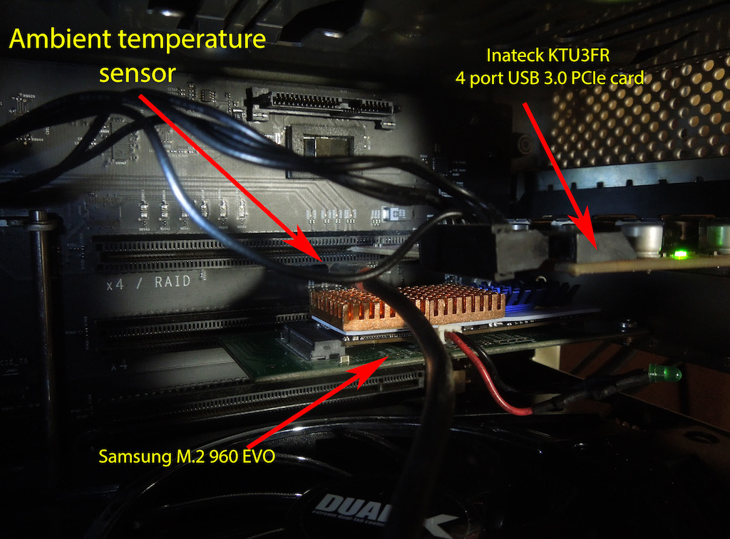

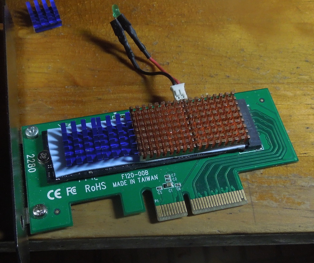

A little off topic : Keeping an M.2 SSD cool
I have been running High Sierra 10.13.6 since it went GM booting from an M.2 Samsung 960 EVO.
I have tried several M.2 adaptors but settled on an Ainex model - without heatsinks.
Since then I have removed all 3.5" SATA II drives from the cMP's internal case - removed my DVD drive and the assembly and now have two SanDisk SSDs happily installed there.
the resutl seemsto be an overall increase in cooling throughput but not satisfied as I have a Sapphire Dual-X 7970 + the M.2 adapter + an Inatek Inateck KTU3FR-4P1 4 port all installed in PCIe slots
I had some spare copper heat sinks lying around so I cleaned them up and put three of them on the Samsung M.2 960 EVO 250 GB.
I placed an " ambient temperature sensor " right on to of one of the M.2 adaptor's copper heatsinks.
After three hours of solid operation the ambient temp. shows as a steady 32°C ( 89.6 ° ).
It's still pretty warm here in Japan but up until three weeks ago we were getting solid weeks of 40°C ( 104° F ).
I'm pretty pleased with the result.
