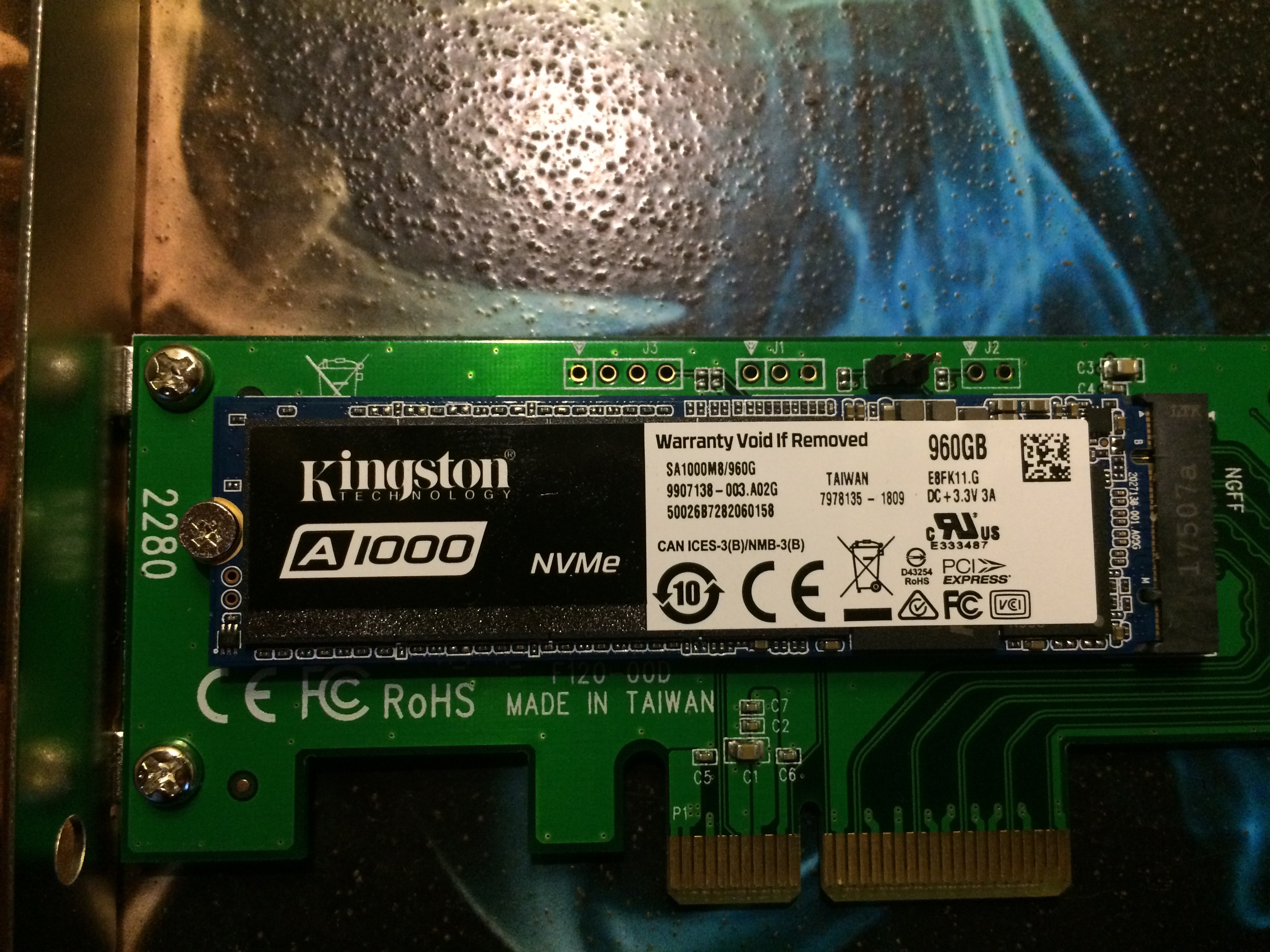

Hi!
Just bought Kingston A1000 NVMe ssd.
I have macpro 5.1 and macpro 2009, with firmware updated to 5.1
macOS 10.13.6 on both
In 3 PCIe slots this drive have a speed for both write/reading only 382mb/sec (even in 16x slot) and only in one slot it have 743mb/sec (but not 1300!!) This result same on 2 computers, I have tested different adapters m.2-PCIe with same result. (also I have tested with adapters from AHCI kingston predator ssd, who have 1300mb/sec on my computer)
Any ideas? can kext modifyin magic be better then native Hi Sierra support for NVMe?
may be cause of slow speed is not fresh firmware of ssd?
If I load in windows 8.1, windows see this drive, it appears as a volume. But Kingston SSD Manager v1.1.1.5 program not see it. It see AHCI drives, but not see this NVMe - any ideas?

You have to upgrade your BootROM to Mojave 10.14.1DP3 140.0.0.0.0. It's the only that have native NVMe support and 5GT/s. If you don't know how to do it, I can PM you instructions.
Read this two first posts:
BTW, the first version of A1000 NVMe SSD is slow as a SATA one. Take a picture of the label and I can tell if is the first revision.
