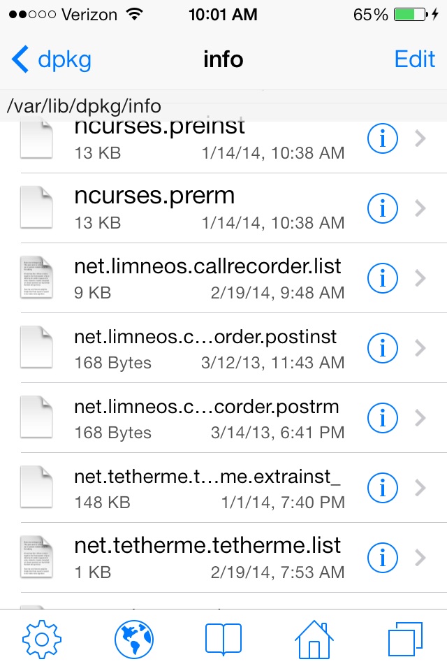

I saw someone on the last post show you a list of some files so I got iFile and found the file you mentioned. Here is a pic of that file if it helps.

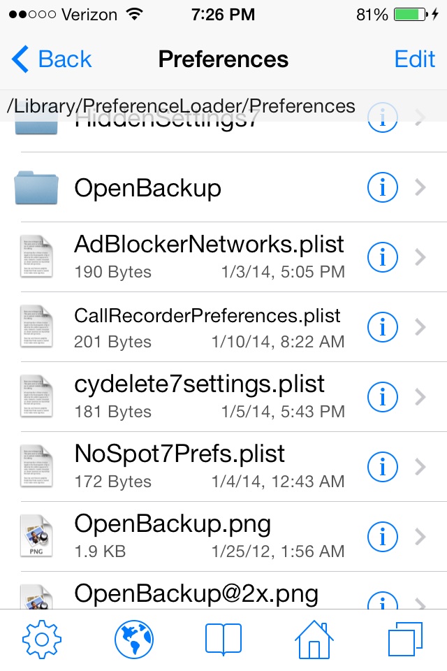

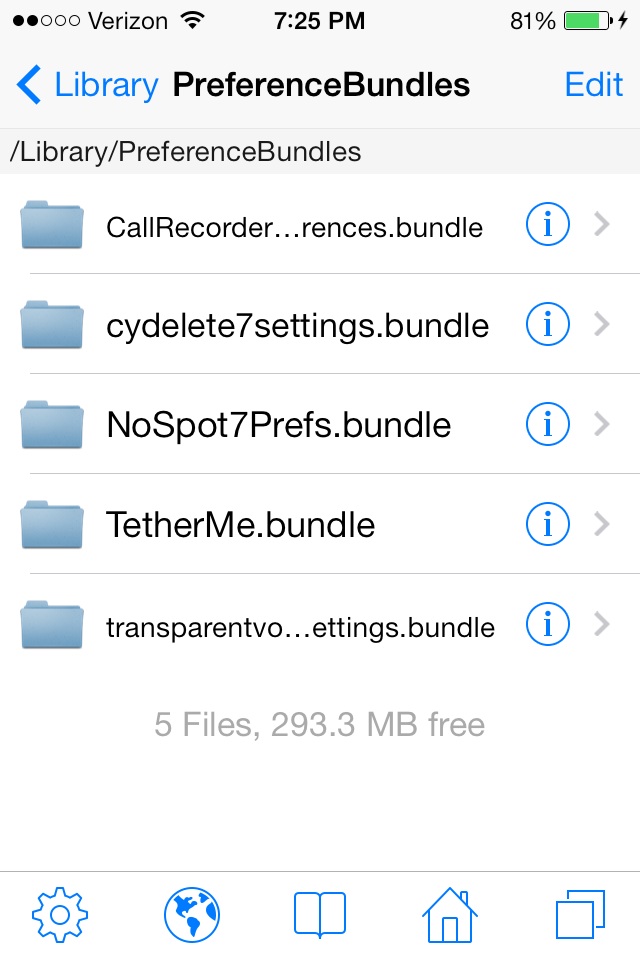

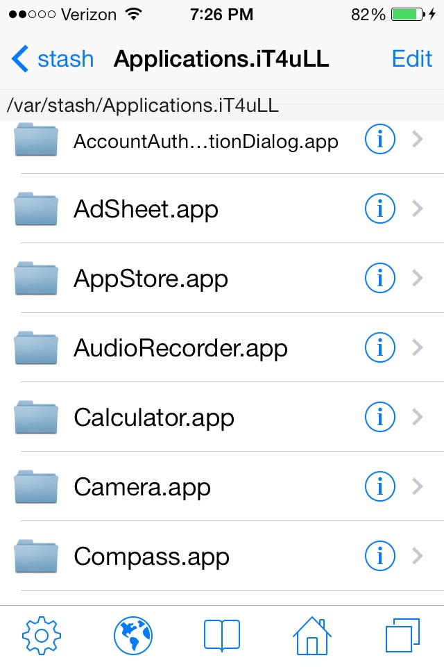

Strange - as opposed to the previous poster having the same problem, your configuration is right.
Could you check whether you have the following directories:
/Library/PreferenceLoader/Preferences/
/Library/PreferenceBundles/
/Applications/
Yes sir, all of them are there.
It seems to be OK.
