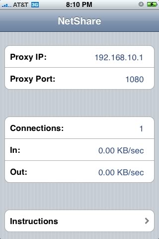

This has probably already been said but I will say it again because I had to re-figure out what I was doing wrong.
Yes Netshare had 192.168.10.1 in the Proxy IP settings slot; indeed all settings were correct and yet I could not connect.
What was wrong with this picture is that where there should be a 3G icon next to the AT&T in the upper left corner there was a WIFI icon. The way I got the 3G icon was I simply got on the internet via iPhone Safari. Once I this happened I reactivated Netshare. Everything worked from then on perfectly.
You MUST have the 3G icon for Netshare to work.
Or the edge icon.
My iphone looks identical except for one conspicuous difference; I have 0 Connections where you have 1. Oh yeah, I have no access to the internet on my Mac. I can ping the iphone from my Mac. Don't know if this is meaningful or not.
You just solved my problem for me. Thanks for that.
