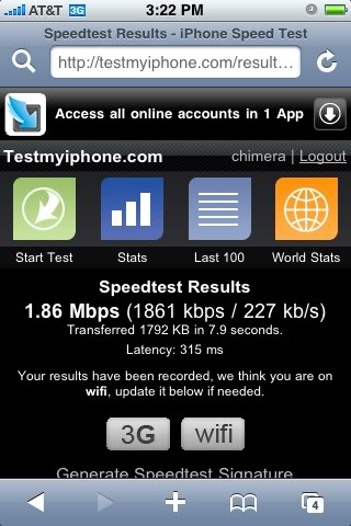

Dunno bout that. I'm getting this on my 3G iPhone:
And the Jailbreak speed using Terminal goes sometimes over that.
As I've said before the Netshare speed is half the jailbreak speed, which is in line with what you all are getting, around 800 to 900 Kbps.

That site has 0 accuracy. It fluctuates way too much. And a test with my laptop shows 8-12 Mbit depending on which try u wanna count. When in fact my laptop should be getting around 35 Mbit as it does with real tests. I wouldn't trust that site for one second ;)
