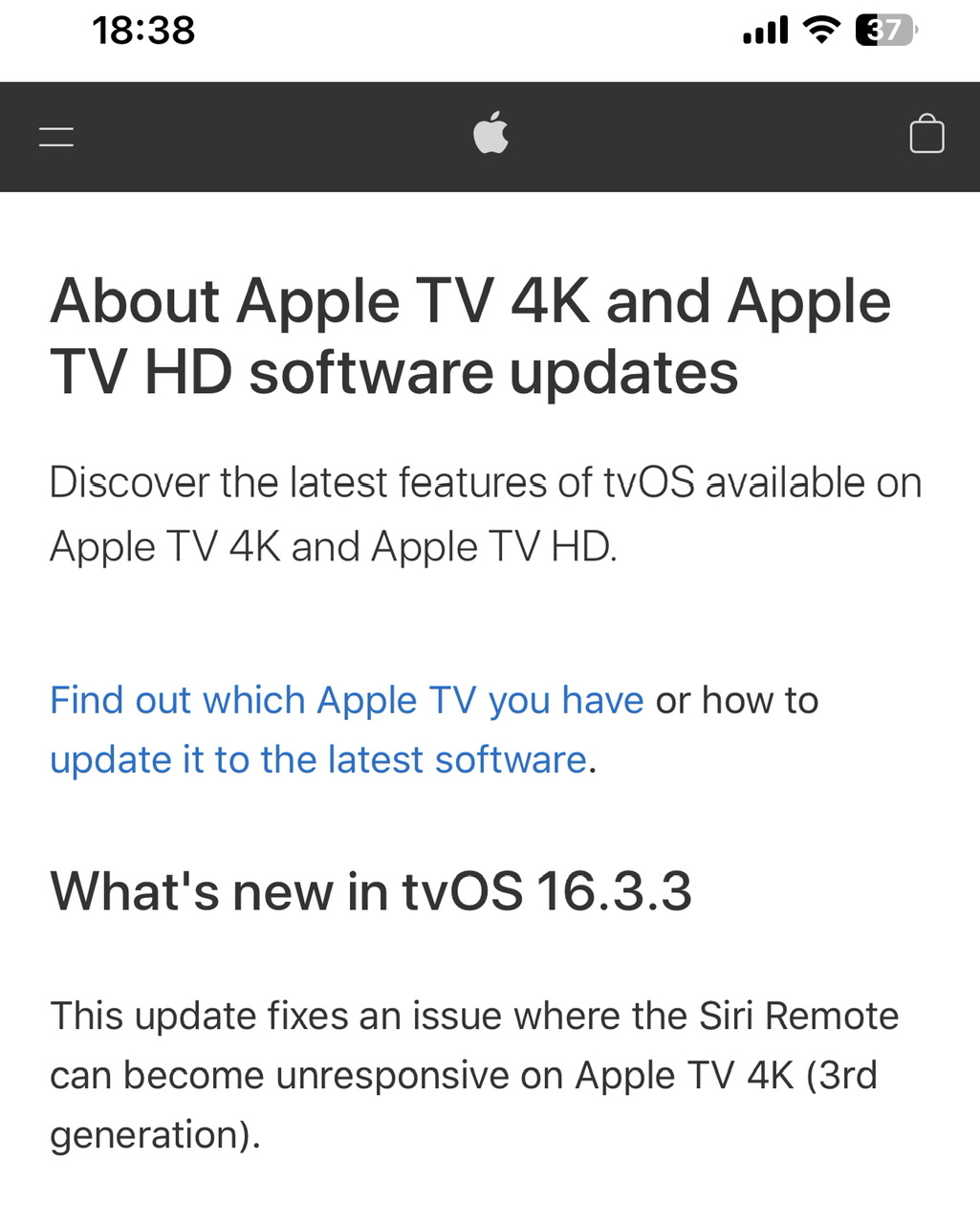

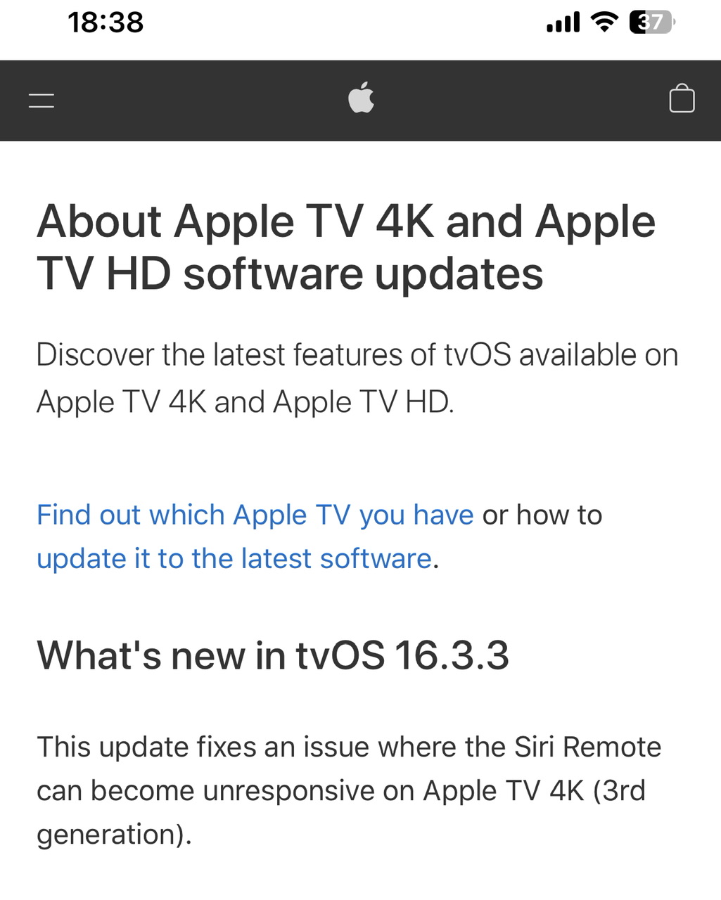

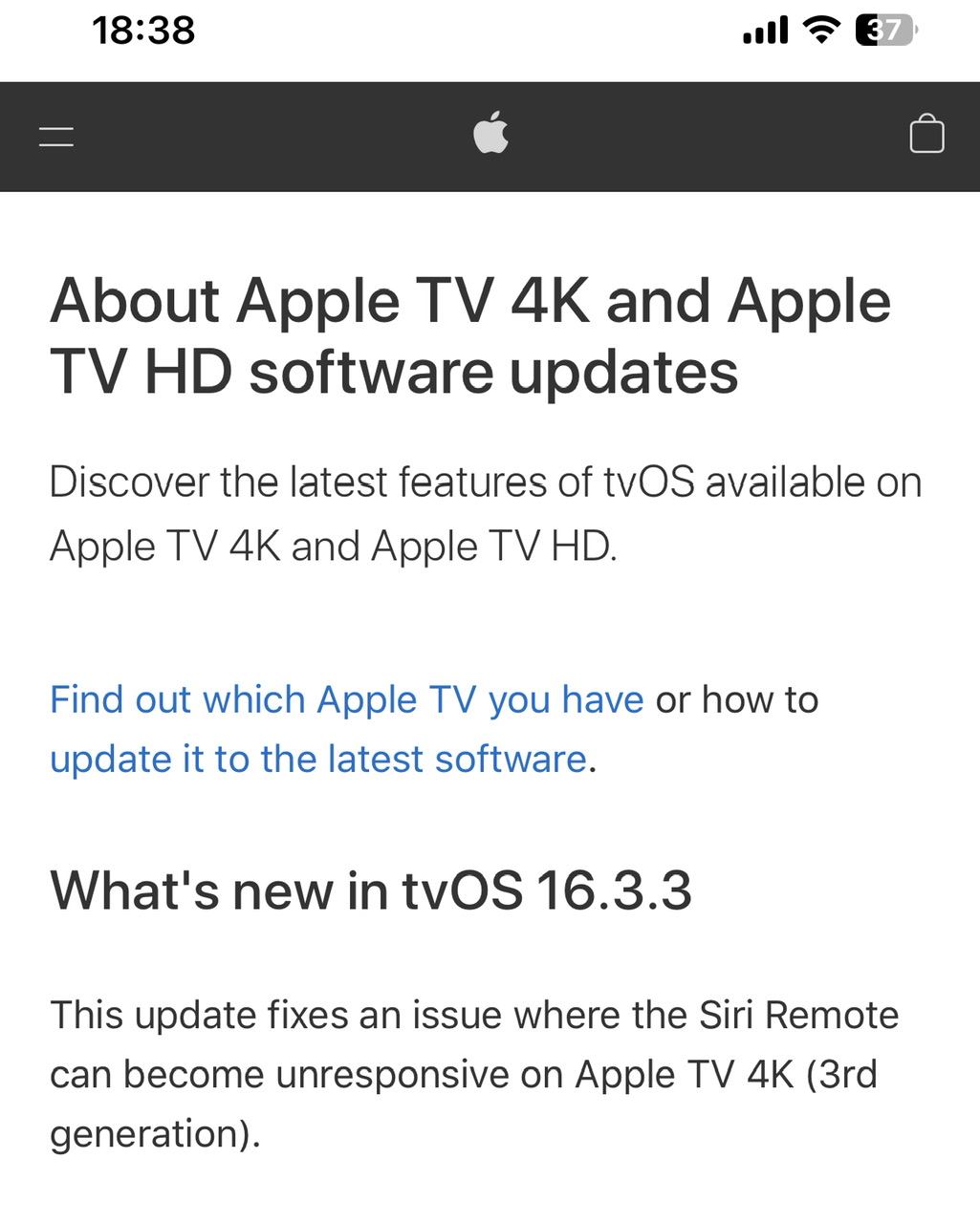

tvOS 16.3.3 available for download
It's interesting that the description only notes the ATV4K 3rd generation. I had this happen twice on my second generation (although it hasn't happened in about 2 months now).
It happened once after the 16.3.3 update. I haven't seen it happen again, and I've already updated to 16.4. I'll test it out again tonight.
