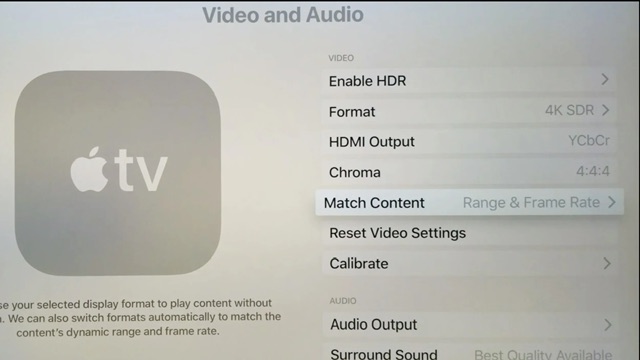

That all sounds interesting but are you talking about changing options on your tv or on the Apple TV? Can you give some directions where to look for those changes? I'm just running HD, not 4K and mostly I'm streaming movies from my computer. I don't know how changing the chroma setting on the TV would affect the bluetooth remote to Apple TV. Or even changing Chroma on the Apple TV (if that's what you're talking about) because There really shouldn't be any relationship between the chroma setting and bluetooth.
For me at least Apple TV set to 4KSDR, HDMI Output to ycbcr then the chroma option will be under that as seen in this screenshot.
Thanks. but does anyone know why this would affect the bluetooth?
As far as the ATV4K 1st gen was concerned it was just down to interference through the HDMI cable when using higher bandwidth video.
Lower the video bandwidth and no more interference.
