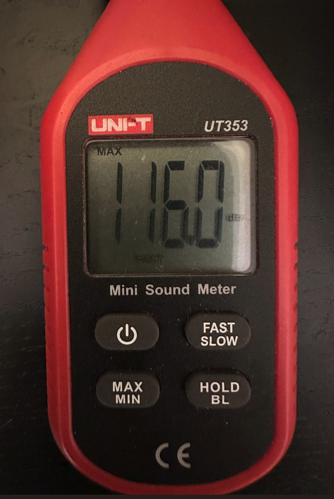

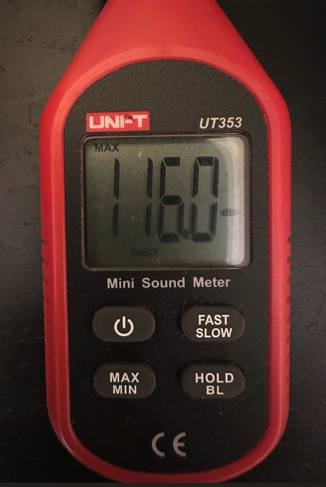

here is the dB reading during phone call on upper ear speaker when "ding" notification sound kicks in.
It was measured few milimeters from speaker.
UPDATE: iPhone wipe and restore with clean start without backup will not help, just tested it...
