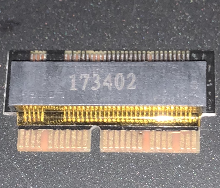

Perhaps try to reapply the kapton tape, just to be sure? I'm not sure what else could be different.My previous adapter was also a Sintech and it worked fine with a Samsung EVO 960. Same set up in this new computer and no go.
And you're trying these in the Mac Pro 2013?I have the sintechs adapters..![]()

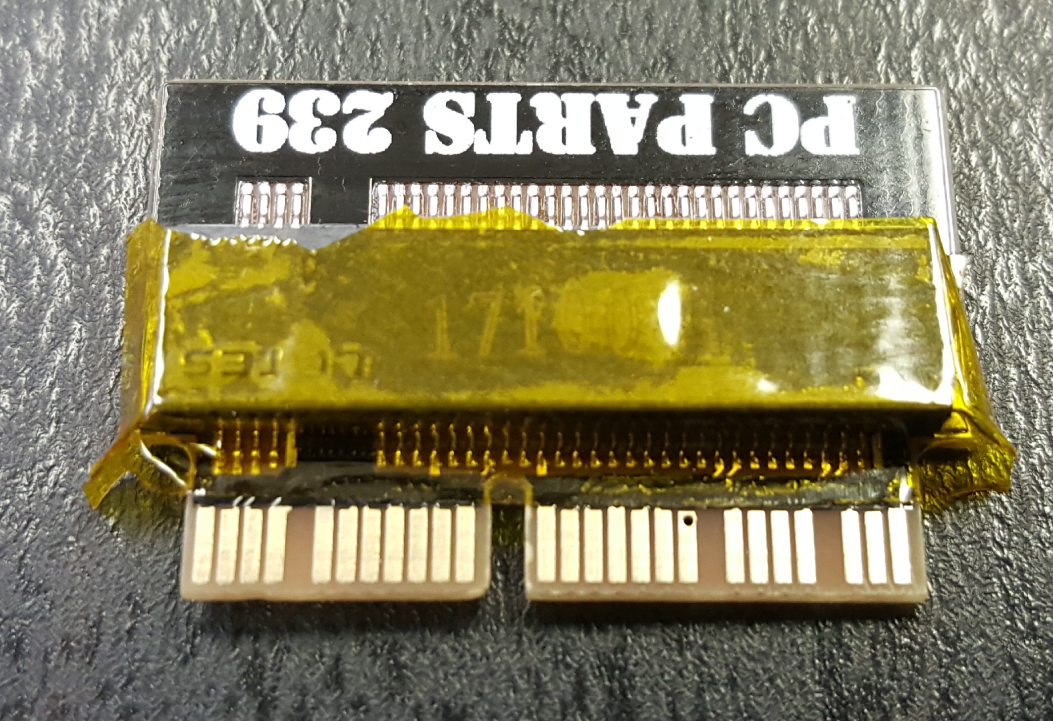

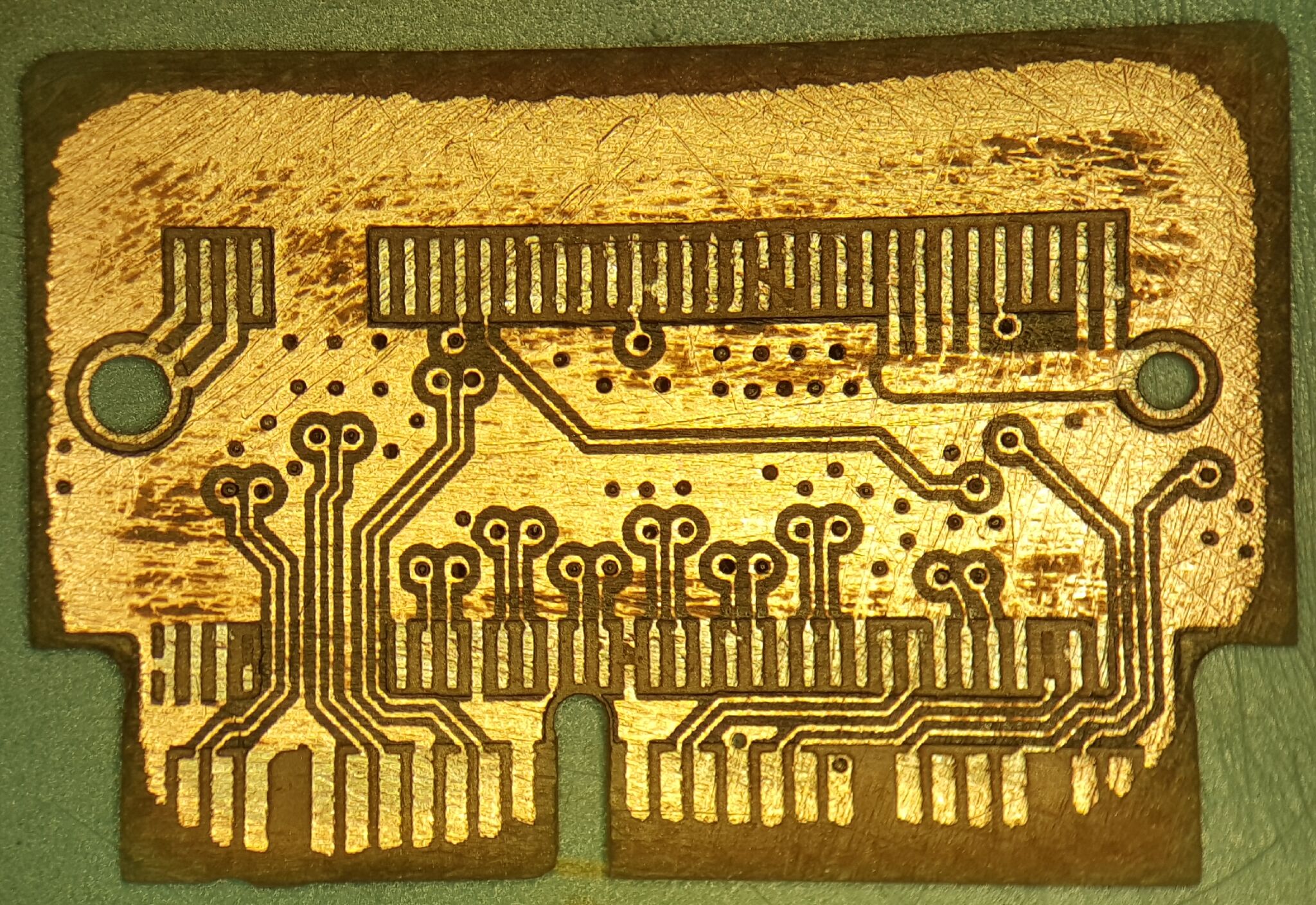

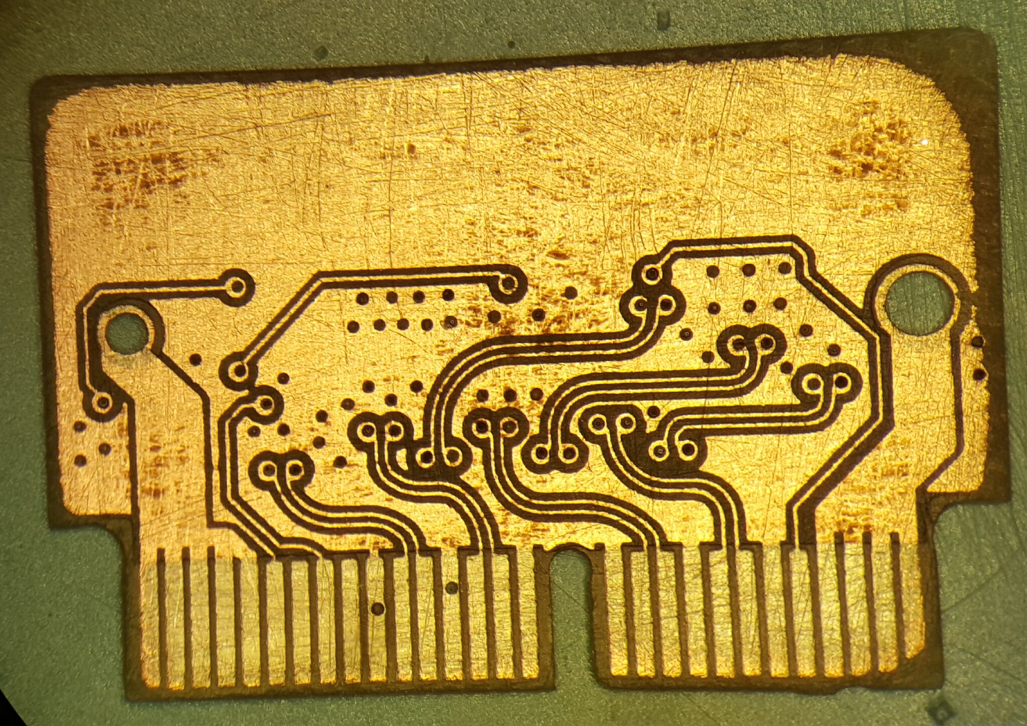

- Your adapter looks to be the Chenyang/CableCC one. Several people reported problems with it. The ones from Sintech and PC PARTS 239 seem to be working properly (including sleep, reboot etc.).
- Make sure the adapter is properly seated and aligned. If it isn't, it might work with fever PCIe lanes (= slower) or not at all.
- Taping the adapter with EM shielding (e.g. Kapton tape) is recommended to prevent EM leaks / shorts.

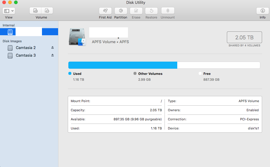

- High Sierra's Disk Utility may not show uninitialized devices. If your SSD isn't shown, try this:
- Open Disk Utility
- Click the top left button in the toolbar ("View") and select "Show All Devices"
- Relaunch Disk Utility

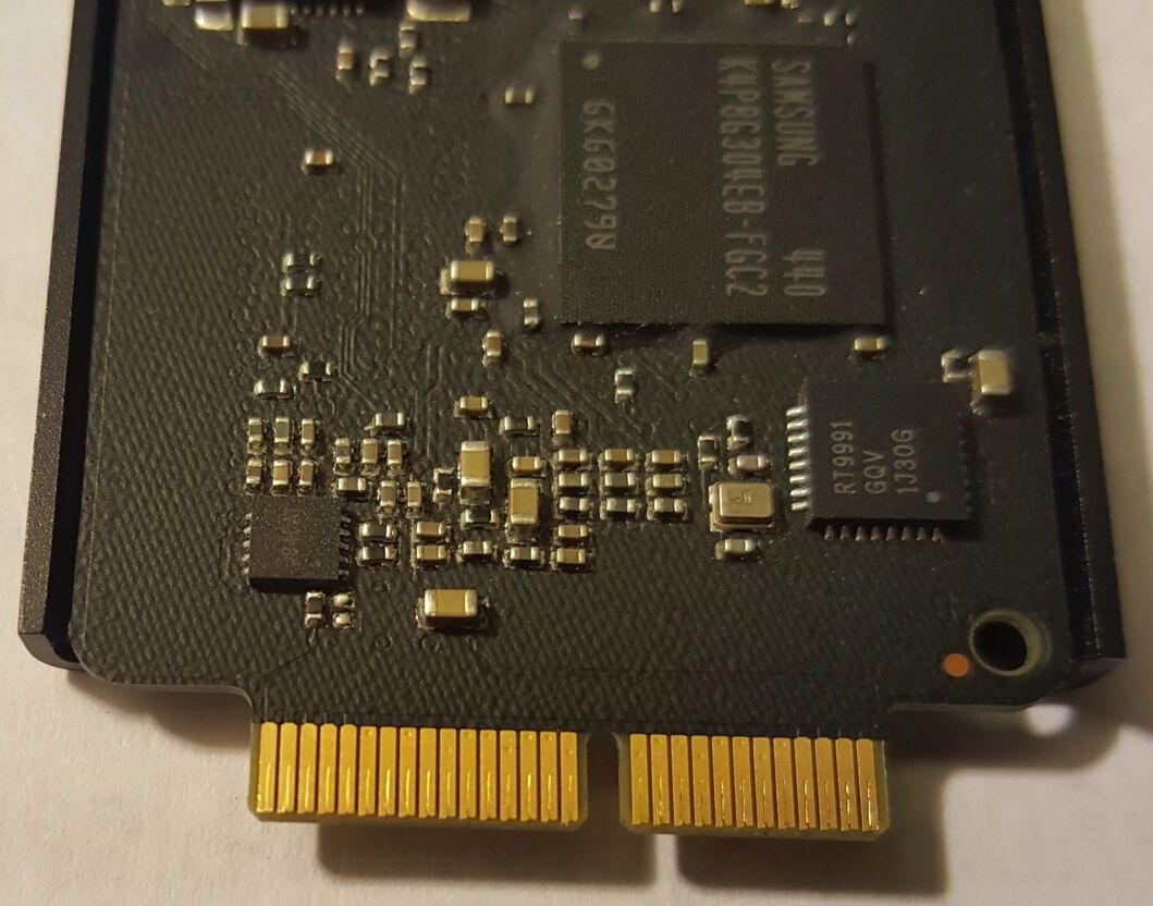

I have two questions. I see no thread about NVMe on the trash can Mac Pro, so I made a new thread.
1 - Does Mac Pro 6, 1 (2013) support NVMe drive type and if not is there a firmware hack? I know iMac Pro coming in December is supporting NVMe, but that support may not trickle down to the trash can Mac Pro. Update; it does work. Internal drive in the Mac Pro 2013. Booting even!

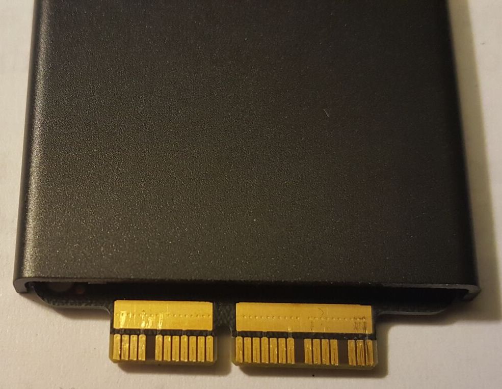

2 - Apple's proprietary connector for M.2 is double height with an extra row that is two solid pads on one side. Does anyone know where to get an M.2 adapter dongle that supports this double-height connector format? Update; the two solid pads are connected to ground.

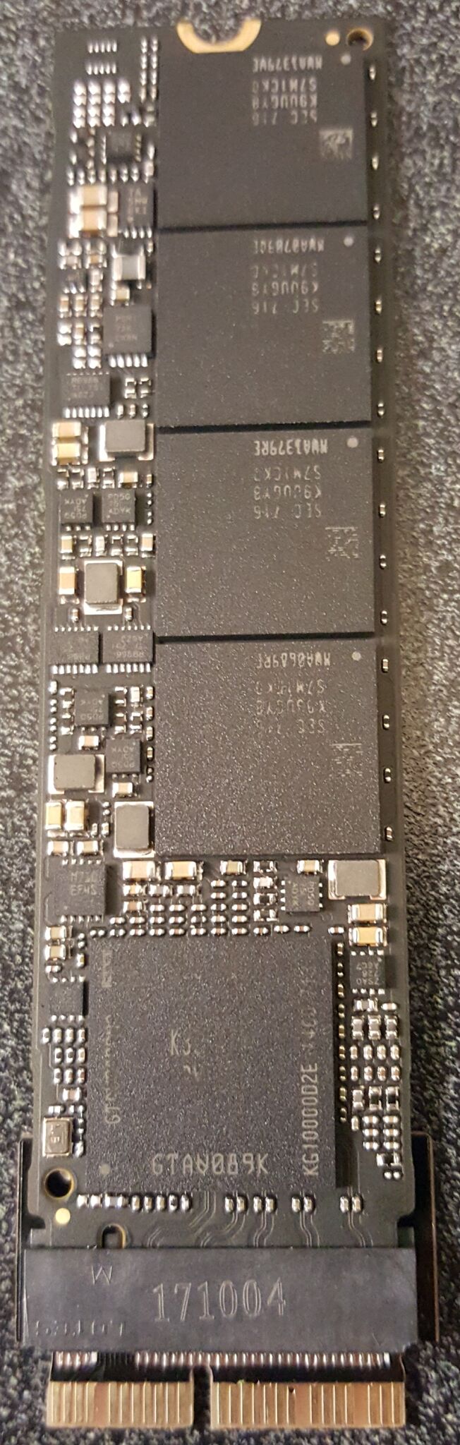

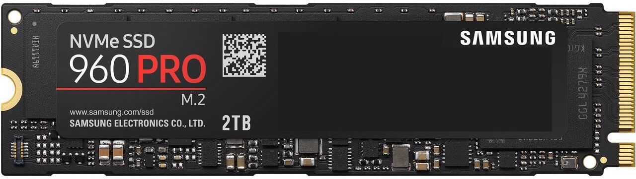

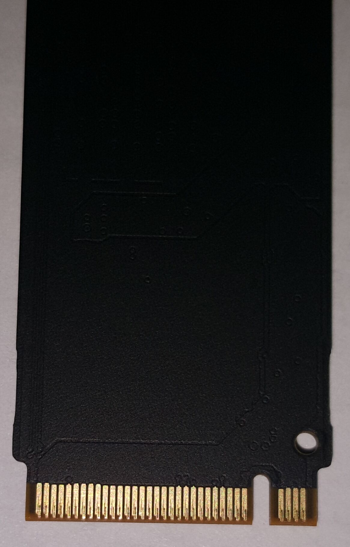

I have Mac Pro 2013 and want to upgrade my M.2 from 1 TB to 2 TB. The only 2 TB M.2 stick on the market besides the OWC custom solution is Samsung MZ-V6P2T0BW. So I got this stick and a dongle to convert from standard M.2 NVMe connector type to Apple's proprietary M.2 connector type. But the dongle connector does not have the second row of pins like my Mac Pro's built-in SSD connector. I've tested it, and it currently does not work in the slot, I'm not sure if the problem is a missing driver or because of the connector difference. Update; it does work. But don't forget to sand down jagged edges using a metal file or sandpaper. And don't forget the tape!
SSD:
https://www.newegg.com/Product/Product.aspx?Item=N82E16820147598
http://www.samsung.com/semiconductor/minisite/ssd/product/consumer/960pro.html

Original 1 TB Drive:
New Drive:

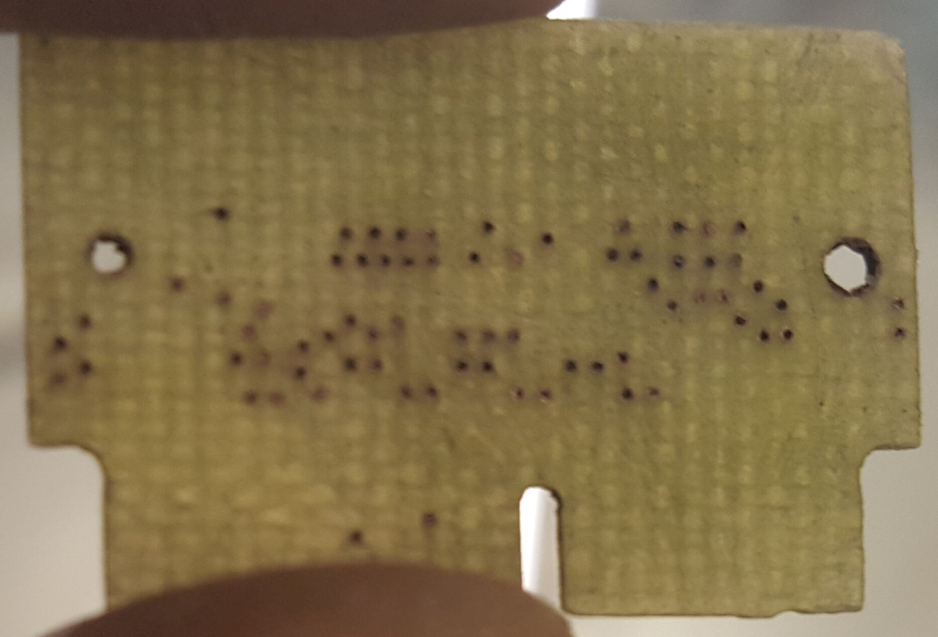

Adapter:
Adapter with Tape:
Adapter Sanded Down:
