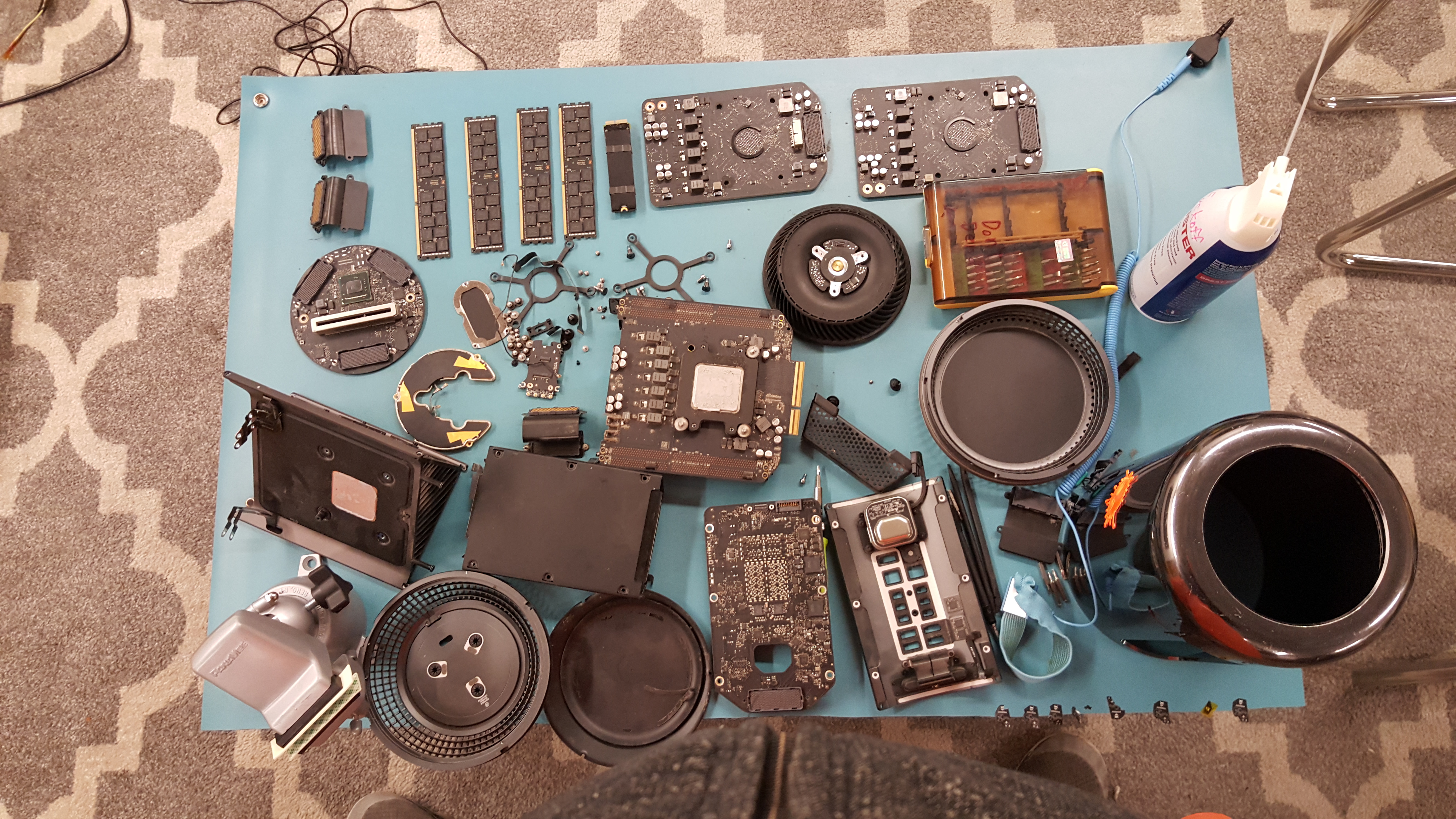

Yeah I checked last night at the office it was definitely the wrong firmware revision. I downloaded the combo update to attempt updating the firmware a second time but I forgot to launch it before I started disassembling my Mac Pro.
lol i have 6 hours to attempt to put my mac pro back together outside of its original trash can prison. if the lucker even still works i probably destroyed it in the teardown process.

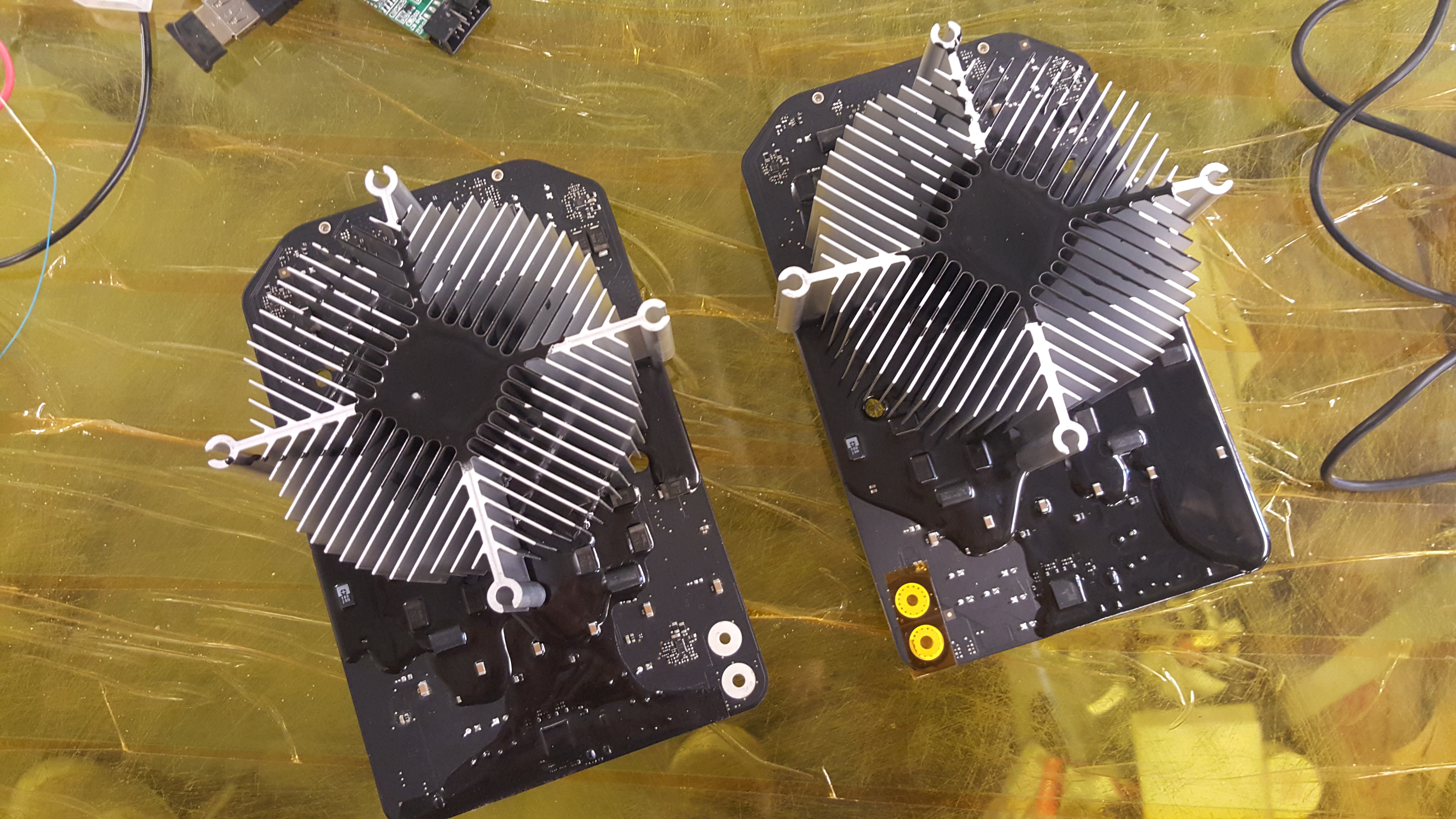

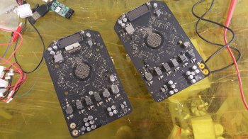

So I was wrong, the holes on the board for heatsink mount are slighty different from standard. It looked right when I eyeballed it, at least for the CPU Riser Card, but going to actually mount it there is a slight difference. I probably can’t afford to custom mill a hunk of metal as an adapter. I’m not using the trash can heat sink either.
I can work around this if I permamently secure the heatsink to the board, but then I cannot remove the CPU afterwards or it will be destroyed. I wanted to switch from 12 core 2.7ghz E5-2697 v2 to 8 core 3.3ghz E5-2667 v2. Anyone who has an E5-2667 v2 and prefers more cores to more ghz want to swap before I sign this CPU’s death note?

Well I am doing all this work now to upgrade my main machine, and I might pot the heat sink to the board, which would make it impossible to swap out the CPU later. I have the best RAM and the best NVMe drive, and trying to upgrade the GPUs. Give all that it would be kind of silly not to max out the CPU. I'll just keep working on a solution that allows me to swap the CPU later.

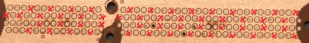

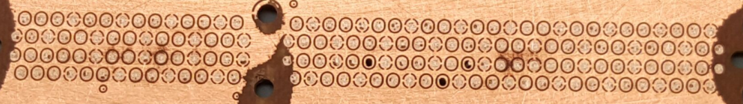

For example on mapping pins without probing. Notice which pins have the full oval and which have the open cross-hair:
This is the bottom of the receptacle socket in the Logic Board that the CPU Riser Card plugs into. Sanded down to a ground plane (or power or signal that is taking over nearly the entire layer other than VIAs, but probably ground). The solid copper is all connected together. Copper pours into the cross-hairs making all ovals with cross-hairs share the same electrical connection (every pair of cross-hair ovals will pass the continuity test).
There are at least 53 cross-hair ovals here. We can group them together using the same color coding in the pin-out spreadsheet.
I guess this is the start of documenting the Mac Pro 2013 connector pins.
A reminder that the socket connects 324 pins between the CPU Riser Card and Logic Board not just what is pictured (~164 pins).

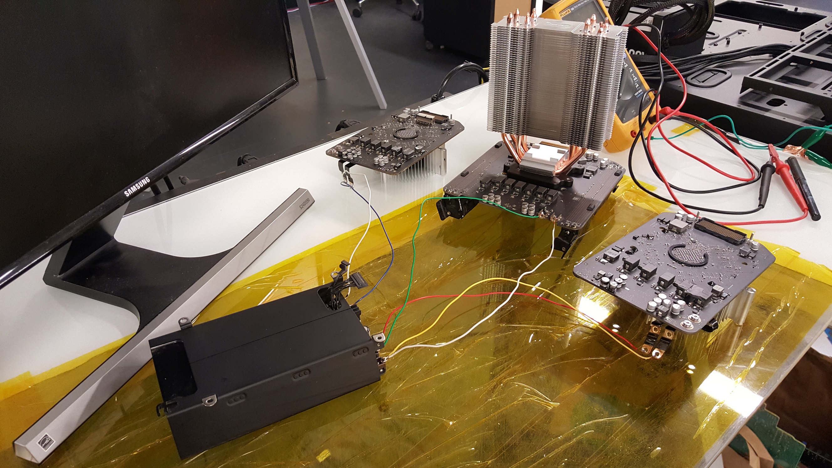

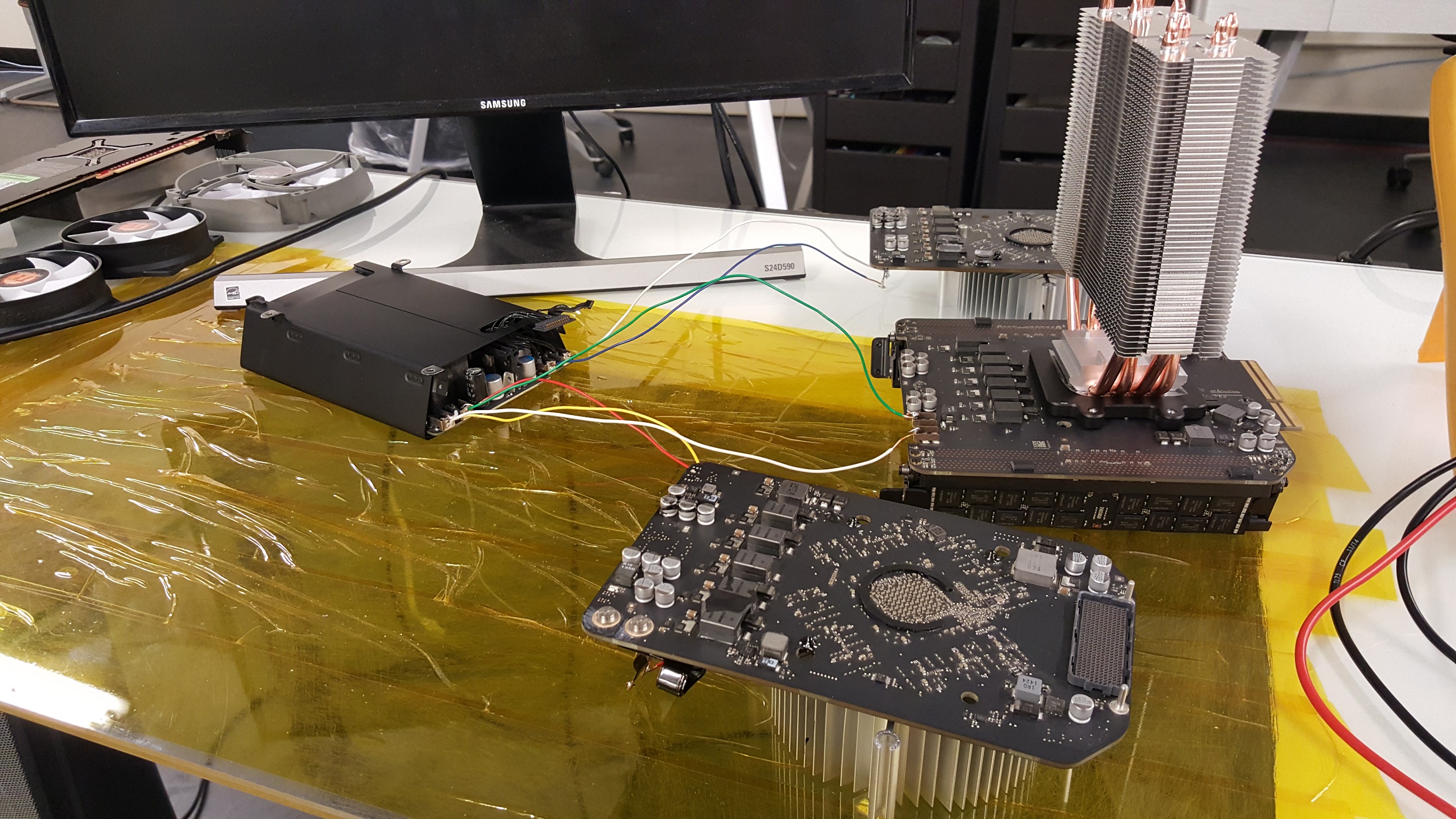

That is some heatsink. How did you fix that sucker?
the cpu heat-sink is just placed loosely on top of the cpu riser card for the purposes of the photo. i still need to mount the cpu heat-sink. another reason i haven't tried to turn it on yet. standard air-based heatsinks for lga 2011 are huge
