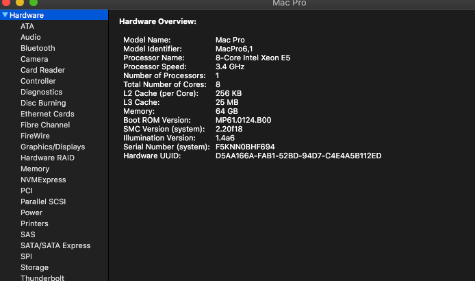

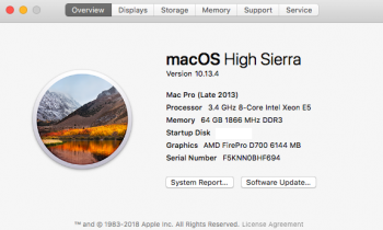

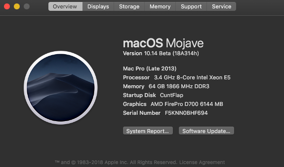

Is this a Mac Pro (Late 2013)?
What version of macOS?
What version of bootrom or firmware?
Link to the exact adapter you bought to verify just in case?

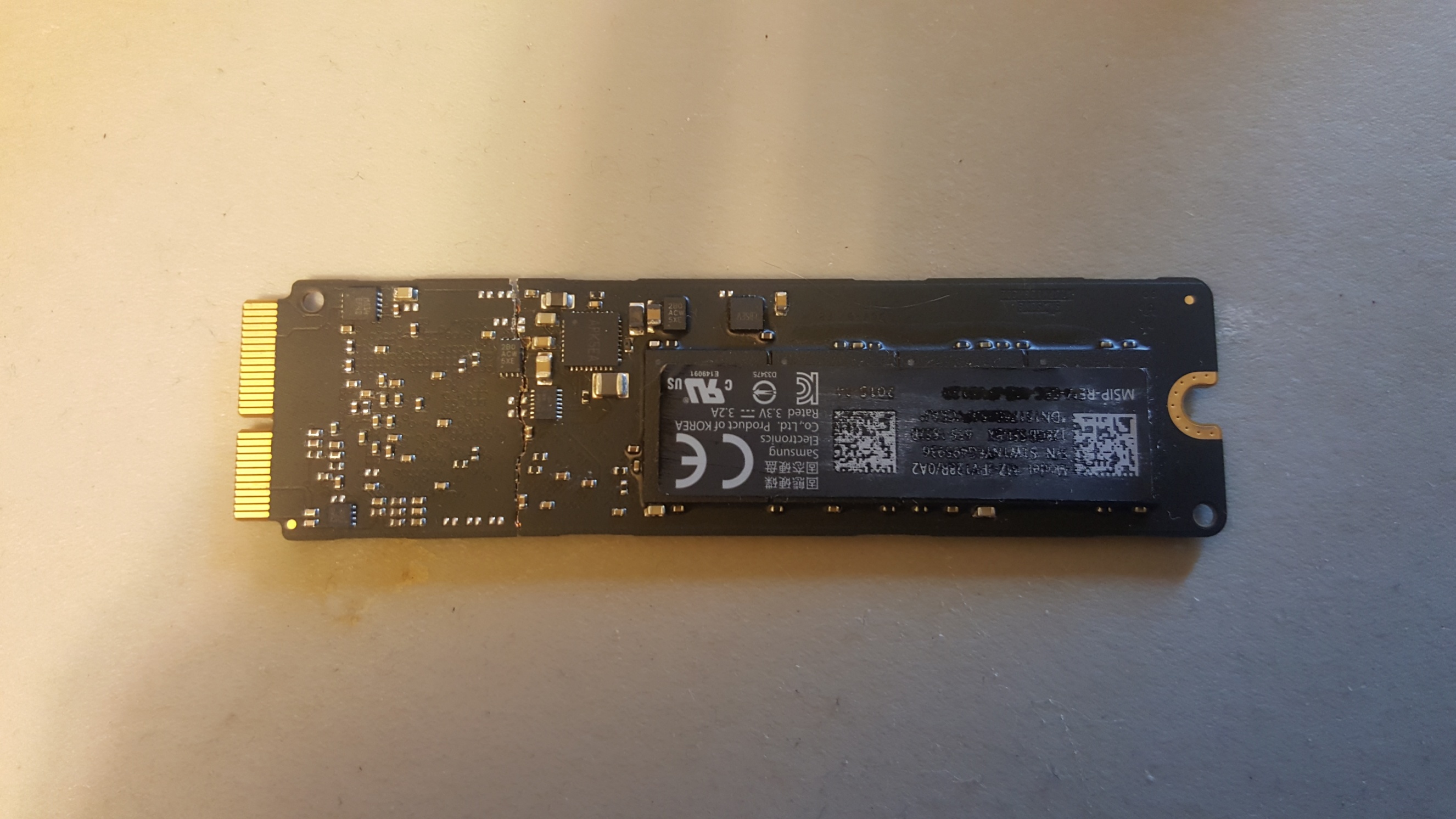

the firmware did not change when i installed mojave but that is probably because i am using nvme. stock apple ssd should arrive tomorrow i'll try re-installing mojave with that drive.Did the firmware change?
Xeon E5-2687W V2 SR19V? For Mac Pro (Late 2013) I wouldn't recommend it unless you have a modded system that can handle the extra thermal load.Codejingle, which model of E5 xeon is that?
Quick question. Do you notice any heat issues? Installing now and running along, except I feel the heat off of the machine. Mac Pro 2013 6,1, 8core, added 1TB Samsung 970 Evo with heat sink and adaptor.I upgraded to Mojave with a stock SSD and the firmware didn’t change. Still at MP61.0124.B00.
Prior to that I upgraded from Sierra on this machine with stock drive and firmware did change.
Nvme drive works fine on Mojave (2TB Samsung 970 evo with Sintech adaptor)
Put the fastest ssd you want in there. None of the thermal issues are being caused by your faster ssd. The M2 stick even under intense use is so small that proportionally the amount of heat it generates contributes very little to the overall thermal load of the machine.I am worried about heat build up. Has anyone else installed this newer SSD with the adapter?
well either apple is giving the hardware mod community the shaft or there is a chance that newer firmware would break modded hardware. if you've hand-built a custom hardware mod and the driver compatibility is a house of cards then any change in the firmware might break the mod.Just curious, why does updating the firmware require an original Apple SSD.
