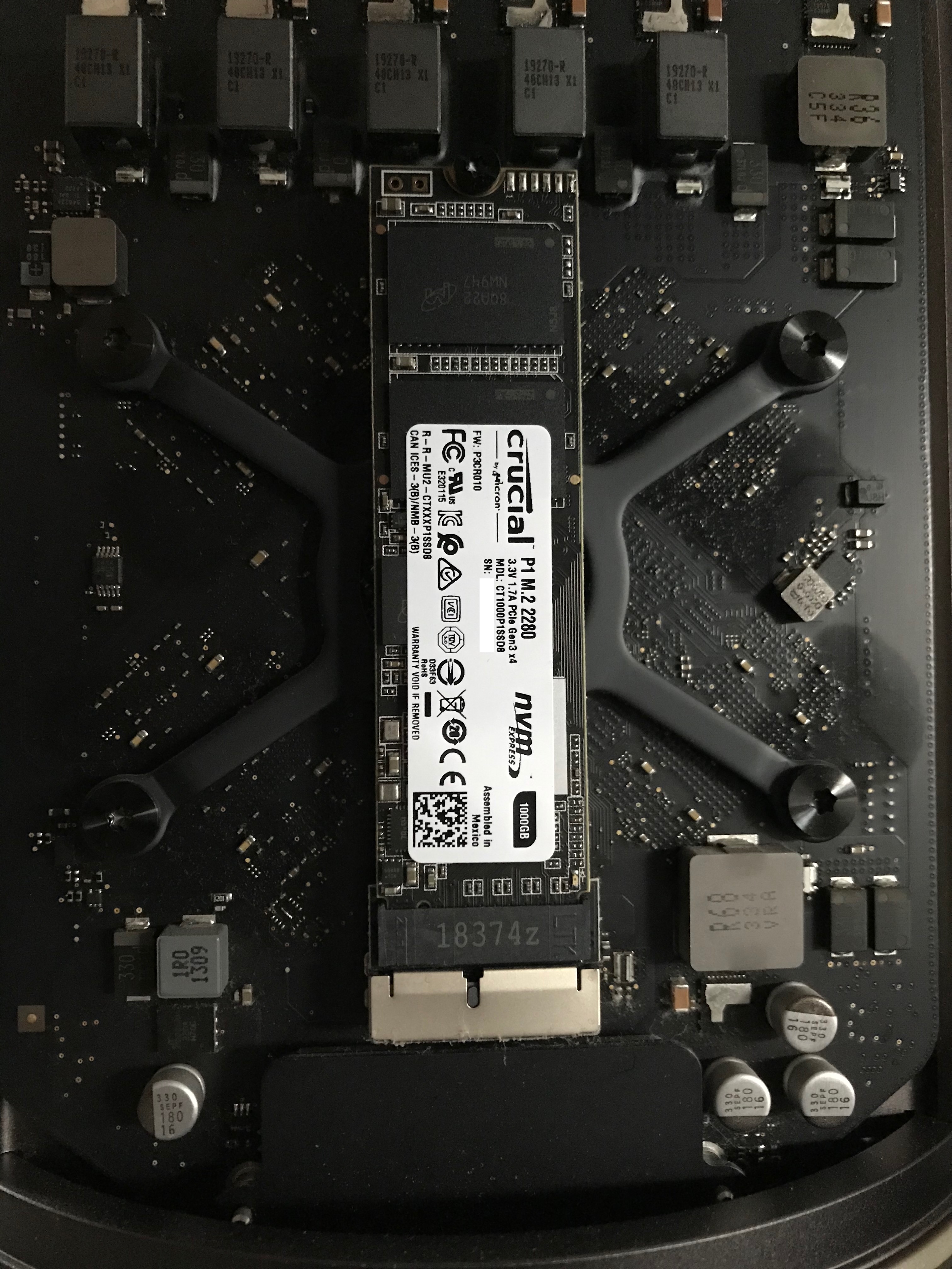

I installed the adapter together with a Crucial P1 with 1TB (CT1000P1SSD8). I used this slower NVMe SSD because the port in the Mac Pro 2013 is not so fast that it takes advantage of a faster one.

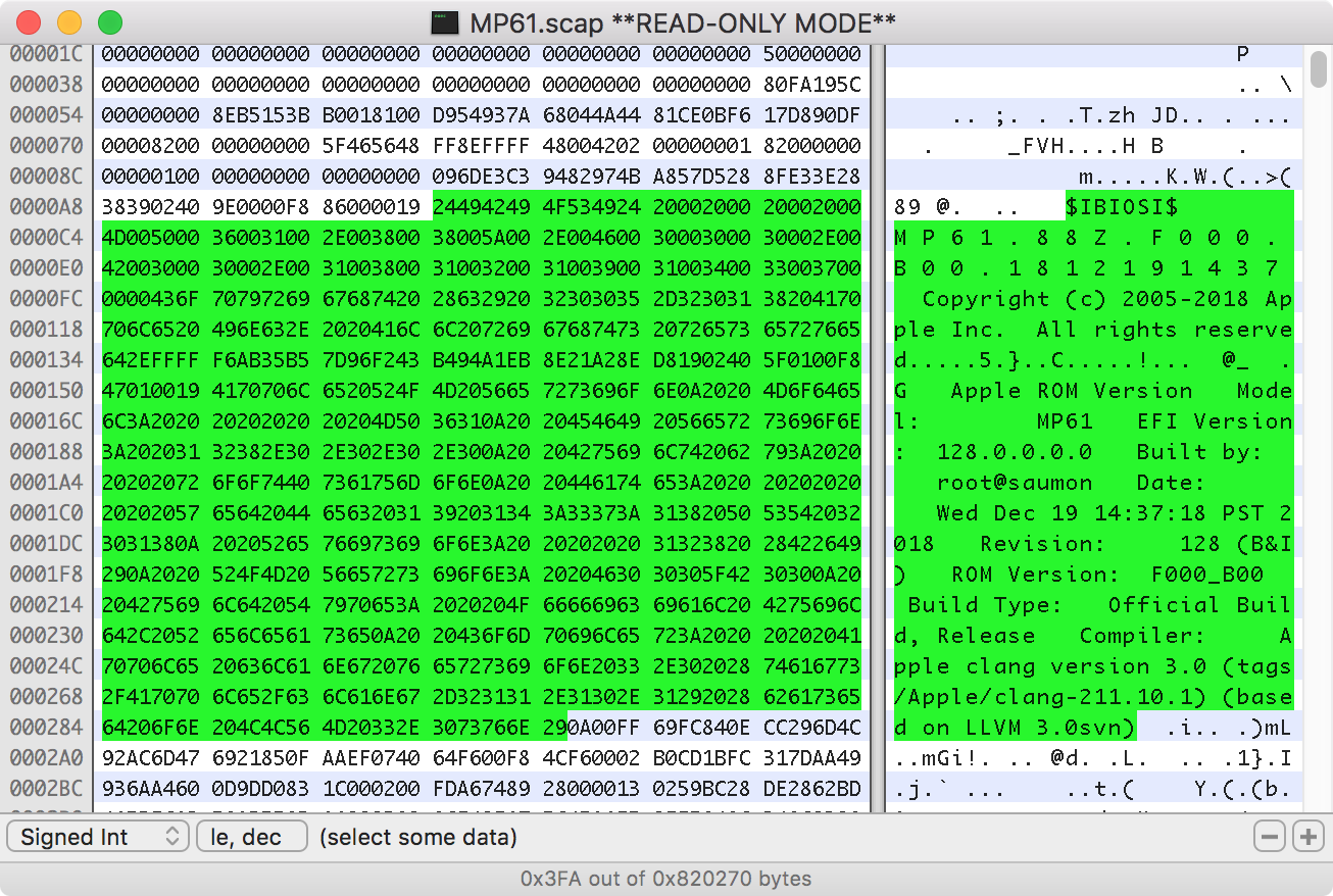

Hey TsiAlex, How do you get this printout ? is there a command line entry...
No, I extract it from the MM61.scap

I just did the update to 10.14.4. Of course, I put the original Apple drive in my nMP before doing the update to update the firmware to 129.0.0.0.0, which went fine. After the update, I put my 960 Pro back in the nMP and redid the update. Everything is fine.
I was half tempted to try the update without putting in the original Apple SSD just to see if it would update the firmware. Would it be possible for Apple to update the firmware so that firmware updates can be done with an NVMe installed, or is the firmware update linked to the controller on the Apple SSD?
I did the update the other way round. With my Crucial P1 the BootROM was not updated as expected. After changing to the Apple SSD it was working without any problem.
So everything is fine now.
