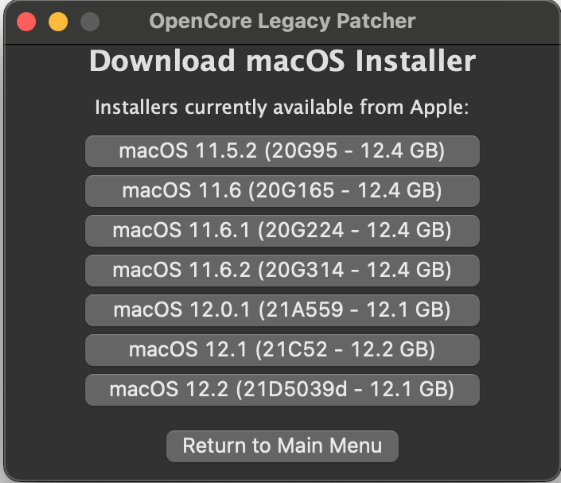

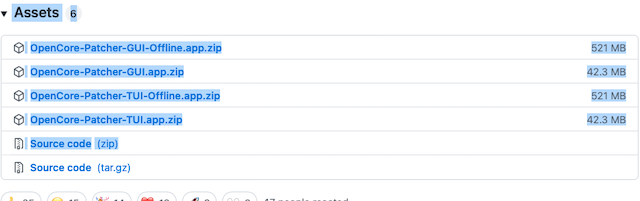

Can someone tell me which of these to download for oclp. Trying to re install and hope to get it right this time. Also I want to download this to my hdd so is a usb installer needed or required?

Personally I would try Monterey 12.2 though many prefer Big Sur while Monterey is going through a somewhat frequent upgrade cycle. You will not need SurPlus with Monterey (which I think is what you are calling Big Sur Patcher)

If you have no idea what you are doing, the GUI offline version will be the most user-friendly. Build OpenCore configuration and install it to your boot drive.
Reboot the computer to initialize Open Core.
You may want to use an USB installer (note: apparently 12.2 does not work for creating an USB installer, install 12.1 and then update) or you can use the standard procedure.
As you probably know, the MacOS bootpicker (this thing allowing you to select the boot disk while the computer starts by pressing option on power on) is no longer relevant and you have to use the OC bootpicker, which OCLP will conveniently install for you.

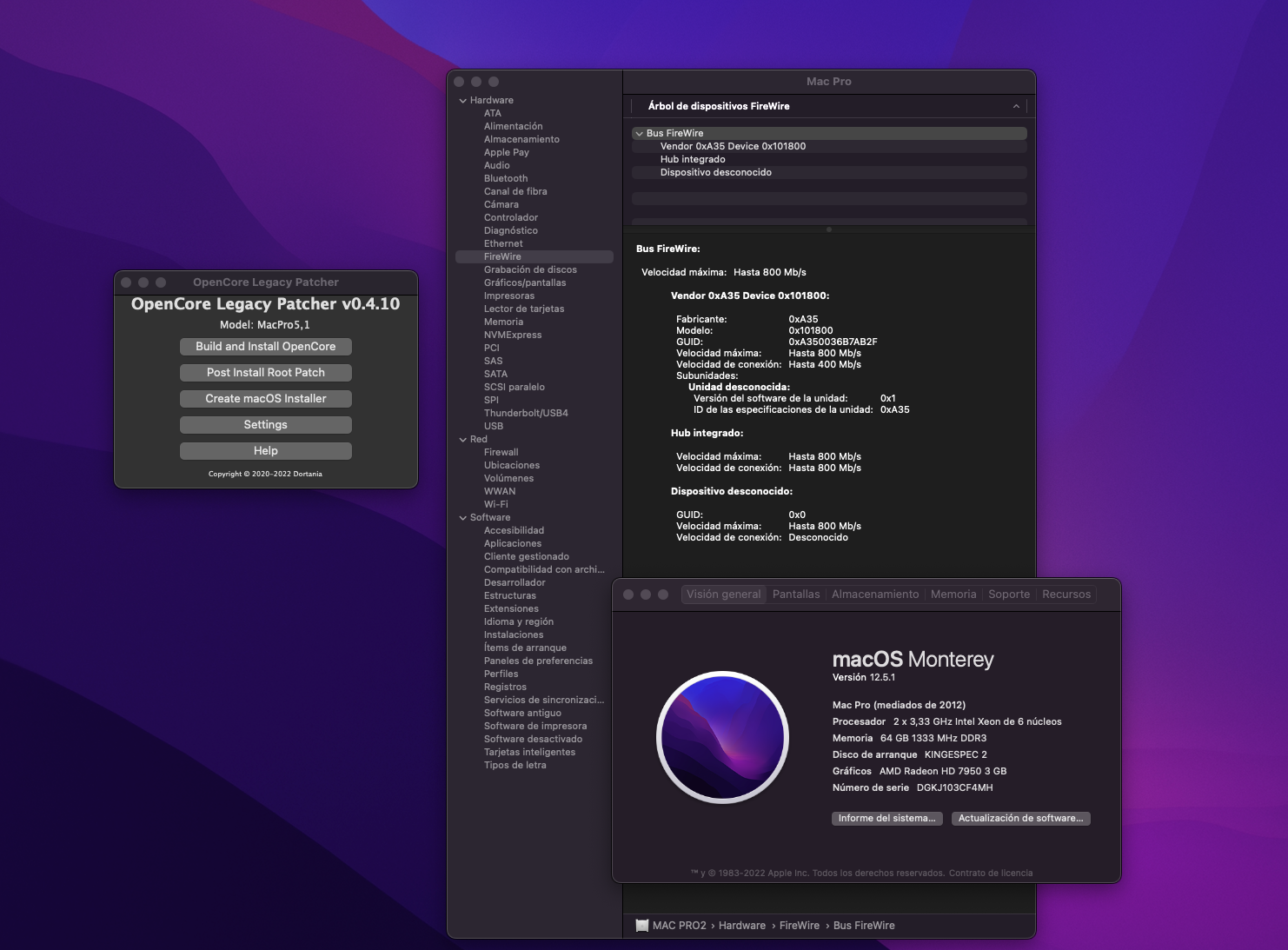

Hello, I have Macos Mojave 12.5.1 installed on a Mac Pro 2x3,33, 64 GB Ram using OCLP version 4.10, almost everything works correctly, there is only one thing that gives me trouble, I have an RME FF800 and when I use it when I choose the driver in the programs that I use for music I can't use it since all the channels start to make a tremendous feedback noise. Only once I have been able to use it well, but as soon as I turn it off and start again the problem persists. I think it will be an OCPL configuration problem, since a Macbook pro with an official Monterrey installation works without any problem. Could you tell me something about it? Would it be better to use MartiLo's packages? It is much easier for me to use OCLP since you do not require any intervention in the configuration plits, I left the hackintosh topic a long time ago, and I am not very up to date.
You mean Monterey.
a Macbook pro with an official Monterey installation works without any problem ... Would it be better to use MartiLo's packages?
You are running an old GPU which I believe is not supported even by Mojave
OCLP modifies Monterey to make the GPU work and the official Monterey is not the same as OCLP patched Monterey.
Martin's package will not have these patches so you will not be able to run Monterey with that GPU.
You will need to check on forums where fellow musicians hang out to confirm but it could be that something in the OCLP patching to support your GPU could be in conflict.
OCLP probably also has to inject some kexts for FireWire to work in Monterey which can be replicated in Martin's package but would likely lead to the same outcome.
If you have or can borrow a supported GPU, you should try that first to exclude that angle.

Hello, sorry for the error, it is Monterrey 12.5.1 that I have installed, the graphics card is fully compatible, it is Mac edition that works perfectly in Mojave and in Big Sur as well. The only problem I have with this installation is with the RME fireface 800 FireWire card, which although the system recognizes it perfectly when using it, I have feedback on all the output channels. For the rest, everything works correctly (I think that sharing the screen with the iPad does not work) but the universal control, bluetooth, wifi, etc...
