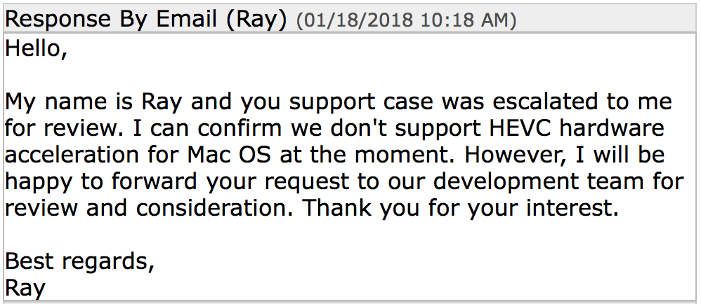

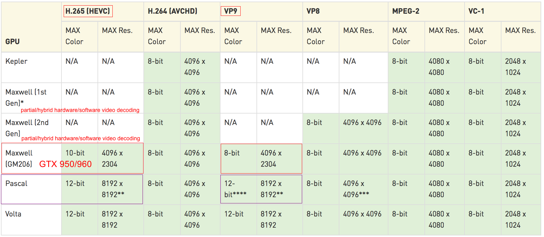

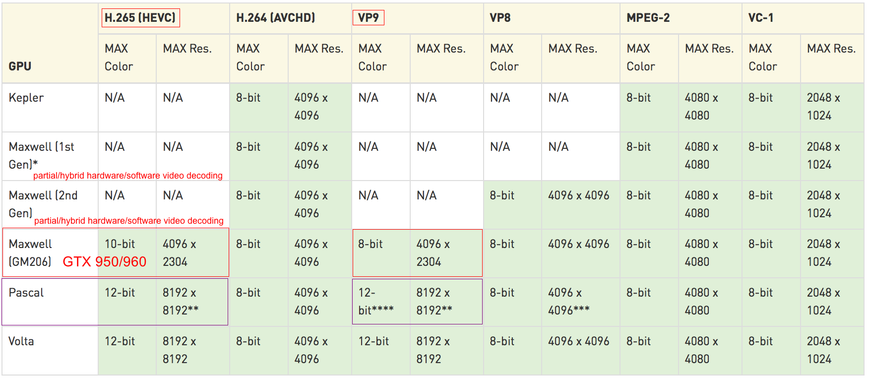

That's very impossible. Nidia hasn't provide any HEVC hardware decoding / encoding support in macOS yet.

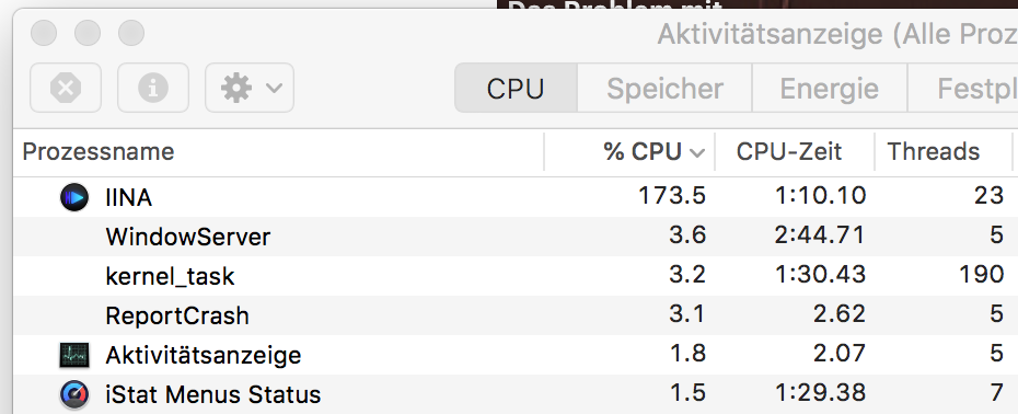

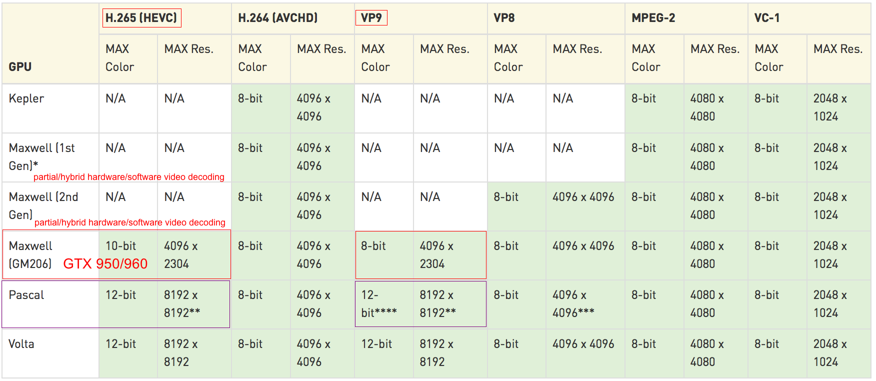

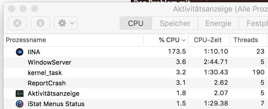

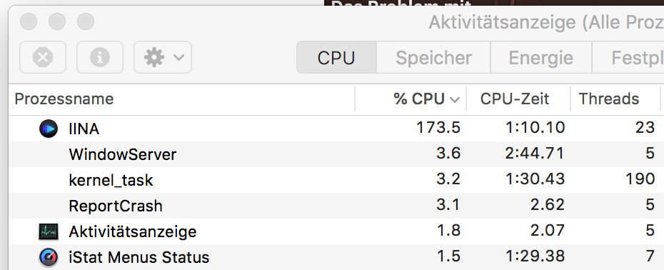

Playing HEVC-footage with Iina 0.0.14.1 indicates ~ 175% CPU use and ~ 25% GPU use (Maxwell GTX Titan X). I don't know when this began, but earlier versions of Iina made my CPU go nuts (all cores full used). The GPU must help some way.
Afaik the shaders of Maxwell GPU's could indeed provide partial HEVC decoding.
But maybe i'm wrong. ;)

Playing a HEVC-movie with Iina 0.0.14.1 indicates ~ 175% CPU use and ~ 25% GPU use (Maxwell GTX Titan X). I don't know when this began, but earlier versions of Iina made my CPU go nuts (all cores full used). The GPU must help some way.
Afaik the shaders of the Maxwell GPU could indeed provide partial HEVC decode.
View attachment 771123 View attachment 771124

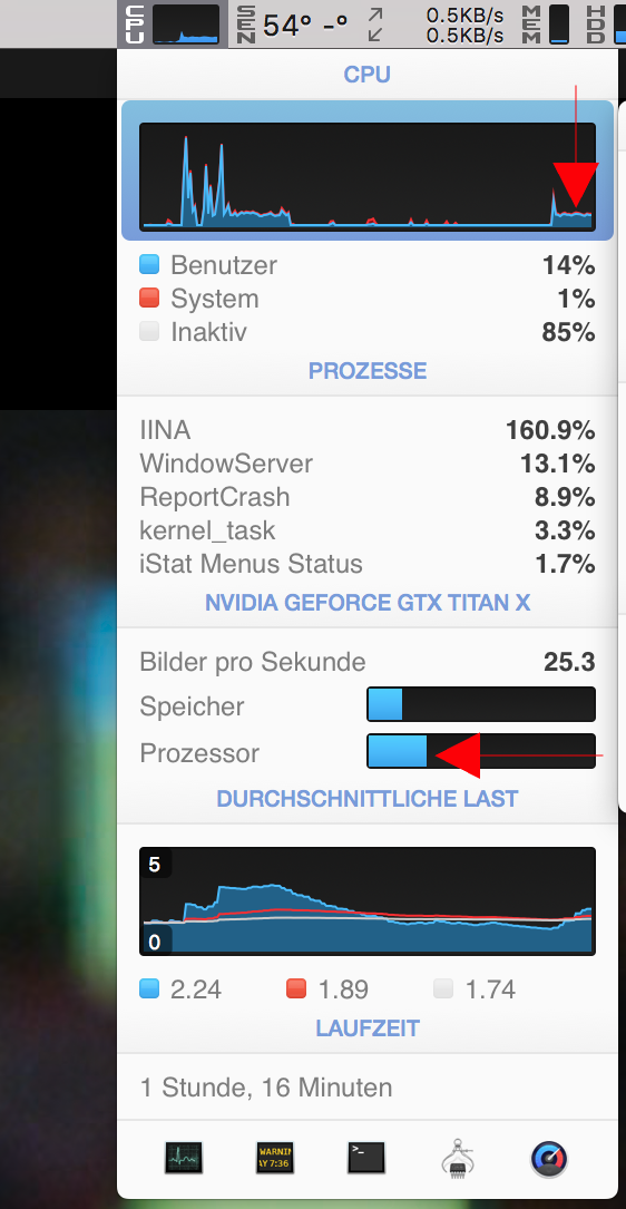

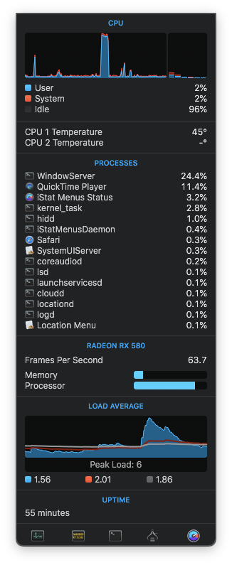

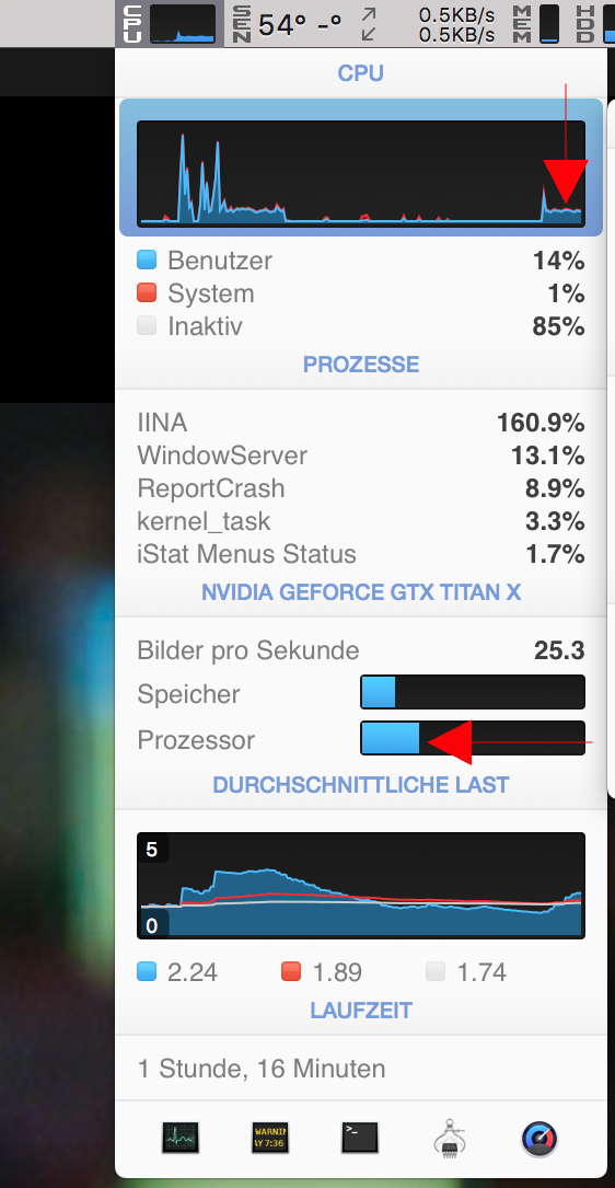

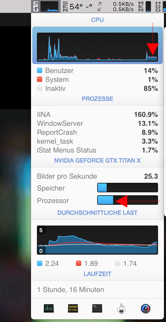

Quite sure that's 100% CPU decoding, the GPU still has to do some work because you are playing video. For real GPU decoding should looks like this. 11% CPU and much higher GPU usage.

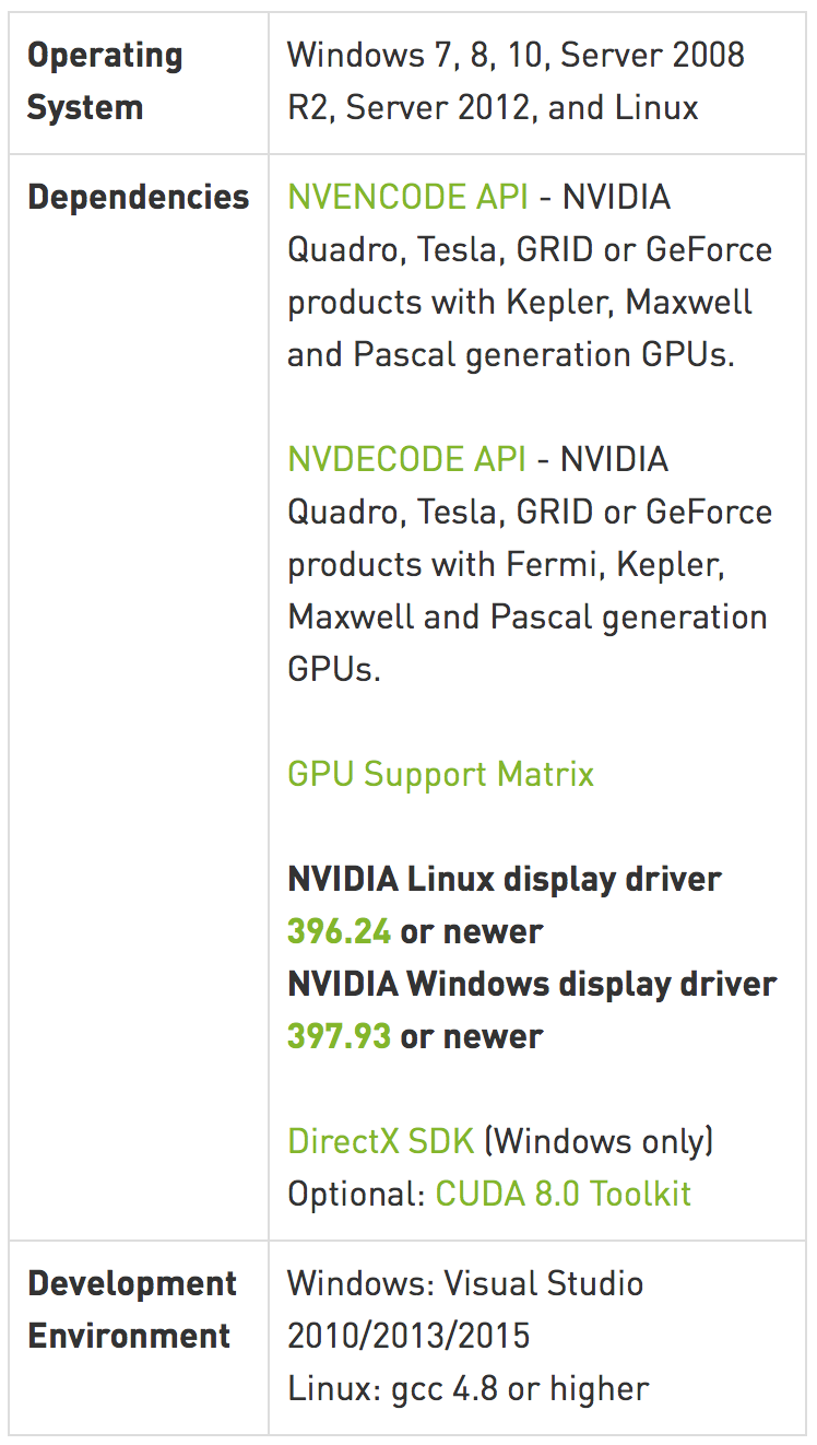

Also, the table your quote is from this page.
https://developer.nvidia.com/nvidia-video-codec-sdk
And if you check the info at the very beginning, macOS is not included.
That 350% to 160% CPU usage improvement. May be because different videos (or playing different part of the video), or efficiency improvement of IINA.
Reactions: Synchro3
Ok, you convinced me.:)
I guess efficiency improvement of Iina.
Thanks for the testing.
