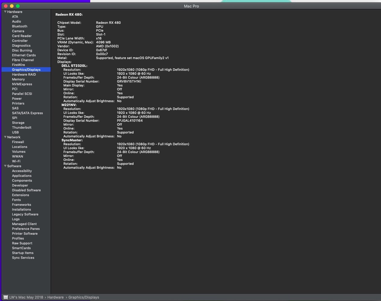

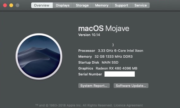

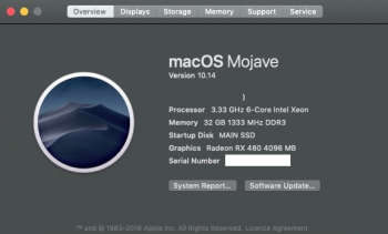

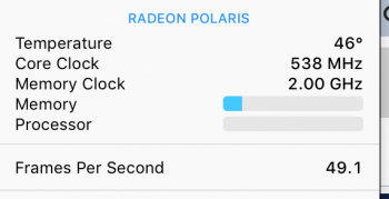

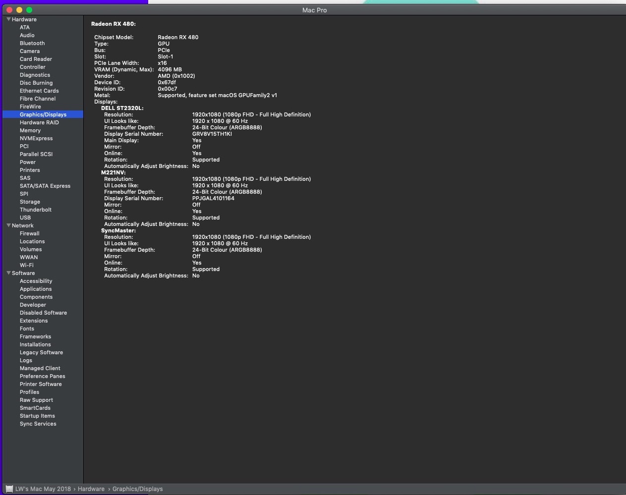

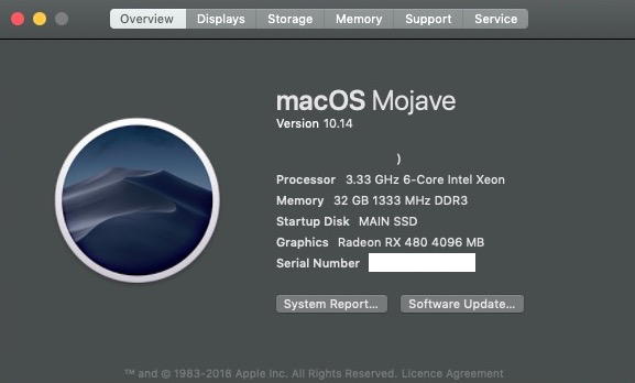

I have a 4,1 flashed to 5,1 with an XFX Radeon 480 4096 memory card, and despite taking AGES to install from High Sierra, (After two hours, I went to bed, and 6 hours later when I woke up, it was ready to restart...) seems to behave.
Watch this space.

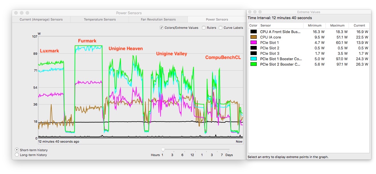

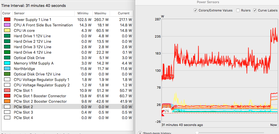

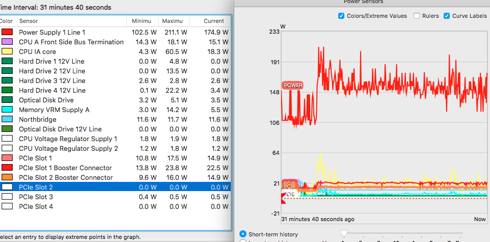

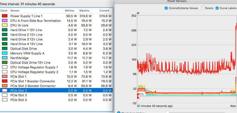

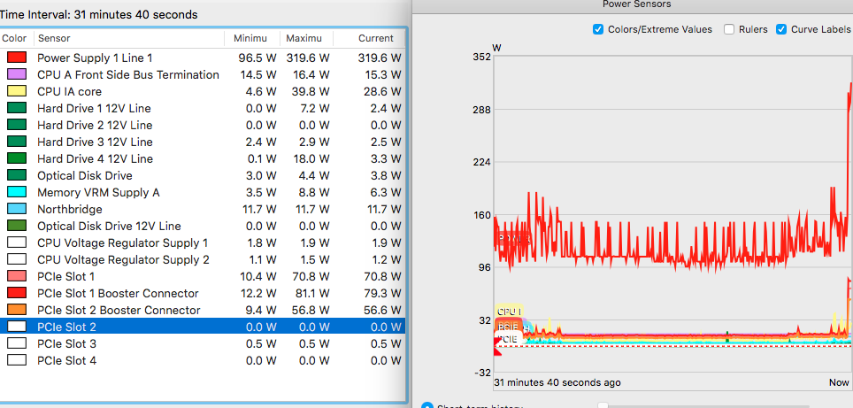

Before you order another cable, try install the card in slot 2.
What I found is those readings are not 100% accurate.
When the GPU in slot 1, it seems some of the slot power is counted in one of the mini 6pin.
But when you install the GPU in slot 2, hardware monitor will able to show you the true reading.
Like this, the same graphic card on the same cMP.
Slot 1.
And slot 2

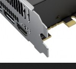

one problem iv noticed is (not shore what it's called so i grabbed a photo)
the little mettle mount points dont seem to correctly line up in slot 1 but my cards used so may have been bent out of shape at some point, any one had this problem ?
I had this problem with my GTX Titan X in the Mac Pro. Could not use all DisplayPort connectors. It seems a design flaw.
I installed a classic 'unbent' bracket from Aliexpress and no issues anymore: https://de.aliexpress.com/item/New-...c-Version-DP-DP-HDMI-DP-DVI/32784037273.html?

You can bend that by hand, it's not that hard, normal force should be enough.
Also, for your info, in my own test, slot 1 has better cooling (open fan card, all HDD bays are occupied).
ah thanks.
ill give it a bend by hand some time soon, if i can get the metal support bits bent correctly ill try second slot for fun if not it's sitting happy where it is.
