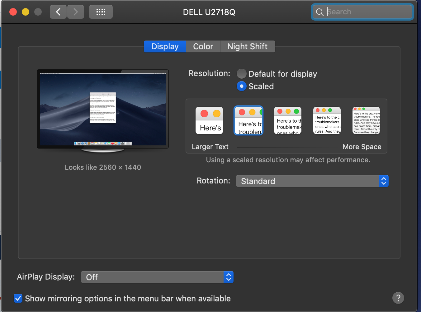

Don't give up ! My Mac Mini 2018 core i3, 8 G RAM makes pair with Dell U2718Q 4K monitor perfectly with native resolutions. All I had to do was making scale to see everything bigger , let it look like 2560 x 1440 as picture attached here

I just got the LG 27MU88-W 27" 16:9 4K FreeSync IPS Monitor yesterday, and is there anything I can do to have my screen at full potential 4k without having tiny ant words where I can't barely read? Current setting is same as yours scaled down to 2560 x 1440.

You are using all the pixels at a full 4k size. The only option is to zoom in on individual apps like safari, word, excel etc

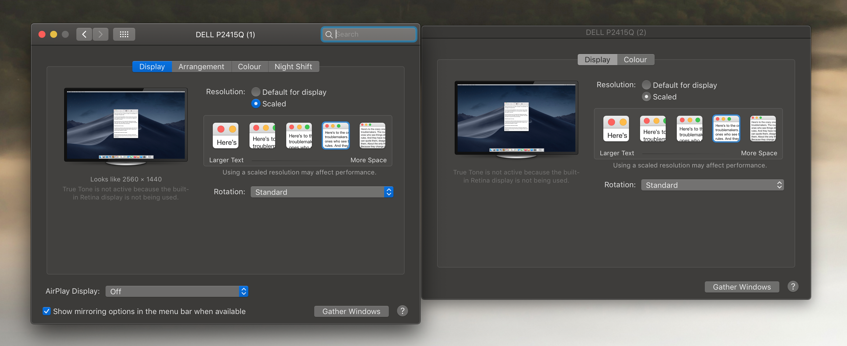

On Retina MacBooks and iMacs, there is an option to change text size without changing resolution.
I know it says "Larger text" but that's just a visual cue. That control shown in the screenshot is a resolution chooser.
Is there no such setting on high DPI displays, such as 4K, 5K...etc?
There are, exactly the same in fact. But again, it's just to choose a different resolution.
In Mojave if you hover over the five choices (as shown in the left window below, despite the cursor not showing) it shows a little message with the details ("Looks like X x Y")
In Mojave if you hover over the five choices (as shown in the left window below, despite the cursor not showing) it shows a little message with the details ("Looks like X x Y")View attachment 813629

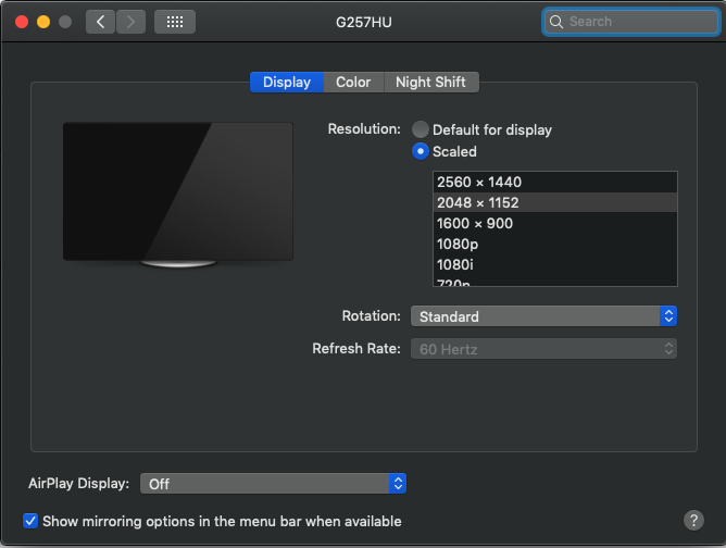

It's weird that the "Larger Text.... More Space" thing doesn't show for me.
That's the 'traditional' resolution selector. I believe you hold down Option to get that when clicking "Scaled". It provides more choices than the visual chooser.
