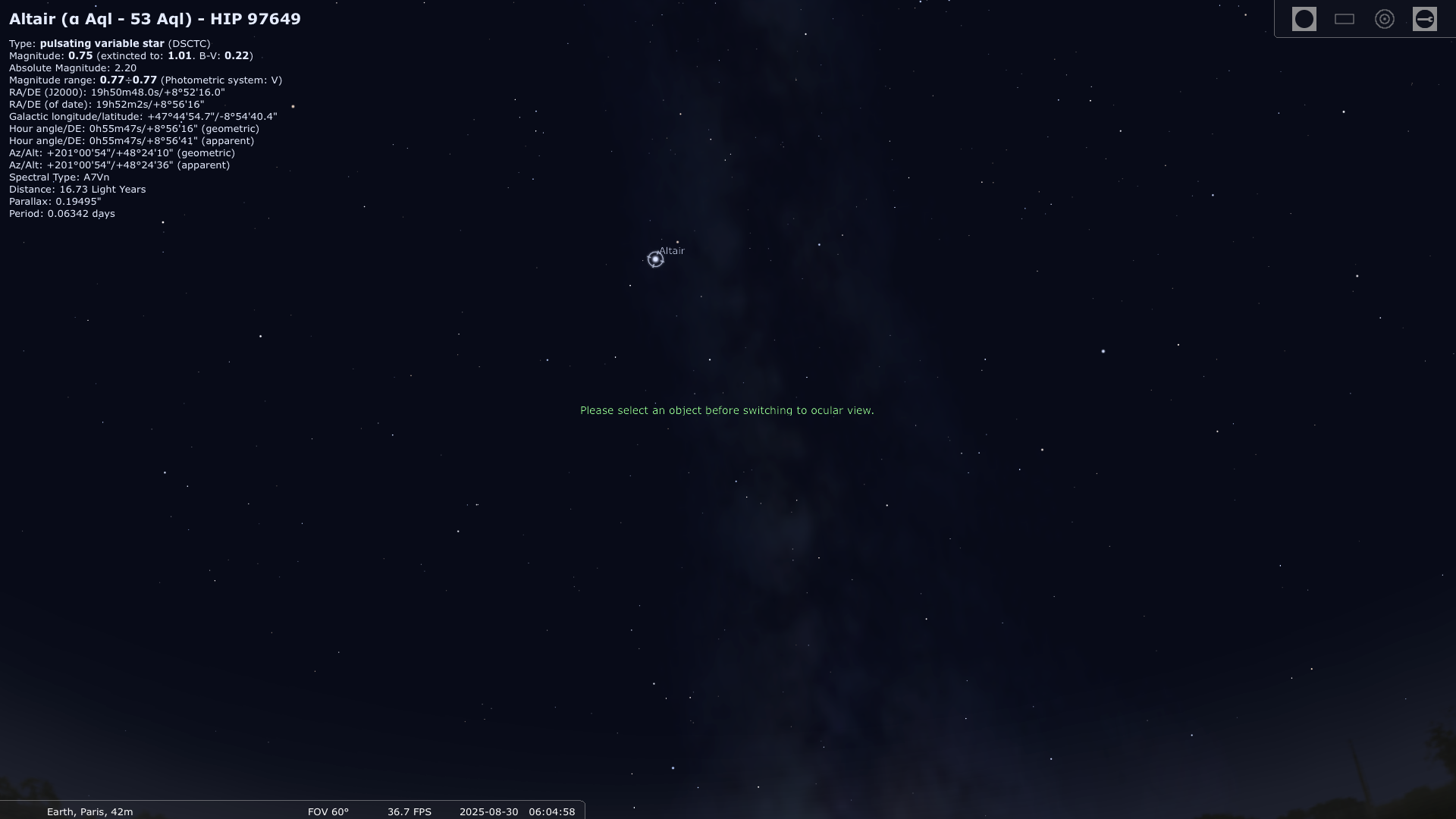

I fixed Stellarium build (Qt4 version, but it works):

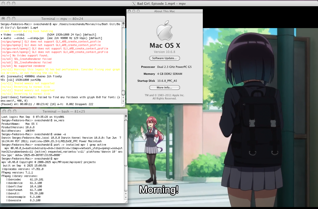

Re mpv, if libsdl2-cocoa does not want to work on a given system (it seems to be quite picky) and you get no video, do this:
Code:
sudo port -v -n upgrade --enforce-variants mpv +x11
Provided some X server is installed (which you will probably want anyway), this gets mpv to work via X11 (with a lot of complaints, LOL):

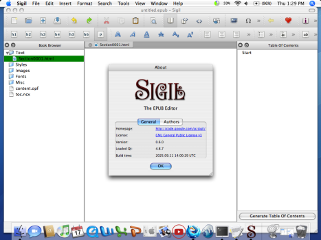

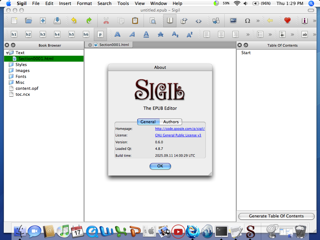

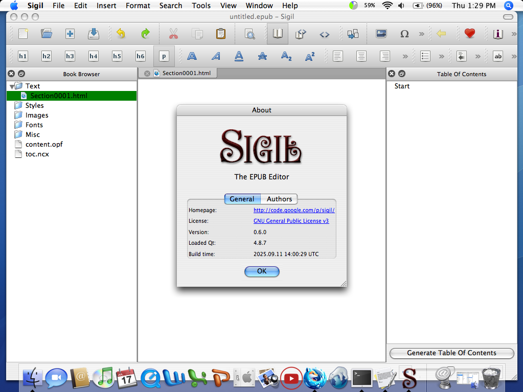

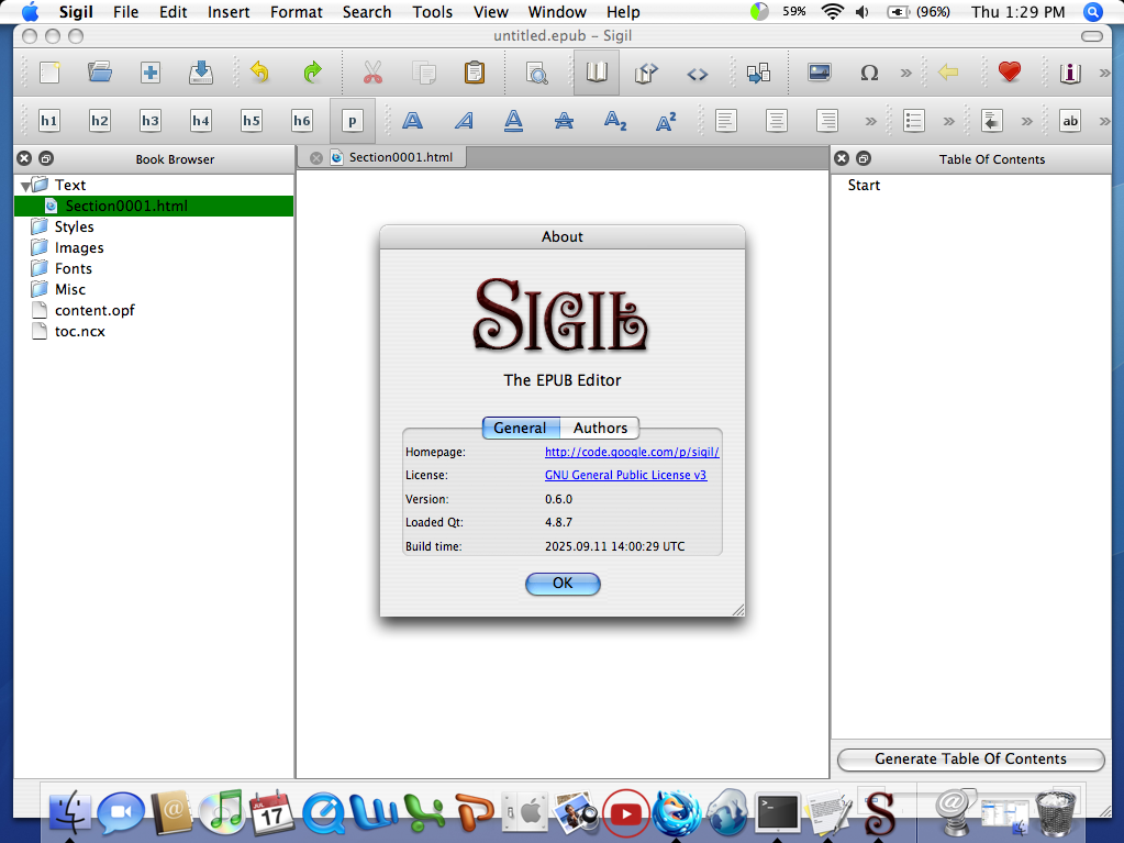

Finally got Sigil 0.6.0 working, mostly from dependencies from this commit (like boost159): 11cded2a12da6e93b5ddc670a1b6ed72cfb513bf
It does not need patches to build with that version and that boost. I may try 0.6.2 just to see if it works, but there should be little difference in features so I am happy with 0.6.0.
You are welcome to add a fallback for 10.4, if you wish. This is not something I will test myself, but as long as Tiger stuff does not interfere with anything else, no issues.
P. S. I hope that archaic boost builds against the current icu? Having multiple icu versions is parallel may be a mess. If really required, it should probably be done in a way allowing simultaneous installation, i.e. w/e old icu needed, should be a versioned port, installed into a dedicated subprefix.
