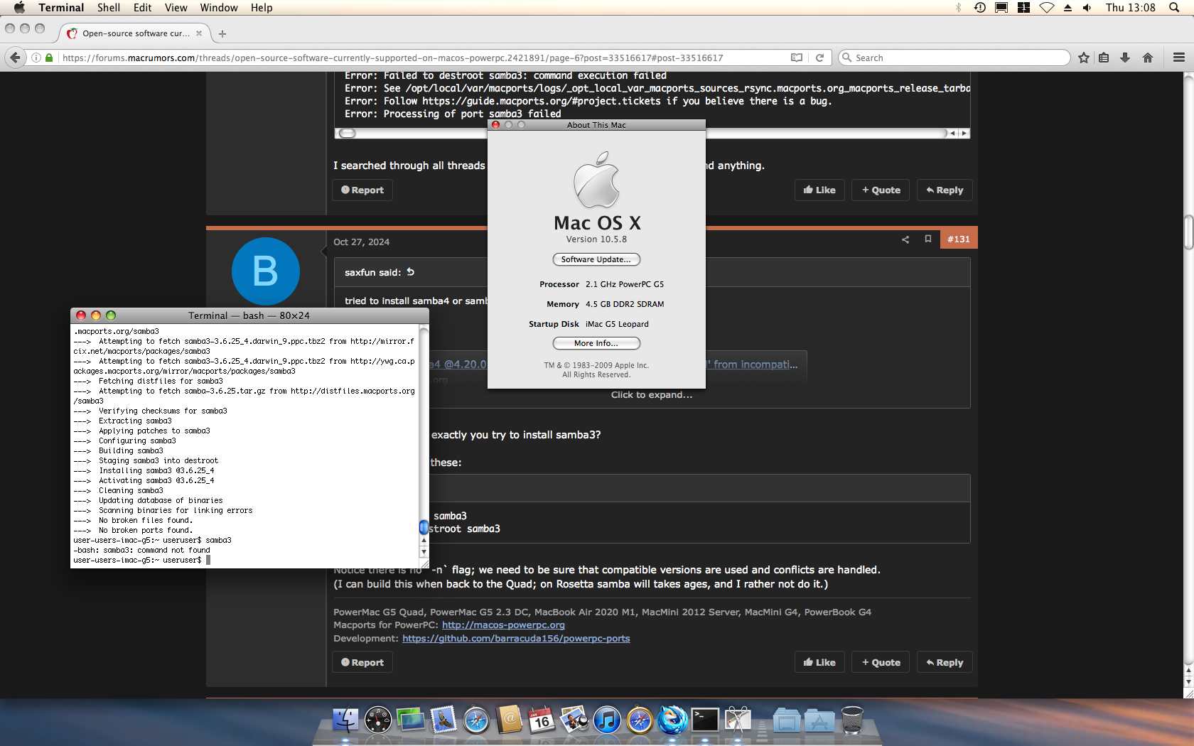

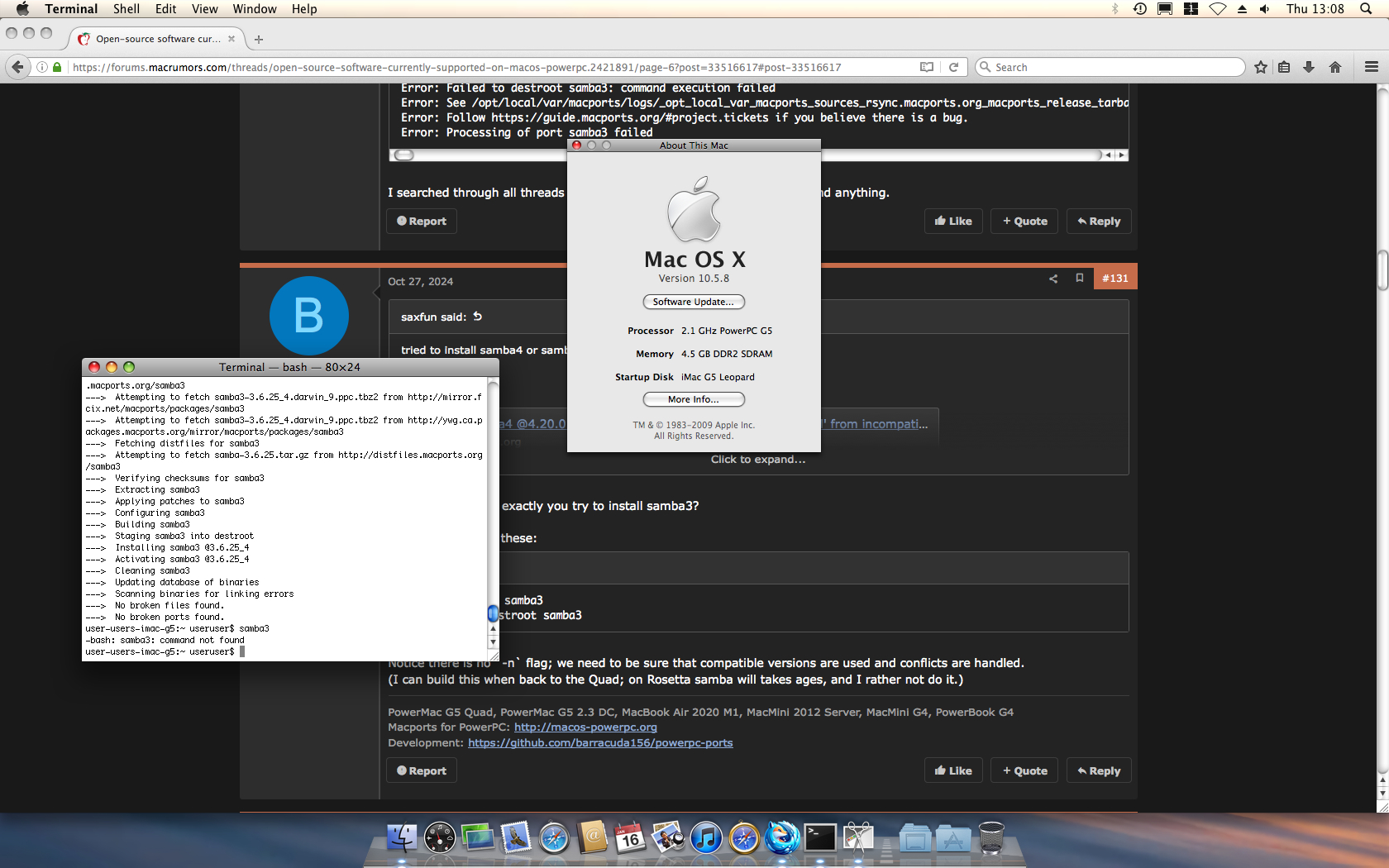

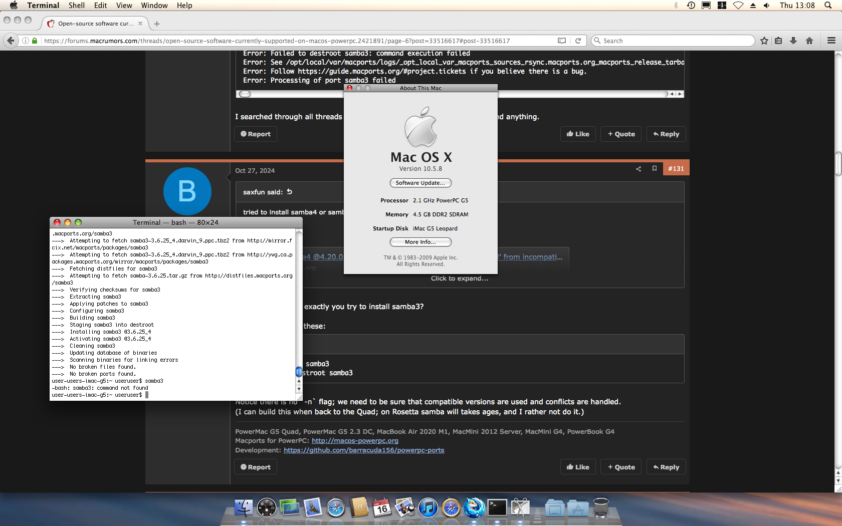

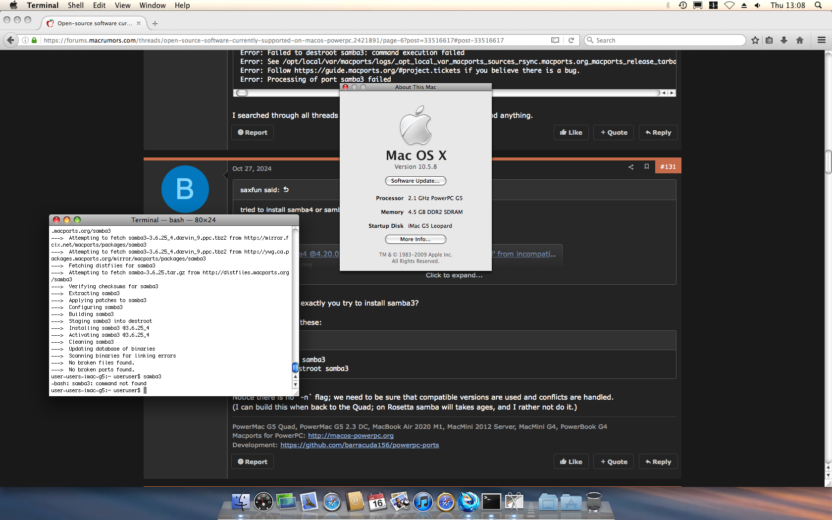

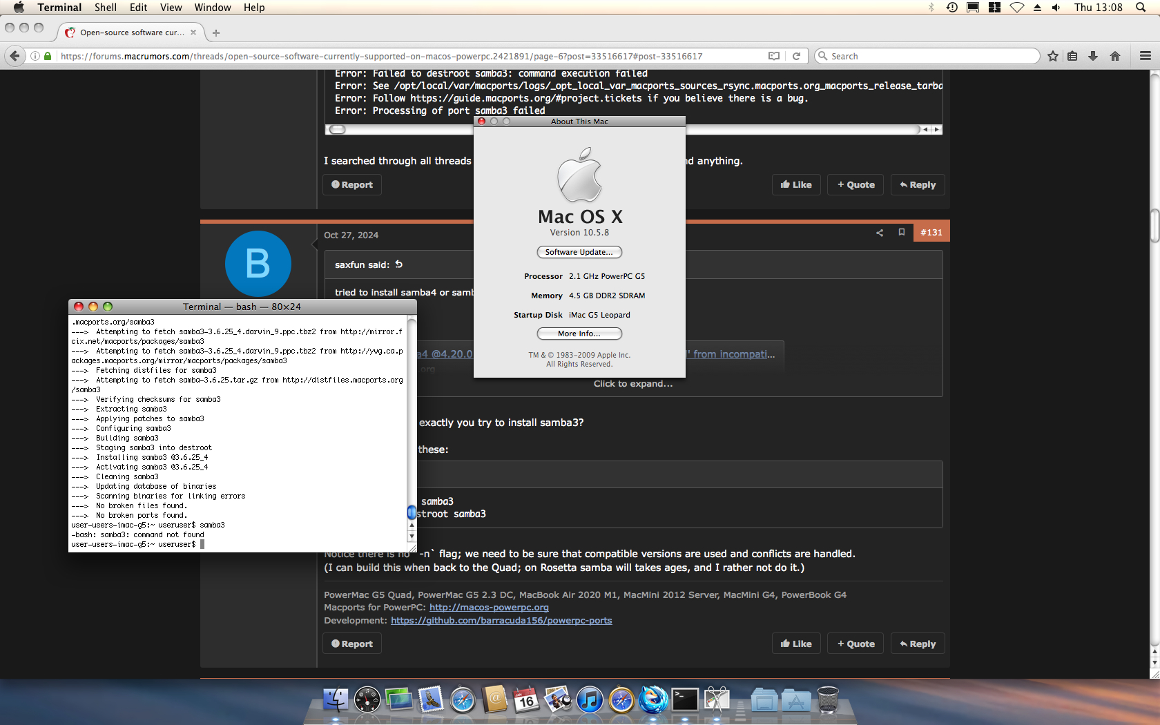

tried to install samba4 or samba3, both ports are failing on my system.
samba4:
samba3, failing wehen destrooting:
Code:
make: Leaving directory `/opt/local/var/macports/build/_opt_local_var_macports_sources_rsync.macports.org_macports_release_tarballs_ports_net_samba3/samba3/work/samba-3.6.25/source3'
xinstall: mkdir /opt/local/var/macports/build/_opt_local_var_macports_sources_rsync.macports.org_macports_release_tarballs_ports_net_samba3/samba3/work/destroot/opt/local/etc/samba3
xinstall: /opt/local/var/macports/build/_opt_local_var_macports_sources_rsync.macports.org_macports_release_tarballs_ports_net_samba3/samba3/work/samba-3.6.25/source3/../examples/smb.conf.default -> /opt/local/var/macports/build/_opt_local_var_macports_sources_rsync.macports.org_macports_release_tarballs_ports_net_samba3/samba3/work/destroot/opt/local/etc/samba3/smb.conf.sample
error: install_name_tool: can't open file: /opt/local/var/macports/build/_opt_local_var_macports_sources_rsync.macports.org_macports_release_tarballs_ports_net_samba3/samba3/work/destroot/opt/local/lib/samba3/libtdb.dylib (No such file or directory)
Command failed: install_name_tool  -change bin/libnetapi.dylib.0 /opt/local/lib/samba3/libnetapi.dylib  -change bin/libsmbclient.dylib.0 /opt/local/lib/samba3/libsmbclient.dylib  -change bin/libsmbsharemodes.dylib.0 /opt/local/lib/samba3/libsmbsharemodes.dylib  -change bin/libtalloc.dylib.2 /opt/local/lib/samba3/libtalloc.dylib  -change bin/libtevent.dylib.0 /opt/local/lib/samba3/libtevent.dylib  -change bin/libtdb.dylib.1 /opt/local/lib/samba3/libtdb.dylib  -change bin/script.dylib /opt/local/lib/samba3/auth/script.dylib  -change bin/CP437.dylib /opt/local/lib/samba3/charset/CP437.dylib  -change bin/CP850.dylib /opt/local/lib/samba3/charset/CP850.dylib  -change bin/macosxfs.dylib /opt/local/lib/samba3/charset/macosxfs.dylib  -change bin/autorid.dylib /opt/local/lib/samba3/idmap/autorid.dylib  -change bin/pam_smbpass.dylib /opt/local/lib/samba3/security/pam_smbpass.dylib  -change bin/acl_tdb.dylib /opt/local/lib/samba3/vfs/acl_tdb.dylib  -change bin/acl_xattr.dylib /opt/local/lib/samba3/vfs/acl_xattr.dylib  -change bin/audit.dylib /opt/local/lib/samba3/vfs/audit.dylib  -change bin/cap.dylib /opt/local/lib/samba3/vfs/cap.dylib  -change bin/catia.dylib /opt/local/lib/samba3/vfs/catia.dylib  -change bin/crossrename.dylib /opt/local/lib/samba3/vfs/crossrename.dylib  -change bin/default_quota.dylib /opt/local/lib/samba3/vfs/default_quota.dylib  -change bin/expand_msdfs.dylib /opt/local/lib/samba3/vfs/expand_msdfs.dylib  -change bin/extd_audit.dylib /opt/local/lib/samba3/vfs/extd_audit.dylib  -change bin/fake_perms.dylib /opt/local/lib/samba3/vfs/fake_perms.dylib  -change bin/full_audit.dylib /opt/local/lib/samba3/vfs/full_audit.dylib  -change bin/linux_xfs_sgid.dylib /opt/local/lib/samba3/vfs/linux_xfs_sgid.dylib  -change bin/netatalk.dylib /opt/local/lib/samba3/vfs/netatalk.dylib  -change bin/preopen.dylib /opt/local/lib/samba3/vfs/preopen.dylib  -change bin/readahead.dylib /opt/local/lib/samba3/vfs/readahead.dylib  -change bin/readonly.dylib /opt/local/lib/samba3/vfs/readonly.dylib  -change bin/recycle.dylib /opt/local/lib/samba3/vfs/recycle.dylib  -change bin/scannedonly.dylib /opt/local/lib/samba3/vfs/scannedonly.dylib  -change bin/shadow_copy.dylib /opt/local/lib/samba3/vfs/shadow_copy.dylib  -change bin/shadow_copy2.dylib /opt/local/lib/samba3/vfs/shadow_copy2.dylib  -change bin/smb_traffic_analyzer.dylib /opt/local/lib/samba3/vfs/smb_traffic_analyzer.dylib  -change bin/streams_depot.dylib /opt/local/lib/samba3/vfs/streams_depot.dylib  -change bin/streams_xattr.dylib /opt/local/lib/samba3/vfs/streams_xattr.dylib  -change bin/time_audit.dylib /opt/local/lib/samba3/vfs/time_audit.dylib  -change bin/xattr_tdb.dylib /opt/local/lib/samba3/vfs/xattr_tdb.dylib -id /opt/local/lib/samba3/libtdb.dylib /opt/local/var/macports/build/_opt_local_var_macports_sources_rsync.macports.org_macports_release_tarballs_ports_net_samba3/samba3/work/destroot/opt/local/lib/samba3/libtdb.dylib
Exit code: 1
Error: Failed to destroot samba3: command execution failed
Error: See /opt/local/var/macports/logs/_opt_local_var_macports_sources_rsync.macports.org_macports_release_tarballs_ports_net_samba3/samba3/main.log for details.
Error: Follow https://guide.macports.org/#project.tickets if you believe there is a bug.
Error: Processing of port samba3 failed
I searched through all threads here and all tickets on trac, but I did not find anything.

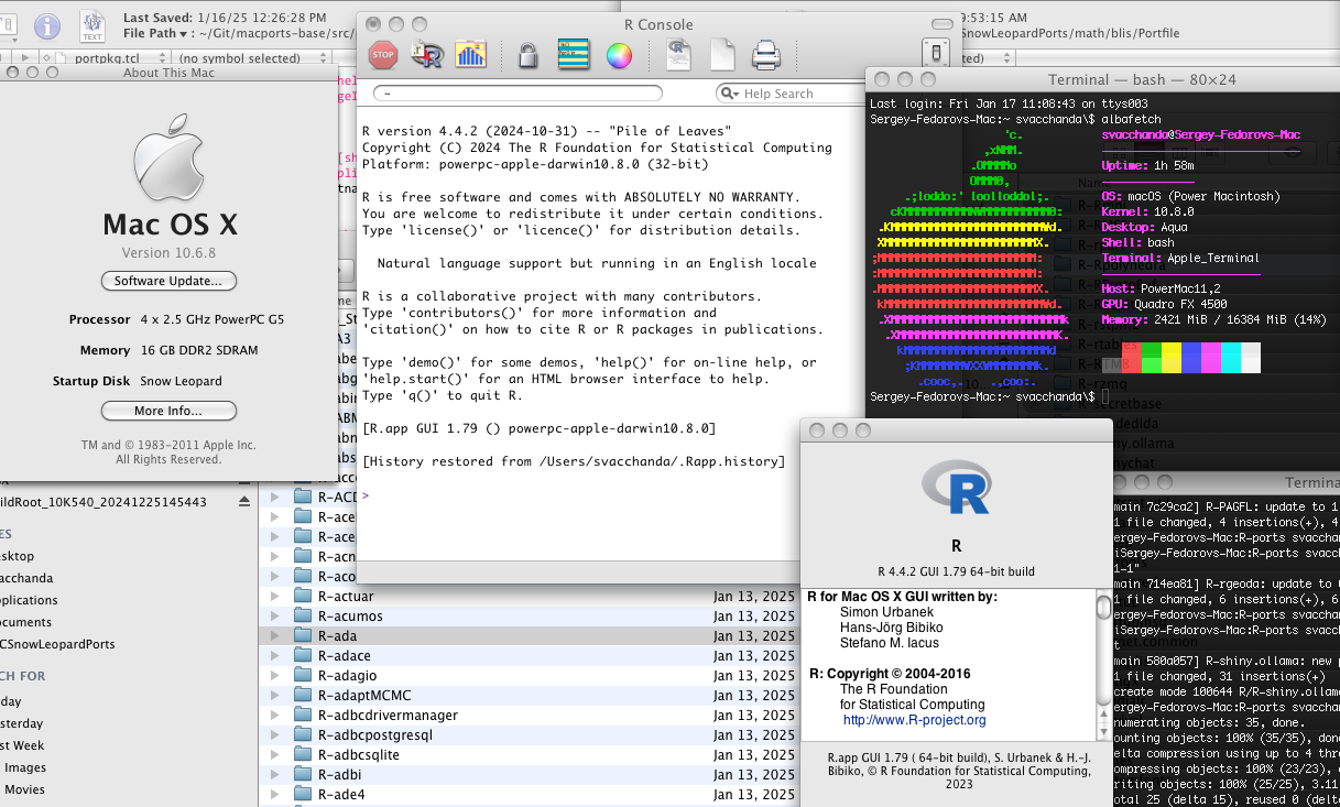

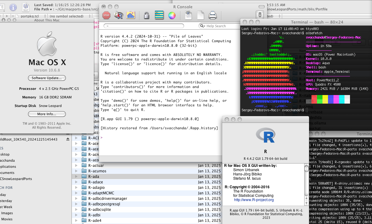

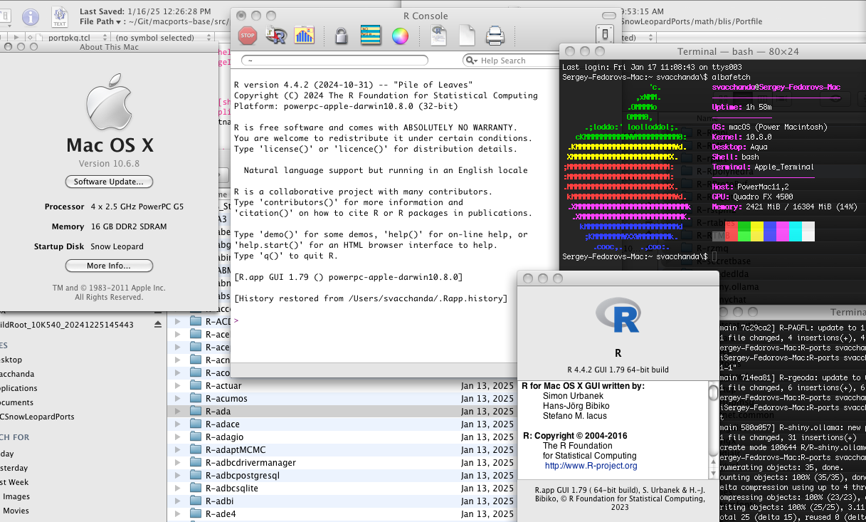

I got R-GUI 1.79 onto powerpc (the latest is 1.81, before we had 1.72). There is still one issue remaining to be solved for it, but it is working.
Reactions: doctor_dog
@barracuda156 , this piques my curiosity... what is the R GUI, and what "goodies" does it deliver to it's users? I looked it up Google, but it was hard to make sense of the user benefit. Thanks!
Nothing unless you use R and even then just some conveniences. R in terminal works perfectly fine.
It was just something I mentioned ages ago that I wanted to get working, and the best what I could fix then was 1.72.
