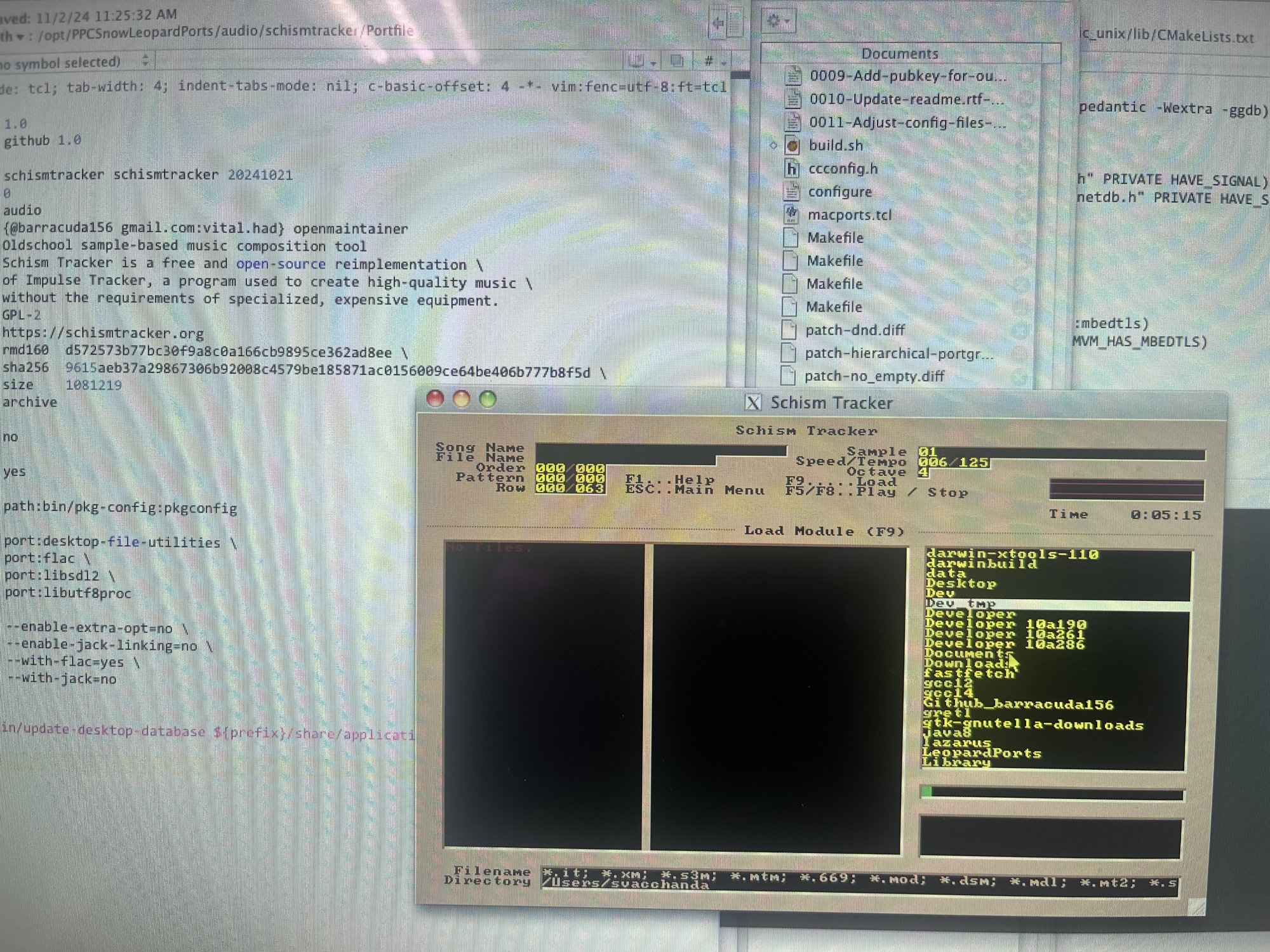

I'm using a patched version of SDL 2.0.3. I'm looking at the Tiger patch for 2.0.6 from MacPorts currently, though.
I've seen it, but I'm not sure how well X11 will play with the Cocoa integration Schism has; I'll have to play around with it i guess.
I could probably try making a port for schism and see if it works.
We have all dependencies in MacPorts, right?
Yep, schism only requires SDL and utf8proc which are both in macports.
It builds and GUI seems to work. On my 10a190 SDL is unstable with video and tends to freeze randomly, I need to find time fix OpenGL.
Perhaps should work nicely on 10.5.8 or 10.6.8.
Are you using the `source.tar.gz` tarball to build it? that one has proper version info in the configure script pulled from git and I don't see a version in the photo you posted.
Whatever GitHub supplies as archive (not a tag). It could have been displayed on the welcome screen, but I need to check it on another system, can’t afford system freezes at the moment (just in case, it is an issue between macOS frameworks and SDL2, nothing about your code; I have had the same problems with other SDL2-consuming ports, and the fix, as I recall, was to replace certain components in frameworks).
P. S. Here you go: https://github.com/macports/macports-ports/commit/771b8b9fce9daa5d39aa21dc6ae0a22fabd9f158
And: https://ports.macports.org/port/schismtracker
I made it nomaintainer, but if you wish to maintain it, please make a PR.

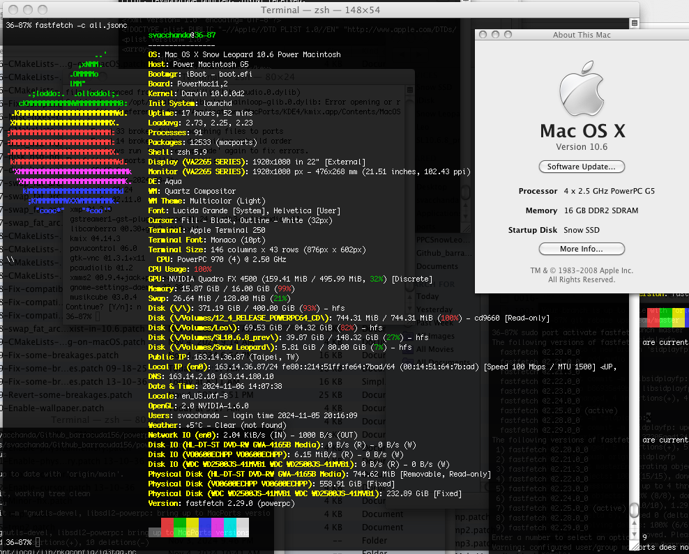

fastfetch 2.29.0 build without errors! thanks.
could you share you conf file for fastfetch? (maybe called all.jsonc in your image from terminal?)
thank you.
