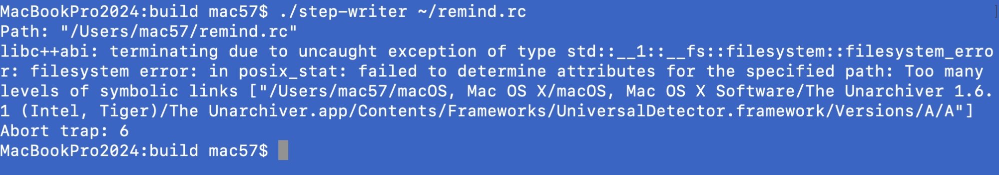

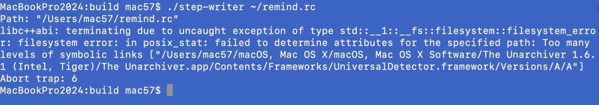

Some quick feedback from Sonoma: I built step-writer both via MacPorts and via the macos Sonoma native XCode tools. The resultant program behaves the same in both cases - it seems quite buggy. I can't even find a way to make it quit. I have to kill the Terminal session it is in to stop it.
All of this may be because it is not intended for or been tested on Sonoma, or perhaps I am just doing something wrong, but I followed the install instructions and they executed fully and successfully. Then I checked for a MacPorts port of step-writer and there was one there, so I installed that too. It too went in perfectly successfully.
However, neither seems to be very successful at opening any of my files! Here is what I get back from the macos native version when I attempt to open the file remind.rc in my home directory:
I get the same response from the MacPorts version of step-writer as well.
Any thoughts?

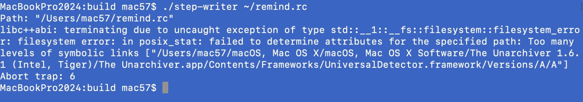

Any thoughts?
1. The app isn’t production ready, but upstream is responsive, you could ask questions and report bugs there, it will help everyone.
Perhaps, experience with emacs will be smoother? It builds for powerpc (use emacs-devel port!).
2. I wanted to ask why on earth you build something against `libc++abi` on powerpc, but then saw 2024, so likely it is Sonoma. Well, Sonoma is buggy (I have it myself). The log looks like a definite bug, but I am not sure on which side. Is it reproducible?
3. Doesn’t Control+C work? I often use just that, it is easy LOL

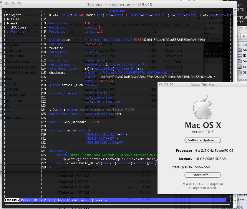

Is there any documentation? There doesn't seem to be. Can anyone say what the intended way to quit the application is? None of the keystrokes mentioned by the author seem to do what they are supposed to... but they may be a Sonoma thing. Again, when I get it done on Sorbet Leopard, I will report back.
... and it fails both ways on 10.5.9 Sorbet:
1/ On Mac OS X, the configure dies with errors related to needing "cxx_std_14".
2/ On MacPorts, it also fails, citing "Invalid value for compiler.configure" - sounds like a similar issue. The log is attached.
Does this NEED a later compiler than is available for 10.5.9?

I agree the error message is not greatly helpful, but it results from this, I believe: compiler.cxx_standard 2017.
So yes, gcc7 is a no go.
P. S. I have opened a ticket about an error message: https://trac.macports.org/ticket/71342
step-writer: Control+C works perfectly fine, both on my 10.6.8 in a VM and in Sonoma natively.
With files, it seems it can handle some formats but not some other. I have opened an issue for that, you may add your error log there too: https://github.com/BrianAnakPintar/step-writer/issues/5
