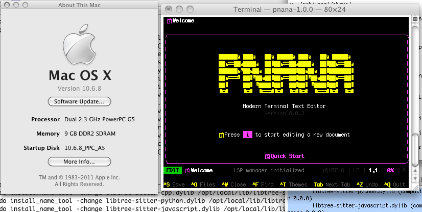

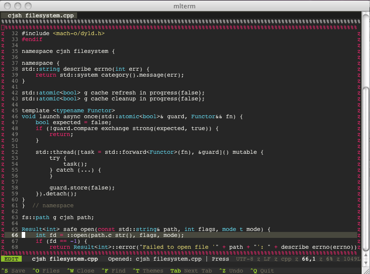

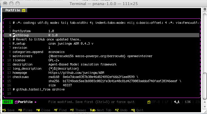

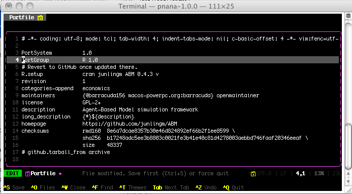

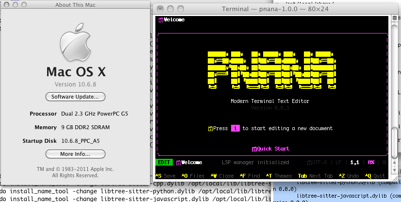

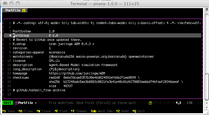

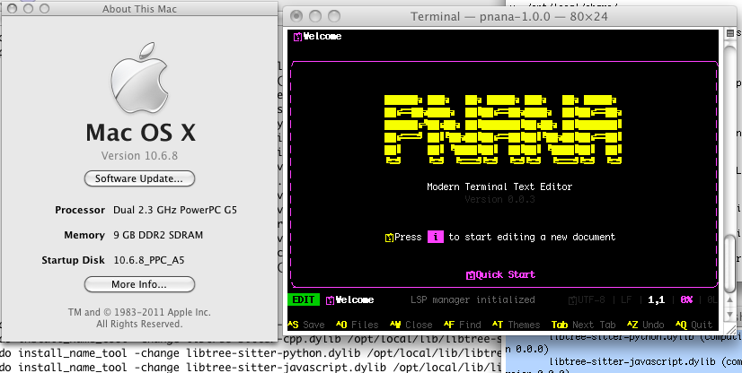

A new portpnana, TUI code editor.
In mlterm:
Reactions: Matias_

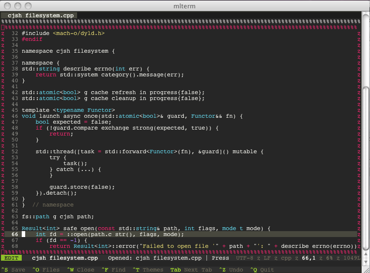

I wonder if latest elinks works? In 0.19rc1 there were such lines in NEWS file:
Of course for GUI-driven OS like OSX it sounds silly to use console browser, but if it can download src from too popular github ... I have earlier version from 2024 compiled on Slackware, I can read discussions on github but not tried downloads yet. new build I tried to configure desires libdom/libcss (from Netsurf?)
Fixed a bug on Leopard, updated the port (elinks-devel at the moment).
Reactions: Matias_

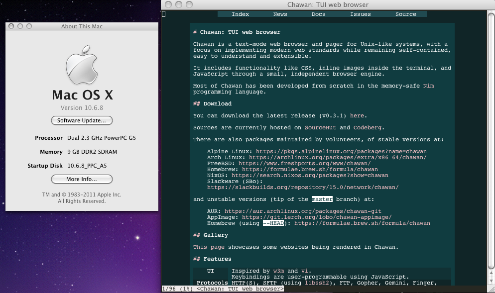

Has anyone here tried compiling chawan?
Nim is currently broken on Tiger, and needs to be fixed before we can build chawan. I thought it was going to be trivial to fix, but then it started trying to use posix_spawn stuff. If you can help with fixing it, that would be appreciated, I have a lot of other stuff to try to fix (like gtksourceview5) before I circle back and try fixing Nim again.
You could ask in Nim upstream as a question (not a bug report). This is a concrete technical issue, they may advise something.
Someone should try on Leopard. I can’t since the build fails on ppc64, and that’s what I exclusively use on 10.5.

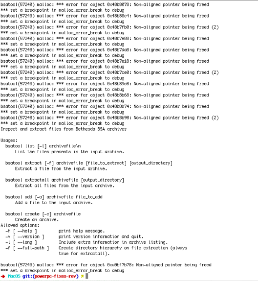

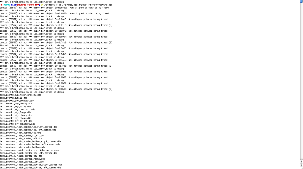

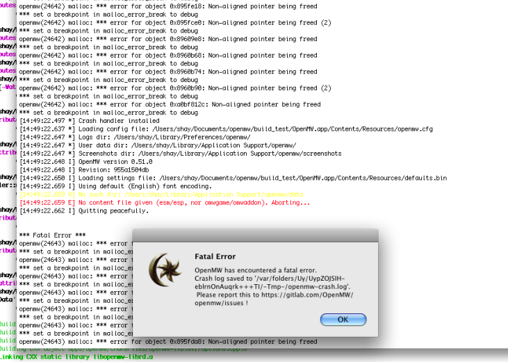

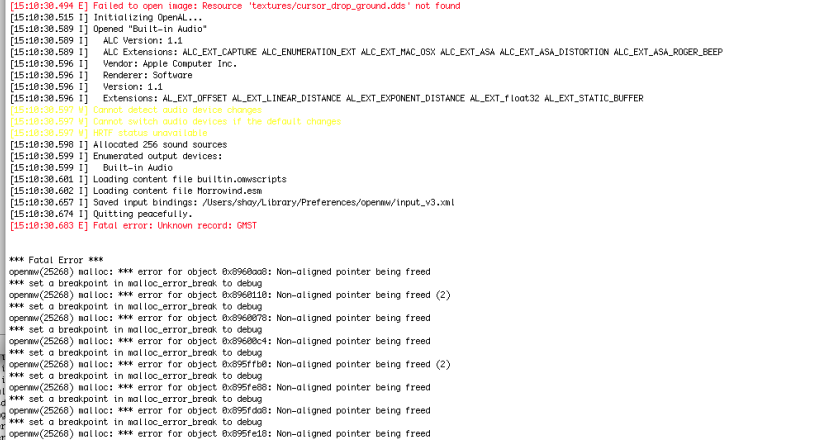

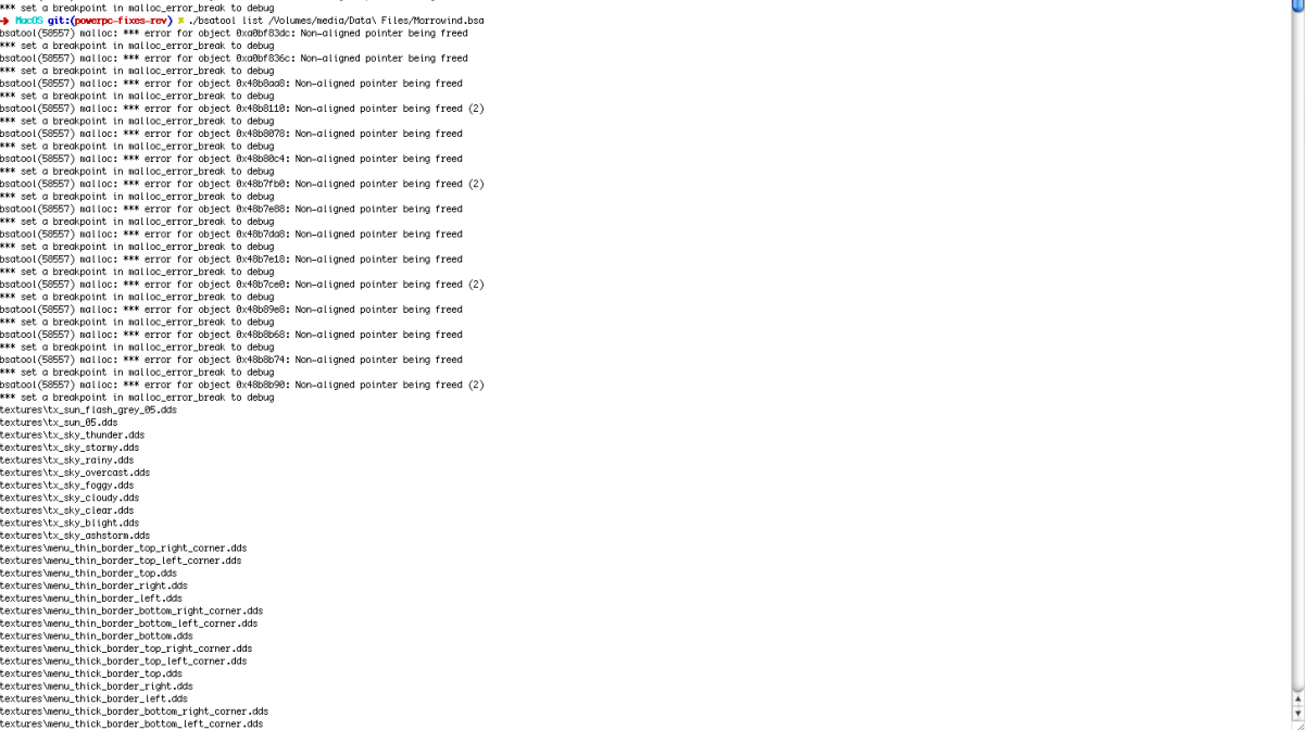

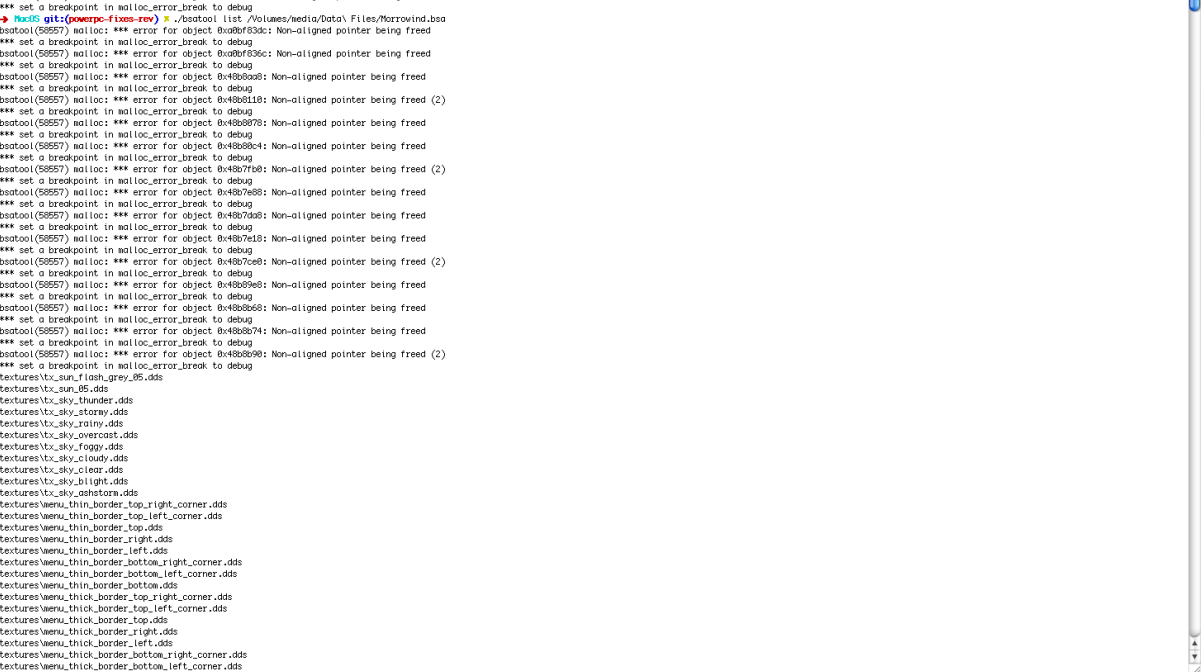

I have made good progress with `openmw` in the past few days - `esmtool` and `bsatool` build and are able to list files from archive properly, still some endianness fixes needed.
`openmw-lib` builds but I run into various linker errors when building the `openmw` project, most of which I'm working through one by one.
If anyone is interested, you can see my issue on the OpenMW repo here: https://gitlab.com/OpenMW/openmw/-/issues/8940
And a PR with my fixes here: https://github.com/doctashay/openmw/pull/1

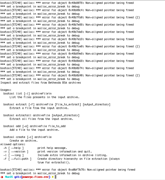

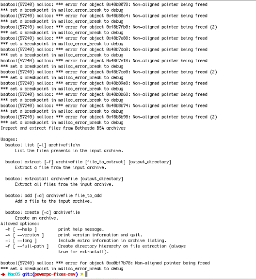

The PR is wild LOL. I left some comments, but I can’t really ready 2k lines of code and figure out what some of that is actually doing, since it is not obvious in some cases.
Notice, malloc errors are likely C++ runtimes conflict, which is solved by legacysupport.redirect_bins wrappers, see CMake port, for example.
Yeah it is a mess. The plan is to clean it up big time by moving the necessary fixes to a new branch and leaving the junk behind
It does build now! I'm able to get an OpenGL window open for a split second before it crashes due to an endianness bug. Working through these now, hopefully not much longer before I get in game.
