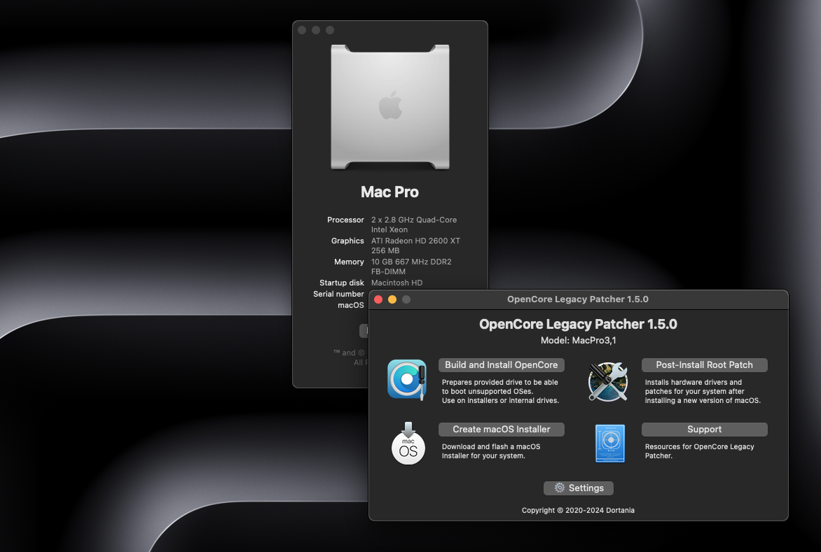

I'm going to try doing it without the bus hub today. Will update if it works or not, or any errors i see along the way.
UPDATE:
Even without using the USB bus, it still refuses to write onto my usb. I know this usb works, and it is formatted correctly. At this point, I'm at a loss.
Picture will be linked.
EDIT
After around like 3-5 minutes it started copying files. I don't know why it's so slow considering the generation of the USB drive, but it is slowly installing now. Will continue with updates.

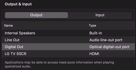

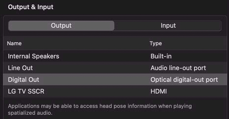

Greetings,
Lack of Audio Out issue
My 3,1 had this issue in Big Sur & Monterey. I could not se ANY of my Audio input or Output devices, could only output via HDMI.
With my fresh Ventura install, all options have now returned to normal.

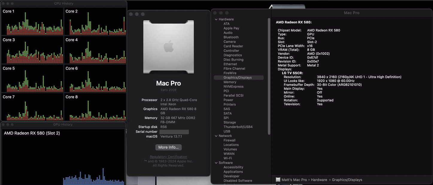

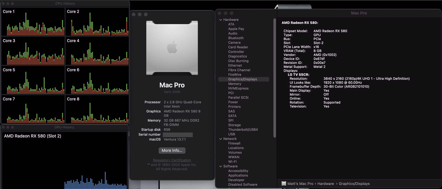

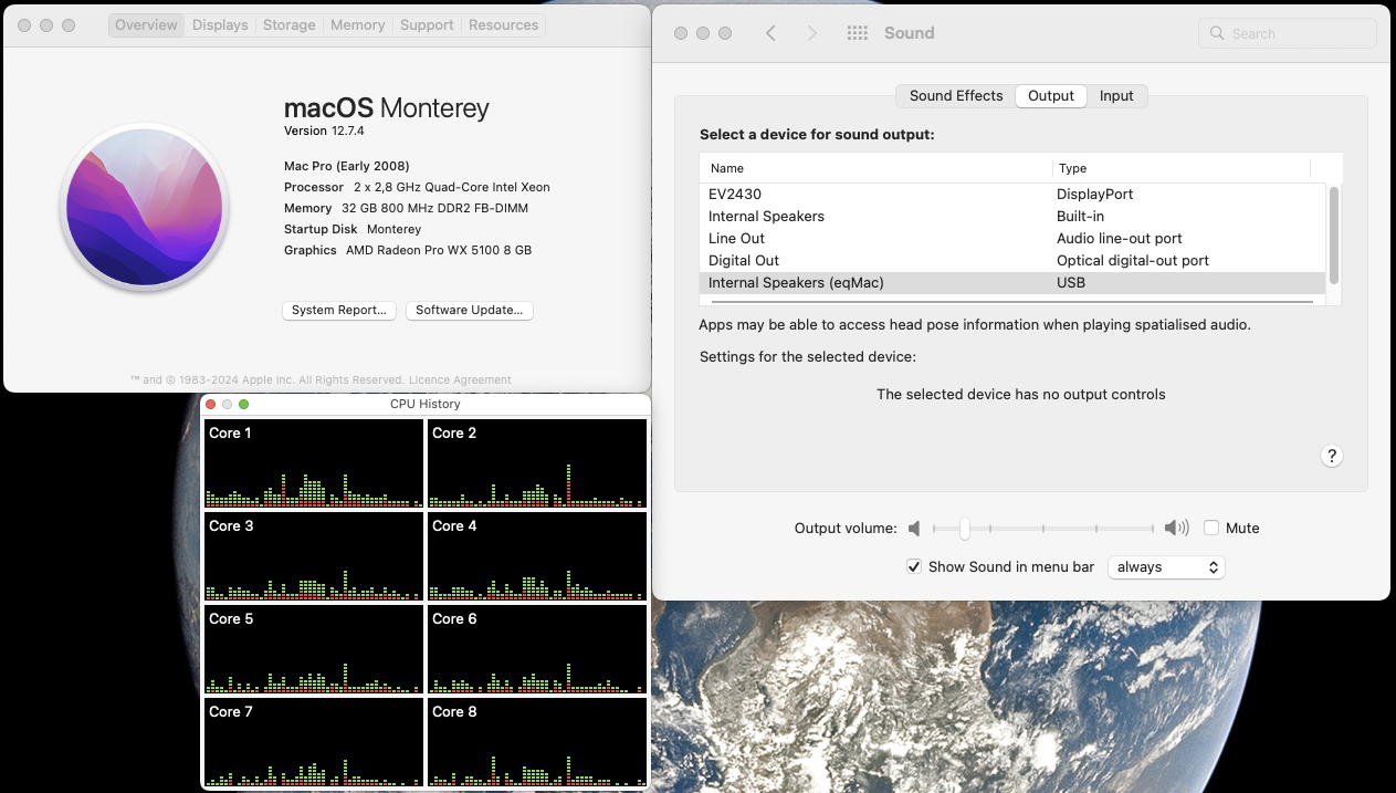

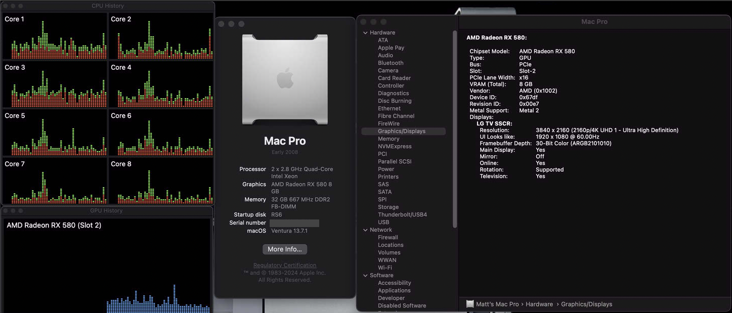

Regarding checking cores
The method I use (there are likely others) is to open Activity monitor and open CPU monitor, or CPU History. On one of my boots it currently only shows 2 cores, but on my main SSD I am (thankfully) able to see all 8 being used.
Reactions: pullman

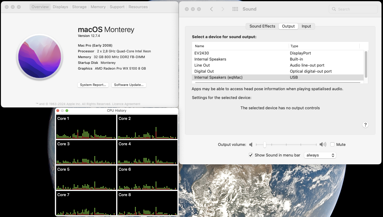

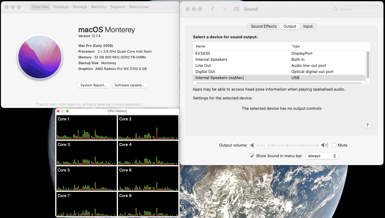

Thank you, great that all cores have reappeared. On mine, all eight show, as well as all audio options. I'm wondering what might cause this difference between two very similar systems. Still I'm happy it's working well now in Ventura :)

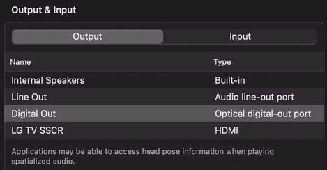

Greetings,
