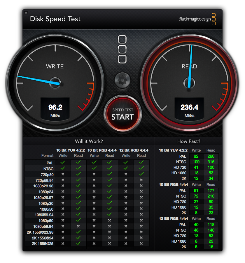

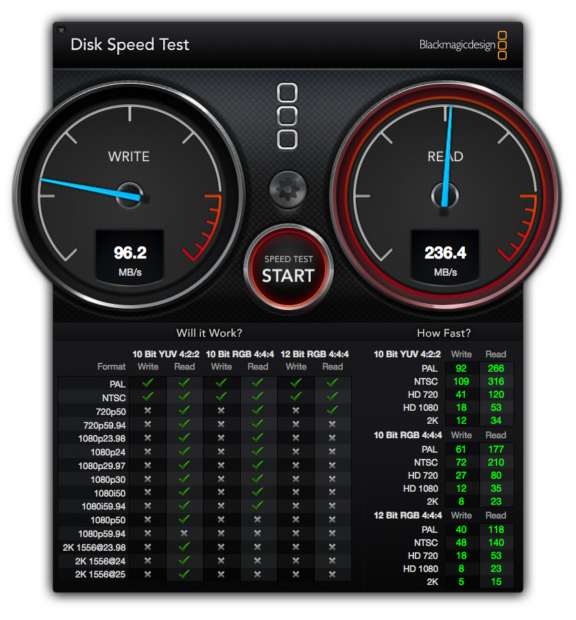

I'm sitting here being all jealous about you people with superfast 160 MB/s speeds... here's my Kingston SV300S37A120G
DO NOT BUY KINGSTON SSDS. Unless you want to buy mine. Then by all means please do.
(TRIM enabled, fsck -fy performed)
I posted in your other thread, but the problem there is that SSD uses a Sandforce controller and they are horrible at writing incompressible data. BlackMagic uses incompressible data for the test and that is why you are seeing bad write test speeds with BlackMagic and good speeds with AJA.

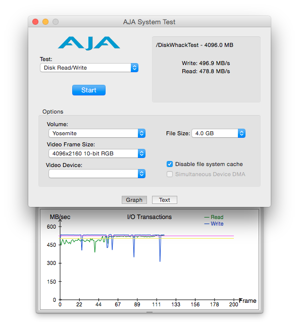

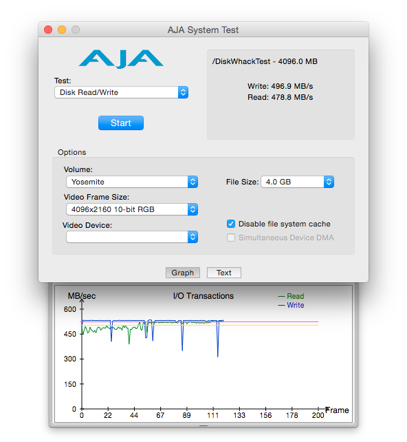

Wow. It makes me wonder how accurate either Black Magic or AJA System Test are. Because AJA gave me this result:
That's 496.9 MB vs 96.2 MB write and 478.8 vs 236.4 MB read!!!
It's not an accuracy issue. It's the type of data used in the test. BlackMagic uses compressed data that tends to show low numbers on drives with sandforce controllers (because they're less efficient with compressed data). Uncompressed data transfers at much higher rates. I'm not sure what controller your drive has, but it could be related to that. Samsung drives/controllers are particularly good at handling compressed data. I did a lot of reading before I purchased my 1st SSD, and it was preciously for that reason that I went with Samsung SSDs.

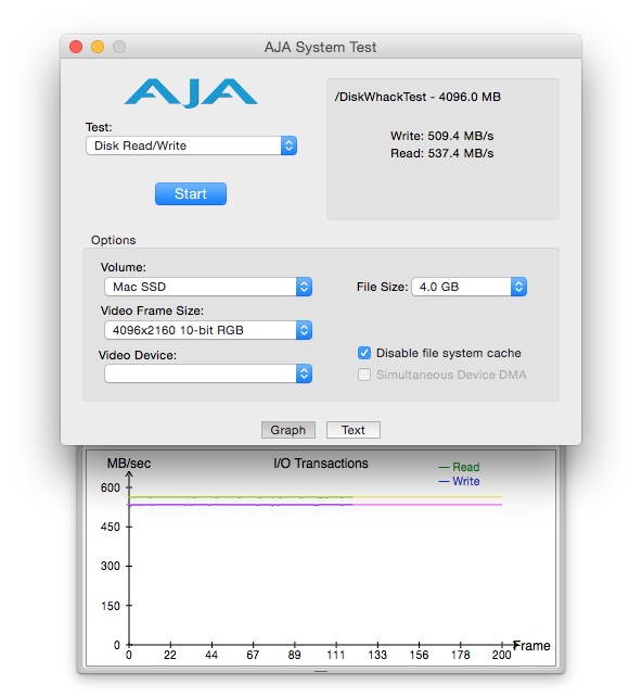

Samsung 850 PRO 256Gb (Revision: EXM01B6Q)

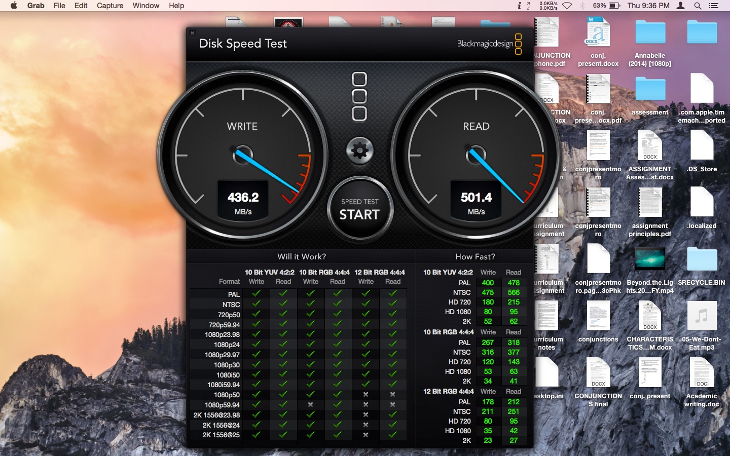

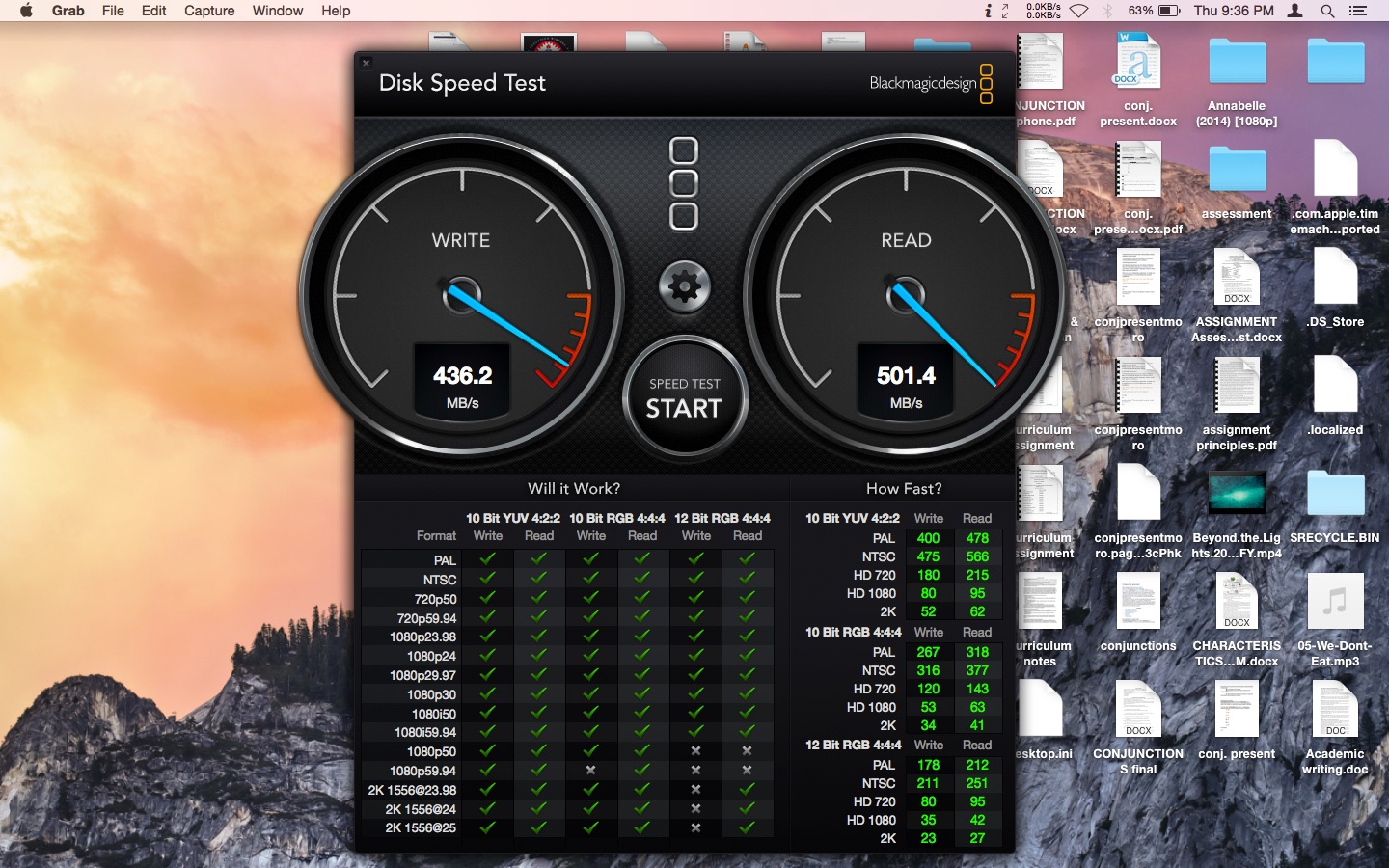

I rebooted again and ran the BM test and got nice results for R/W (~500). Everything seems snappy.
