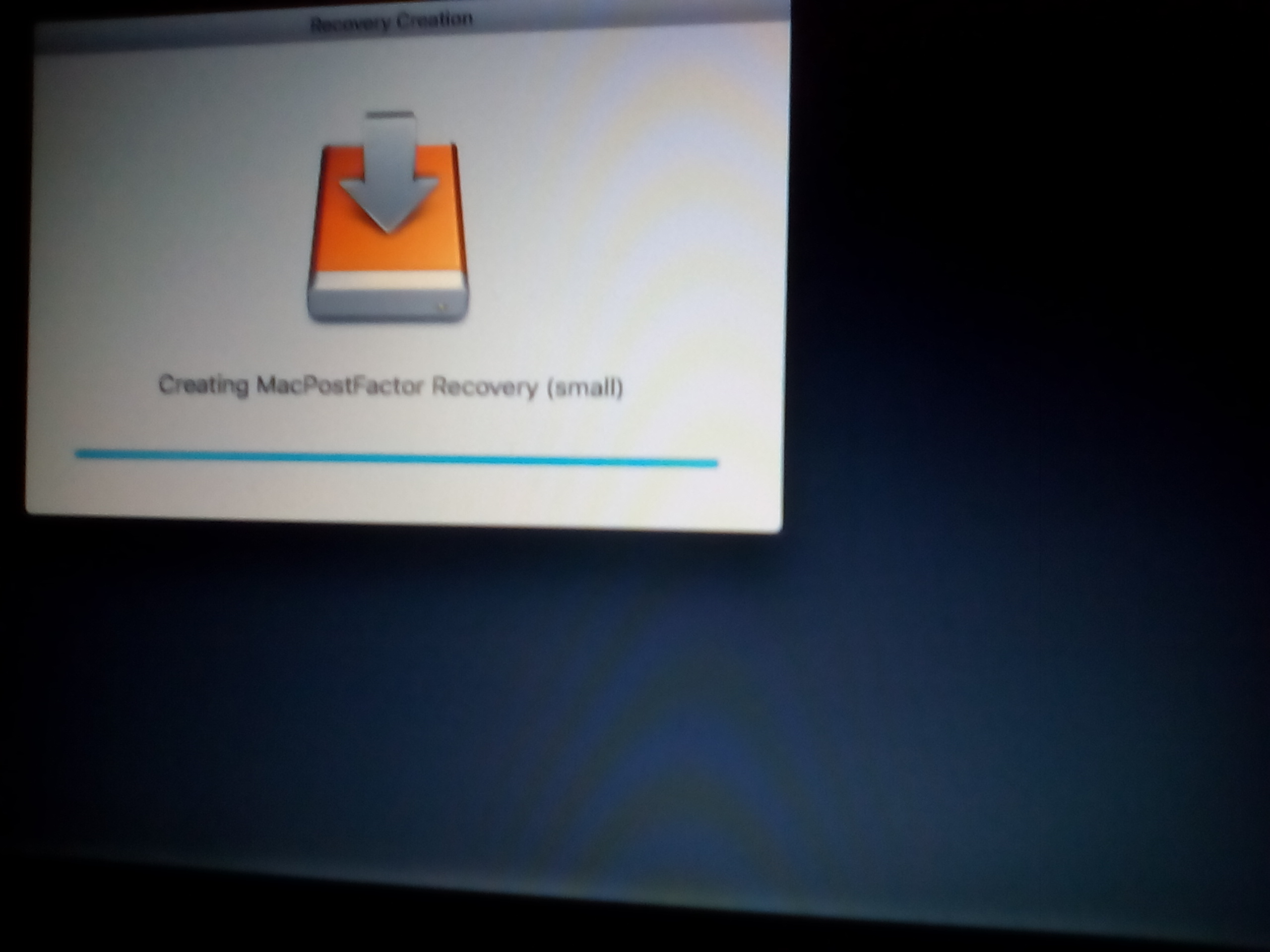

I've been unable to get MCPF to work, the first stage works, and I can restart from the Installer USB stick/partition. But I get a kernel panic after a short while.

Seems that MCPF doesn't work to install 10.10 either. The installer says it doesn't know what's wrong; but the installer log says that OSInstall.pkg can't be opened as the current OS is too new; i.e. the installer OS is 10.11 and needs to be 10.10 for OSinstall.pkg to be run. However, after examining SystemVersion.plist on both the installer and destination drives; the destination drive has 10.11 and installer drive has 10.10. Something's quite broken!

I keep getting error 1 on my MacBook 3,1. I've tried erasing and reinstalling loads of times and I have also redownloaded the .app from the App Store. I've tried to do a usb install but its says my 8gb drive is too small. Any one any ideas? Thanks
I'm trying to install El Capitan via MPF but I can't select any "type to install" option :(

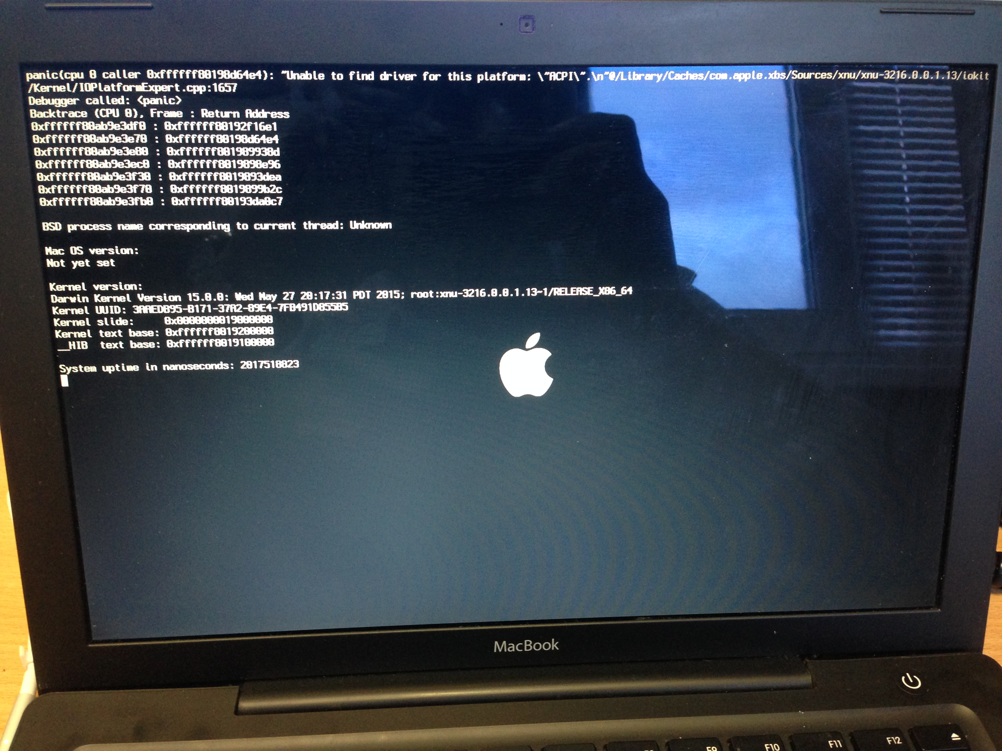

I've tried MCPF v2.0.1 with my MacBook 2,1. It doesn't work (many attempts, first directly to the HDD, second creating the installer and doing a clean install formatting the whole HDD drive...).
What happens?
I arrive to the screen I'm attaching, after some minutes it reboots. I arrive again to this screen, it reboots, and this happens all the time. The installation process cannot finish.
What happens?

Related to boot.efi, El Capitan Pike's EFI doesn't work with my MB 2,1. I needed to use Yosemite Pike's EFI instead. As you know, it works, but SIP cannot be disabled.
So, I understand what happens with MCPF v2.0.1. El Capitan Pike's EFI doesn't boot with the vast majority of EFI32 Macs, it seems to be very Mac Pro oriented. I tried to change it, recompiling it with Visual Studio and it didn't work, it rebooted all the time too. I even have an issue opened on GitHub related to this but Pike hasn't answered to it yet.
That's why my MB 2,1 reboots, it's what happened to me while I was trying the method I've described using that El Capitan boot.efi. Until I didn't change boot.efi to the old Yosemite one, I didn't have success installing El Capitan.
Can't help with the first issue. The instructions for creating a USB install key do say they require 15 GB of available space.
Good day. There MacBook:
makbuk2.1
core 2 duo
950 graphics
4GB of RAM
board-id mac-f4208kaa
All I have done on the instructions but when installing el captain arises Kernel panics or just a black screen with the Apple logo. Please help me please what I'm doing wrong.

Are u using yosemite's boot.efi? U can check post #502.
So yosemite boot efi is the key to install and have working ElCap on some unsupported machines?

Check post #502 and download that boot.efi, replace boot.efi you have with this one, and install it as explained. Tell us what happens then: it should boot.

Mb 2,1 needs Yosemite from post #502. Mb3,1 needs another boot.efi from your Yosemite OS X Hackers installation. Mb3,1 boot.efi will not work on mb2,1. Be sure what boot.efi u are using. If method is 502, be sure kext.caches folder is created. If you do 502 again with your 2,1 using the files attached and then explain *exactly* what happens, maybe I can help you.

To know limitations read posts from #502. Yes, yosemite's boot.efi is the key. Procedure #502 is the only one now is working. OS X Hackers are now working to fix MCPF.
