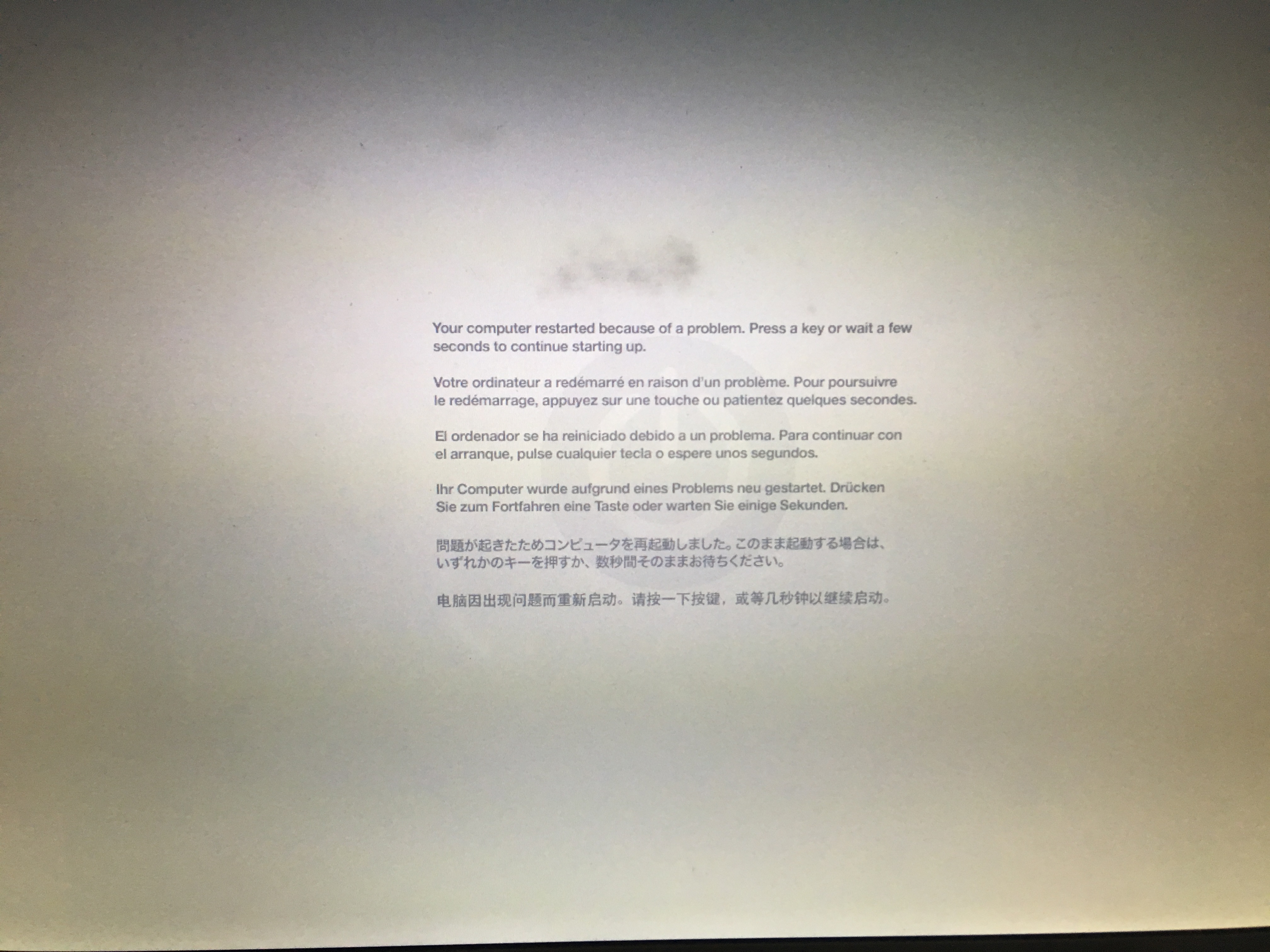

@TMRJIJ: My MB 2,1 (late 2007, white) can't boot MOSE 1.42 prepared 10.11.6 installation drive (OS X Base System) on external USB disk. USB disk seems to die immediately, the boot logo freeze for ever and the cooler gets loud like hell. Is this because of SIP or is there any other reason?
Same behavior for 10.11.5.
With MCPF 2.0.1 I can start MacOS installation but unfortunately it gets aborted with "Illegal Instruction 4" (directly after the message "FSF cache NOT written" in the step "Writing system path cache") and MB restarts automatically. The workaround and disabling SIP via "scprutil disable" do not help either.
The MacBook 2,1 only has USB2.0 ports. Apparently Apple removed support for USB2.0 in the ElCapitan installer (which only supports USB3.0 ports).
Only workaround seems to be the one detailed by Skyfly555 in post #1 method 3. I used a variant of this with an Asus Hackintosh to get EC working on my MacBook 2,1. So it can be done but another PC/Mac is required.

@mattschwantes: Thanks for the explanation. Could you please be more precise on the statement "Apple removed support for USB2.0 in the ElCapitan installer (which only supports USB3.0 ports)". The general USB2.0 support in EL Capitan is not stopped (see https://support.apple.com/kb/PH22215?locale=en_US). So why to stop support just for the installer but continue with it for the installed OS?
Will disabling SIP fix the USB2.0 issue with installer?
Sorry for the lack of clarity. The first half of my post was to you. I then posted another separate reply to Skyfly555's post, but for some reason MacRumors forum automatically combines consecutive posts from the same person.
My explanation was a bit inaccurate. My knowledge in this area is relatively limited, mostly coming from reading the previous 35 pages of posts in this thread. The issue appears to be that Apple removed the KEXT for the Intel USB2.0 controller that is found in our MacBook 2,1. So the installer (which is using USB) will begin to install, but it reaches a point where it needs those additional KEXTs to continue. Disabling SIP is only half of the battle. The other half would be to add the KEXTs to the installer.
Another matter to note is that once you have it all up and working, every single Apple security update automatically disables/removes one of the critical USB kexts. After this, keyboard/mouse/USB ports again stop working because it turns out they are wired internally as USB devices. This forces me to boot using Refind from an external USB Yosemite install to repair the internal ElCap Kexts again, which takes 30-60 mins to fix everytime. All this makes it quite annoying to use as compared to Yosemite, which basically just works.
I am not personally capable enough to automate a fix for the disappearing USB kext, but nobody else mentions this, so perhaps I am the only one encountering the problem (currently on v10.11.6). Wish you good luck with your efforts here.

Hello guys!
I would like to ask you about i’ve got a late 2006 Macbook Pro that I wanted to use with el cap.Now I’ve tried serveral methods to install that on my mac and it’s always failed but then I saw a method to install it via a MacintoshHD.dmg that someone created (big thanks to that person). So I installed it and my macbook now it wont let me to do anything, nothing responds except the power button. So if someone have a fix to the usb please tell me..
Thanks in advance!

Hello guys!
Thanks in advance!
Method 3 works great on my MBP2,1 mid2016
Sebestyen50
macrumors newbie
Jun 12, 2017
3
I’ve tried it, just the usb kexts what I didn’t found but i’ve found it right now. The next thing I suffer from is KP. My mac always reboots randomly and starts up with this screen..
Is there any method to solve this?
You must be sure all the kexts have the appropiate permissions, and when you create the prelinked kernel be sure they are included and you don't get the message saying "omitting...".
Check the permissions going into /Volumes/Capitann/System/Library/Extensions and type on terminal: ls -l *
Be sure all of them have root:wheel owner and chmod is ok.
Be sure, too, you have installed boot.efi from @vsbalint70. It disables SIP when used in conjunction with rEFInd.

Hi! I have a big question about the new boot.efi that made by @vsbalint70 , so I installed that refind bootmanager and then i switched off SIP and managed the permissions.Thats all I have to do to try the new boot.efi or I have to more?
Thanks in advance
