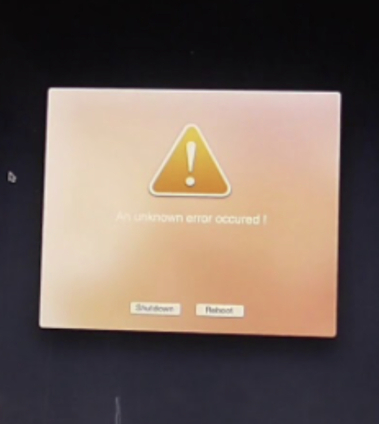

Could you please help me? While installing El Capitan from pendrive I get this error, Yosemite installation was successful. IMac late 2006.

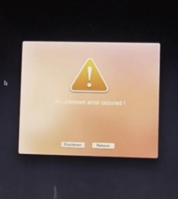

Could you please help me? While installing El Capitan from pendrive I get this error, Yosemite installation was successful. IMac late 2006.​
Hi, as often you don't provide further information (like which patcher you've chosen). Meanwhile, it's important to know if Yosemite is still working.
You should try with a different USB drive and make sure you've used the right settings. Yes, anybody can get distracted and chose the wrong format.
You should also check if the El Capitan installer used is up to date. As you might have read, options are narrowed to OS X Patcher from RMC Team (links are all through last 3 pages) which also has a downloader script available for a fresh copy of the installer.
If you're still getting a failure, you should specially read my previous posts where installing works better from a hard drive partition than from a USB drive. Yes, it's easier just use this second option... but there are so many mishaps like yours that make the first option more reliable.
Of course, you need hard drive space for the installer partition and another one to put El Capitan (maybe 10 GB and 40 GB will do the trick, unless you'll need to transfer programs/data/preferences/settings/users). Again, not knowing if you only have Yosemite, might force me to guess you have a stable Lion or Mountain Lion partition in case of failure (like this one).
If you only had Yosemite and it's know useless... not sure if System restore will work to restore a patched booting partition. Or if you even have a System restore partition for Yosemite or if you still have the USB drive to reinstall Yosemite.
For those that will come later... please take a while to read (at least) the last 5 pages and provide more information than just your model (like partitions and hard drive size and the amount of RAM) that might be useful for easy help.
