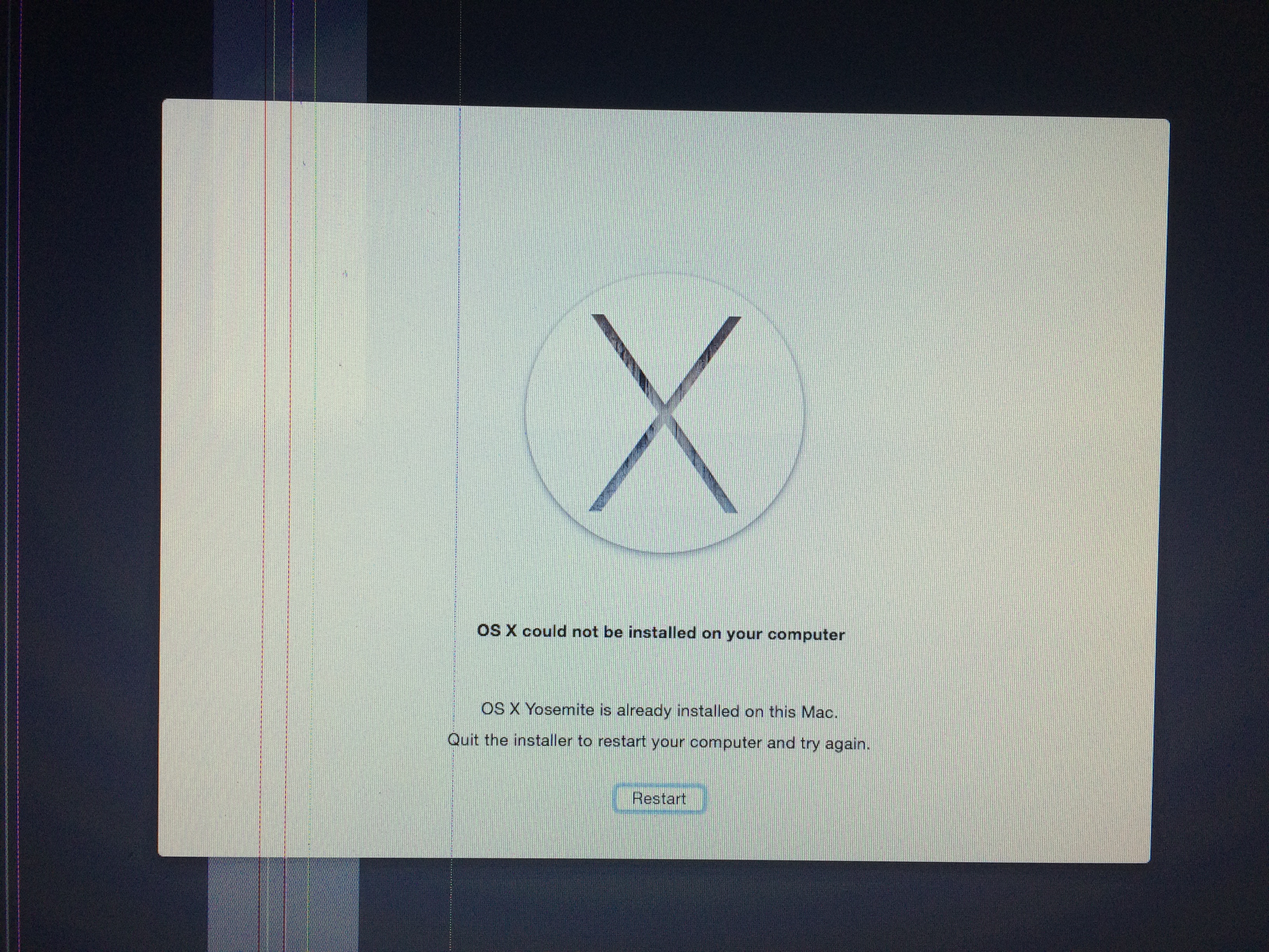

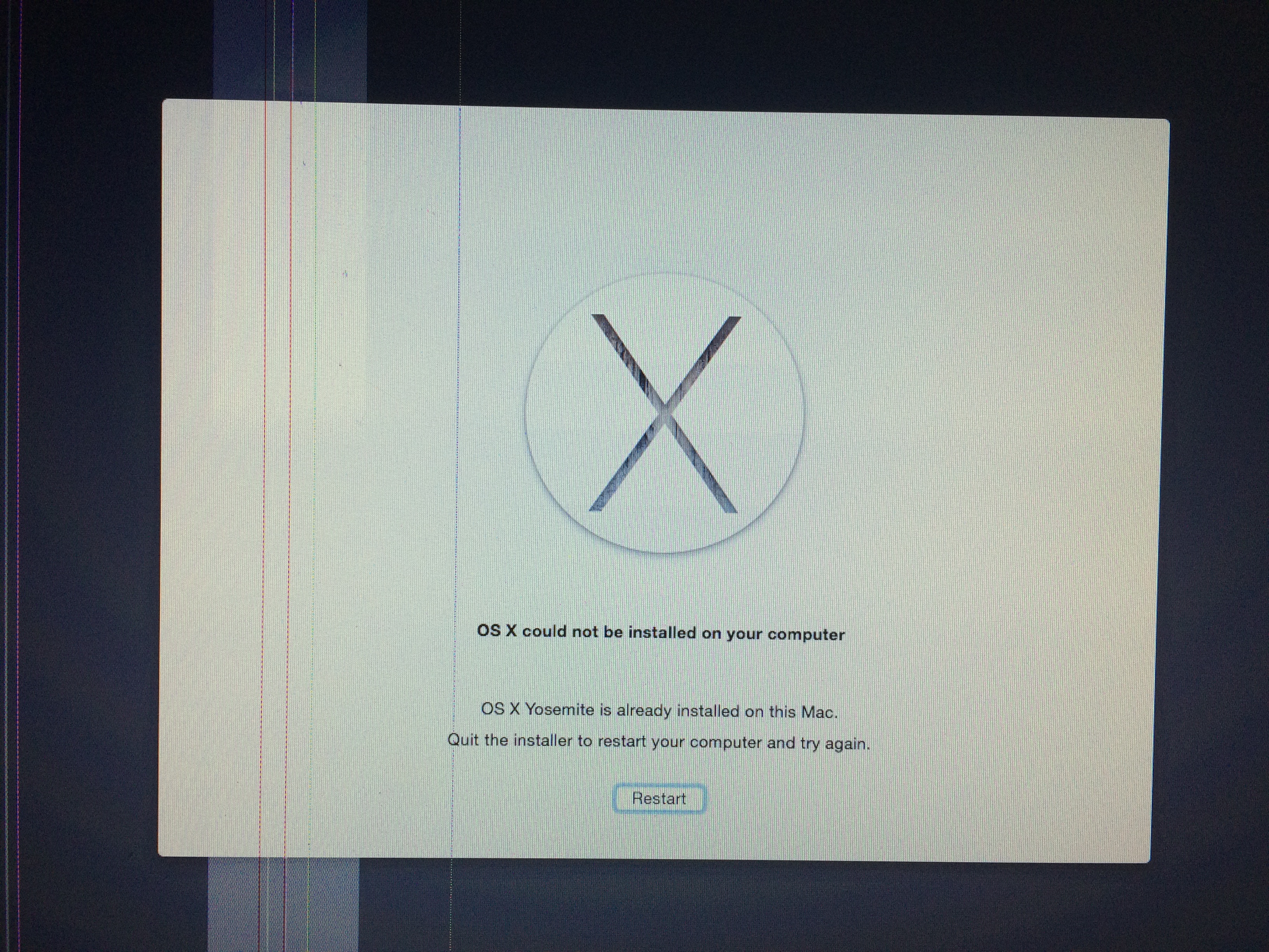

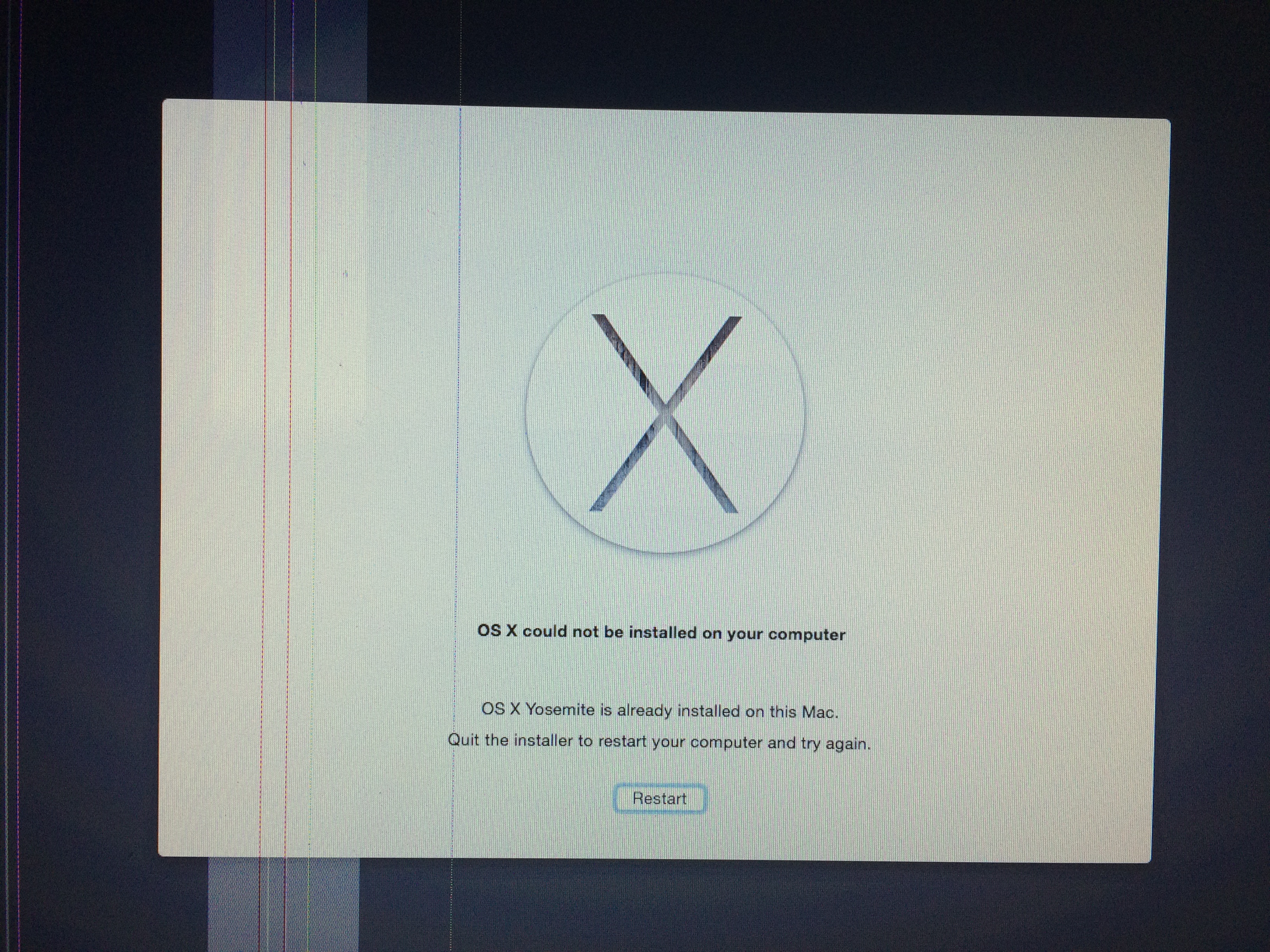

I have a question about the above:
I have the installer as writen by Hennesie2000. It worked like a charm on my Mac Pro 2.1
I have added the board ID from my iMac 5.1 <MAC-F42786A9>
when I boot from the Yosemite installer I get the nice black boot.efi and then at the end I get the full schreen display in color stating:
OS X could not be installed on your computer
OS X Yosemite is already installed on this Mac
Quite the installer to restart your computer and try again
Does one of you have an idea about this?
thanks,

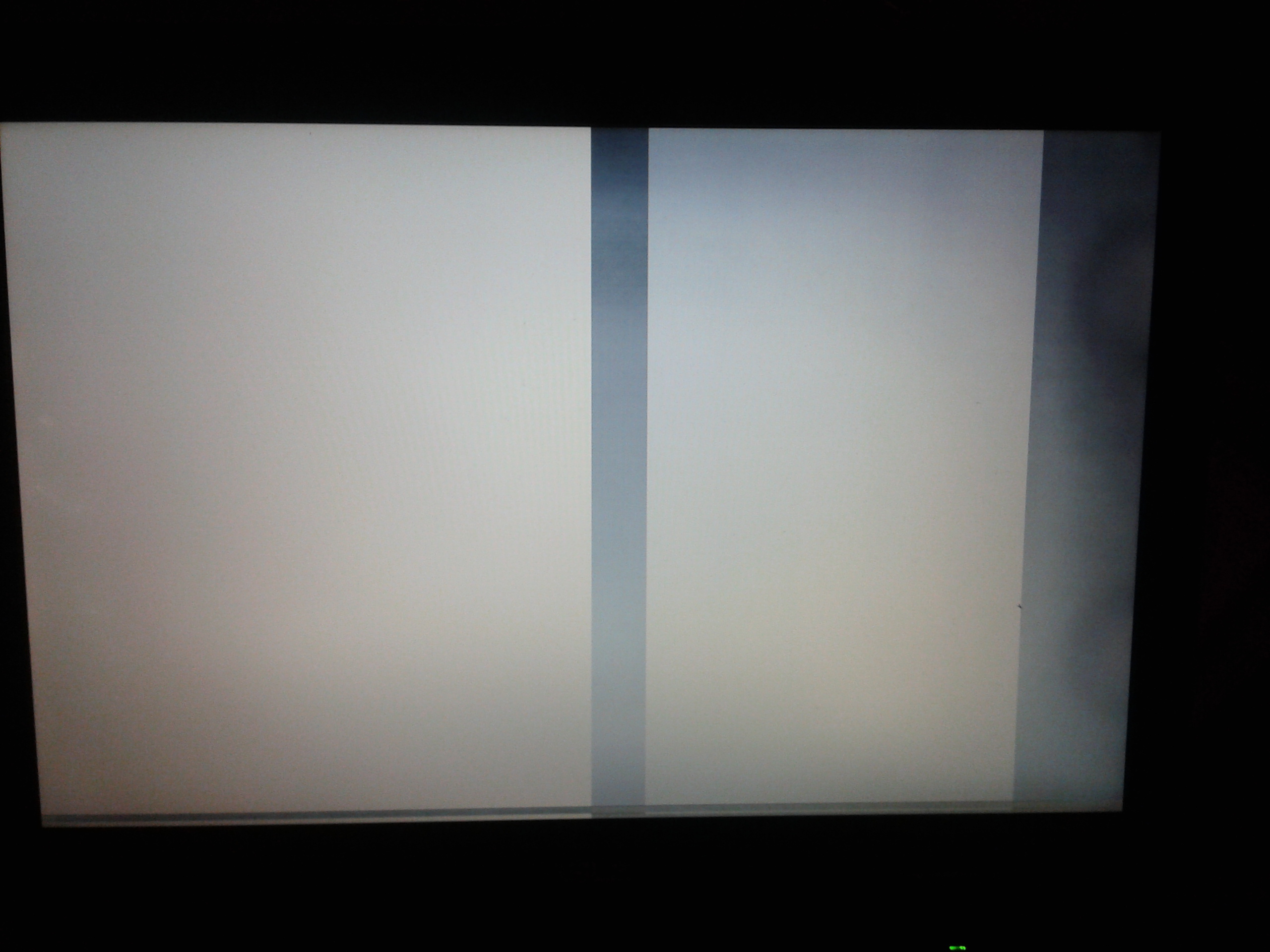

Hi!

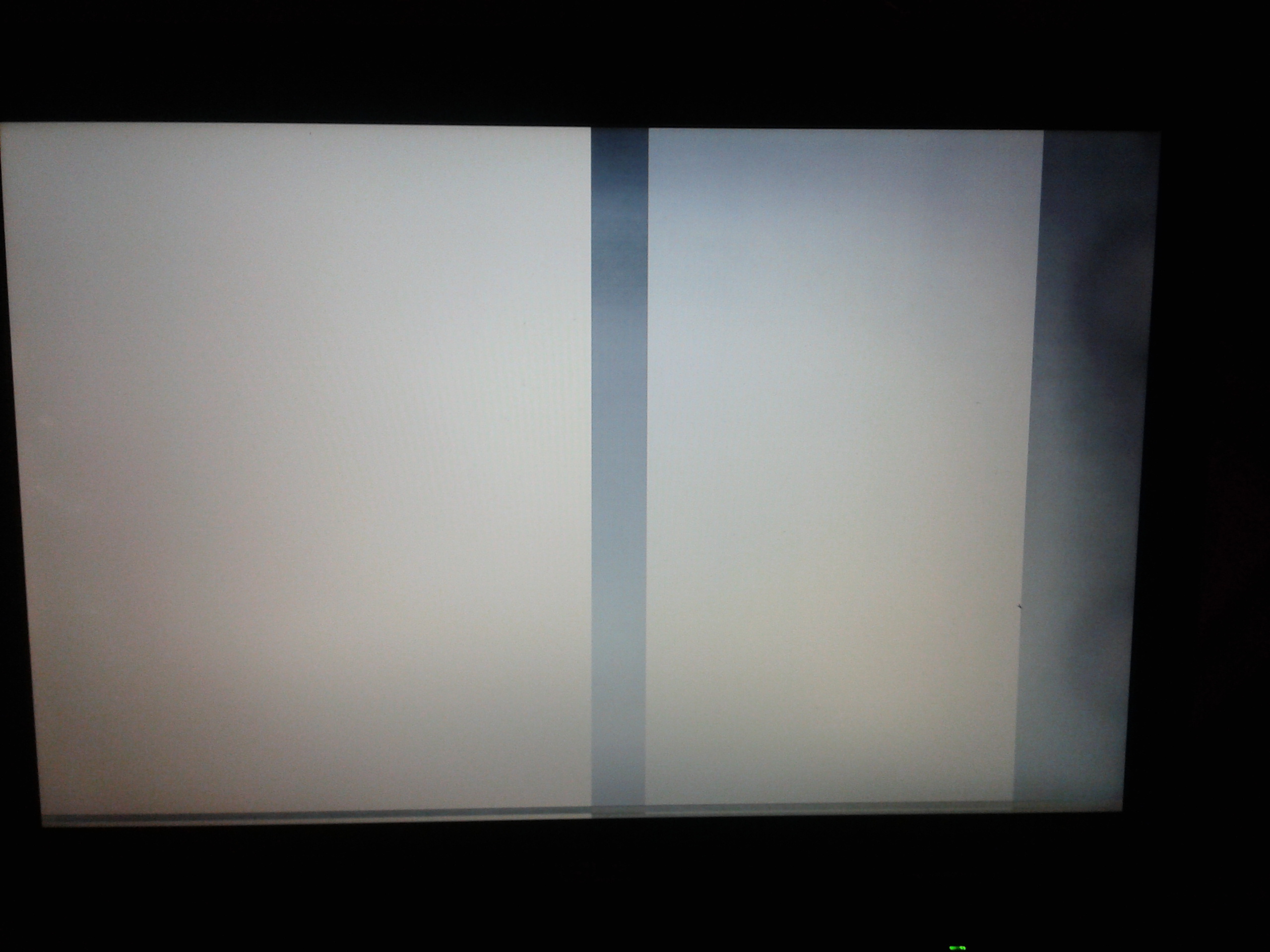

Any help for gma x3100 driver for yosemite/el capitan?
I have tried with x64 drivers but got artifacts.
I used graphicsenabler=no boot flag too but nothing results.
Any idea?
Thx,
G

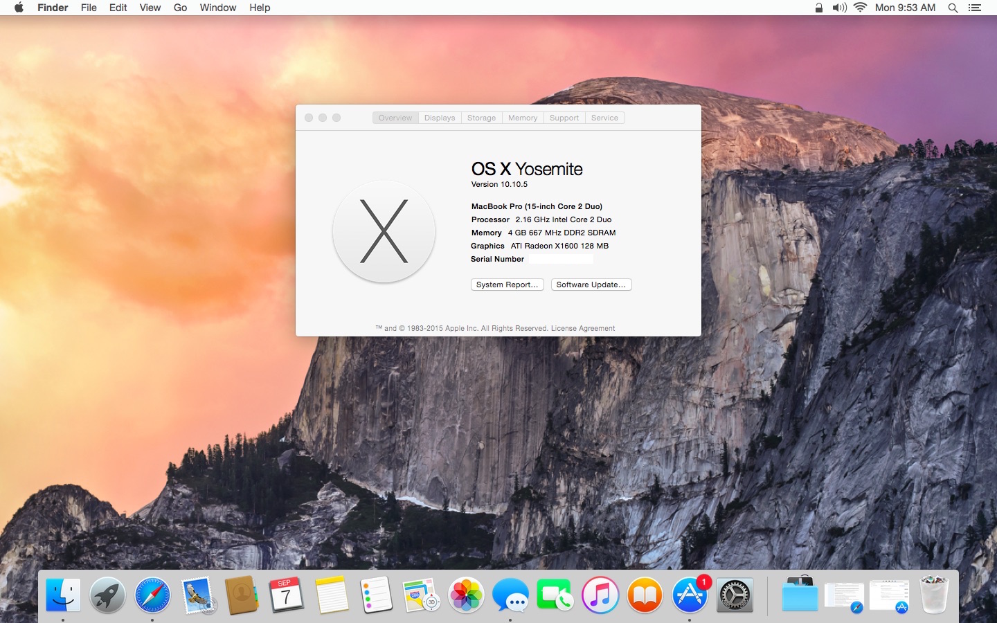

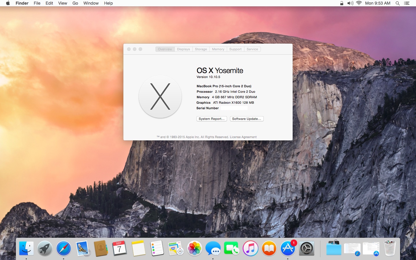

View attachment 579568 SUCCESS!!!
I tried OS X Extractor Public Beta 2 again and actually followed the steps in post 1 (I thought it would do everything for me like MCPF). The only step I found missing was adding the board-id to OSInstall.mpkg. There are 3 places to change this.
Still working through the slow graphics, haven't decided to disable graphic acceleration yet.
Tidel,
can you point to the 3rd place to change the board ID!
I know of two but it could be the issue with me not beeing able to make it hapen on mine iMac 5.1
thanks,
Forget about it I checked the instruction again and found the 3rd one.
Still the same message "OS X could not be installed on your computer"
Tidel,
thanks,
Installation is running.
followed the instruction again and now it seems to be ok.

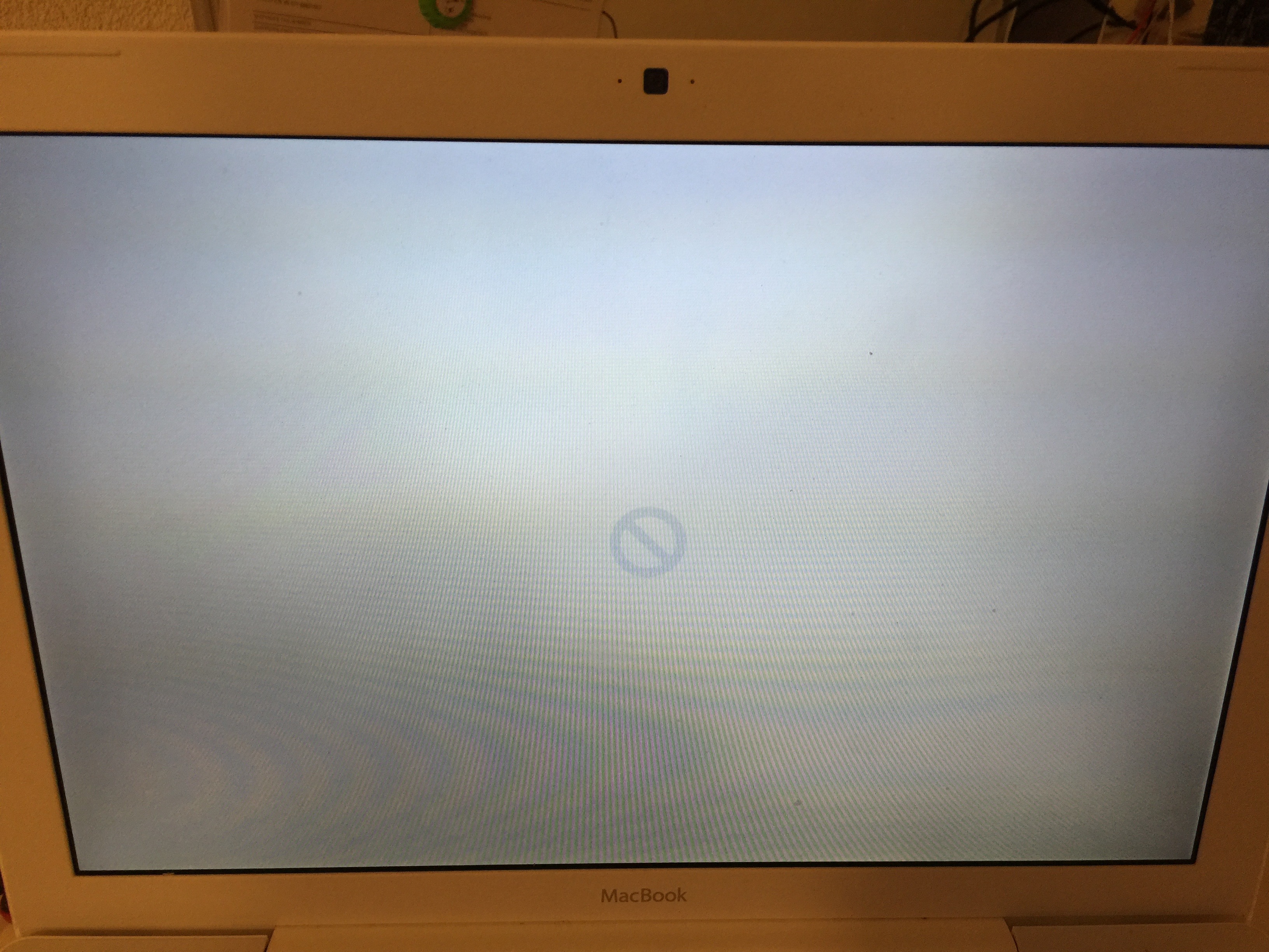

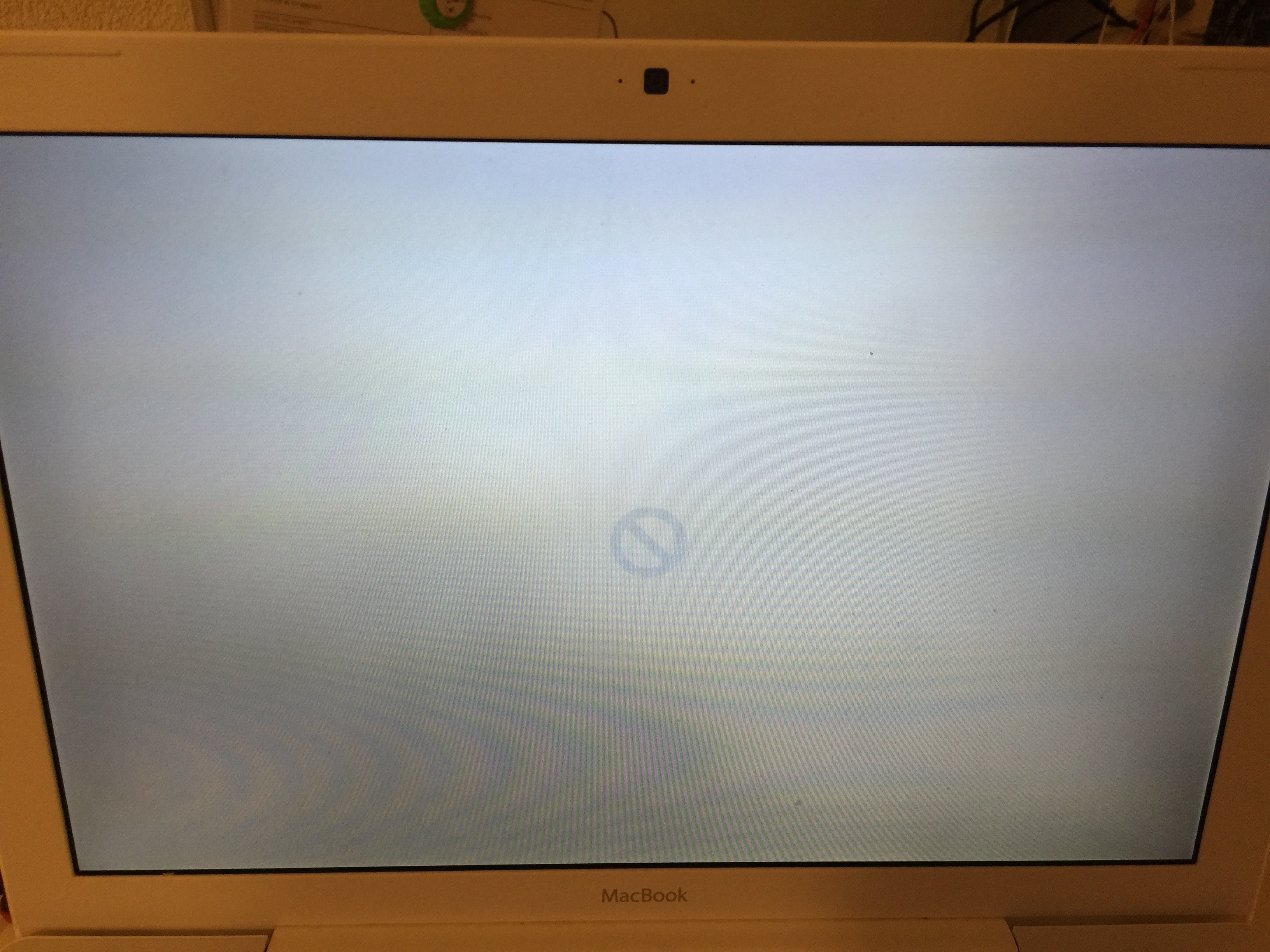

After create a bootable usb drive and install Yosemite the first boot give this error sign.
Install it on a MacBook 4,1. Anyone a idea what to do about it?
I have just done the installation on mine 5.1 machine.
If you did not upgrade the CPU on a 4.1 machine you still have the Core Duo CPU and for this to work you need the Core 2 Cuo CPU.
See #1 insturction it reads C2D cpu upgrade.
I hope this does help.
good luck.

Its not a iMac its a MacBook and the CPU is not upgradable.
I see a lot of order users with a MacBook 4.1 Whoever it is successful.
This might help:
D: If Reboot Fails
(If the Mac does not reboot to the Yosemite desktop boot to the install-drive again and perform the following.
Boot back into the Yosemite Install Partition
open the terminal at the top menu bar or boot into single user mode (Hold Command -S immediately afterturning on)
enter:
Code:
sudo rm /Volumes/[Main Drive Name]/System/Library/CoreServices/PlatformSupport.plist
